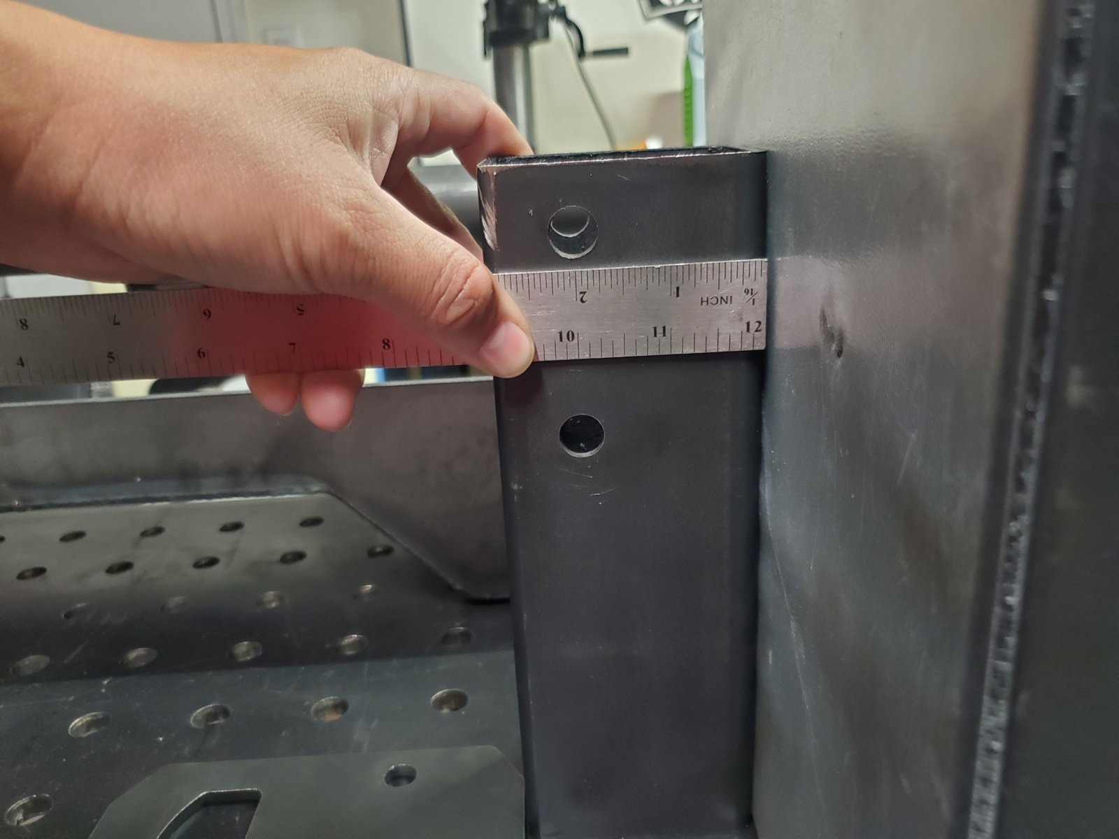

  14. Jul 16, 2024 at 6:46 AM
    #194
    Kwikvette
    Kwikvette [OP] Well-Known Member Vendor
    Feb 27, 2019
    #284735
    82,246
    Fresno County
    4 run, 2 don't
    I take it you're referring to the 2" mark right? I think that might give people the most trouble.
    Best thing to do would be to lay something flat against that edge facing towards you.
    Could use anything like a binder, flat stock, square tube, anything with a flat surface really.
    Then place your ruler against that flat surface to read 2" across.
    Example.
    You're not going to get anything perfect, but the areas where one might need help with is where I used small slots.
    Was taking ease of install into consideration.
    The discontinued set uses holes that are .40" diameter.
    I use .406" throughout except .41" for the L bracket and exterior bracket for a tiny bit of wiggle room.
    As someone doing stuff from home without industrial equipment, trust me the need to keep things consistent is a tad bit nerve wrecking :laughing:
    Just doing what I can!
