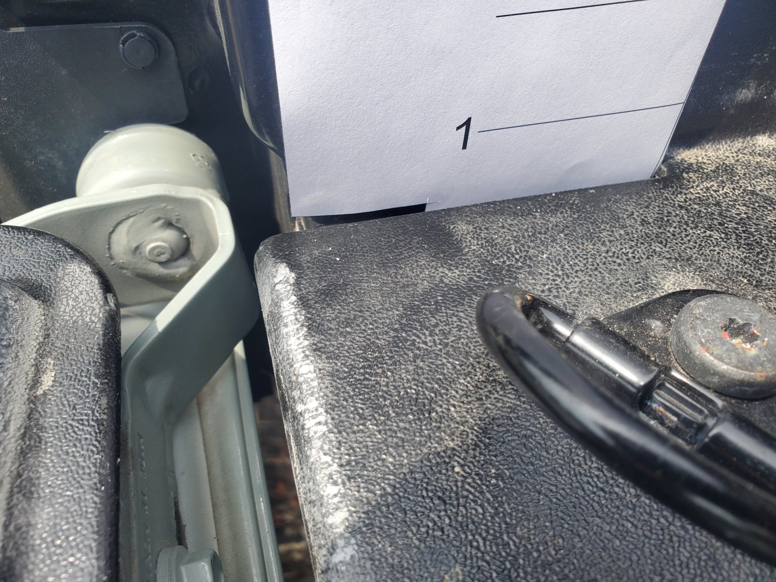

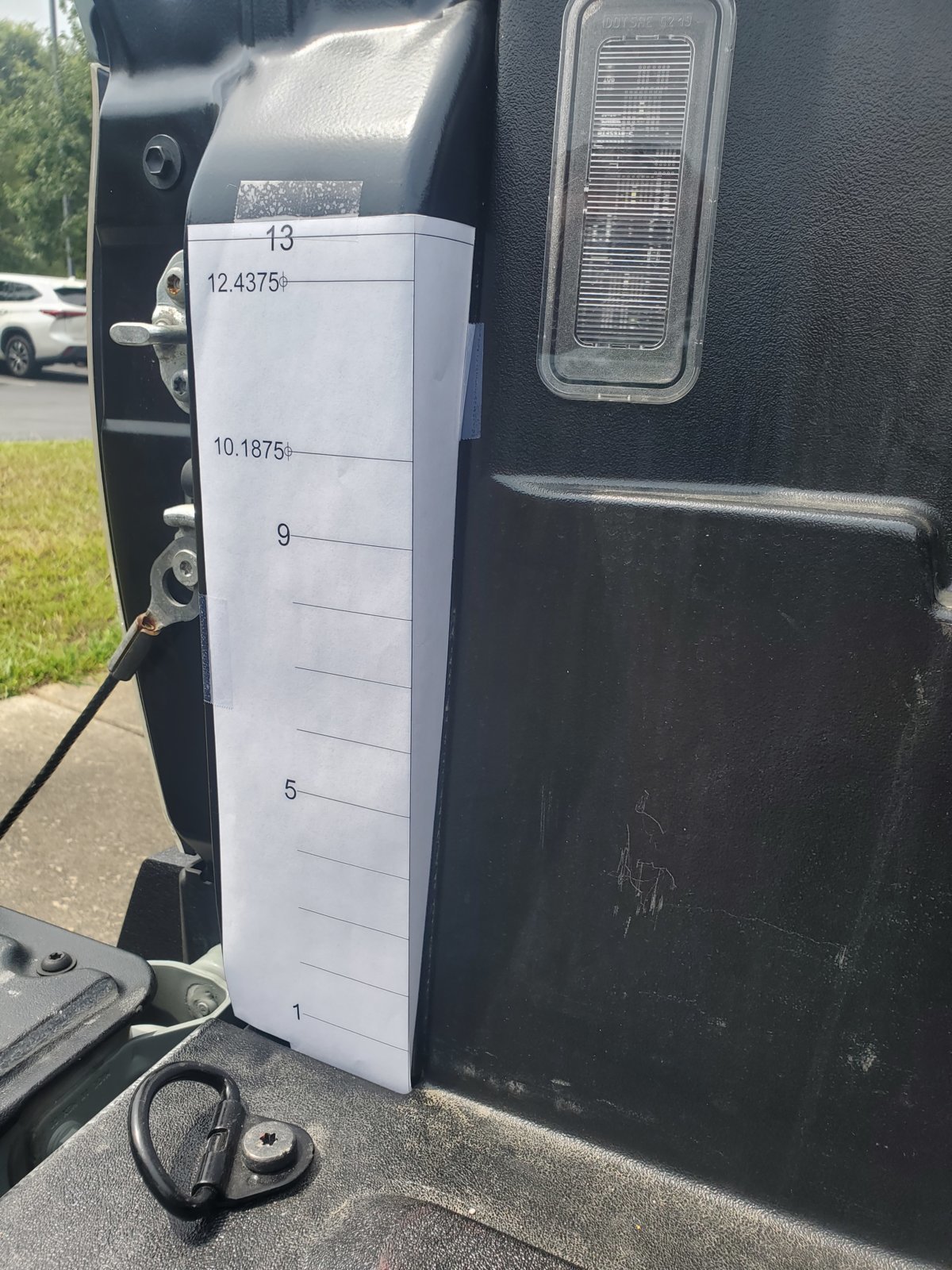

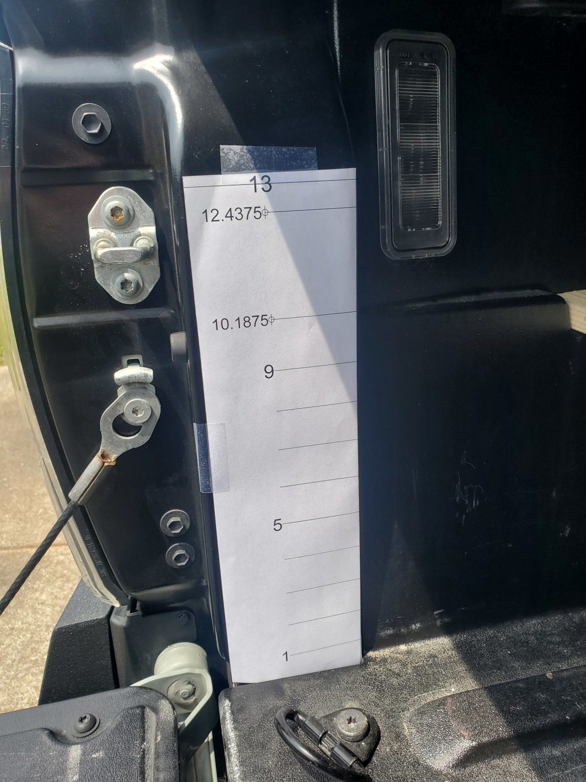

    Print on tabloid or 11x17 paper, but CHECK IT AGAINST A KNOWN GOOD SCALE before using.
    After checking the dimensions are correct, cut the template out, fold the triangular part back at 90 degrees. Note the notch for the bump that @Kwikvette has pointed out. Place the paper in the corner taking care to set the bottom on the steel base, rather than the fiberglass portion of the bed. Do your best not to roll the paper around the corner. Center punch the two holes. Ideally you should use a tri square to check the 2 inch dimension as shown in other photos, but if you don't have one... Why don't you have one? They really are useful.

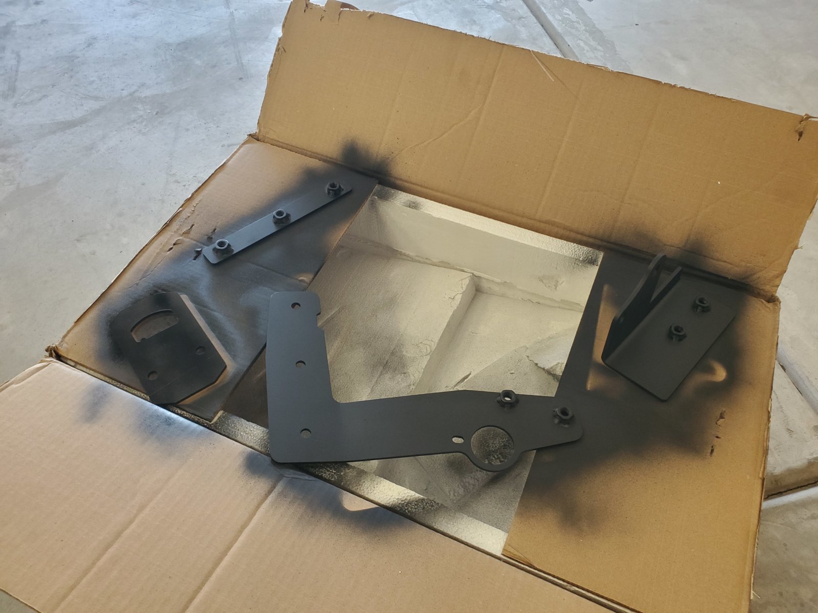

    4 run, 2 don't
    Picked up the pooch from the vet.
    Got a light coat on the parts which I'll let dry until the hardware gets here.
