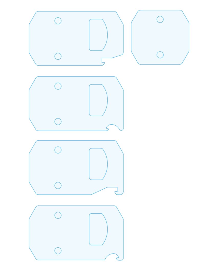

    I'm not in range to bring you a beer, but the 4WP opener is hardly compatible with a standard long neck bottle and the bed mat. The cap pops and bends slightly, but the bottom hits the mat before the top releases.

    Second is more likely to draw blood. I’m also one of them… when I start seeing blood on parts during an install… I know it has happened yet once again. I do carry spare bandaids… the fabric kind.

    They can both equally draw blood, and I posted those pics to get opinions but think about where it's installed.
    I see a lot of sharp-edged clamps, mounting/tie down points, and other attachments on truck bedsides and on those factory rails.
    In other words, there's probably something sharp already there but because we know it's there, it's a non-issue. The opener will face towards the cab, versus an item that sticks out towards the center of the bed which is way more prone to catching something and drawing blood.
    Just my theory anyway.
    If I'm wrong, it's why I ask you guys :D

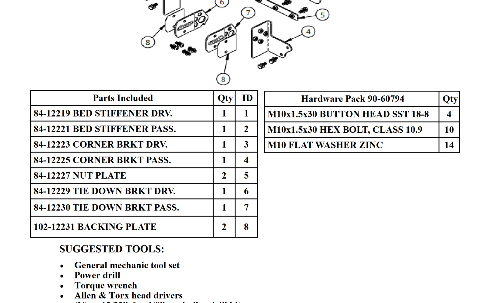

    @Kwikvette
    I’ve had some other stuff sitting in my McMaster-Carr basket for a while, and just want to verify I have the hardware list correct.
    These will need 14 count m10 1.5x30mm bolts but all of the nuts are welded on? I’m sure I can source zinc washers locally.
    I swear I looked at the instructions before posting this, I just struggle to visualize how things go together until I am physically holding the pieces… Thanks in advance!
    Also just a note on post #1: Under purpose it lists m8 for hardware, and then under hardware it’s m10. I know this is a work in progress, that you were initially looking at m8 and also that this won’t be an issue in the future when you are shipping SS hardware. Just wanted to point it out.

  13. Jul 17, 2024 at 9:13 AM
    #293
    tacotroy17
    tacotroy17 Well-Known Member

    Correct, I listed it all on the first page -
    14 x M10 x 1.50 nuts get welded onto specific parts so a buyer only needs to concern themselves with bolts if they opt out
    For those wanting hardware included, either 14 x M10 x 1.50 x 30mm hex head bolts will be provided, or 10 x M10 x 1.50 x 30mm hex head, and 4 x M10 x 1.50 x 30mm button head bolts will be provided
    The directions themselves list M10 hardware.

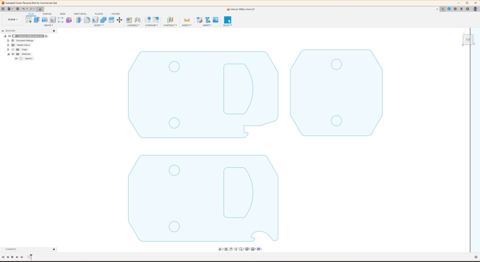

    The only mention of M8 at all was if you specifically went through Send Cut Send as I created a quote myself utilizing bends and adding hardware. It didn't provide an option for anything larger and the nuts I chose were the cheapest available at $2 something each. They have some for $8 - $12 each.
    This way a person knows what they could spend if they decide not to go this route as I posted, I'm doing this from a garage on basic tools. Don't have a CNC laser table or industrial press brake :spending:

    @musicisevil
    Also as far as how they go together, posted on the first page but here again if you're wondering how exactly.

    Added two more, but with the opener facing the opposite way.
