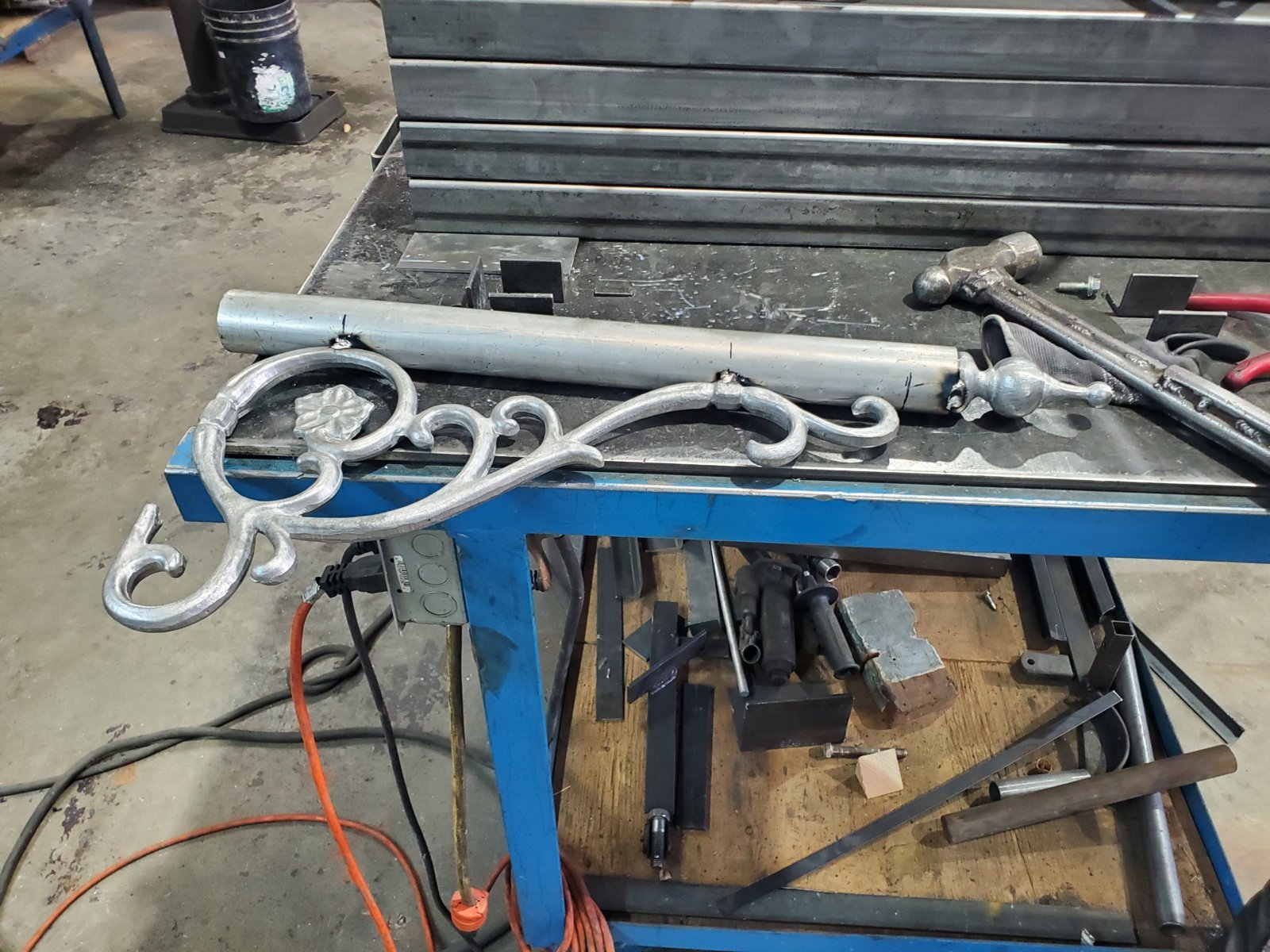

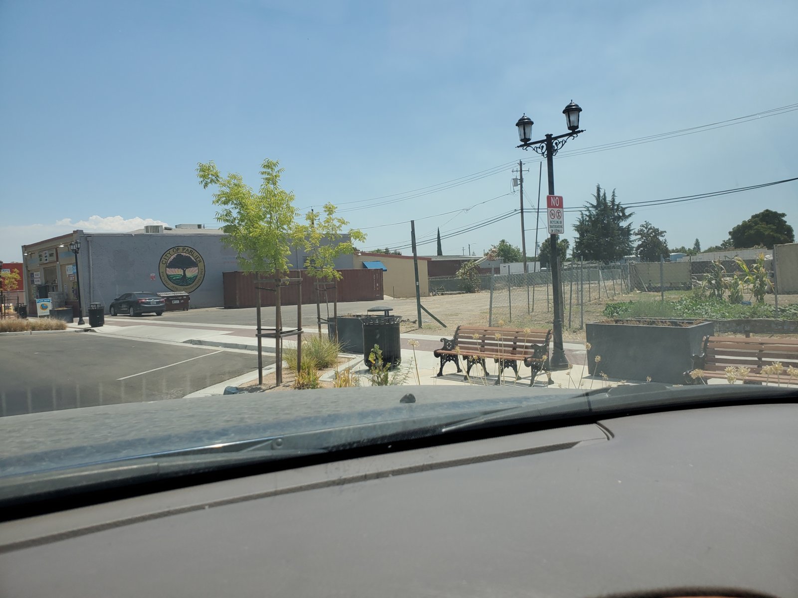

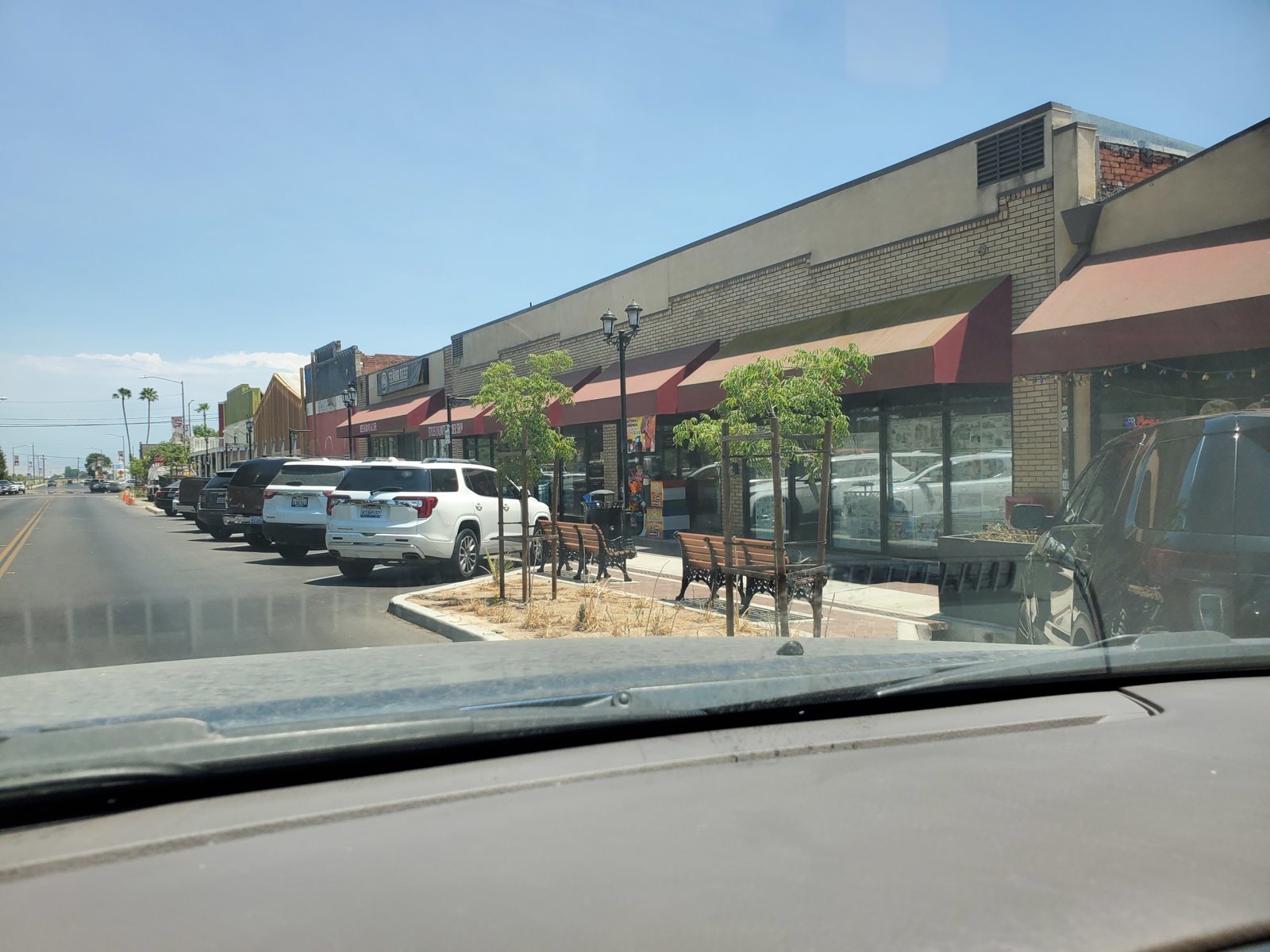

    Just a small derail :burp:

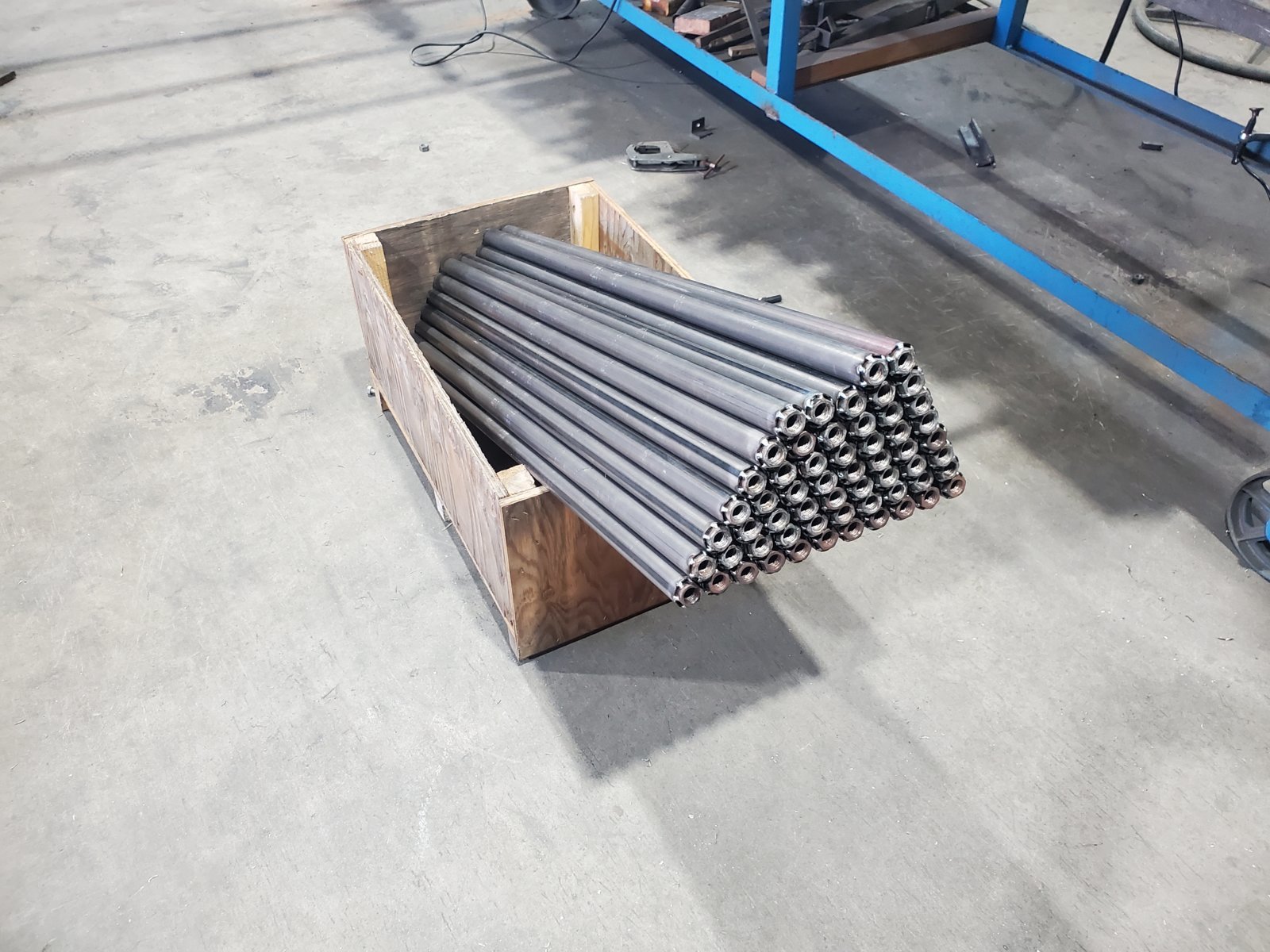

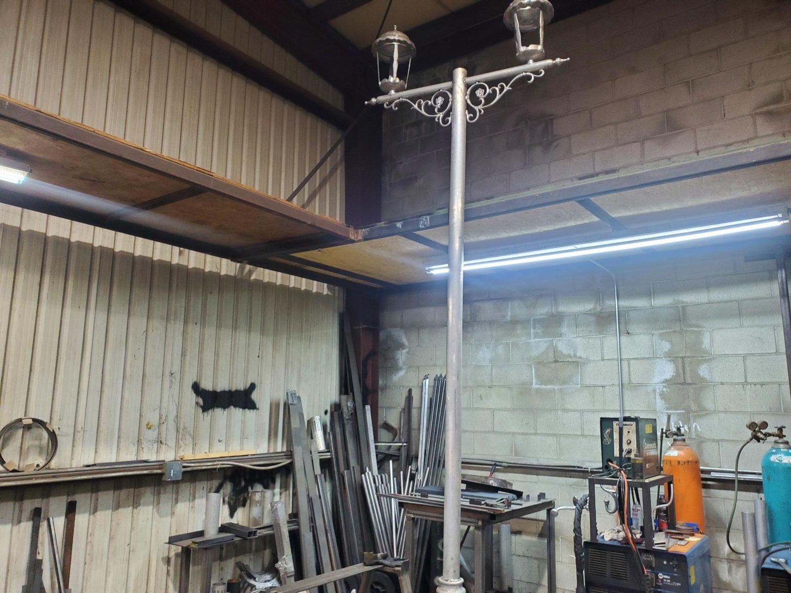

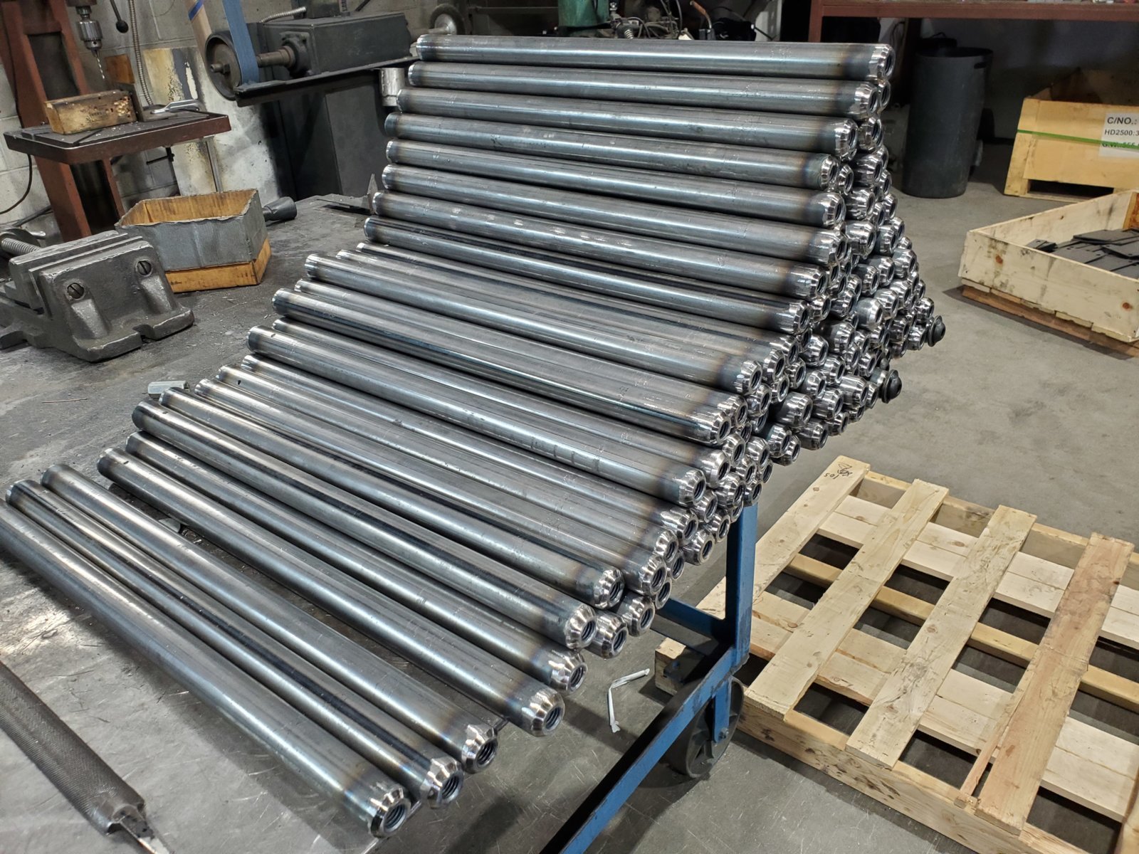

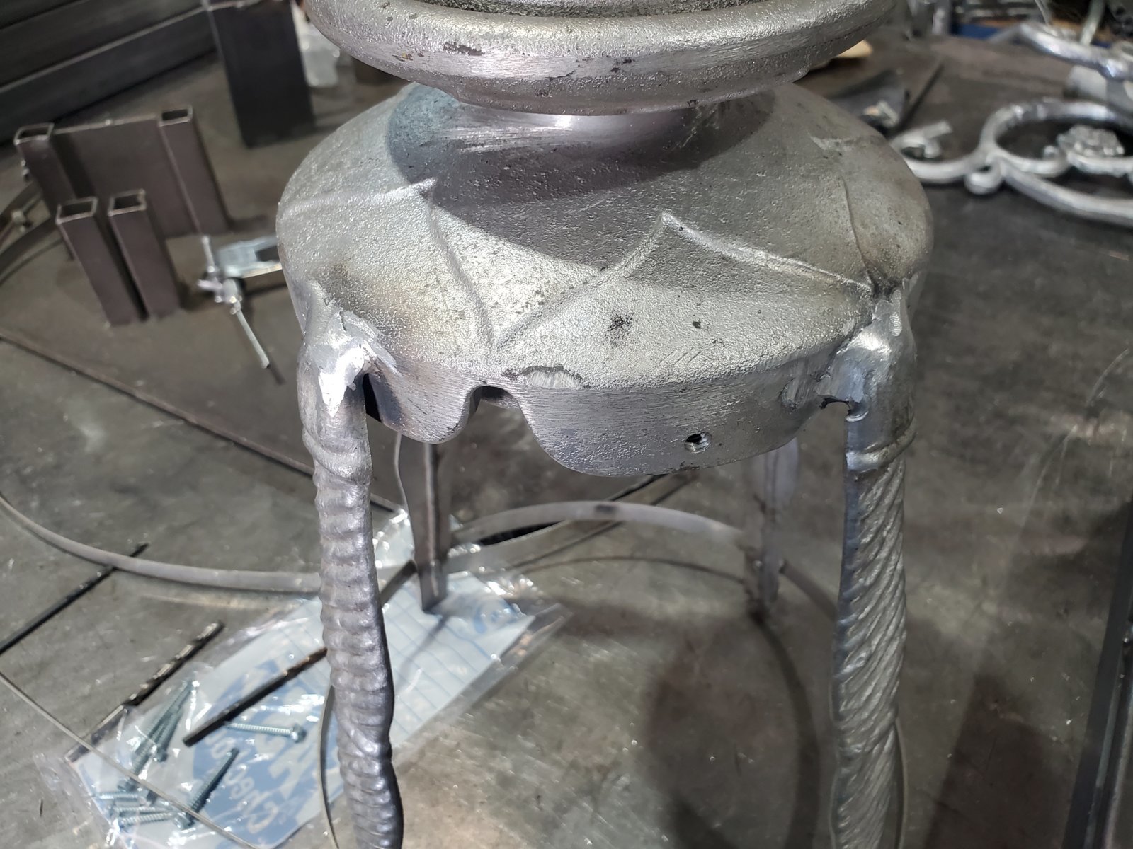

    Went to get a haircut earlier today, after dropping off that package.

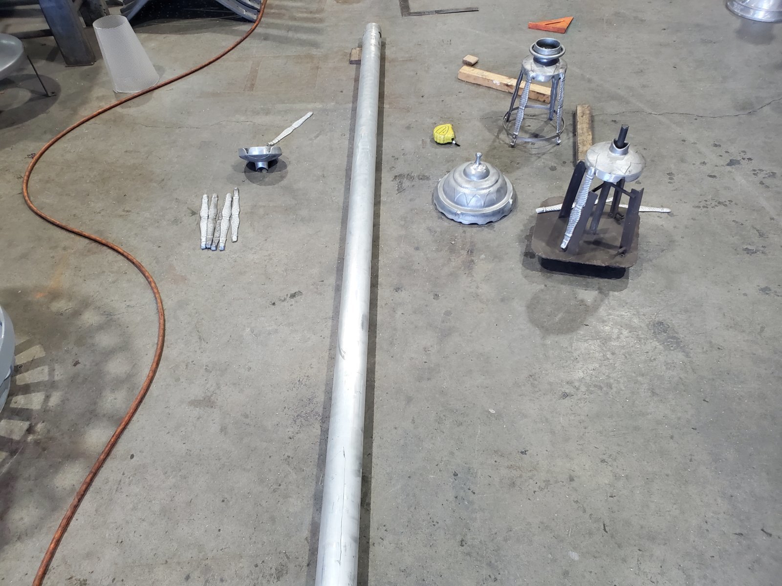

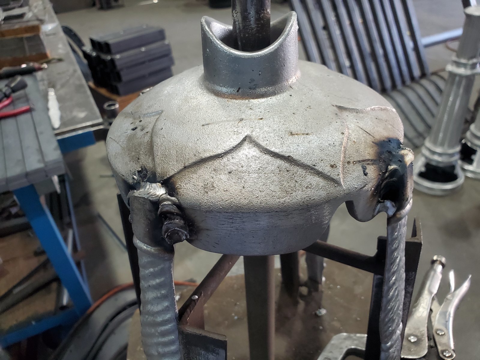

    I love seeing some of the stuff I've made out in the real world - this is stuff I made at the first fab shop I worked at.
    When a member here mentioned weld nuts, I was already familiar with them but because my boss was a cheap ass, I made my own jig to weld nuts centered on tubing for benches we made.
    The light poles only sucked cause I'd have to prop them up and get them as square as I could before welding them :bananadead:

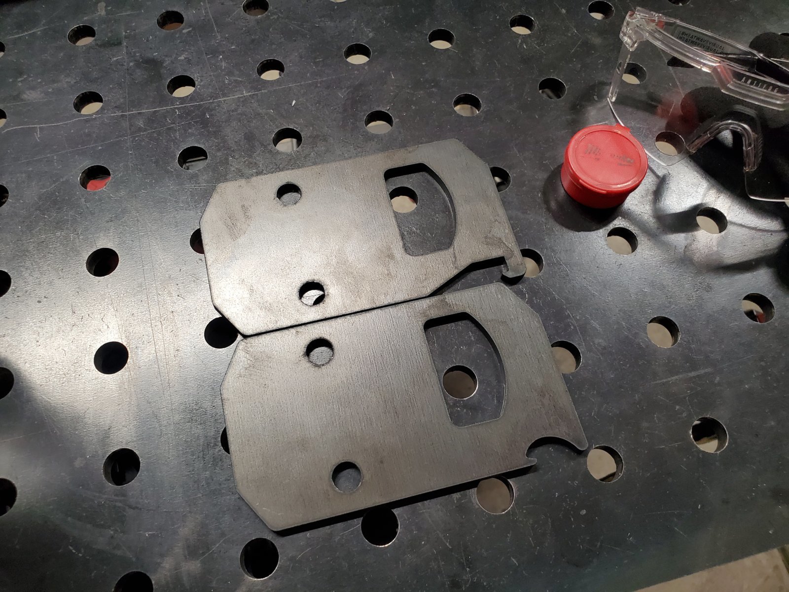

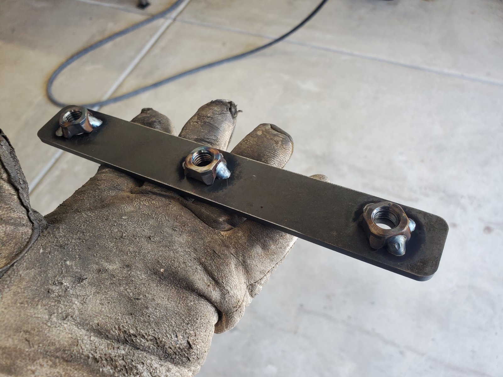

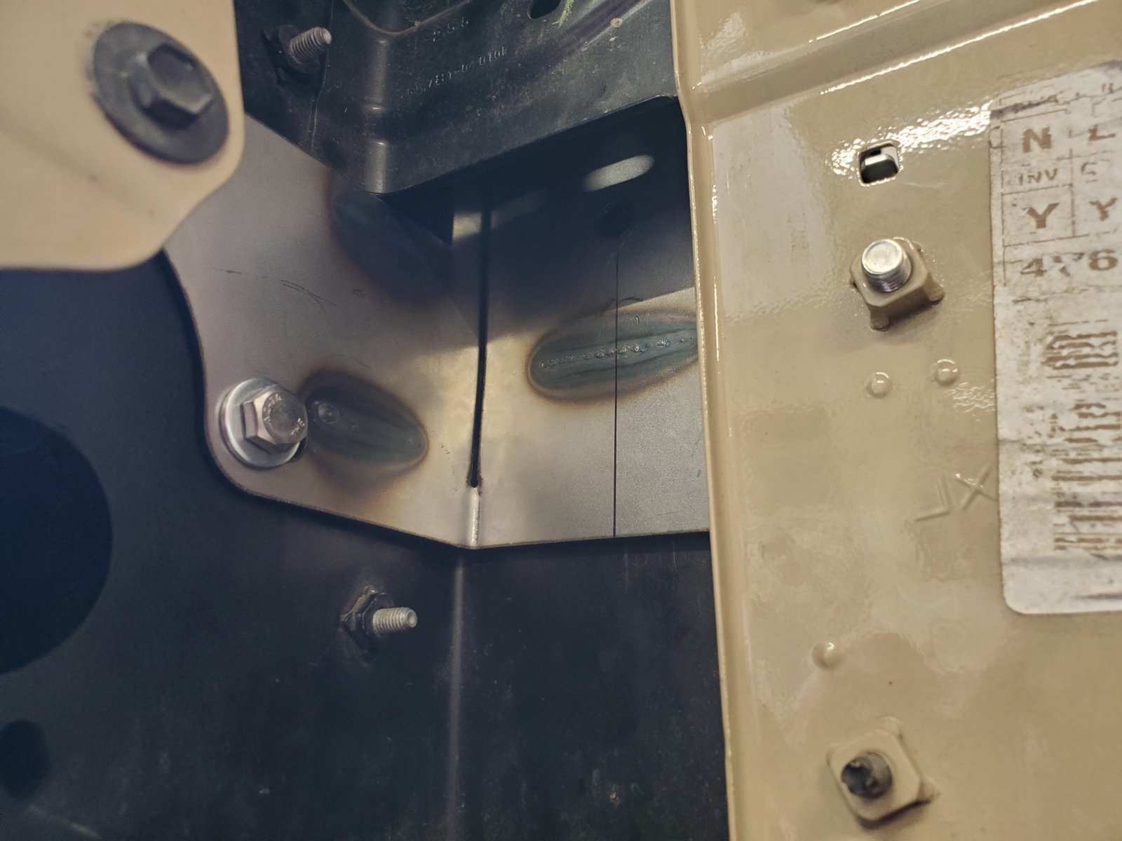

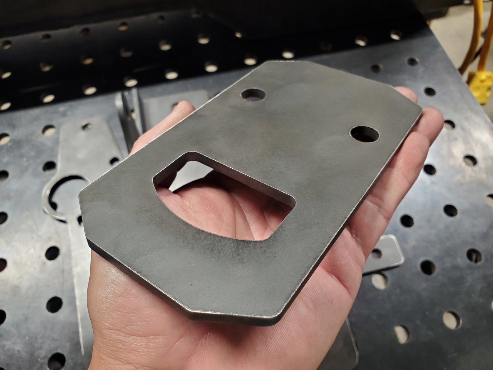

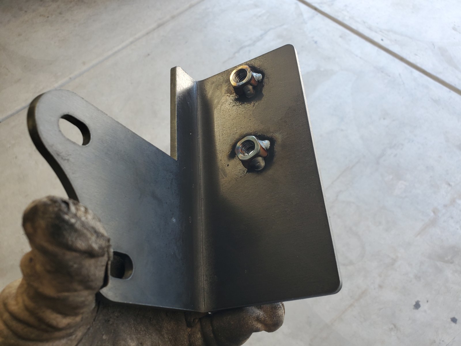

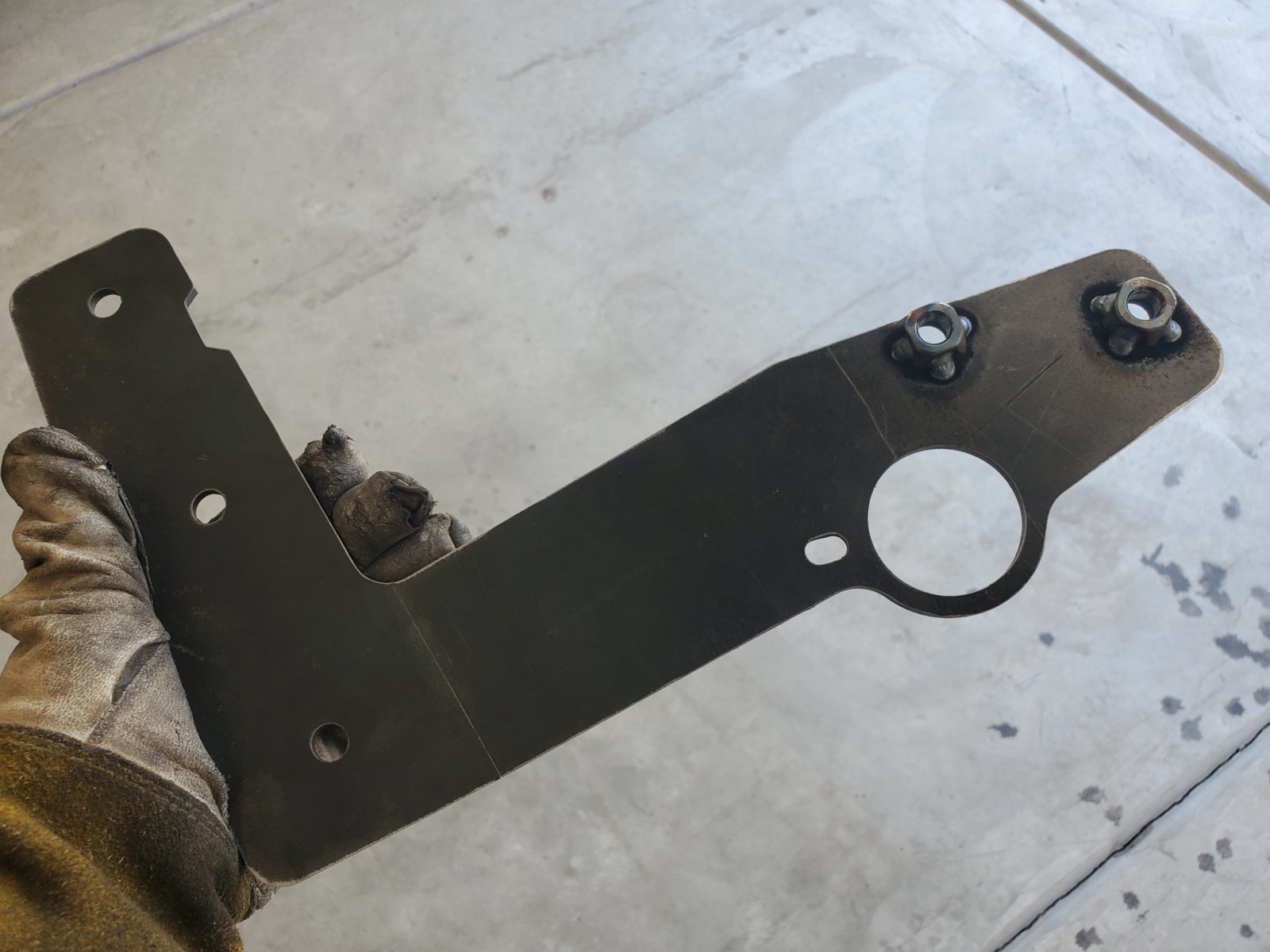

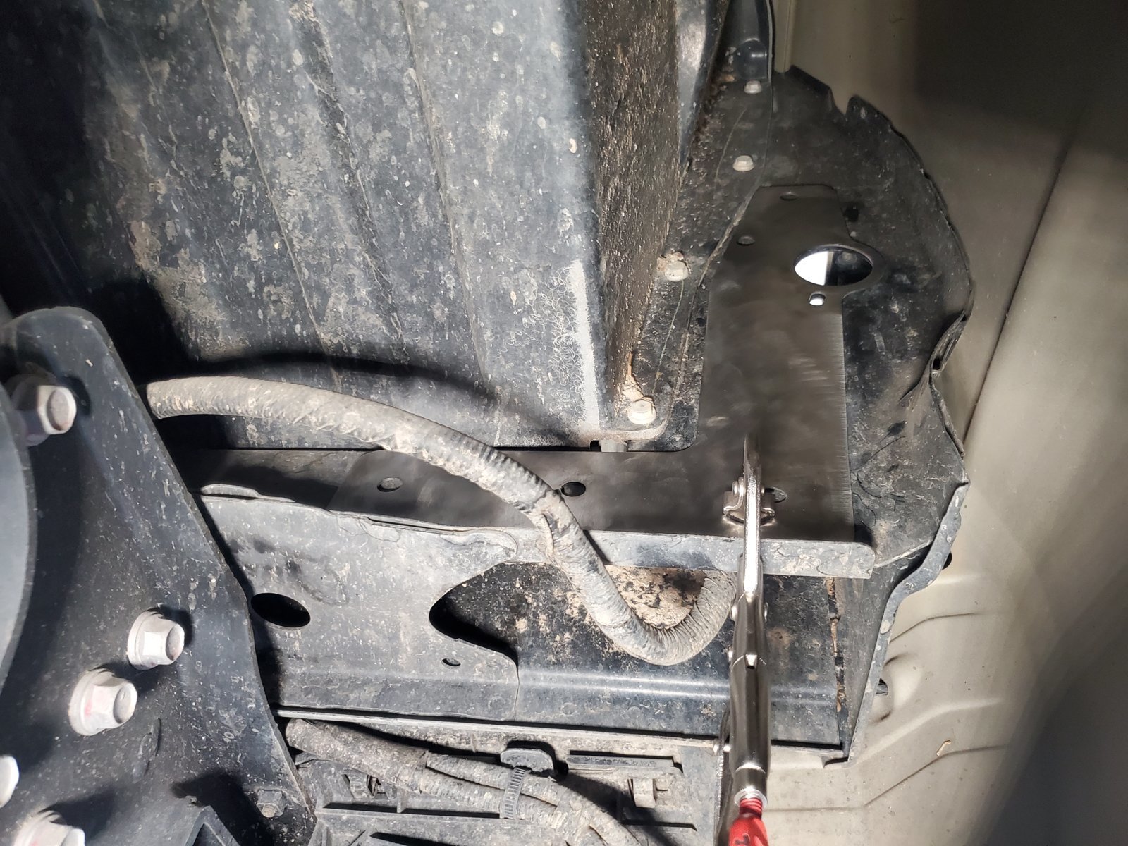

    The internal component shown here, goes behind the tail light housing.
    The large L bracket component shown here, goes on the opposite side as shown here from underneath (in front of the rear tire). The top two holes will be used to mount with the internal component.
    The skinny bar shown here, mounts on the other side where my clamp is which acts as a clamp and reinforcement to the L bracket.
    Lastly, the exterior bracket shown here (multiple) go in the bed itself to sandwich the internal component that you placed inside the tail light housing.
    Some will choose plain (smaller version) while others will choose a tie down option only, or both a tie down and bottle opener option.
    Refer to the very first page of this thread for mock up and install notes!
