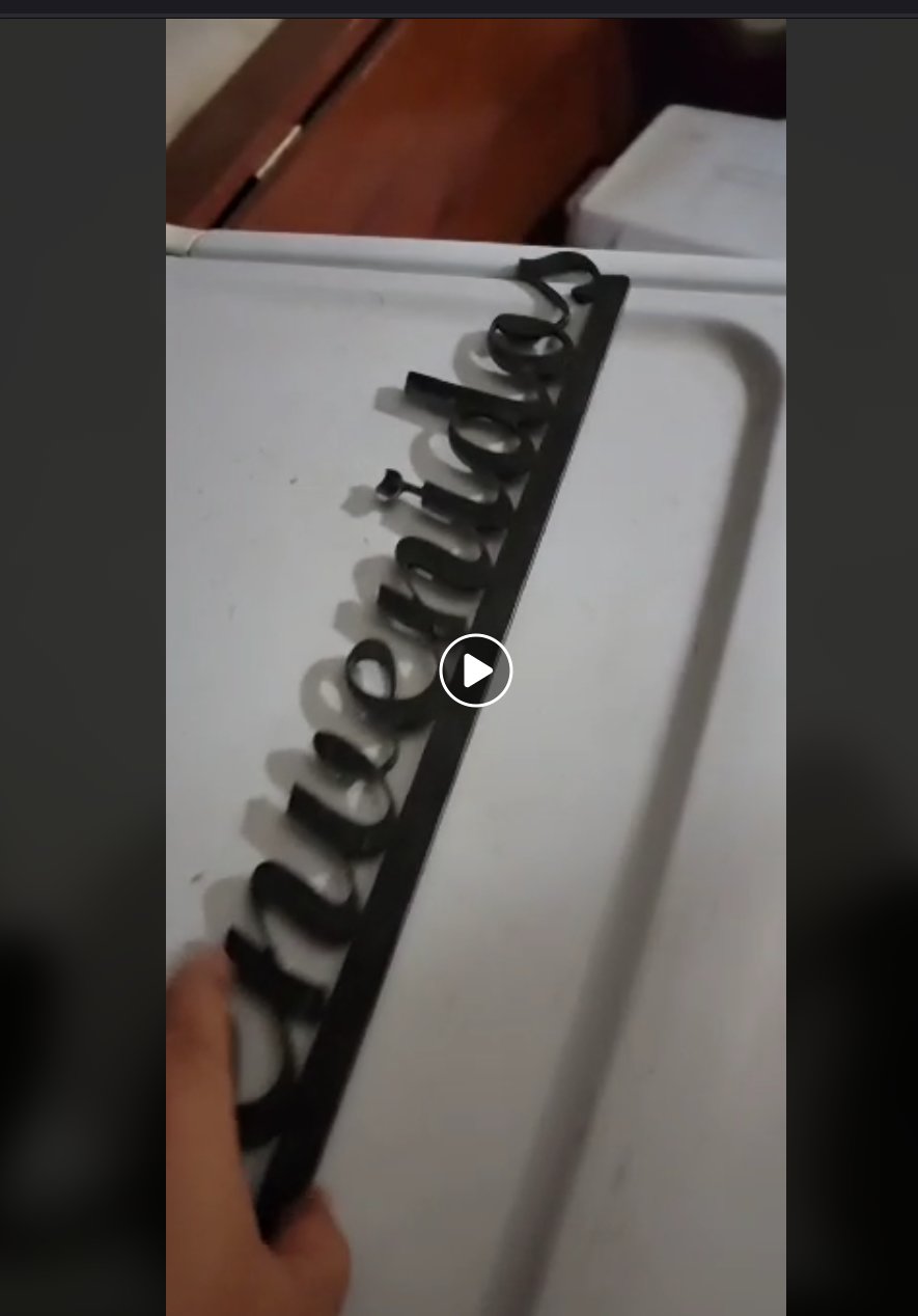

    I'm on the PC doing some CAD work - one of my customers is actually from Honduras. In fact, I do side work (whether CAD or video meetings) to a few customers on Zoom and Facebook hence why I reply here often and quickly.
    I clean up and make his files cut ready or make him some simple stuff. Even now at 11pm he's still cutting.
    He just cut this now.
    It's a screenshot cause he doesn't type much if at all. He does voice messaging or video's :rofl:

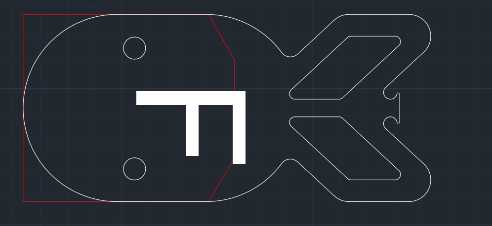

    3d printing is more accessible than CNC plasma cutting. Once we get a final tie down I will post the file, if people have access to a printer, they can print it themselves. I'm willing to print for those who do not have printers. I've never sold prints before, but I can figure out time and materials on the machine.
    It probably does make sense once @Kwikvette gets past prototype and fitment stages for me to send them to him and he can ship it with the steel if he is willing to.
    @Kwikvette, do you feel like the single layer is enough? From memory it's about 0.325" with a radius for the rope or strap, which seems like enough for rope being used to tie down loads in a Taco. It is possible to make the plastic the bread in a steel sandwich, to get more rounding, but that feels excessive to me.

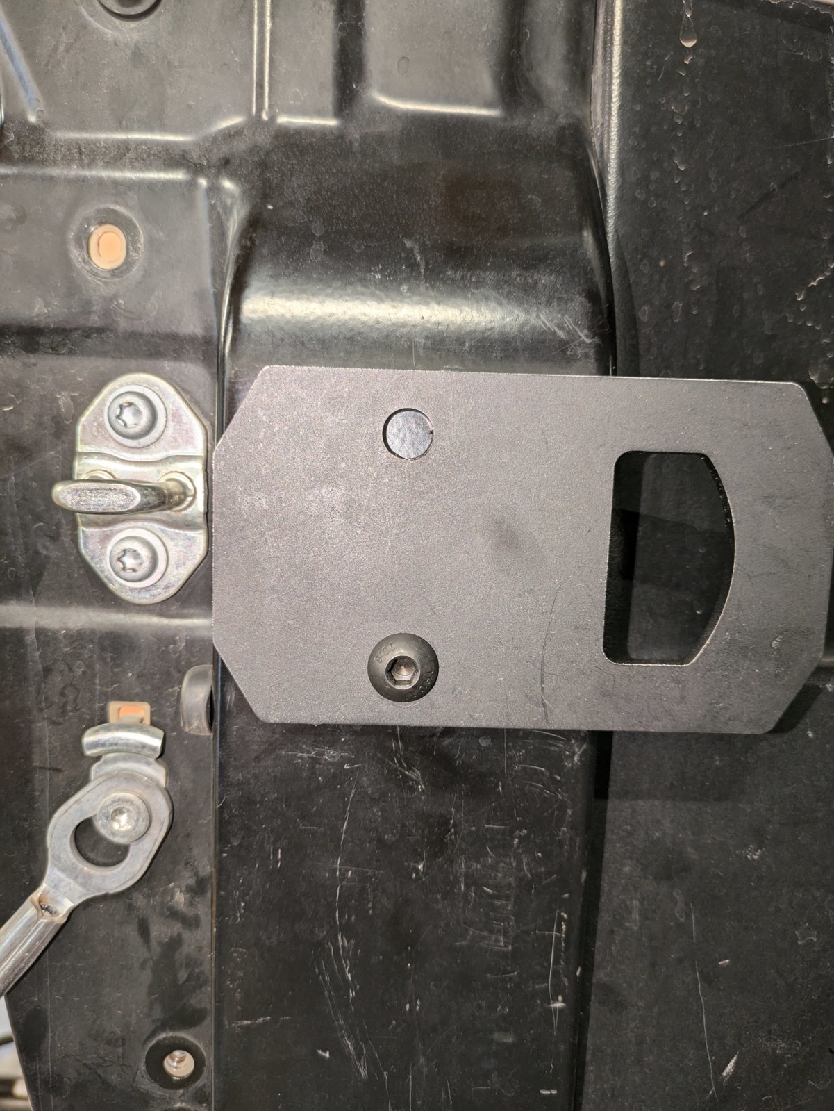

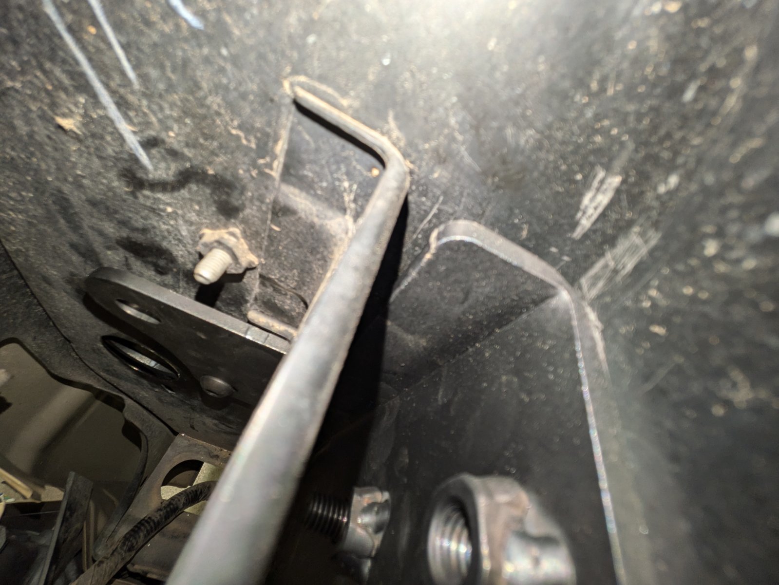

    @Kwikvette dmed. Looks like sizing up the steel make for slight discrepancy in fit.
    Plate in bed is correct, however the plate that butts up to that (L bend) need to have the holes moved over as shown in measurement.

    Bending the L plate out a little bit would probably be a band aid fix for this, however fire sets likely need to have nuts more towards the tailgate by the measurement I sent.
