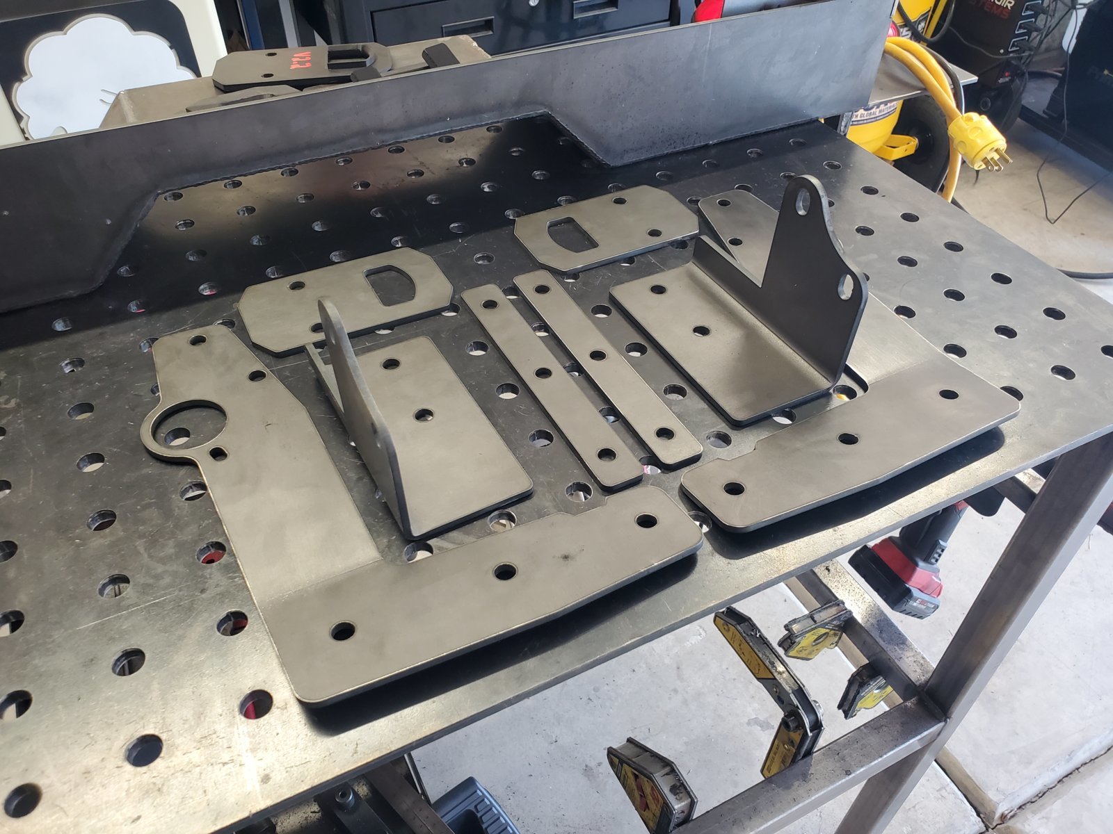

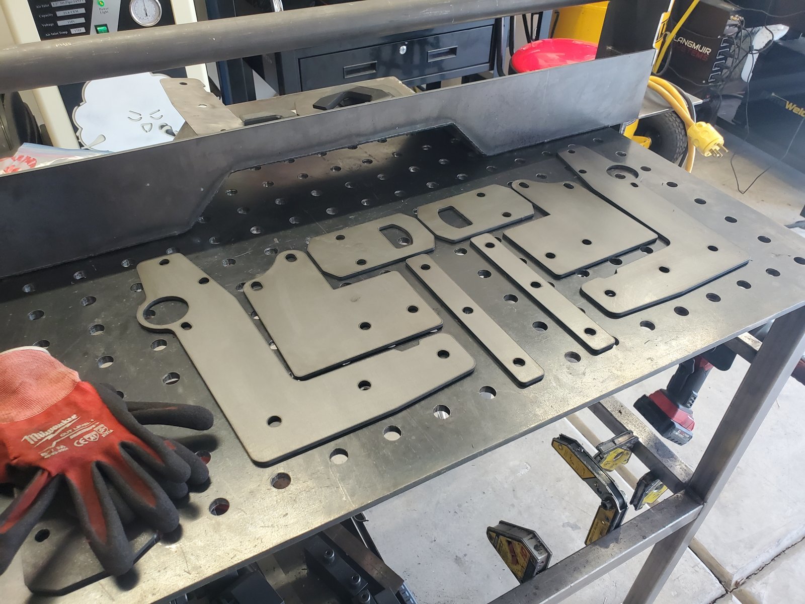

    I'm so confident in the adjustment that I went ahead and used the last bit of 3/16" I had to cut a complete set.
    Going to bend the necessary pieces, weld on nuts, and send the passenger set (along with driver internal bracket) for final fitment.
    This should be it.

    When you see the "kit" in its entirety it's like 'got damn she's thicc' :rofl:

    I was looking at the pics of the parts on page one (that you currently have), and then back to the latest set I cut earlier, and you can tell now how much closer the new holes are to the edge (towards the tailgate).
    Also, not sure if I posted it here but I enlarged the holes on the exterior bracket another hundredth of an inch.
    I'll be sending you a bottle opener exterior bracket if you want to have one on your driver side.

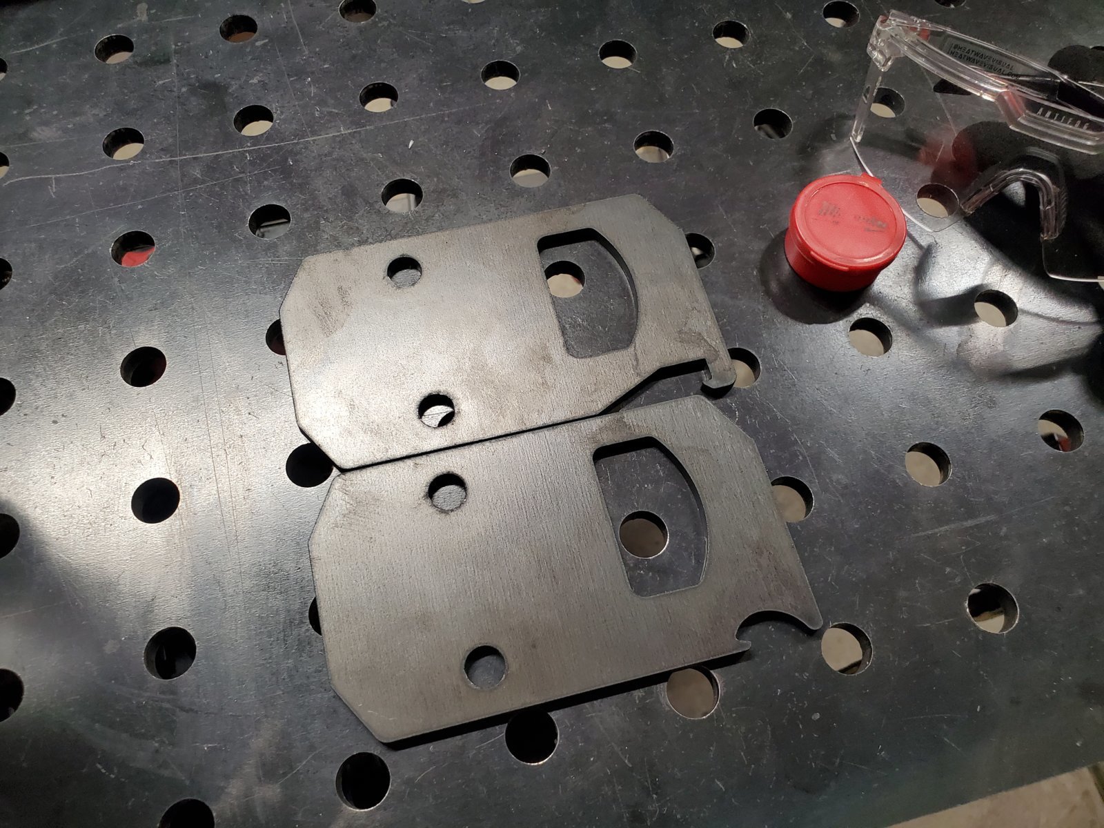

    You really need to just hold one of them.
    Having a bottle opener or not, does not affect structural integrity whatsoever.
    Not sure how to emphasize it's strength...being someone that messes with metal on the daily.
    Do you have an aftermarket bumper? Or sliders?
    Just about any and all aftermarket, off-road bumpers are made of 3/16" steel. Sliders will use mounting plates, even gussets, out of 3/16" because it's so strong.
    But you could be right about the bed not needing to be sandwiched. I'm sure it helps though, seeing as how that's how it's designed. It's really more about bolting the internal bracket to the bed itself though so I'm not sure I'd trust bolts alone to secure the internal bracket to the bed.
    So if you opted for something cleaner you could just go for the plain exterior bracket with no tie down and no bottle opener like so.
