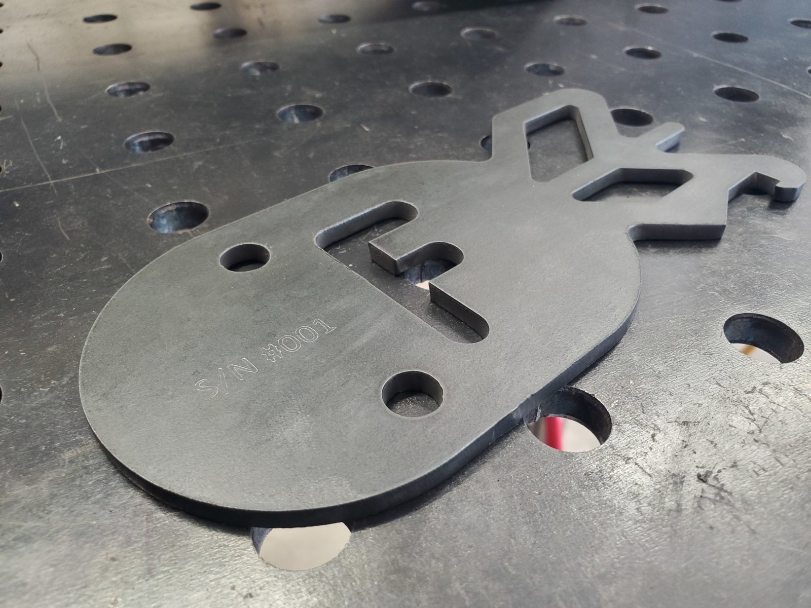

    Imagine if there was indeed a custom, single-release, exclusively limited edition F bomb release with serial number? :rofl:

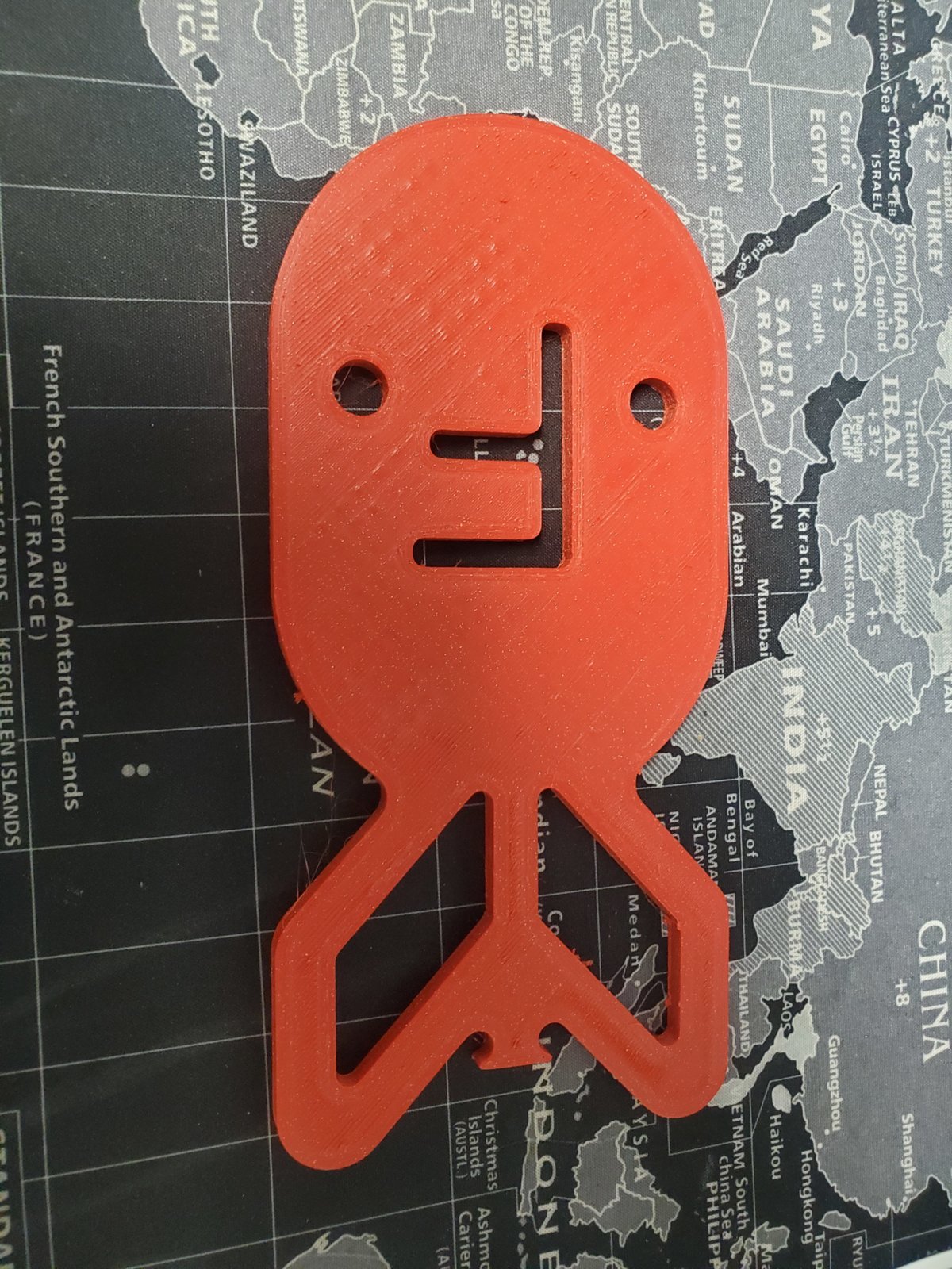

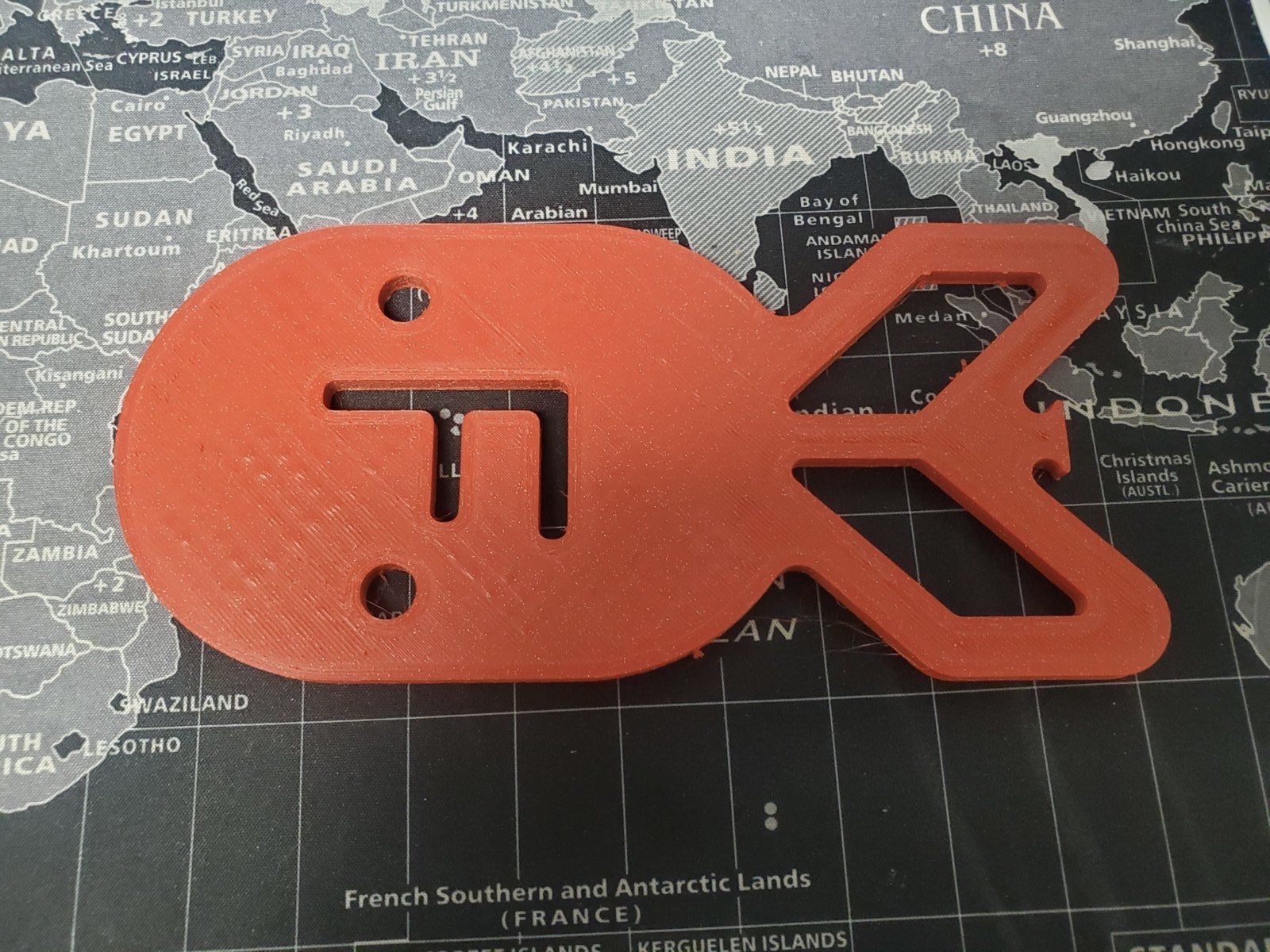

    OMG, that's WAY cooler than the one I 3D printed to see if the tail geometry worked to open bottles!
    I gotta buy a 12 pack, (I'm a cider guy, not beer) to see if there is any possibility of it working.
    Crap, no way to rotate the pic.

    Takes too long :rofl:
    In short, the process requires running two CAM programs - one for engraving and one for cutting.
    Need to swap out tool heads for each program.

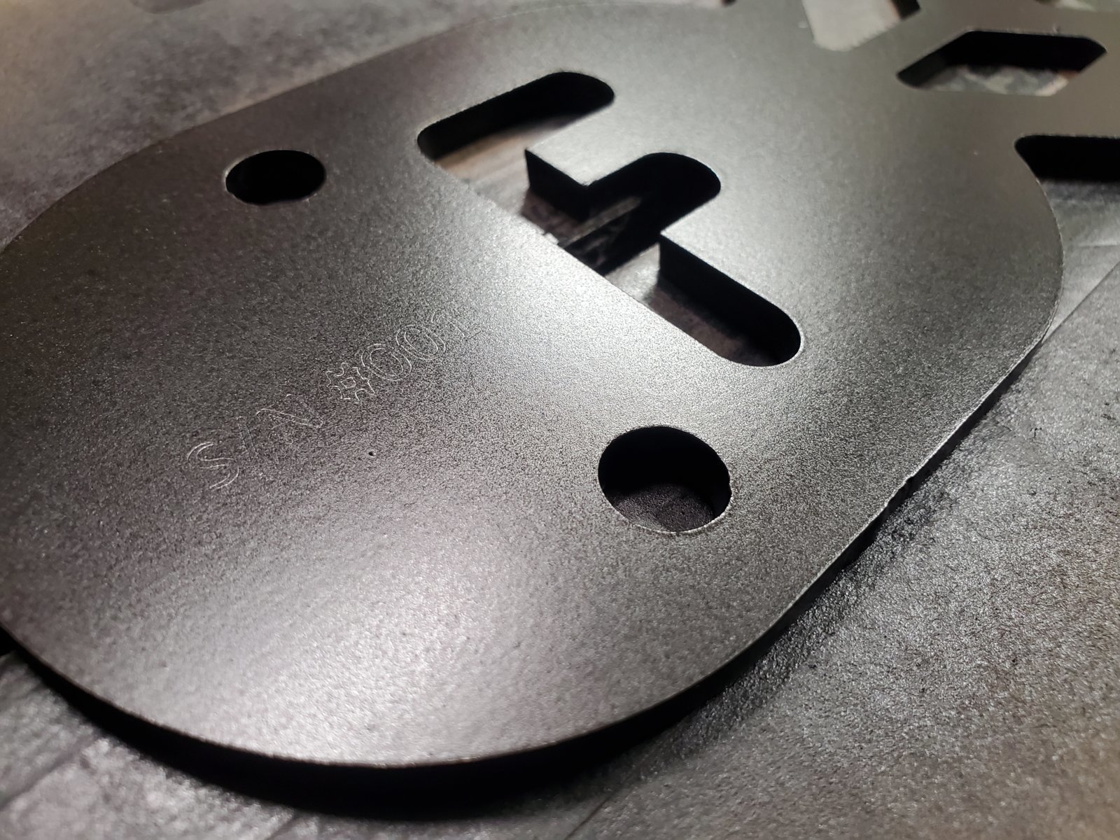

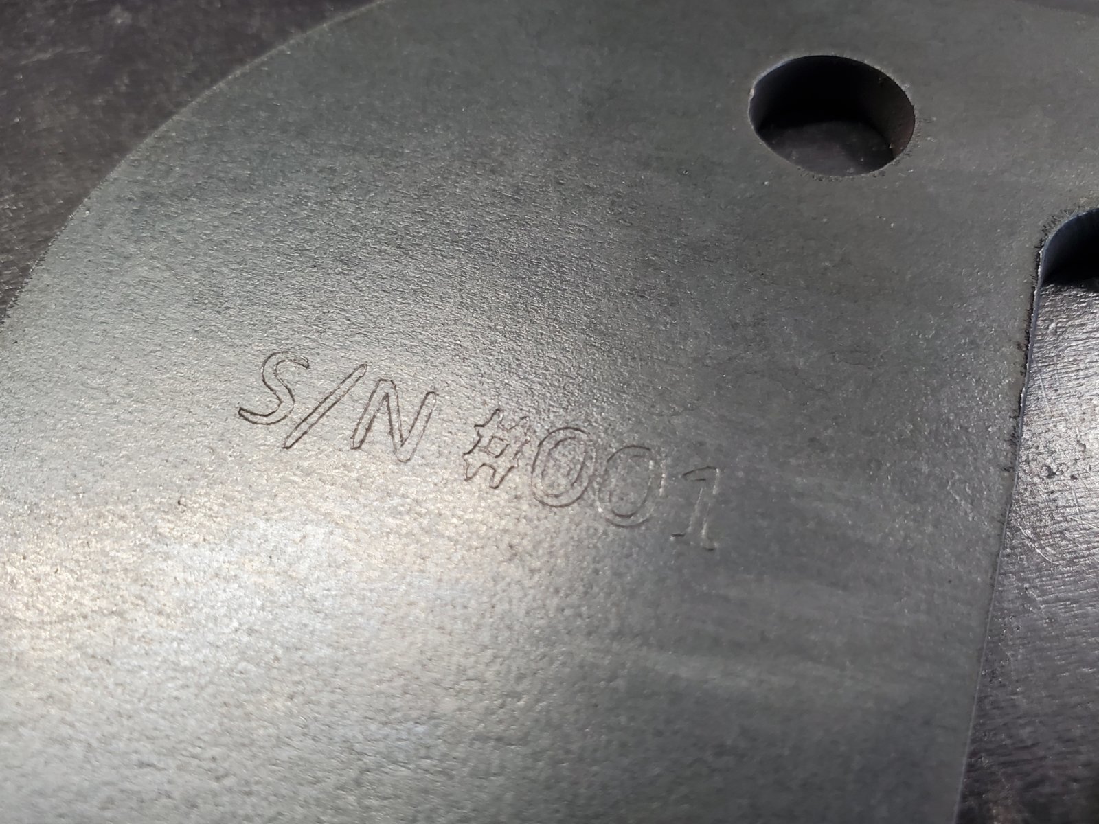

    Real talk, I did that in jest.
    Unfortunately, scribing is far different than actual milling as the tool only scratches the surface of the material.
    Had this been something like aluminum, the scribing would most likely be much more noticeable especially since no additional coating will be needed.
    But on steel, it is only noticeable on a raw, unpainted surface. Once painted, the scribing is pretty much gone.
    The only way to get something like this to stand out on steel would be to paint or powdercoat said item first, then scribe whatever you plan to put on it followed by coating it with clear.

    Here you can see what I mean. Light coat of paint+primer in one and it's just barely visible.

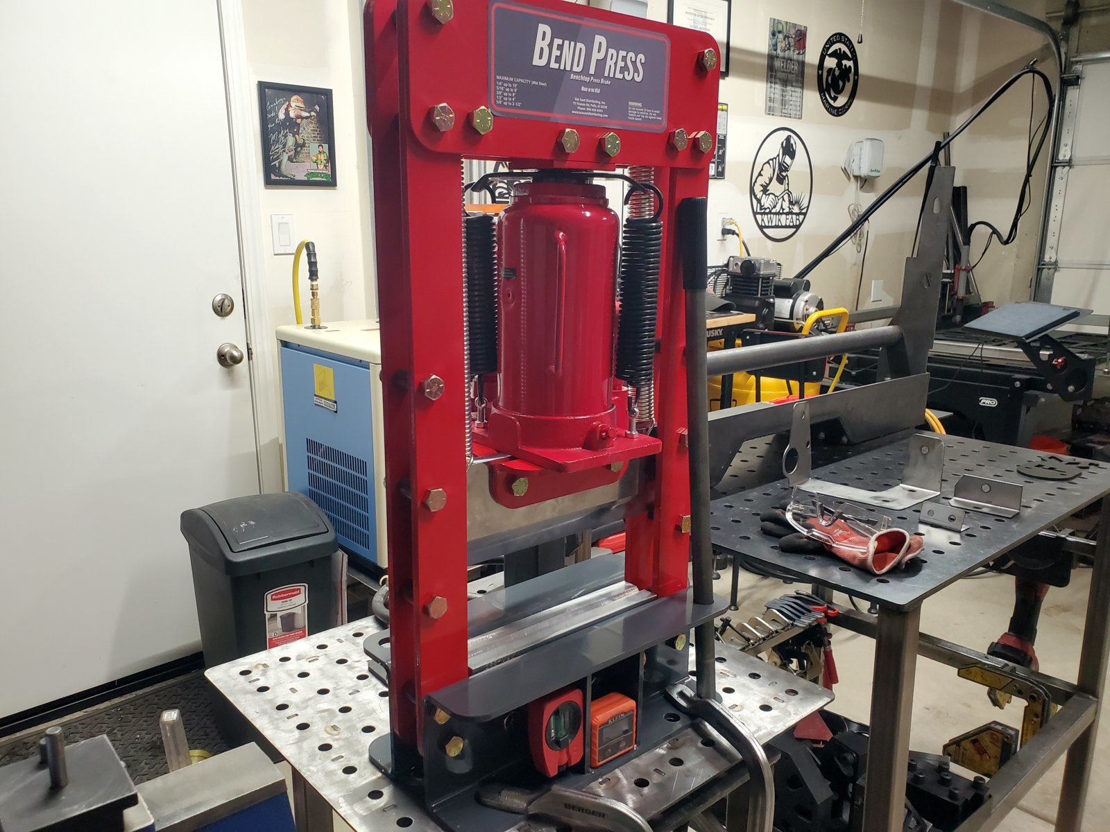

    Have to say, even manually jacking this thing it moves quite a bit more than the one I had temporarily set up.
    https://youtu.be/aCBkTi2Utg8?si=ak_YFp5Fz2G1MYEN
    Ready for production!
