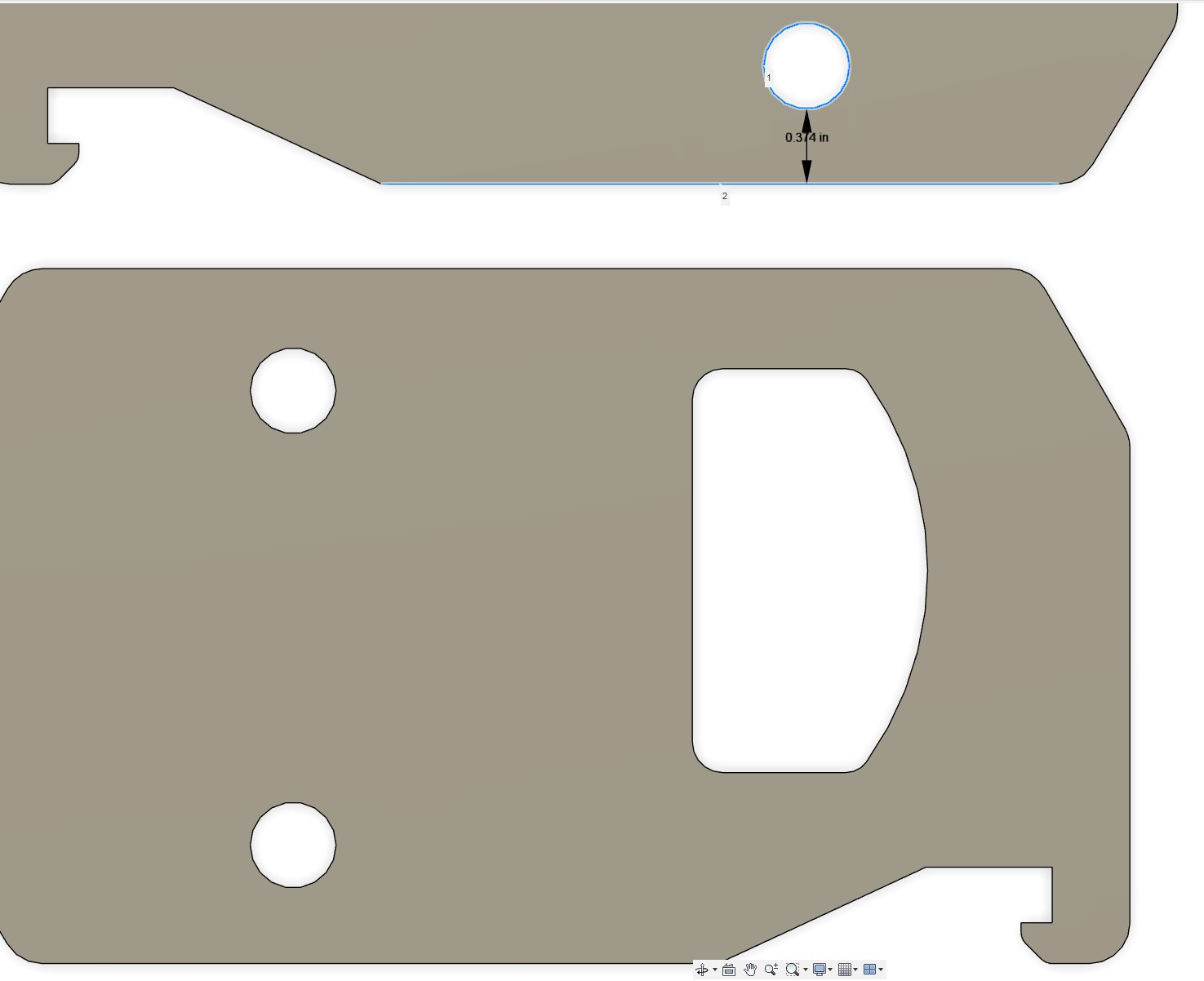

    :eek: OMG...
    I just checked. The bottle opener plastic is indeed a drivers side! :jellydance:

    So regarding the holes, the tiny difference in spacing from the edges, was because I assumed the holes in the original drawing were centered in relation to the bracket itself.
    But no, the hole closest to the edge is always at the bottom like shown here with the openers.
    To make things easy, I'm keeping things as is.
    I don't think anyone will notice 0.018"

    Well dang! I didn't check that dimension - and I'm glad you pointed it out now!!! Both of the plastic parts are drivers side! Gotta go play with the mirror command in AutoCAD
    NoOne, ERod27 and Kwikvette[OP] like this.

    Having stared at these for a few minutes, and knowing that here is a difference, I can see it. I'd recommend some sort of labeling of the two if the difference is important.

    When I sent @Sand_In_My_Taco his set, I wrapped the items in packaging paper (to fill voids). It'll be easy to zip tie the 3D printed parts with the corresponding brackets.
    Installed though, you won't see it.
    Place an M10 bolt through it, and snap a picture of it looking at the face of the bracket.
    Then flip it and do it again.
    The bolt hides that .018" difference.
