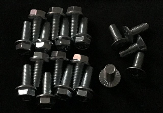

    Gosh darn it, I love me some quality parts.
    These things are nice.

    Are you planning on countersinking the four holes?

    Muy guapo them fasteners.

    Just noticed the bolts you were referring to.
    I wonder what size countersink bit is appropriate for an M10 bolt?
    A 3/8" bit works great for M6 bolts; just used it for my pedal mount recently as I wanted it to sit flush against the garage floor.

    Metric bolts use a different counter sink Angle than SAE.

    What angle would that be?
    I believe I found some to be 82 degrees - I have a 90 degree bit for cleaning stuff up otherwise I'd run more 82 degree bits.
    At $45 to $75 per bit though, it doesn't make sense for me to own multiple :rofl:

    Normally metric are 90 degrees and SAE are 82 degrees.
