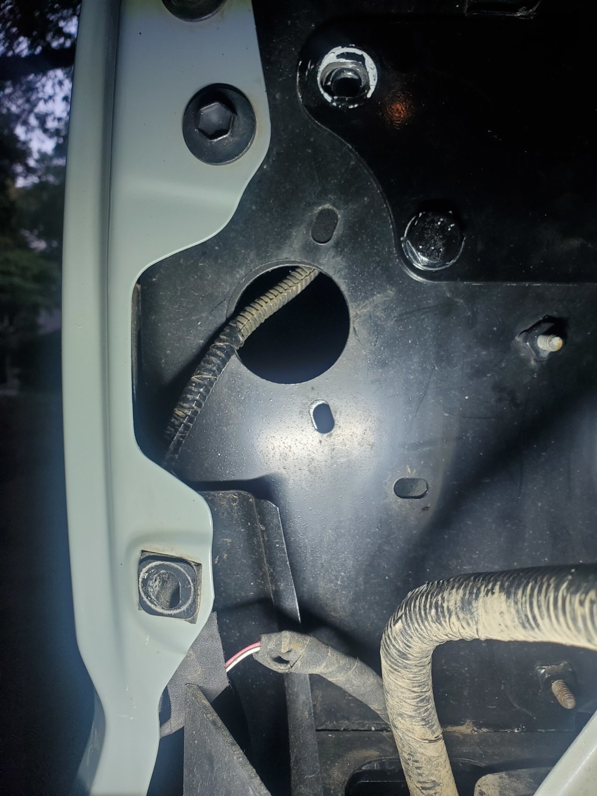

    Purchased Toyota Certified, with Vijay bumpers, additional lights, and Falken Wildpeaks on Fuel rims. Prev owner apparently painted the grill.

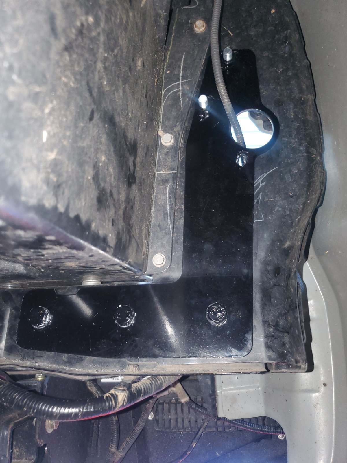

    I agree.

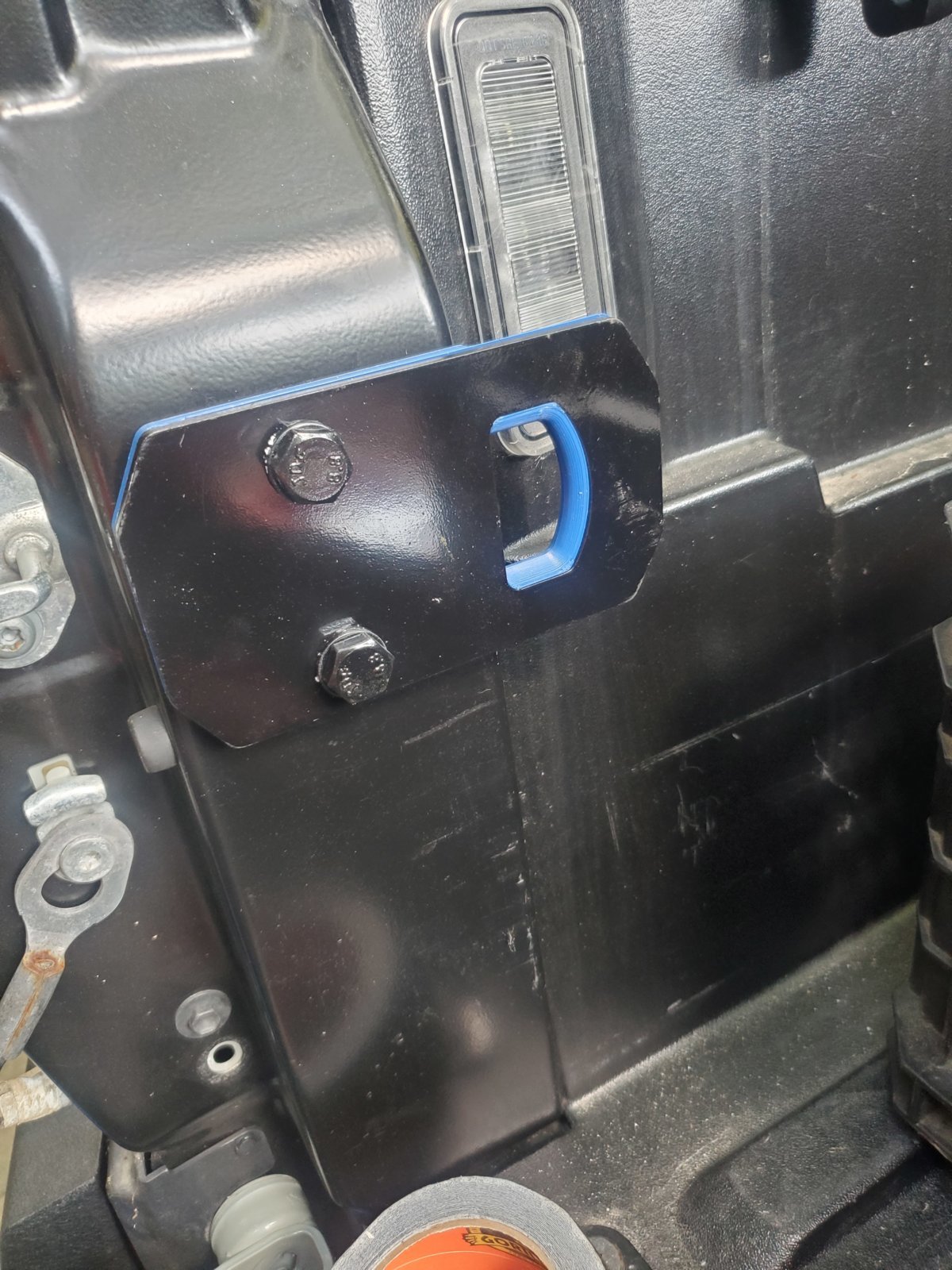

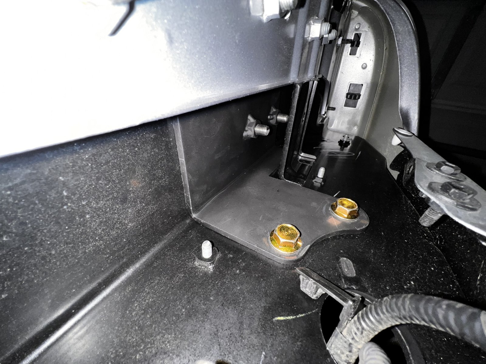

    I'm now home and unpacked, and have even had a chance to play trucks. Some wiggling and opening up the top hole helped. Lengthening the holes in the 90 bracket may be all that is needed.
    Painting the brackets something other than black sure makes the photos turn out better!
    I got the drivers side in.
    I used the blue strap saver so you can see it.
    Need to paint the holes and put some loctite on.
  4. Aug 14, 2024 at 4:43 PM

    Why the heck does it look perfect on yours :rofl:
    Strap saver looks good!

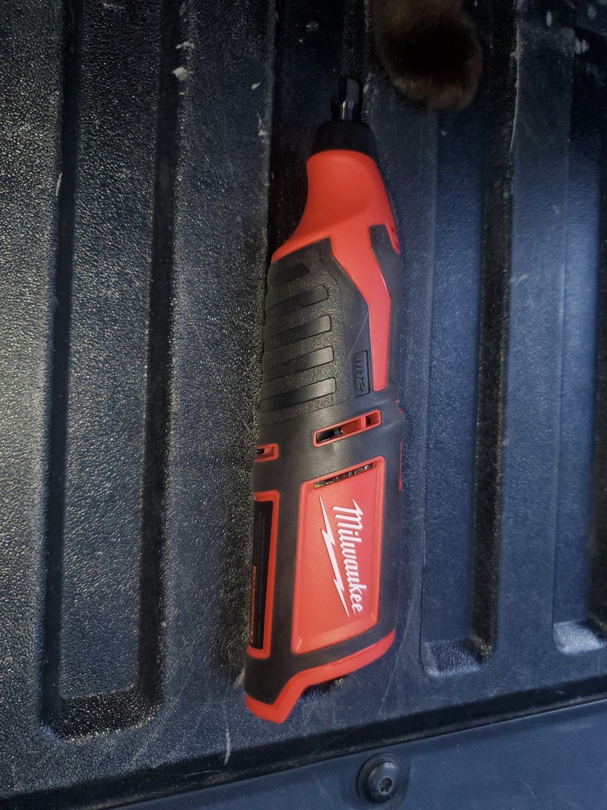

    Because on the way back home, when we stopped to get fuel, the wife saw a "Little bit of Everything" store. She went over while I fueled and even talked Tacos with a local in a blue '23 (if your on here say hi!).
    Wife took a while, so I went over to find her, she and the proprieter came out and told me I needed "these boxes of Ritz crackers and a plasma cutter". Wife had the crackers and dude shows me a Hobart plasma for $1300. I was sore tempted, but there's a lot of other things I need before that.
    But there were a fair number of Milwaukee Cordless tools, so now I have this for 80 bucks.
    I already have a couple Dremel tools, but M12 means I can use it anywhere.

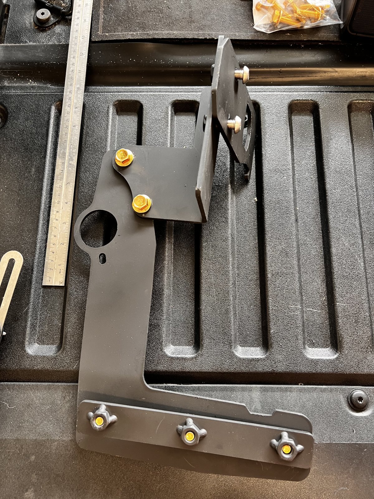

    It isn't quite perfect, the alignment is off just a hair. I think if I could get the top hole rotated just a little more up and in it would likely line up on the money.

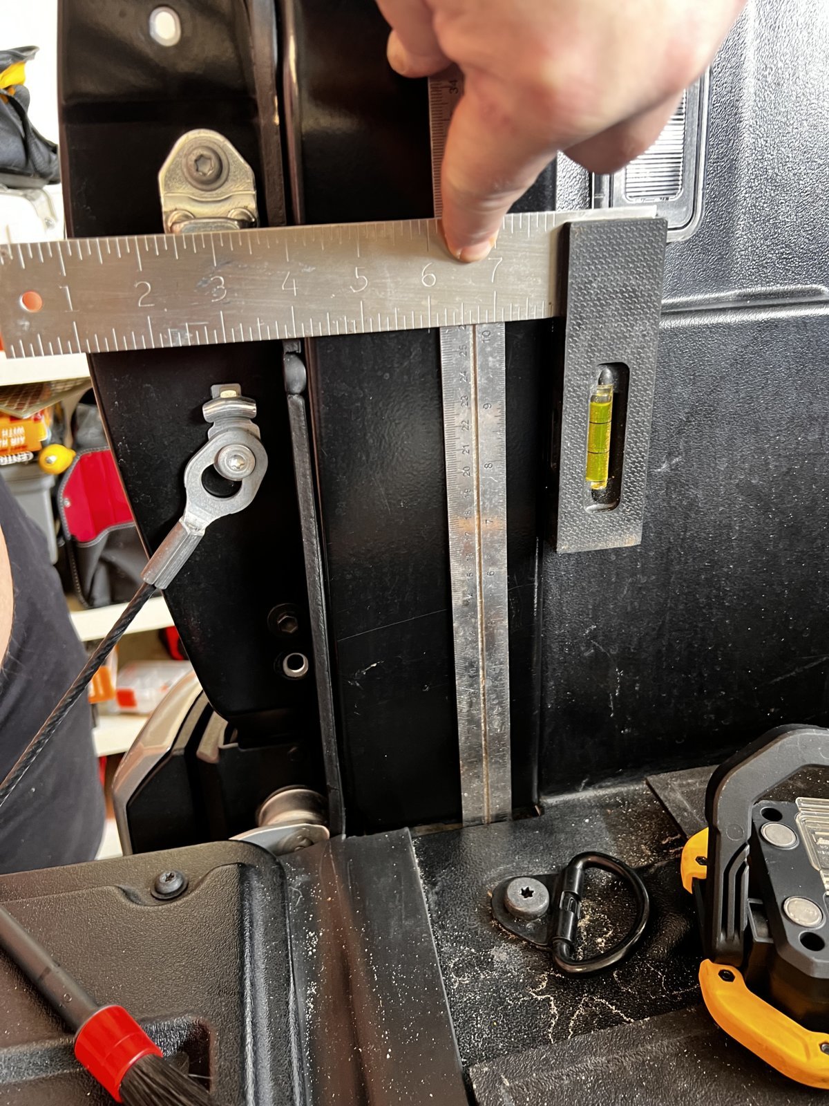

    An install hint:
    Working alone, I found that a longish (4") ¼-20 bolt through the slot hole at 5 o'clock let me hang the internal bracket in place so I could thread the m-10's in without needing a third hand.

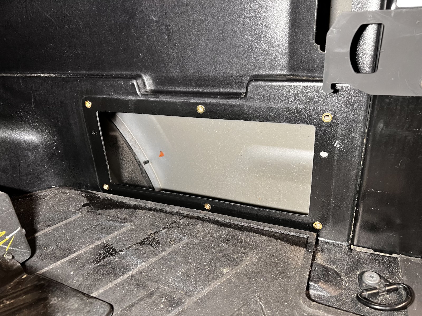

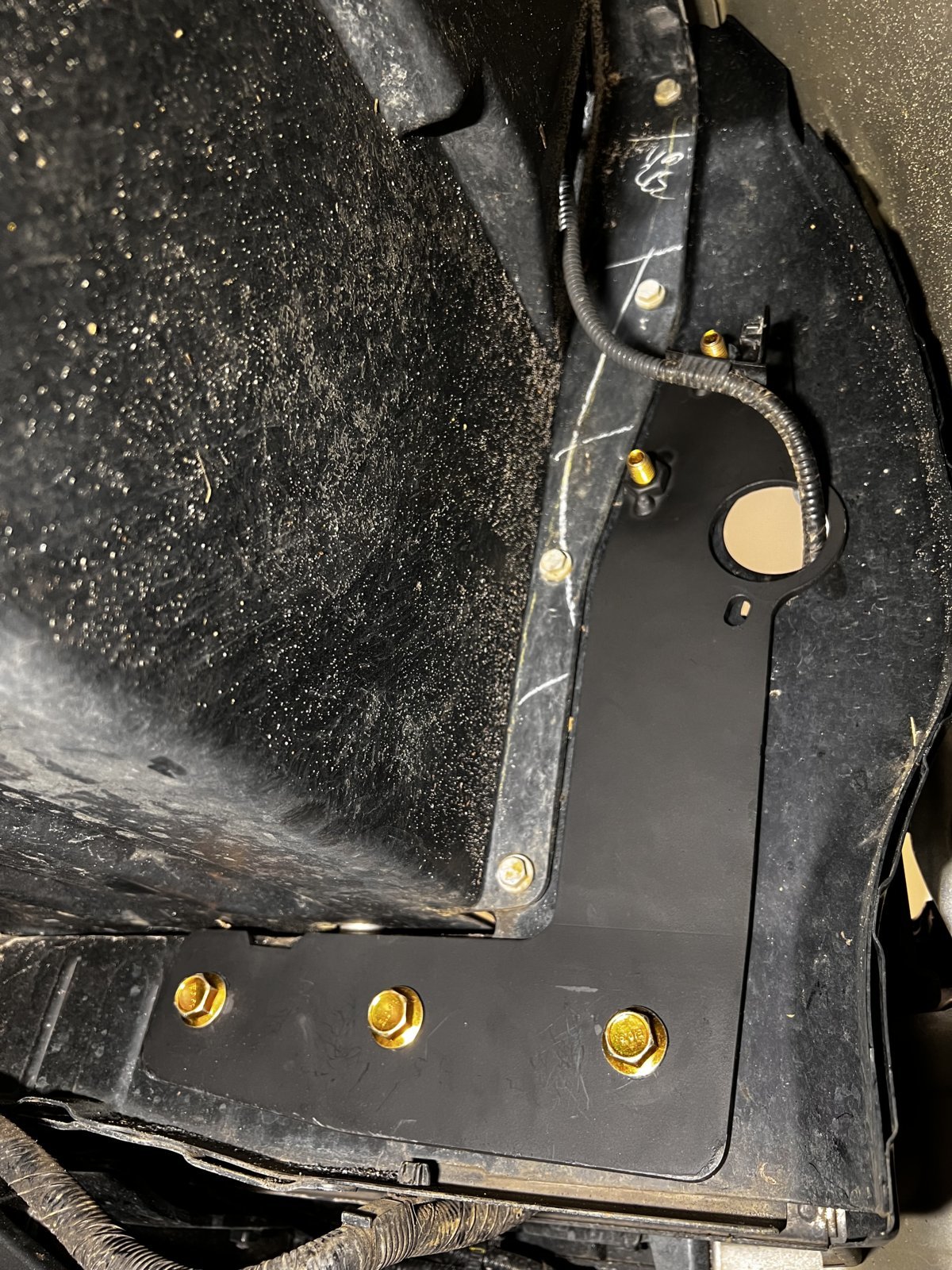

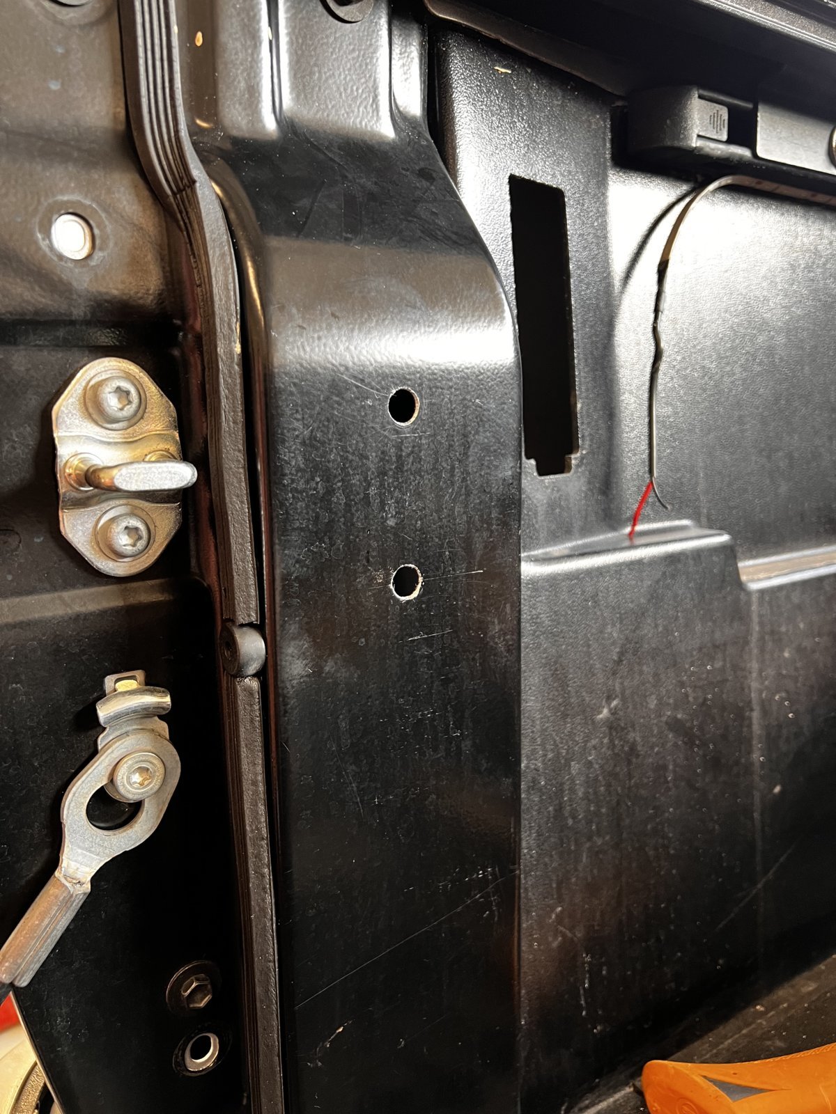

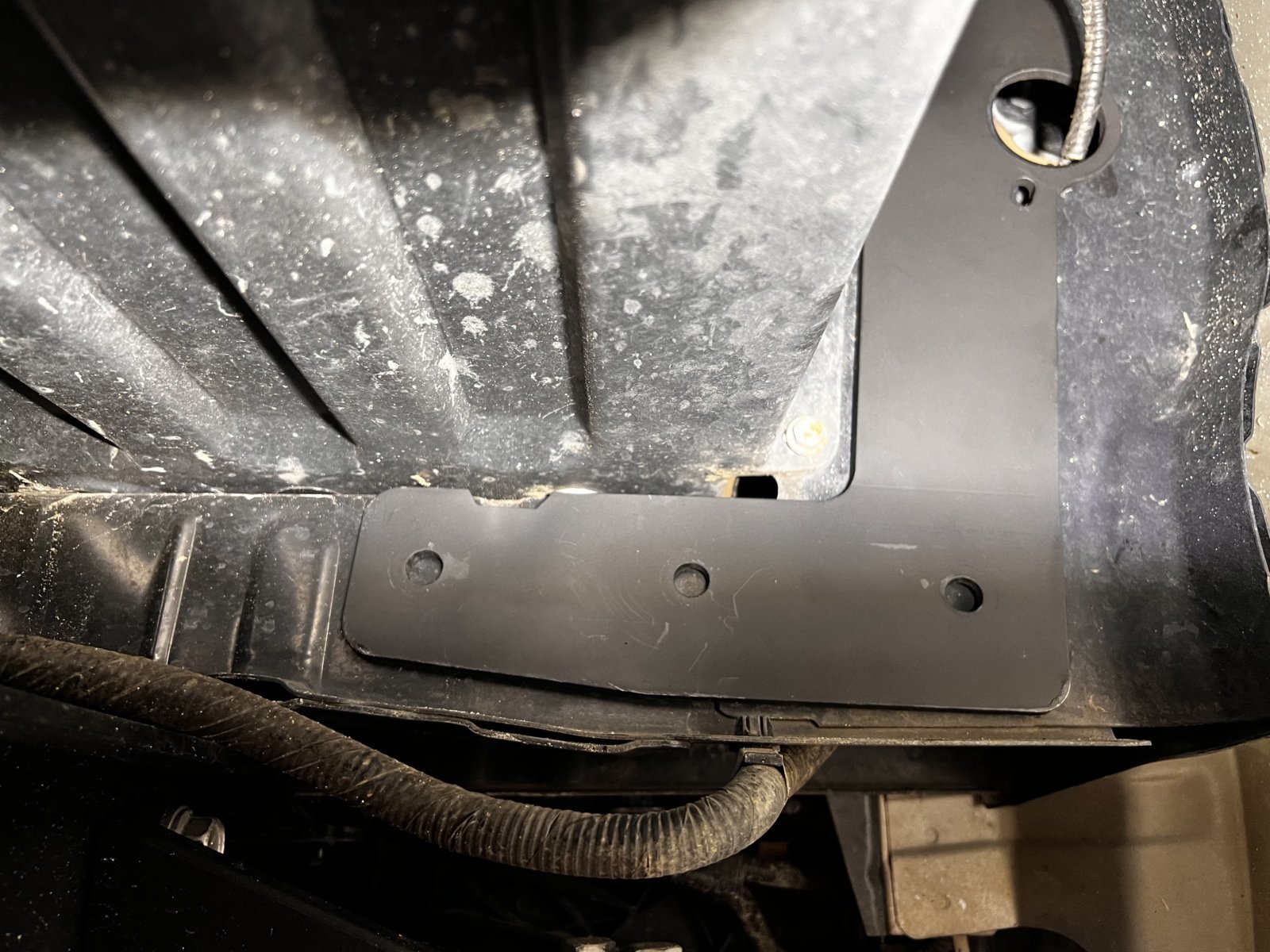

    Install done! Took my sweet time and took tons of pics. It took about 2 1/2 hours being very deliberate. Pics uploading now. Will post in the morning. No issues/problems. Minor mis-alignments , but not a problem.
    NoOne, BoomerGVNG, ljerr2 and 3 others like this.
  11. Aug 15, 2024 at 4:48 AM
    #971
    ljerr2
    ljerr2 Well-Known Member
    Oct 20, 2018
    #270010
    333
    Iowa
    2020 Tacoma TRD Pro
    Awesome - looking forward to the pics and commentary!!!
    NoOne and RxYoda[QUOTED] like this.
  12. Aug 15, 2024 at 7:29 AM
    #972
    RxYoda
    RxYoda Well-Known Member
    Mar 19, 2024
    #446157
    249
    Mark
    Florence, SC
    2023 Sport Premium 4x4 DCSB
    And so it begins…

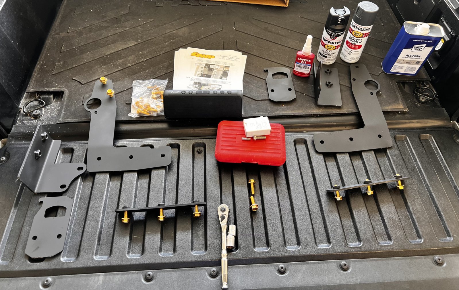

    Tools (helpful) in my case for solo install
    16” of wire or string (to pull/secure bracket while aligning bolts)
    1/8” HSS drill bit (for pilot holes)
    13/32” HSS drill bit (for holes for (3/8”) M10 bolts)
    HSS countersink
    232 or 233 threadlocker
    Square (At least 6”)
    Flat ruler (At least 14”) (steel worked best for me, std/metric is ok)
    Black touchup paint (for exposed metal due to drilling, I used rim touchup paint)
    15mm sockets (For bolts I chose)
    3/8 drive socket and 6” extension
    Torque wrench (if you are OCD)
    T-40 security bit (for bolts I chose)
    T-27 torx bit for passenger side power/storage panel)
    Scratch awl/pick ( for scribing and removing wiring retainers)
    Portable light(magnetic was really handy)
    Safety glasses (lots of metal filings while drilling under truck)
    Various rags (to clean surfaces that will be captured by new parts)
    Your choice of cleaning solvents (Why miss an opportunity)
    Drivers side 90 minutes (being VERY deliberate)
    Passenger side 50 minutes (lazily taking my time, but still acting like I had been there)
    Tips:
    Sweep the floor often, you will be laying down in metal shavings
    Safety glasses…(Ask a welder about protecting your eyes)
    Measure three times, drill once
    Threadlocker is cheap
    Thank the people that put in A LOT of work to bring us this product!!

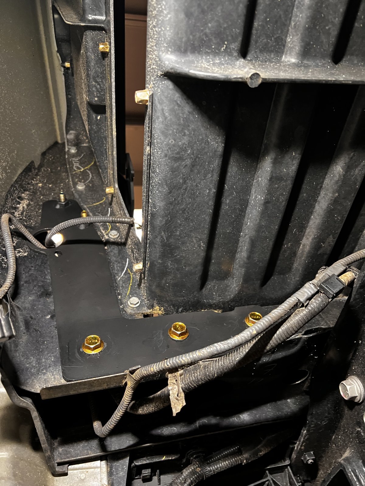

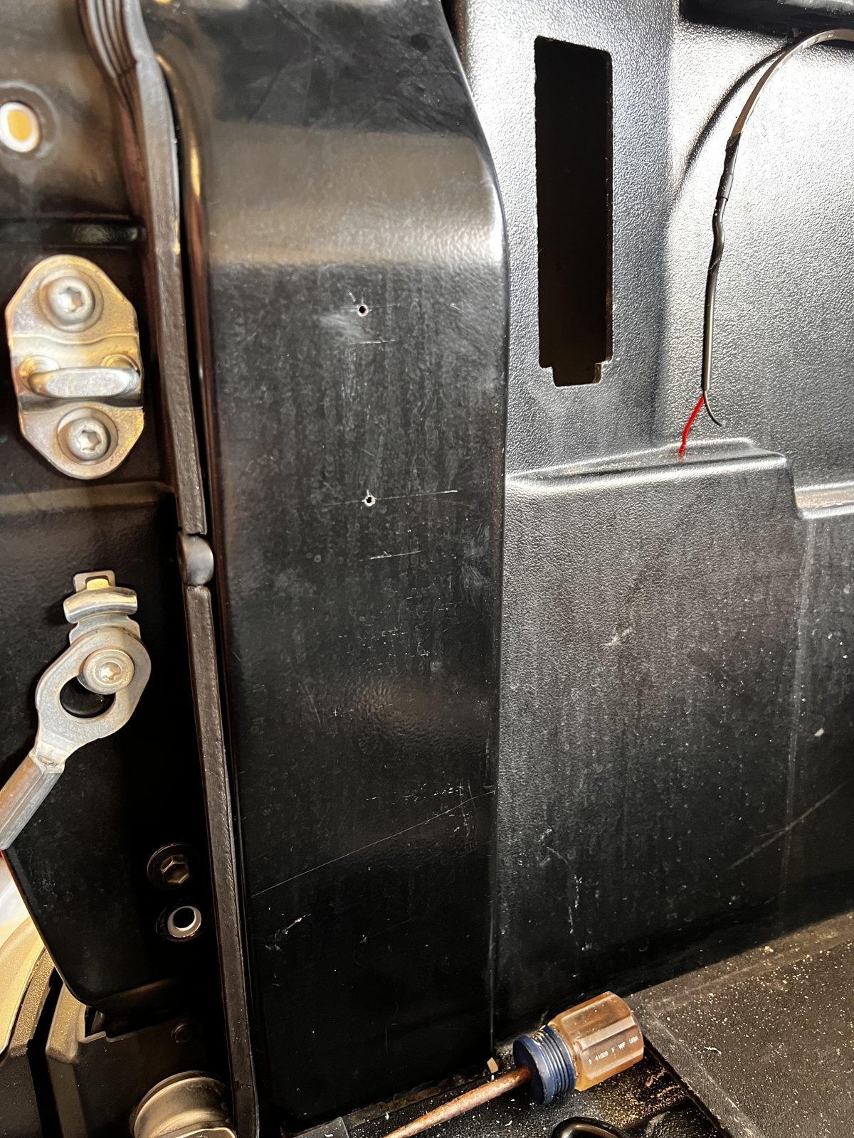

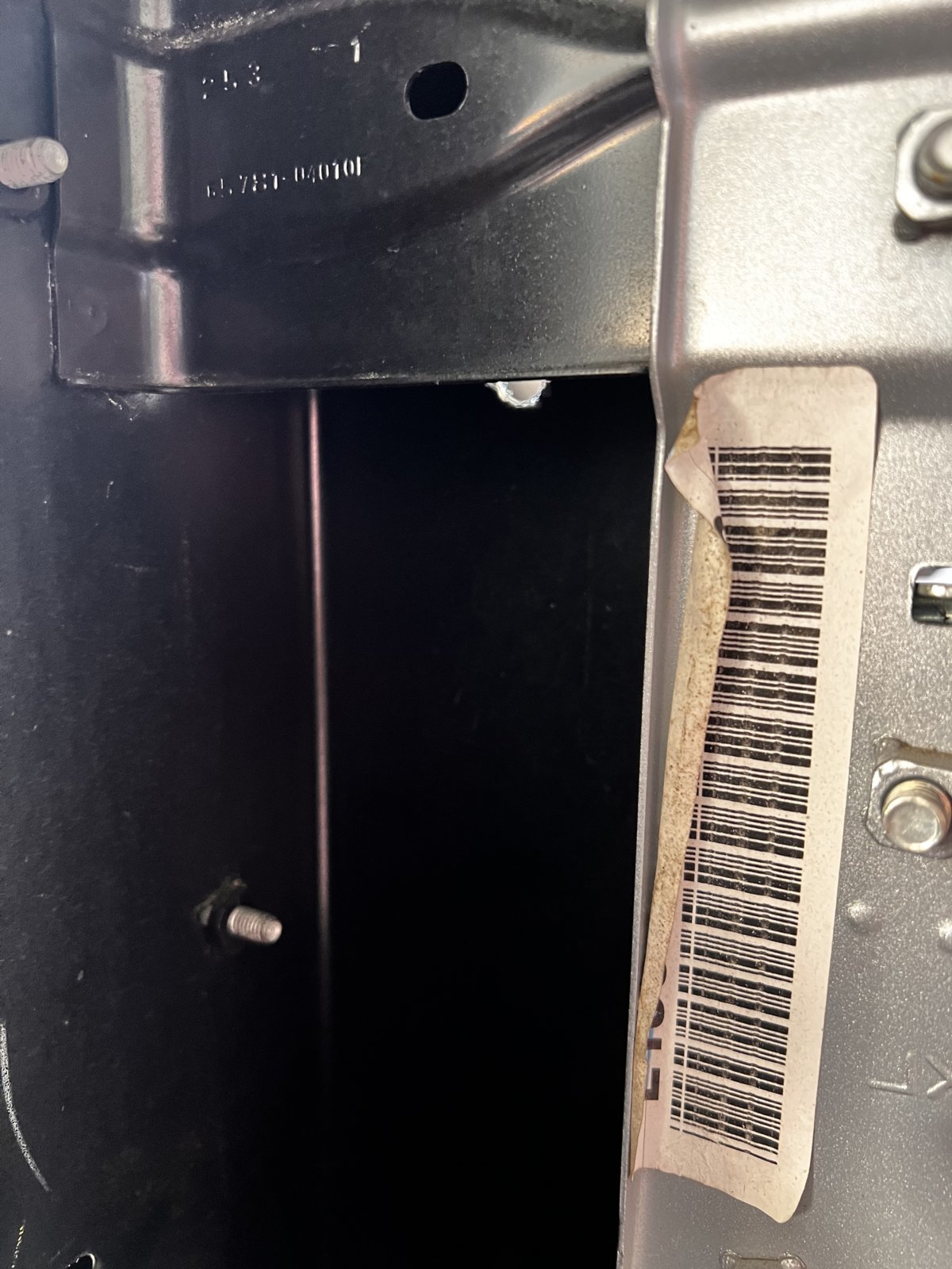

    Drivers side mock-up (thread clean out)
    Remove and protect taillight from scratches
    Drivers side tail light cavity (first 2 holes will be concealed by bracket on right of cavity)
    First two holes 10 3/16” (259mm)and 12 7/16 (316mm) from bottom of bed support (see other directions for where to measure from)(shown in pic)

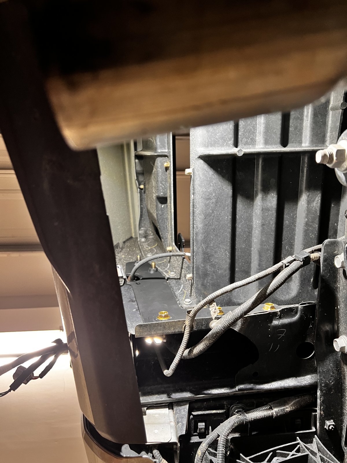

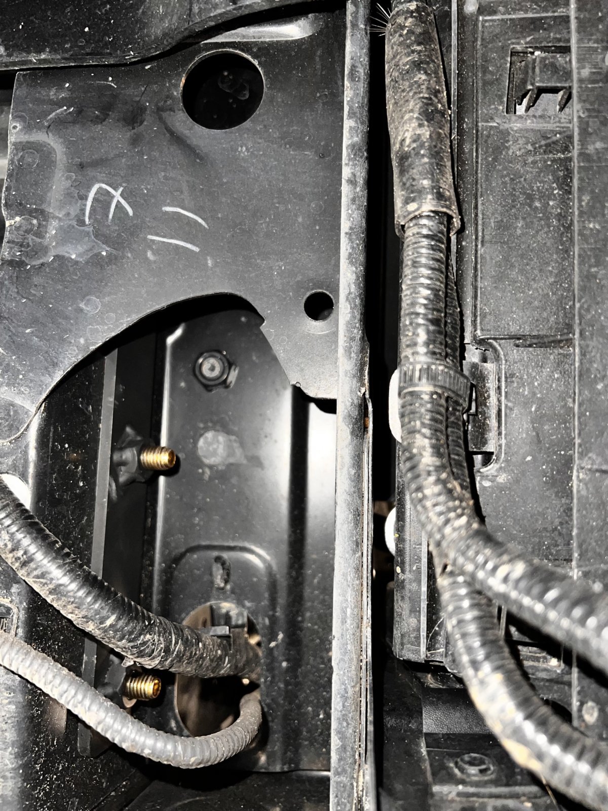

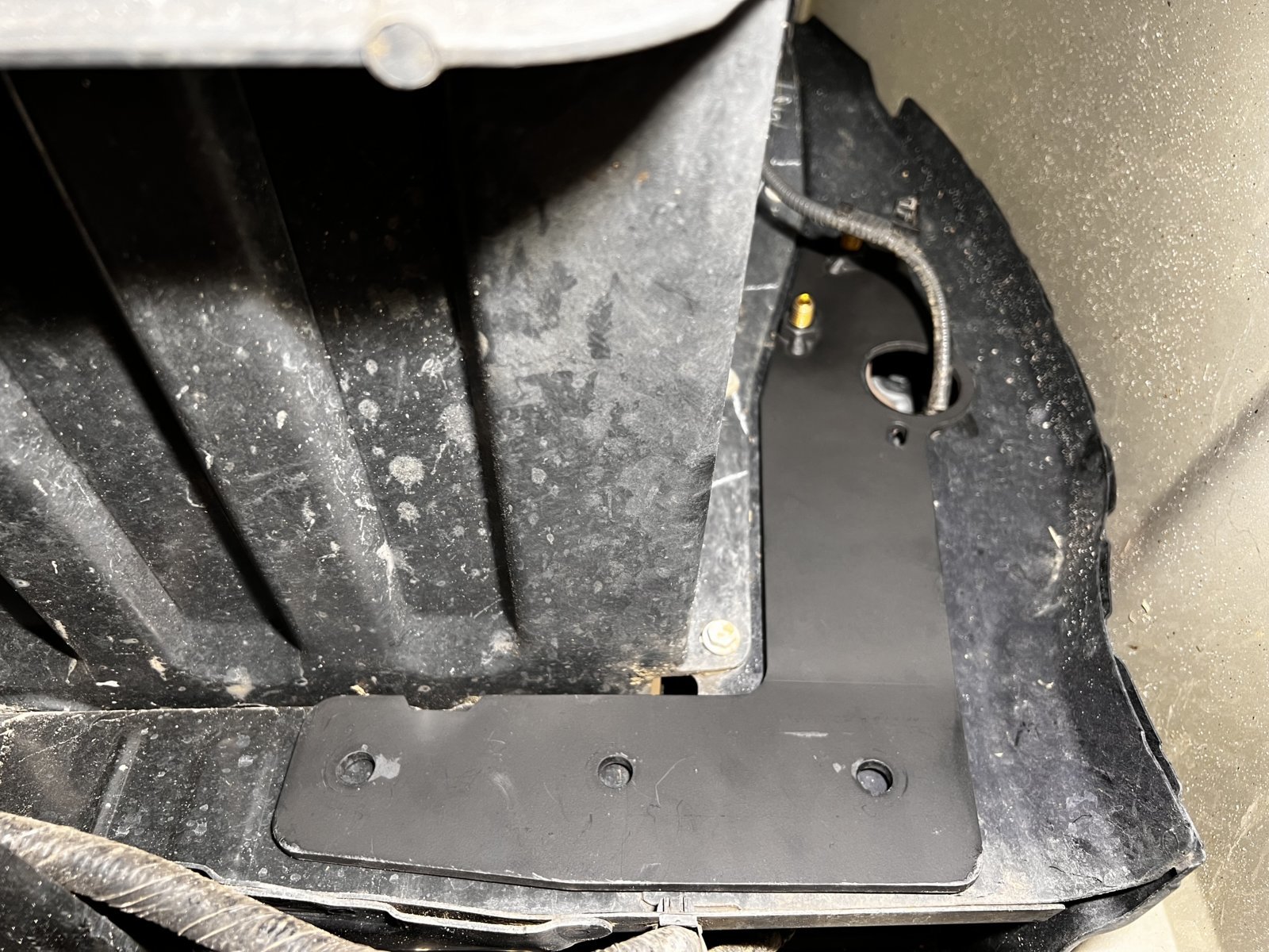

    Bracket secured in tail light cavity, disconnect and remove wiring from large hole/passage
    Stiffener secured from above
    Three little holes..
    Reconnect wiring and reinstall taillight
    Repeat for passenger side

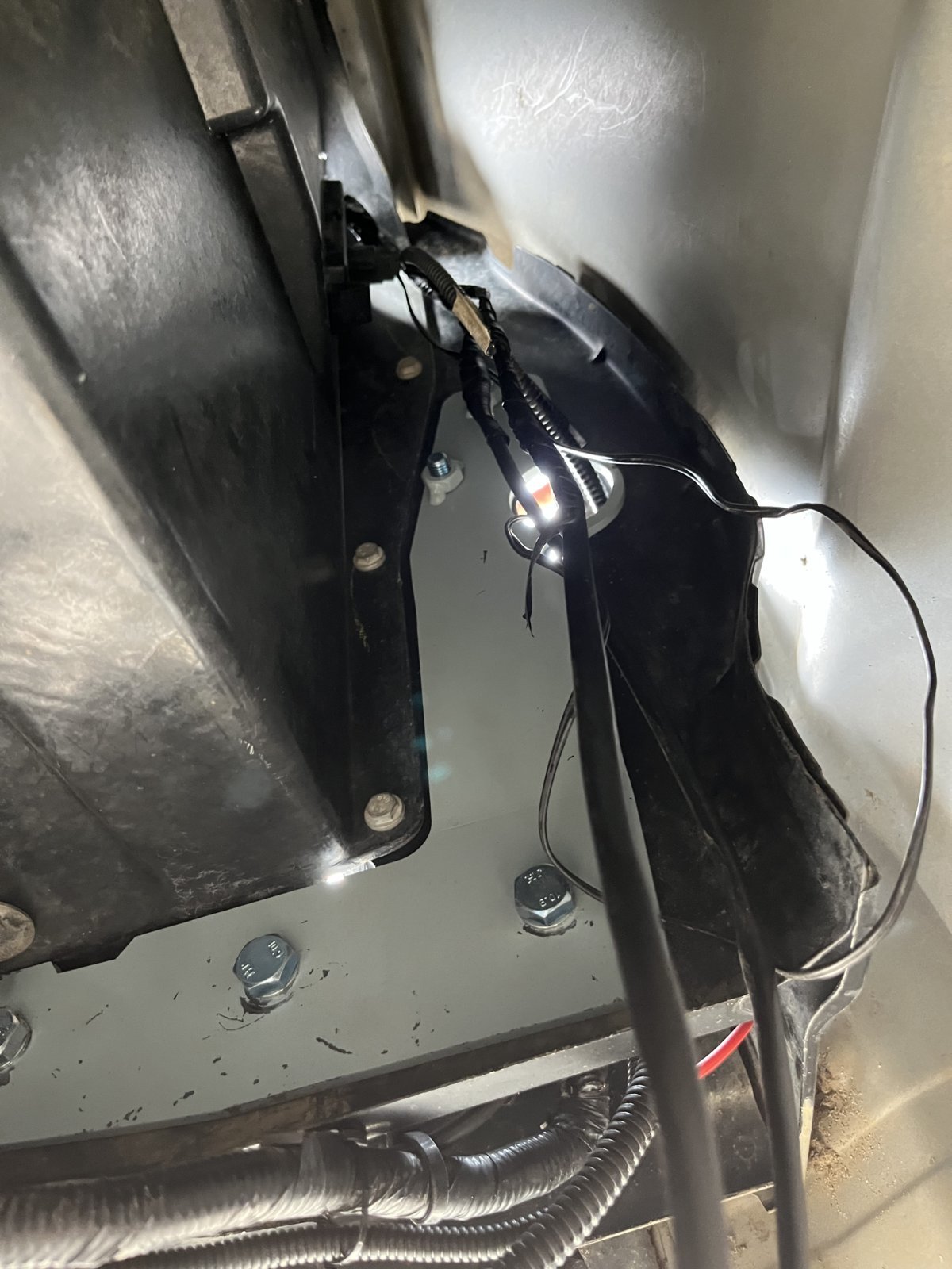

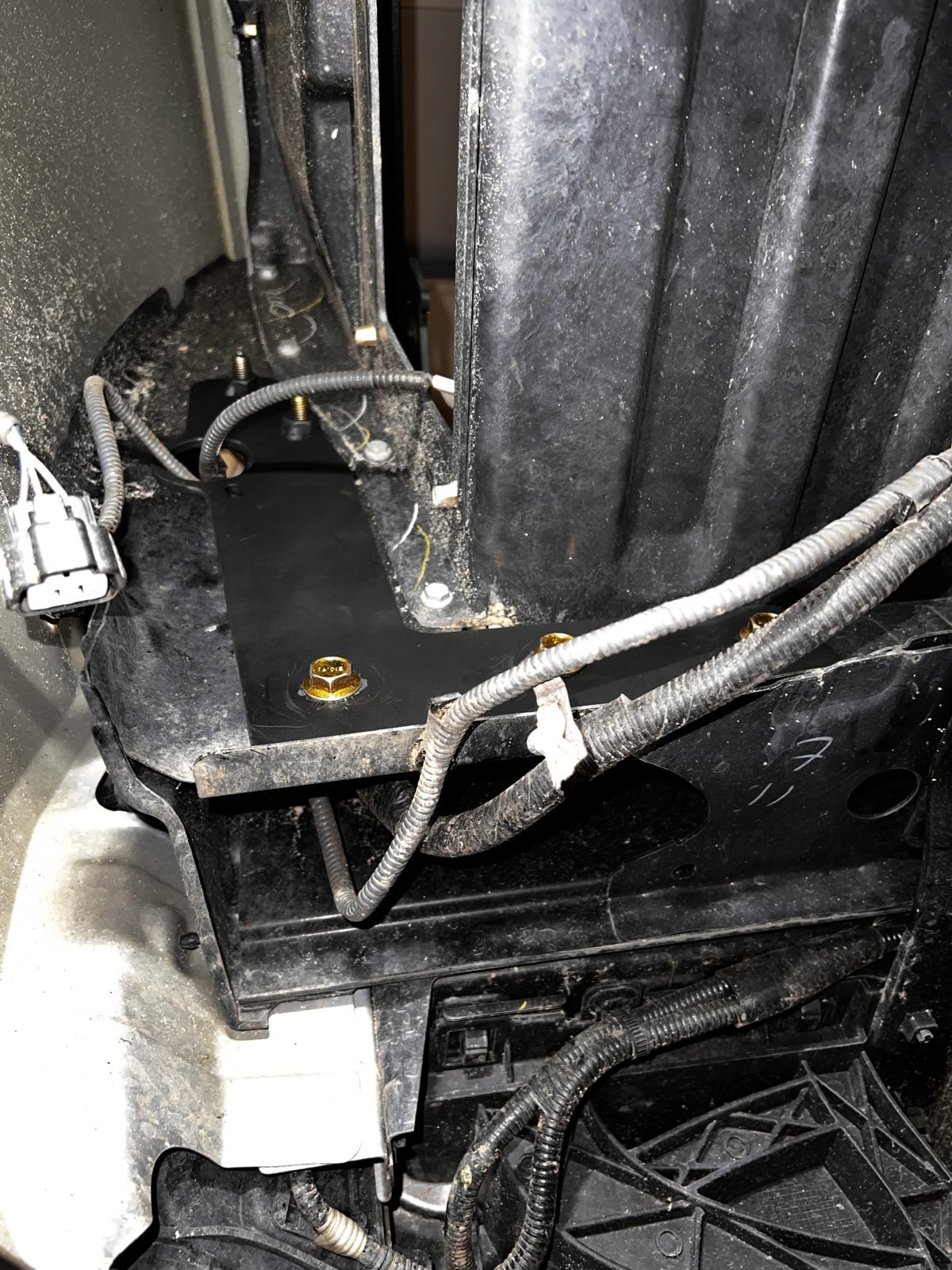

    Remove electrical/storage cubby, disconnect wiring, clear wiring from passage

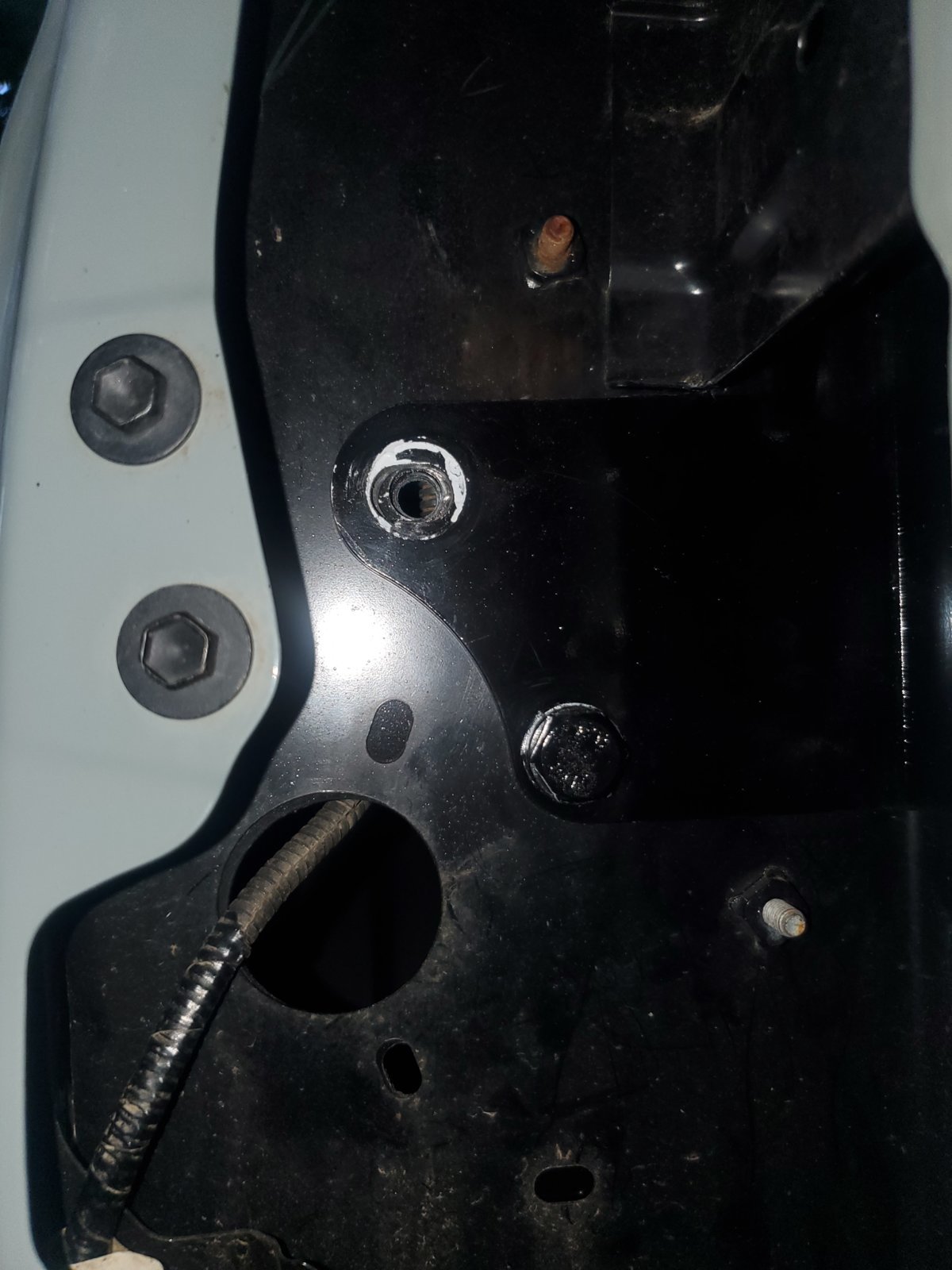

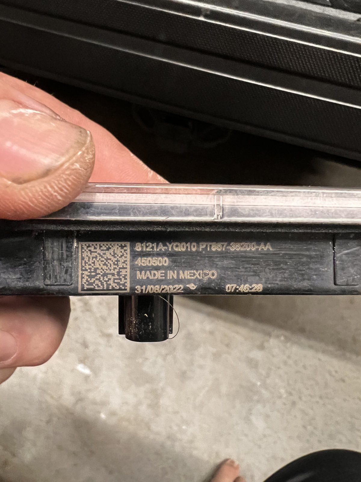

    Codes on LED bed light

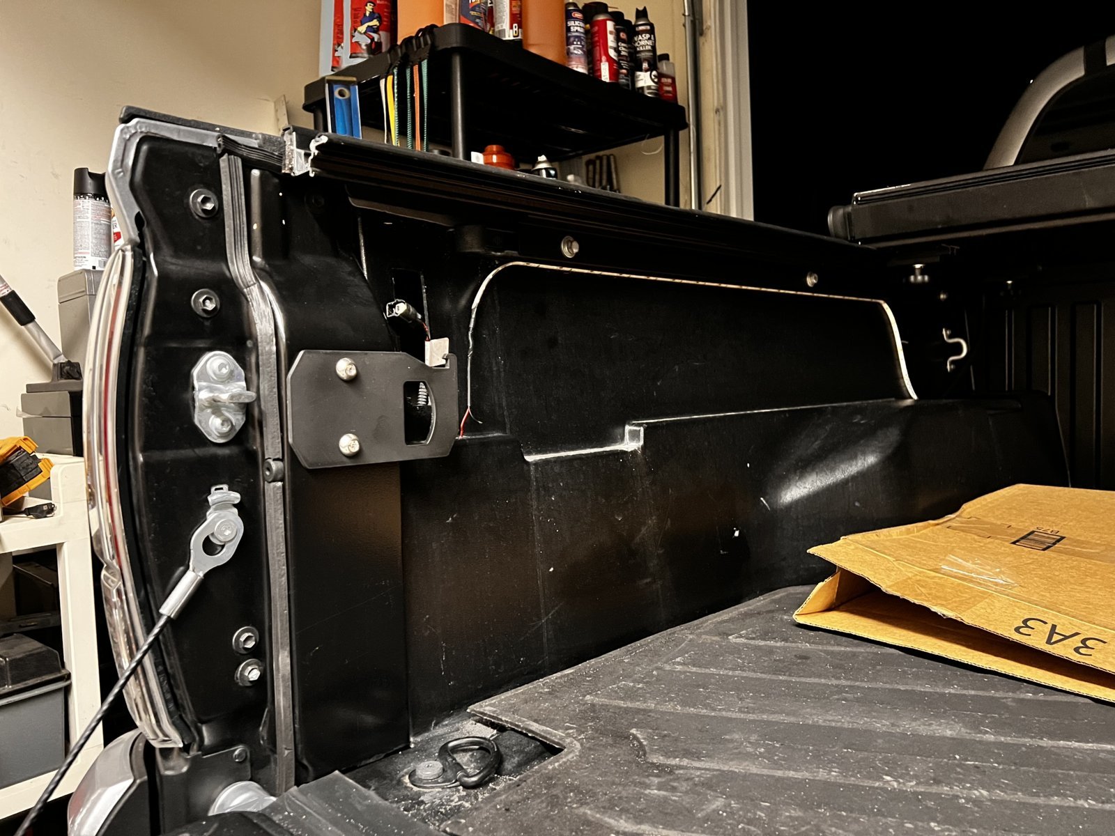

    Buttoned up!

    Only thing I want to mention is that your bottle opener is upside down! Unless it was on purpose.

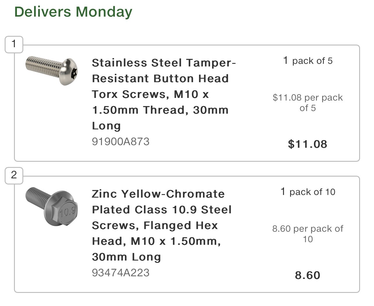

    I was about to order the same zinc plated bolts but shipping was almost 30 bucks for 15 bolts…made the total $47 for 15 bolts. May see if I can source anything zinc local and if not I’ll run plain stainless and use black oxide for the bolts seen in the bed.
    NoOne likes this.

    Hold off until your order comes up, in the event that shipping of said hardware is cheaper to me.
    Whenever I order from McMaster Carr it's shipped for cheap and always arrives the next day. I must be close to them.
