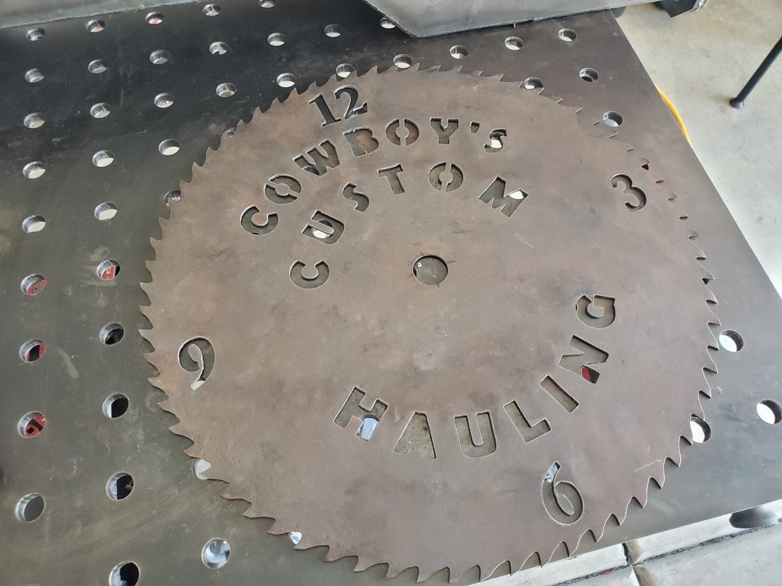

    Can you make my bottle opener say Kwik Fab? I’m serious lol. Power to you brother! This is great stuff!!

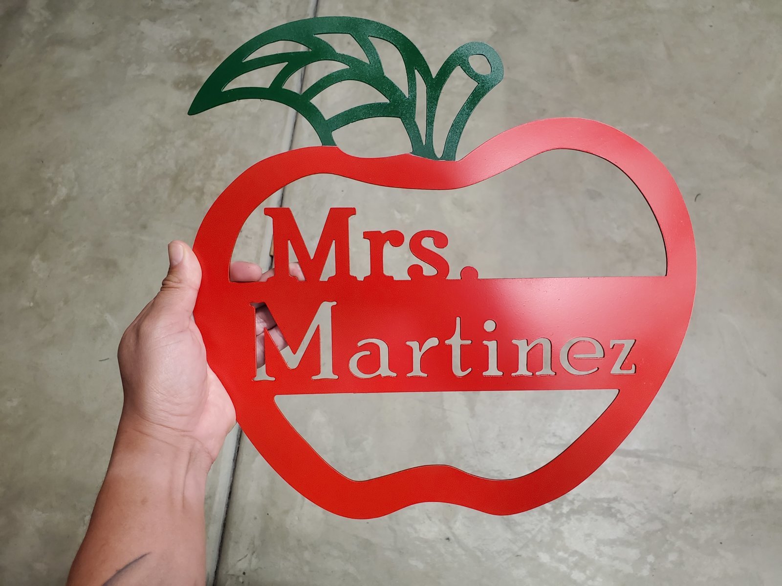

    Sheesh that'd be awesome if I could!
    Font too big though :rofl:
    Looks good when the font is big though! Made this for my wife's co-worker as a surprise gift...but smaller than that then it starts falling apart

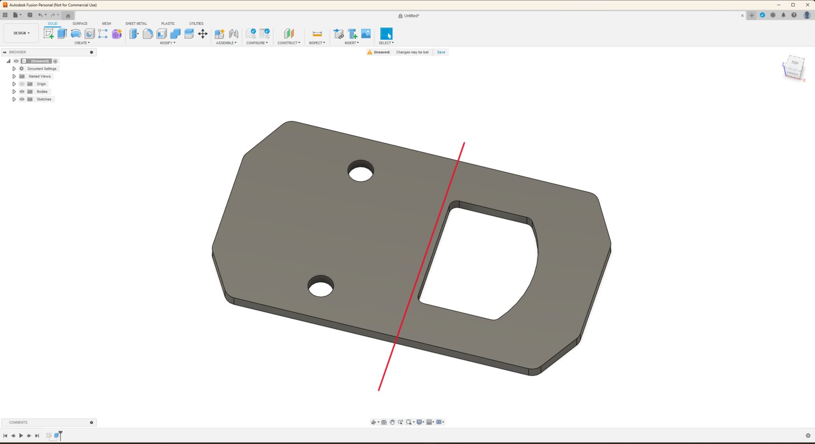

    Tomorrow will answer a question I have for myself - how far past the mount holes until the bracket is exposed to work as a tie down?
    Red line here is just an example, but ideally I want to make this as short as possible while providing utility. I don't want anything to extend farther than it has to.

    Others seem to like the design with it sticking out but my preference would be zero stick out. Something that has little to no chance of getting caught on something, doesn’t interfere with cargo…etc. I’ll keep looking for more fun/creative ideas but in the absence of a better idea I’d rather have a standard D ring in this location than have a 2”x2” slab of steel sticking out into my bed. And that’d be easy to add for any of us without any design change on your end. Perhaps just a slightly longer bolt to accommodate the thickness of the D ribg bracket. Something like this: https://www.amazon.com/dp/B07Q2H38F6

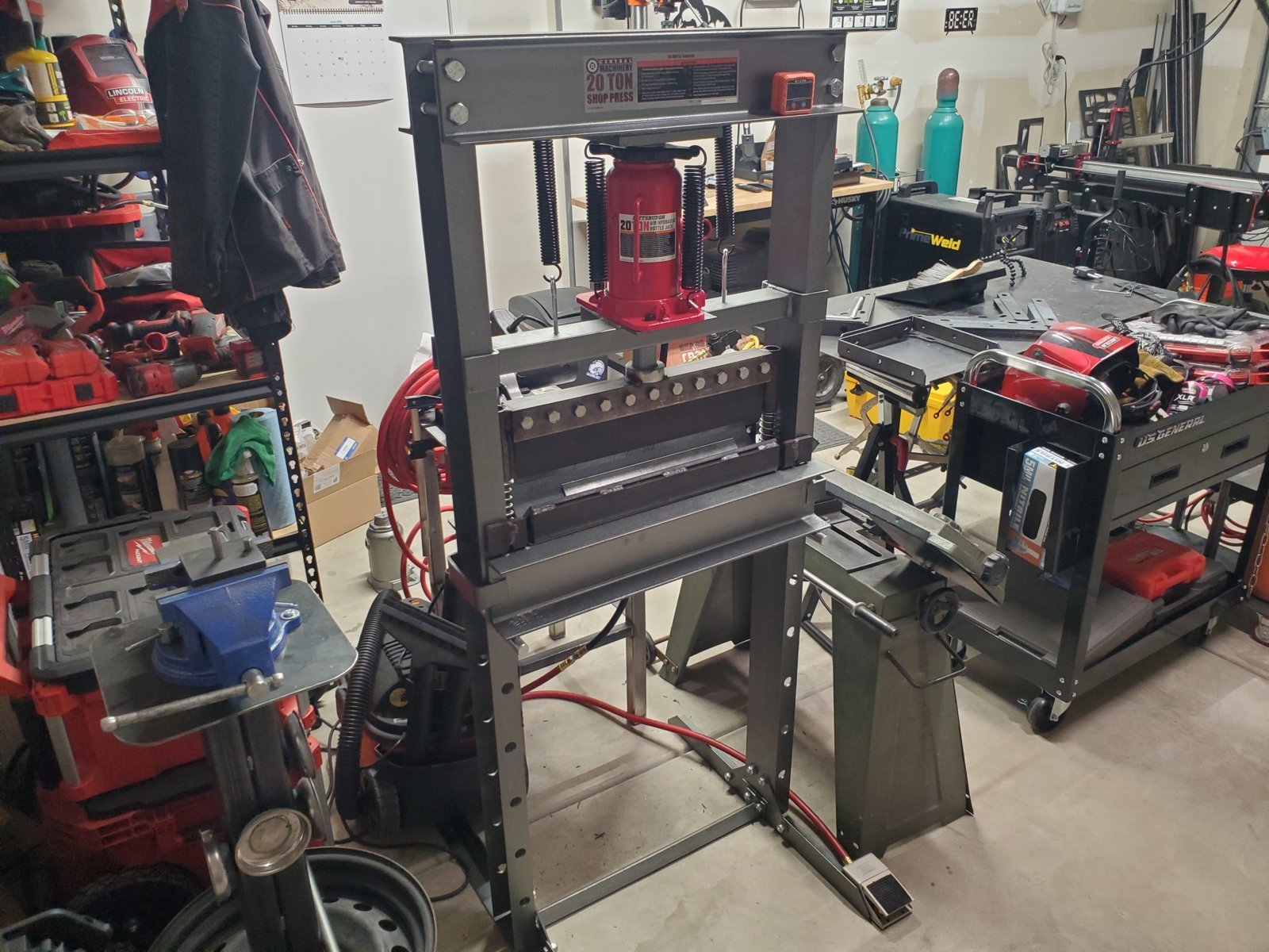

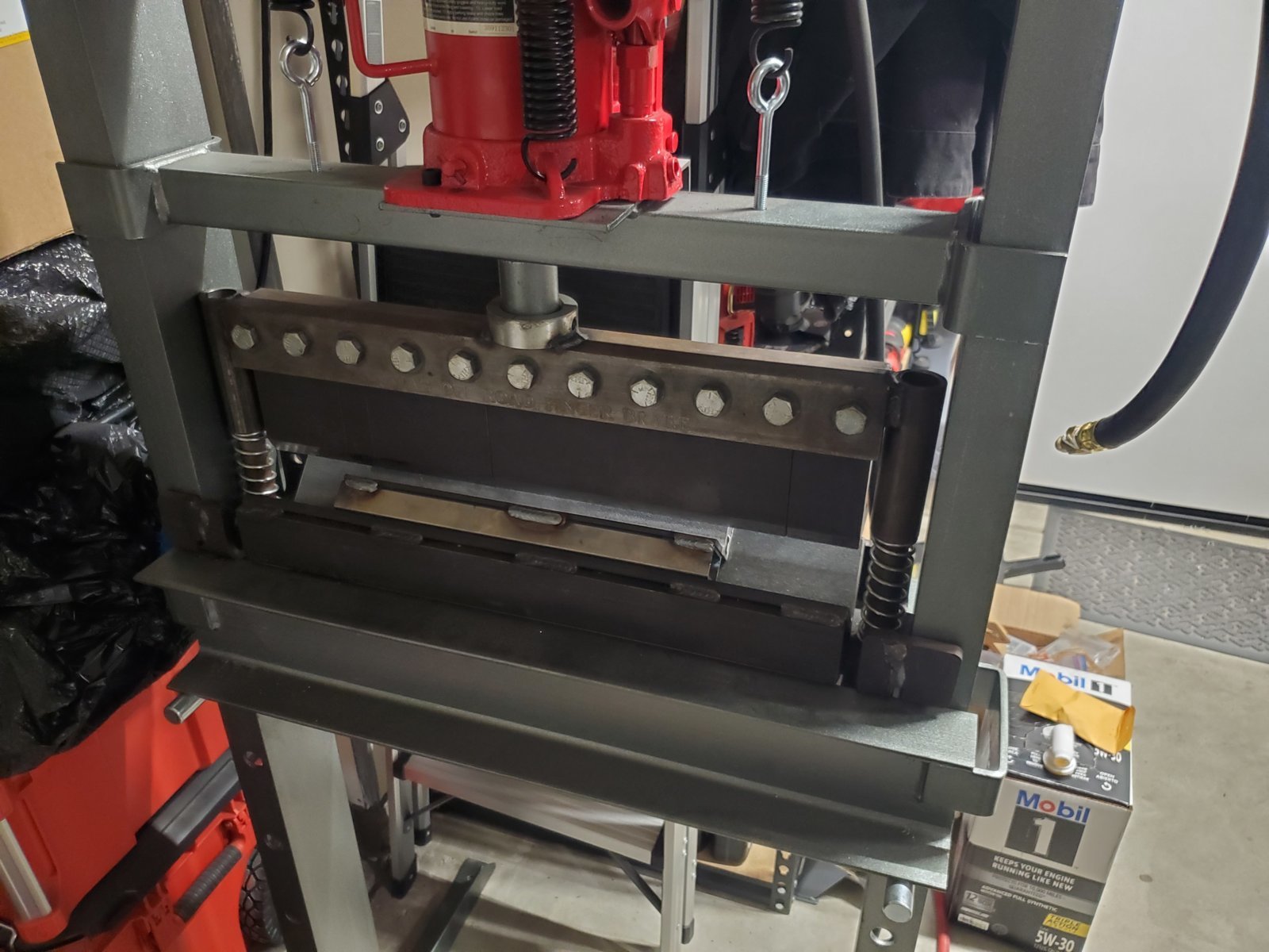

    Some of y'all are here just to follow along, so thought I'd share a little something.

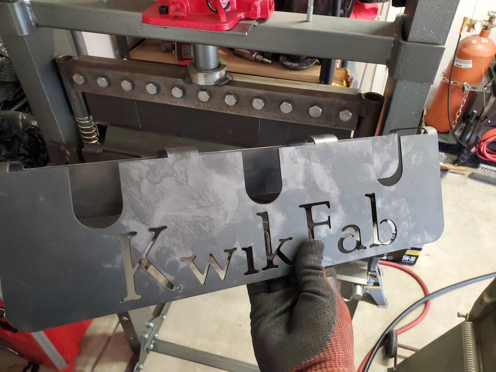

    I used to use a harbor freight press with a swag offroad brake kit. Now, I've made skids, and bent up several misc items (both for myself as well as sold items) and it was great

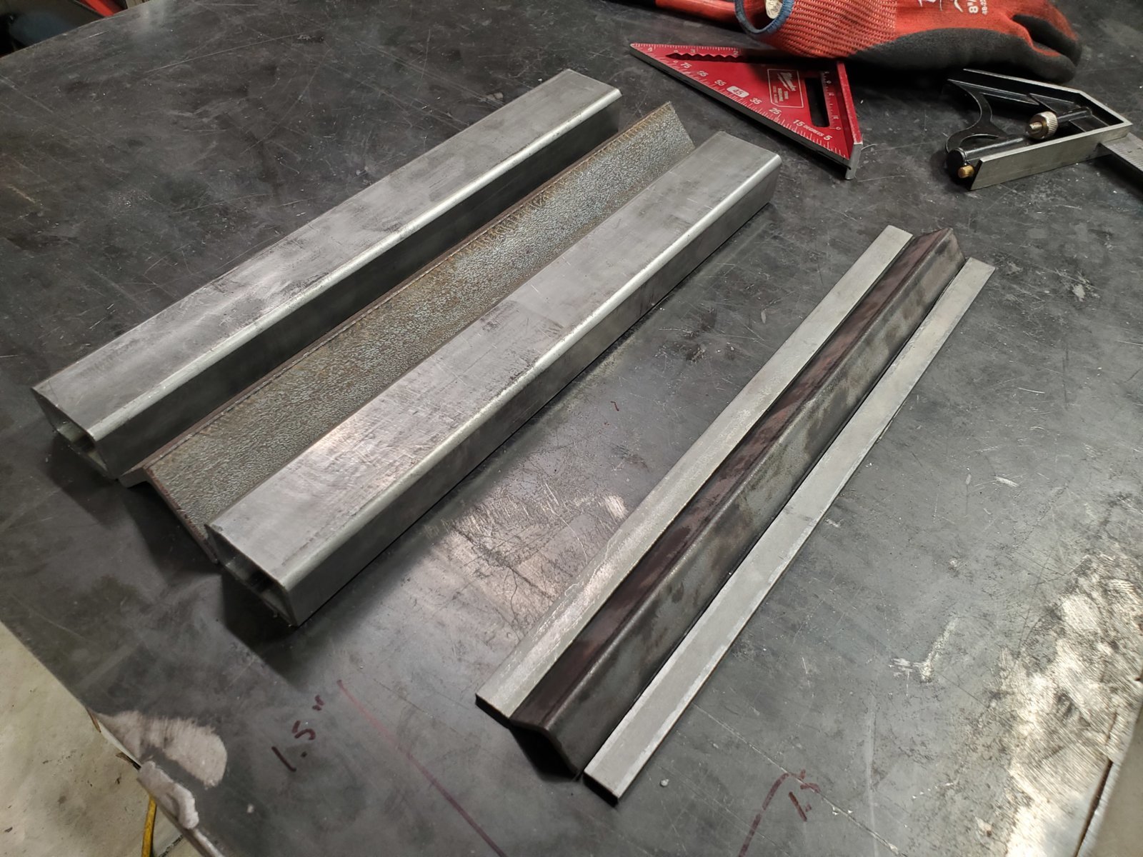

    The problem with the setup was that, I would also get requests for small parts out of thinner material.
    I had tried to improve on the suggestion of "stacked angle iron" and tried making a smaller die for a tighter radius even
    But even that wasn't enough for a nice bend
    I found myself incorporating relief cuts for nicer bends on thin stuff, sold the press, and put my swag kit in storage. I'll use the swag kit top die set again, but once I build myself a larger press

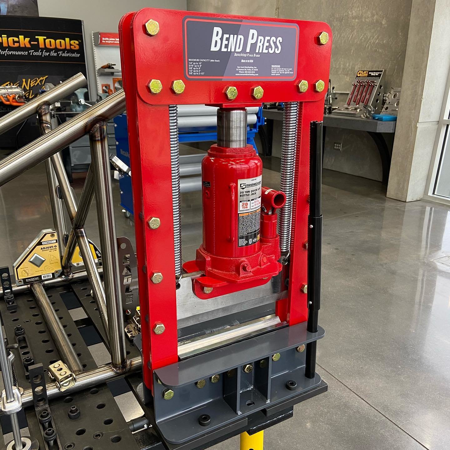

    I mention this all because for awhile I've wanted something smaller (for small projects) that'll give me a quality bend so I have this arriving tomorrow
    It'll be perfect for the projects I've done this year without one, as well as these stiffeners, while handling some mounts I need to knock out next month.
    Have to thank my supporters (both local and on the forum) for allowing this to happen :fistbump:
    Once it's set up, hoping to start running those bent pieces first thing Sunday.
