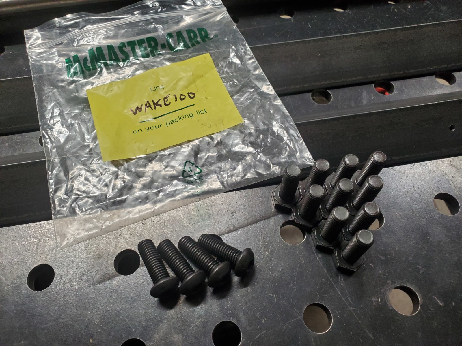

    wake100
    wake100 Well-Known Member
    Jul 22, 2013
    #108784
    1,158
    Syracuse, NY
    2021 AG DCLB off road 4x4
    Uptop roof rack, cali raised light bar, diamondback tonneau
    i mean the stuff costs money. not looking for free. i can do what ever. I work at a business where mcmaster will have them here the next day as well.
    NoOne likes this.
  2. Aug 15, 2024 at 11:49 AM
    #982
    Kwikvette
    Kwikvette [OP] Well-Known Member Vendor
    Feb 27, 2019
    #284735
    80,840
    Fresno County
    4 run, 2 don't
    You're good I got you.
    Just let me know if you get your own hardware beforehand.

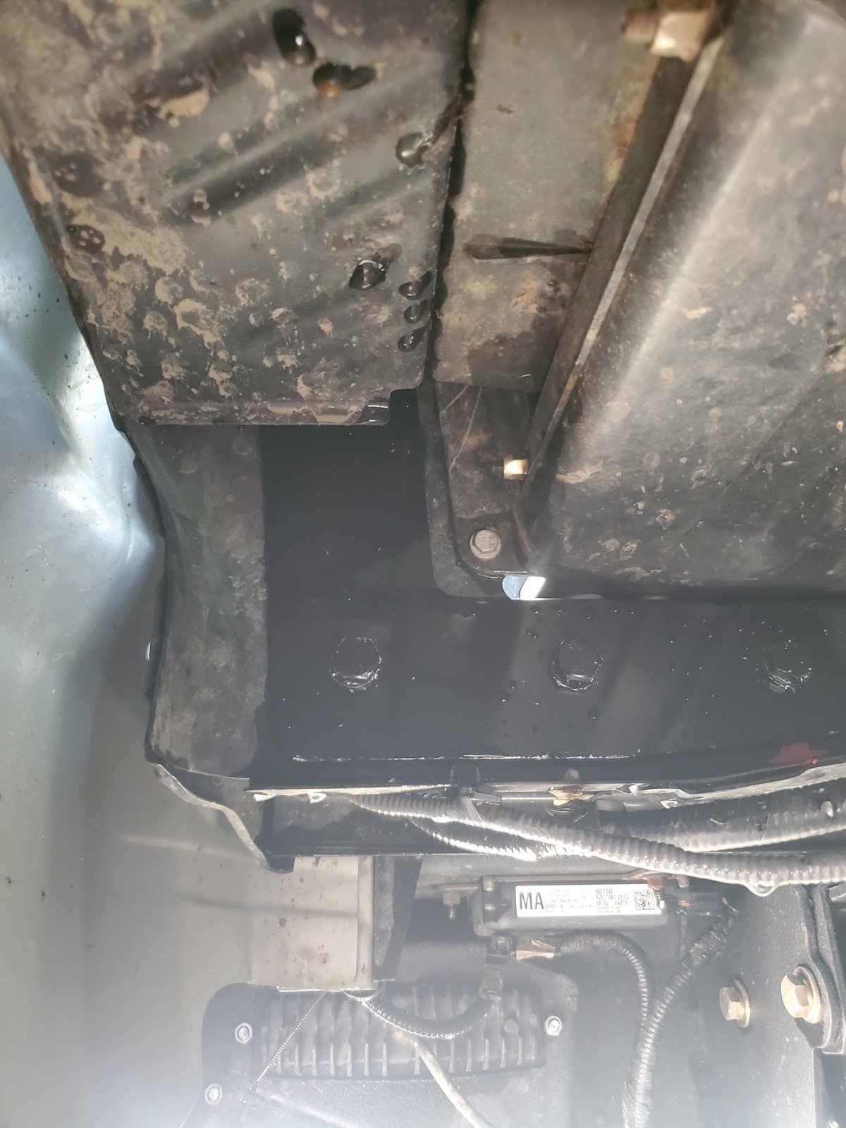

    ‘Thank you! I noticed after taking pics. I have taken them loose and decided to paint them semi-gloss to match bed rail.
    NoOne and Kwikvette[QUOTED][OP] like this.

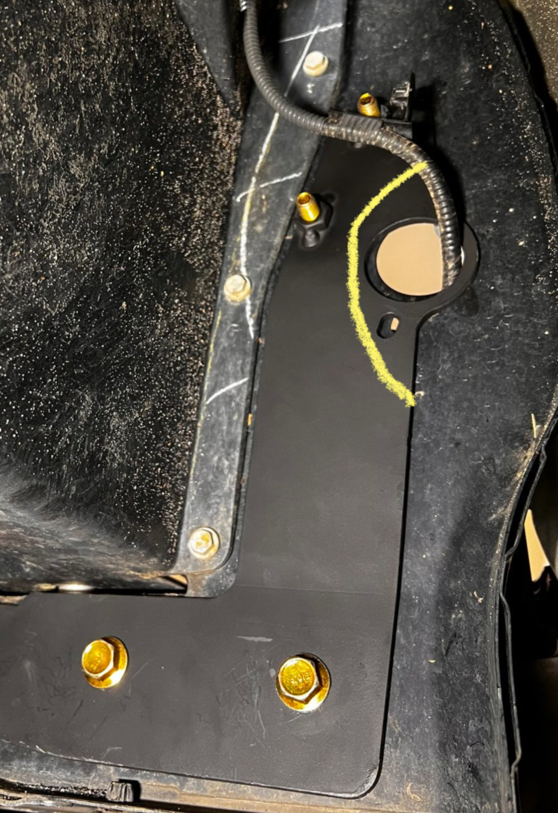

    You’ve probably thought of this, but the alignment wouldn’t even matter if you cut a larger bit of material out instead of having the large hole and little slots. Plus the wiring harness clips would still work. Sort of like this (credit to rxyota for the original pic):
    Whether you feel like that leaves enough material/rigidity is a different question.
    NoOne likes this.

    I feel like the hole is already oversized for a single piece of wiring loom to go through and the alignment thing is pretty much just cosmetic.
    Something that one comment brought up earlier which is much more of a concern imho is that the way these are installed, if your bedsides are already bowed these will effectively lock them in that position.
    Make sure your bedsides are in the position you want them in and held in place if necessary before your start drilling. Some have mentioned using a ratchet strap if they are really bad
    NoOne, MagicToolbox and Kwikvette[OP] like this.

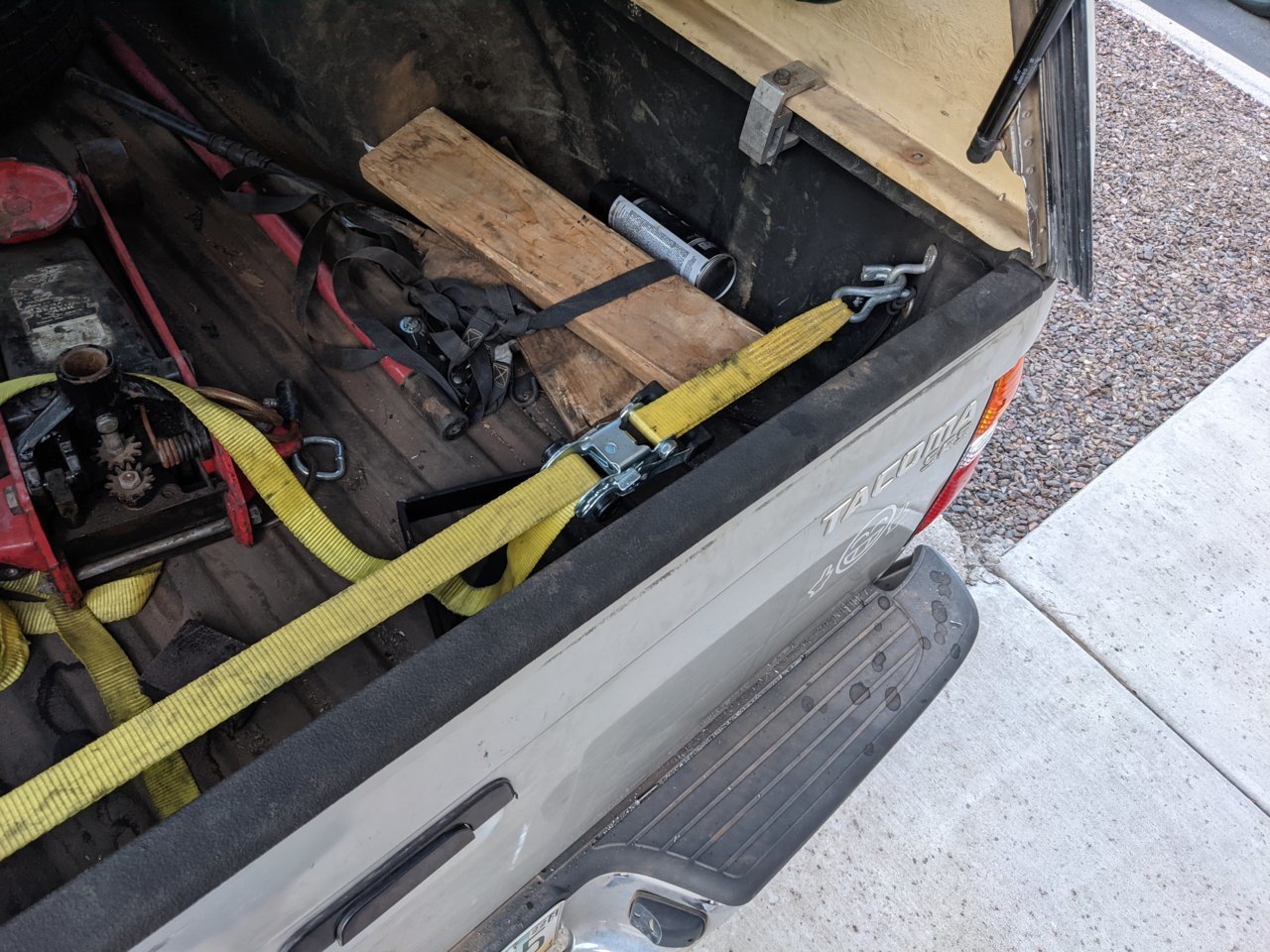

    One thing I forgot to mention, or something others should do is post a picture of the rear of their truck with the tailgate up.
    This way you can see if there's a considerable gap from one truck to the next.
    Here's the first bed stiffener set I ever made, and pictures of the before and after (including using a ratchet strap to close up the gap).
    Gap before bed stiffeners -
    Ratchet strap to pull it in closer, and install -
    And post install -
    NoOne, ljerr2 and musicisevil[QUOTED] like this.

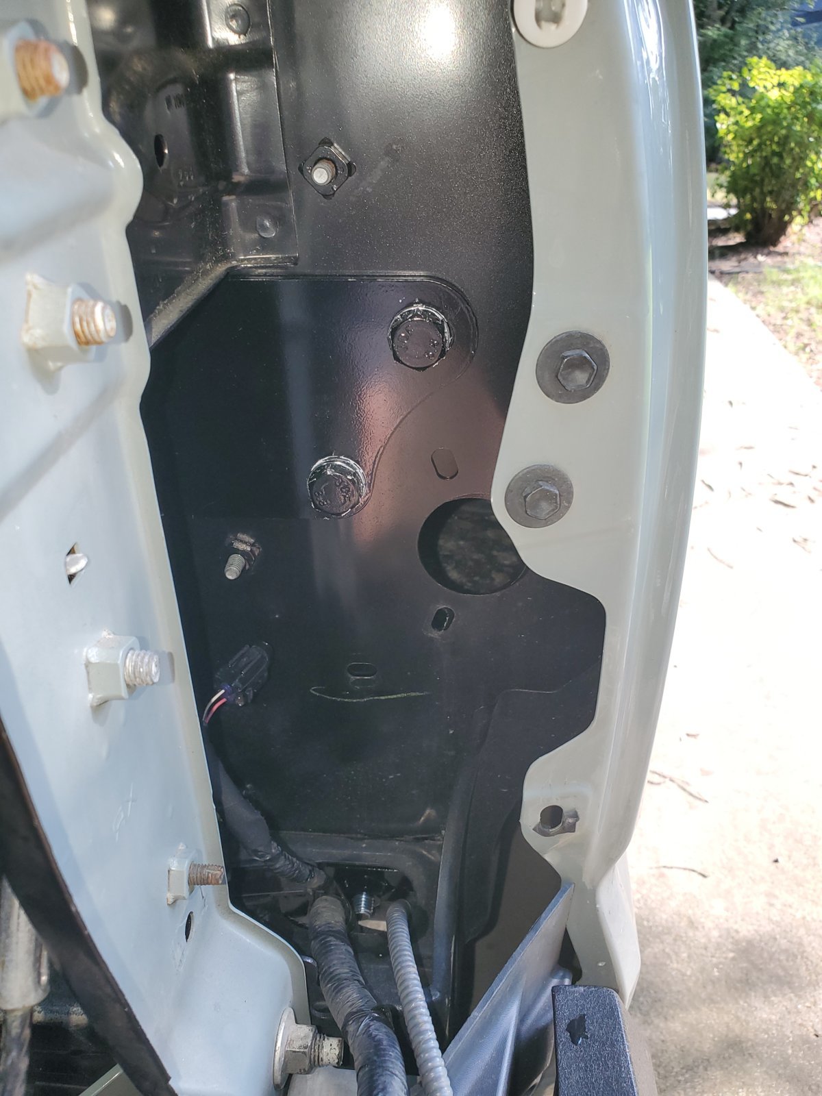

  8. Aug 16, 2024 at 1:59 PM
    #988
    MagicToolbox
    MagicToolbox Well-Known Member
    Feb 23, 2024
    #444482
    335
    2022DCSB MT TRD OffRoad in Lunar Rock

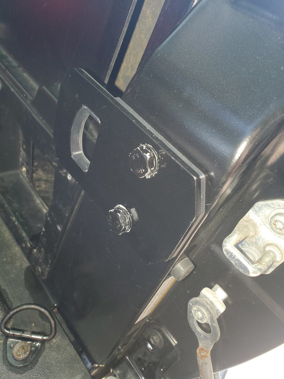

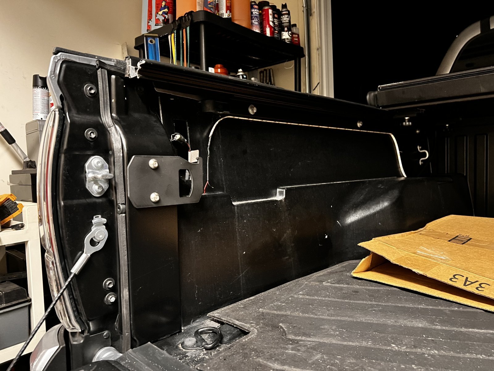

    Purchased Toyota Certified, with Vijay bumpers, additional lights, and Falken Wildpeaks on Fuel rims. Prev owner apparently painted the grill.
    Blerg. Who the Flouff put all that extra crap in the way on the passengers side? More wires, plastic shelves and boxes, why can't I get my head up in here... WHY IS THE TAILPIPE IN MY WAY!?
    OK - I'm done ranting.
    Passenger side is installed. Things just got too hot in the sun for a final disassembly, paint, and loctite.
    I even left the tail light off to come in and shower, I'll put it back on after dinner.
    NoOne, musicisevil and Kwikvette[OP] like this.
  9. Aug 16, 2024 at 2:04 PM
    #989
    Kwikvette
    Feb 27, 2019
    #284735
    80,840
    Fresno County
    4 run, 2 don't
    Looks great!
    Can you share what you used to adhere your strap savers to the exterior bracket?
    Yours look absolutely flush, unless that's how they naturally sit?
    NoOne likes this.

    Bolts.
    I didn't put anything in there. I have some double sided tape that I may use, but I'm not sure it is necessary. It may keep some water out, or it may hold any water that gets in, in place.
    Since I got an extra pair of tie downs early to test fit strap savers, one with a bottle opener, I may try to powder coat them and see how that holds up.

    When your batch comes up, there will be a couple of questions.
    1. What kind of tie downs do you want (drivers and passengers)?
      1. No tie down , structural only (no strap saver)
      2. Tie down.
      3. Tie down with bottle opener.
      4. Limited edition F-bomb (no strap saver)
    2. Do you want strap savers?
    If you want strap savers there is an additional $10 charge paid to me. (via PayPal). @Kwikvette has a small stock of them, and will ship them with your hidden stiffys.
    There are pics in the first post showing the different tie downs.
