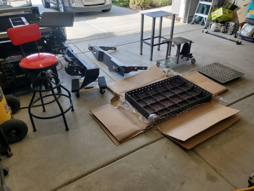

    Moved around another few hundred pounds of steel and tools around the garage :rofl:
    It's in shambles right now so I'm hoping I get it all back together by Sunday.

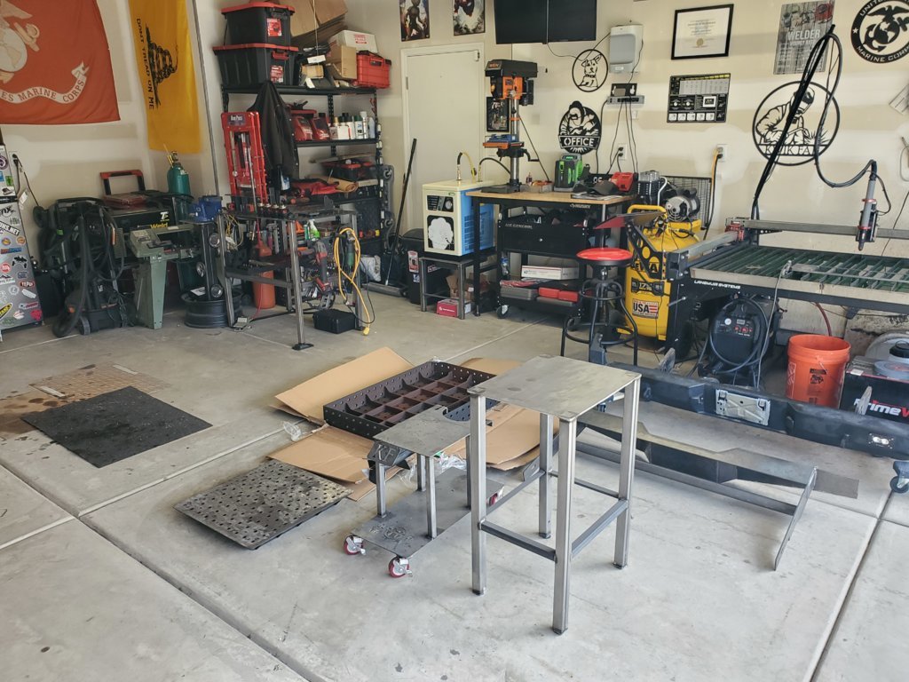

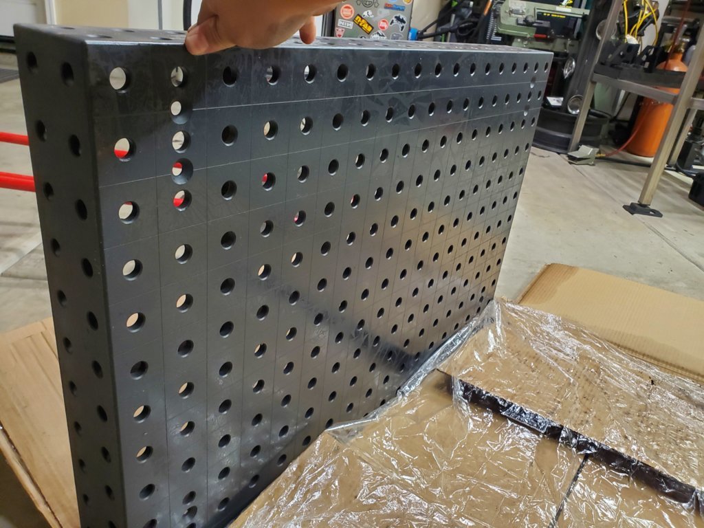

    Apologizing to 2nd batch in advance :bananadead:
    Going to be a slight delay; FedEx seems to have lost my table legs so I've got a 150lb hunk of steel on the ground along with other stuff.
    The addition of a second welding table would give me more work space but at the moment I can't place items anywhere else without the second table being up.
    Going to see about getting another set so I'll keep y'all posted.
    I will say, I can't wait until it's up cause it looks damn good.

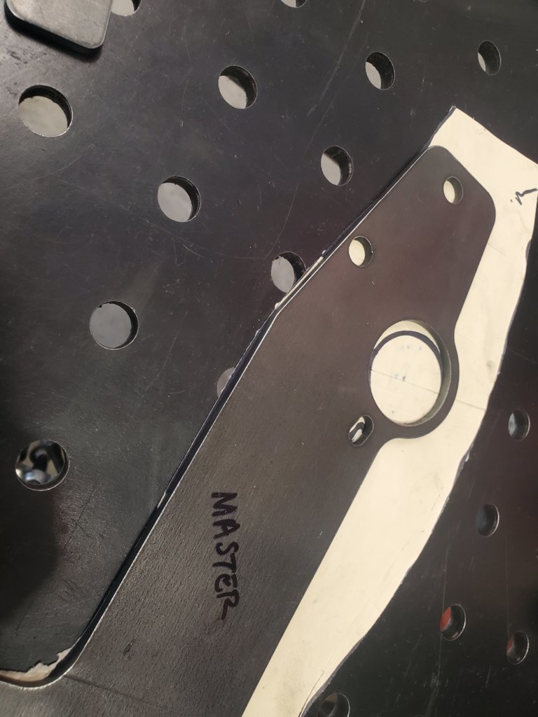

    @NoOne
    Thank you again for drawing and cutting this out and sending it to me.
    Just want to confirm, this is the correct side up?
    And do you mean for me to push the metal piece up against the paper edge for alignment like this?

    It was placed on the wheel side of the body plate and the markings are from the taillight side. I folded the top of the template while using a backlight to align the holes when marking the first bracket’s slot centerline. Ask away.
    EDIT: No, no need to push against the edge… that’s where the bed edge stops and would be as far as you could move in that direction.
    EDIT2: Unless the intention is to be butted against the bed. I did not try the bracket against that edge AND the bottom edge tight. My belief would be to avoid friction between the two, since the plate will win the battle. A small gap should exist there to me.

    The ONLY reason it was helpful for me is orientation/alignment. Otherwise, if it’s not oversized, it’s not particularly helpful. I could see a case where someone might use a bolt/nut to hold the L in place while assembling, but that’s as far as my imagination took it.
    I was thinking about how to correct the issue last night and reasoned - don’t change bracket #1, instead, correct the hole placement in #2. You already have the spacing correct, it’s just where they are/angle. I wish I had thought to mark the top/bottom of #1 on the template when I had it corrected. It can still be done, but it would have helped.
    EDIT: Thinking critically, would it make more sense for #1 to have the nuts and #2 to have misalignment slots? (Diagonal down, away from bed)

    #1 is internal
    #2 is L
    I was using the reference as to installation order.

    I just looked at it… if the slot hole size used on “internal” bracket was used on slot hole on “L”… the issue goes away… if the holes line up.

    I suggested that a few pages back.
    No nuts welded with slotted holes, but the majority voted against it as it doesn't affect functionality.
    I'll toy with the angling and whatnot on the L bracket to match your template. Thinking maybe tomorrow in terms of the drawing part of it.

    I’m referring to the slot near the large hole. If you used the larger size as used on internal bracket.
