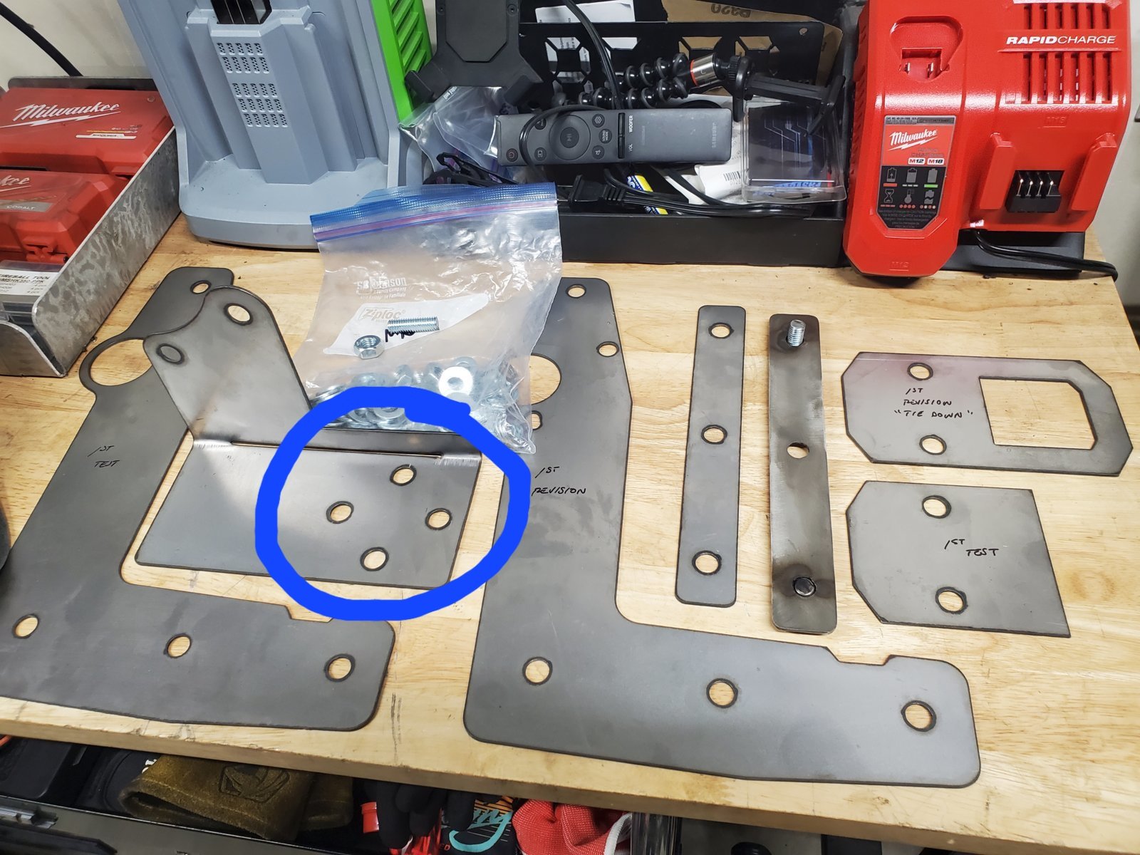

    You already have it covered if you are putting in four holes (circled in photo below). Those holes allow the part in the upper right corner to be mounted horizontal or vertical, you just have to measure out where to drill through the bedside per the 4WP directions accordingly.

    See page 5.

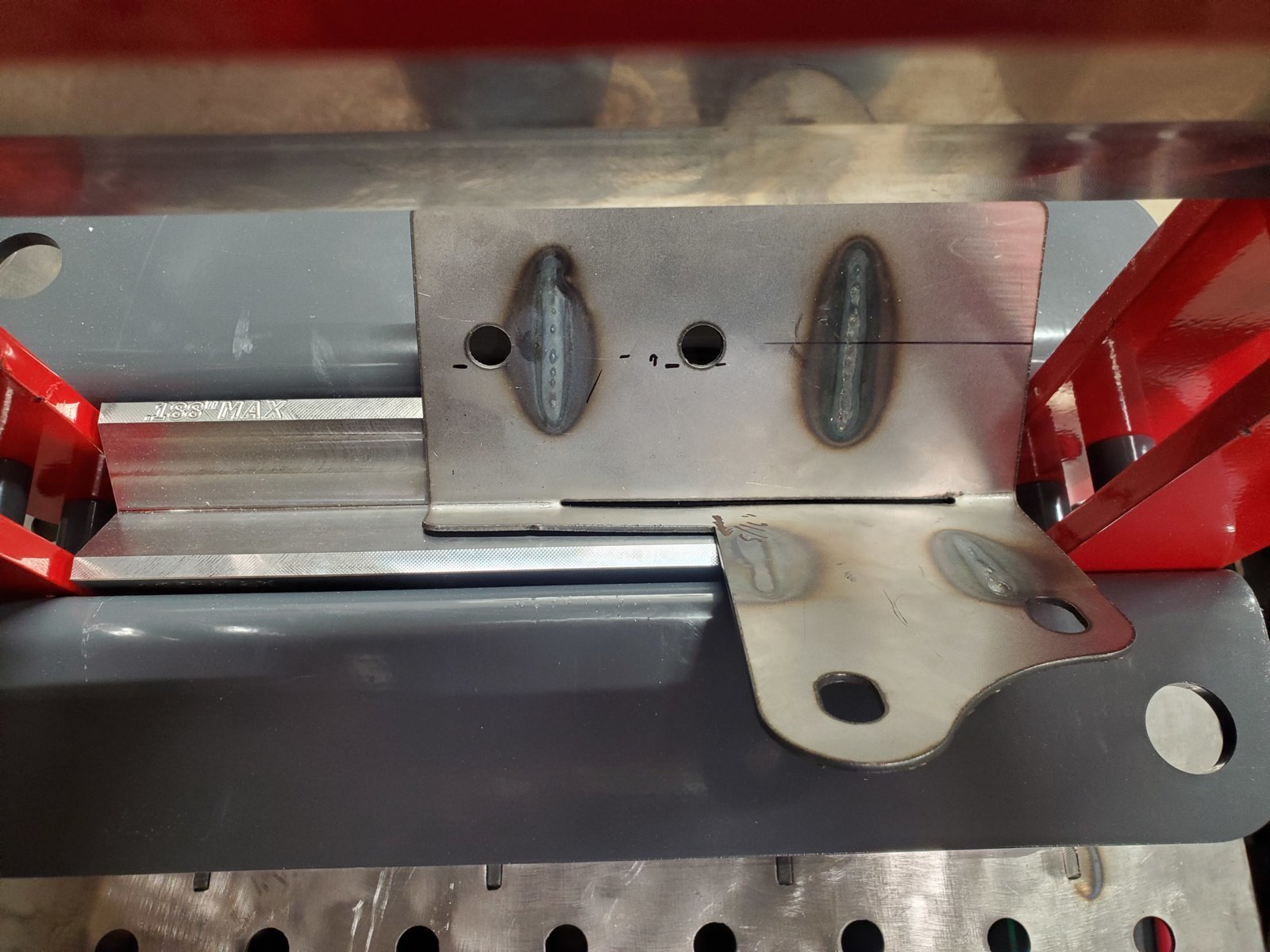

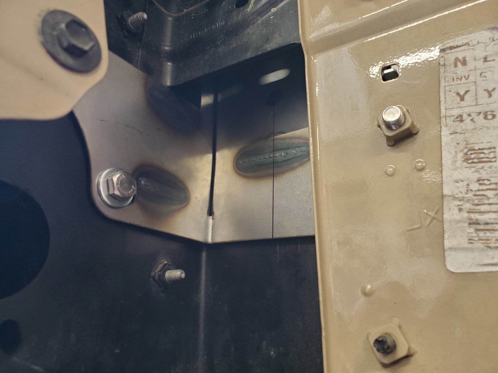

    Being that we got right to work on the truck, we didn't get many pictures *during* so I snapped a few at the last half hour of work.
    To start, tail light removal is simple as it's held by 2x 10mm bolts.
    I was being quite gentle with the tail light, but you really need to give it a hard yank to get the two locating pins out that hold it in place so just an FYI if you've never pulled them out.
    Followed by removing said bulbs out of the housing.

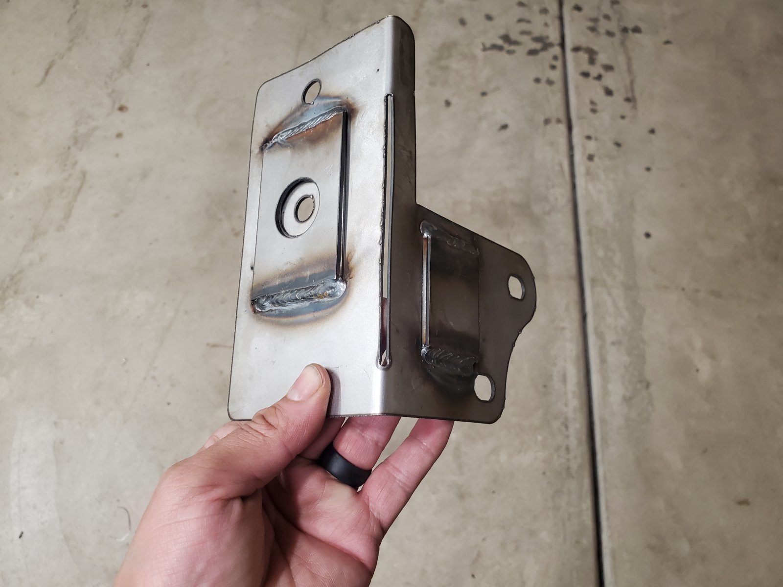

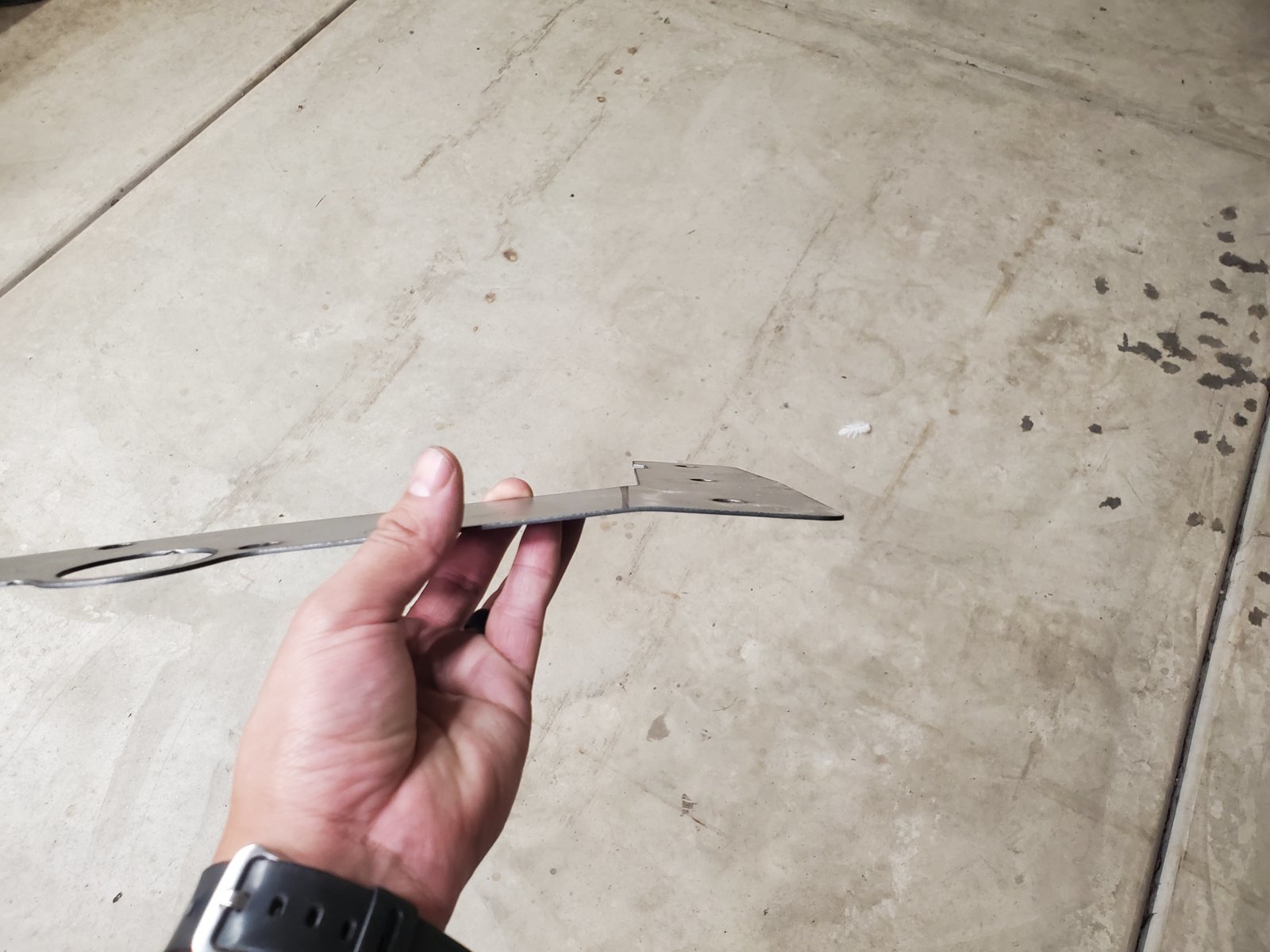

    The first small hiccup we ran into was the slightest bend here underneath/backside of the bed.
    Not as visible to see in this picture but here is the angle needed to fit flush against the inside.
    The L bracket itself though, fits just fine although I may enlarge the big opening there by 1/16".

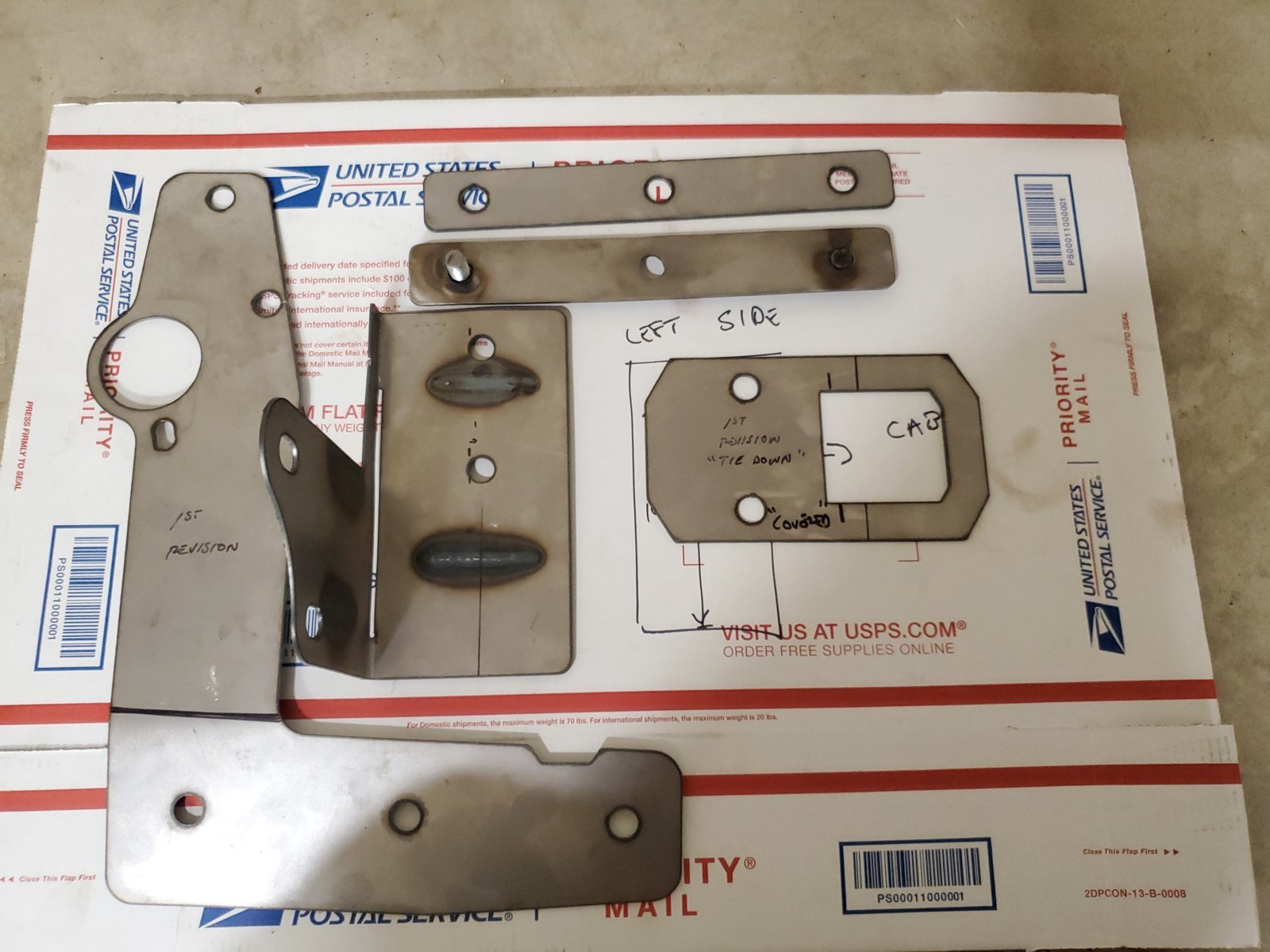

    The inner bracket with a 90 degree bend is the one we toyed with most, and rather than toying with 3/16" material (expensive), I opted to add spacers to make up for the actual thickness needed.
    I was supposed to just "tack" these :anonymous:

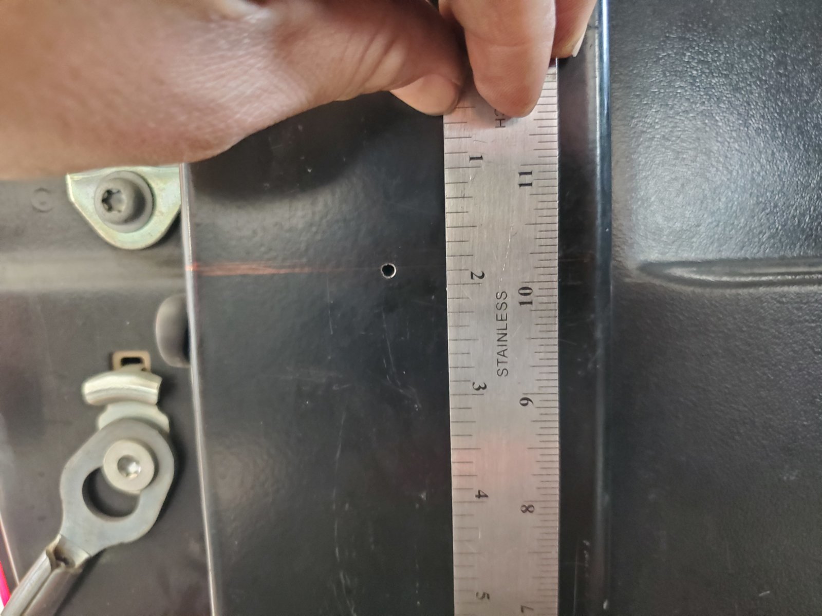

    We decided to use 4WP instructions for measuring 2" from the leading edge for our hole.
    One common thing I've read is how people were having to drill large holes, using a step bit even, for lining up the holes to match the brackets.
    This is how we measured 2" from the leading edge - keep in mind this is the DRIVER SIDE so the right edge is where 0 starts (towards the cab).

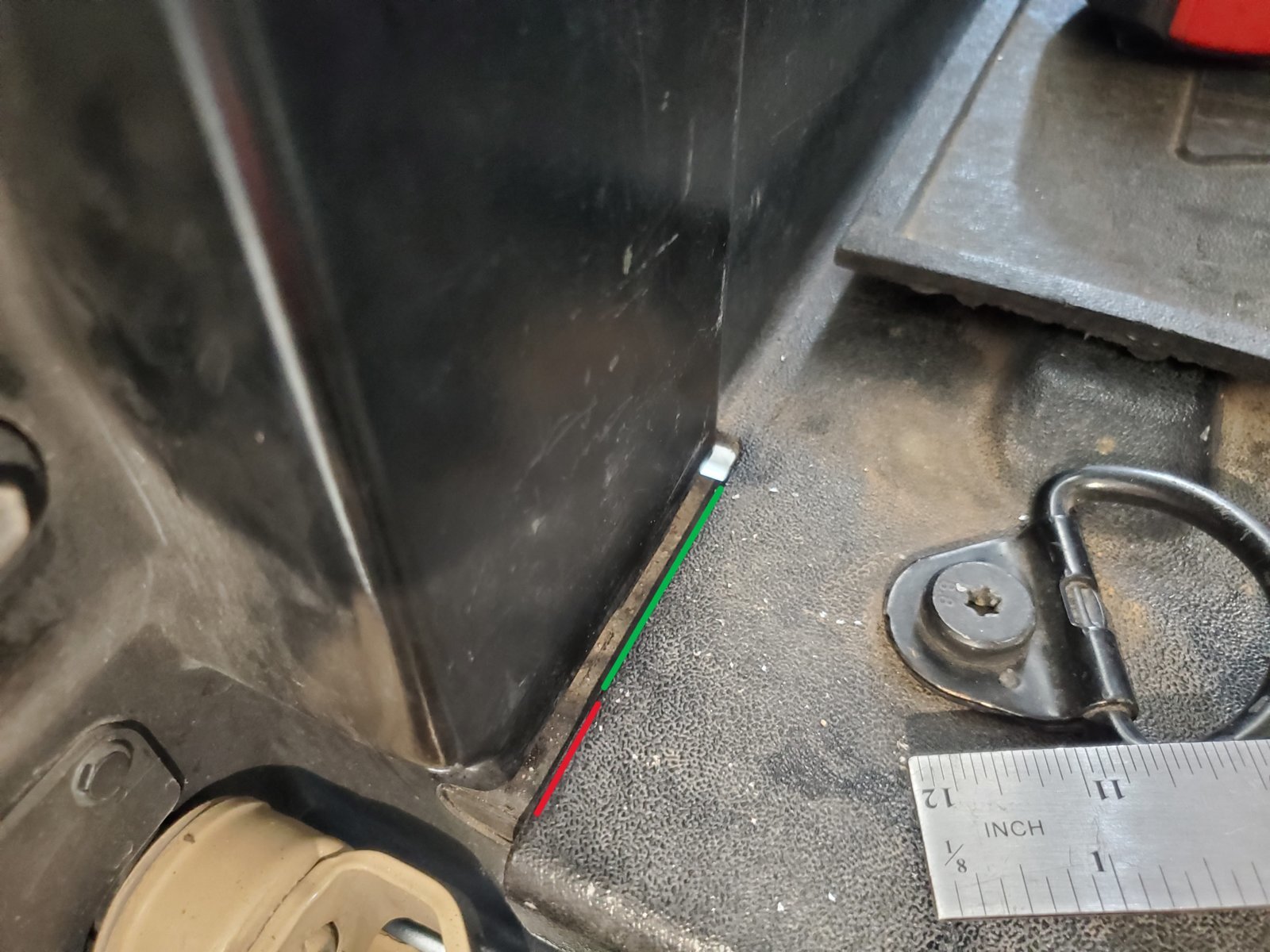

    Another thing to note for those watching.
    To measure up from the bottom of the bed, you need to ensure you are measuring from the metal.
    It is also very important to measure from the lower portion.
    There is a slight "hump" closer towards the tailgate, and it drops as you move forward towards the cab.
    For the center of the bottom hole, we measured 10 3/16" from the bottom up from the green.
    Best way to do this is put up your rule, mark a line, then draw a line straight across as shown here.
    You will see it measures at 10 3/16" for the center of the bottom hole.

    Just glad to now have a "master" mocked up set.

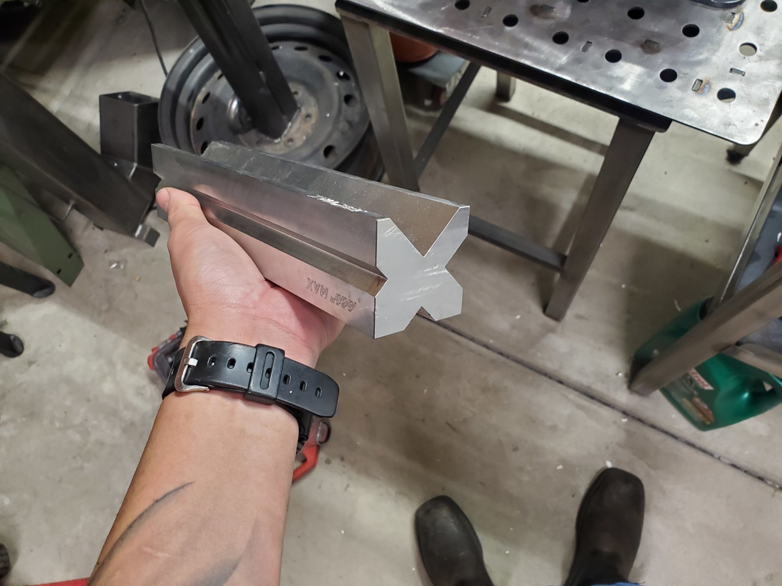

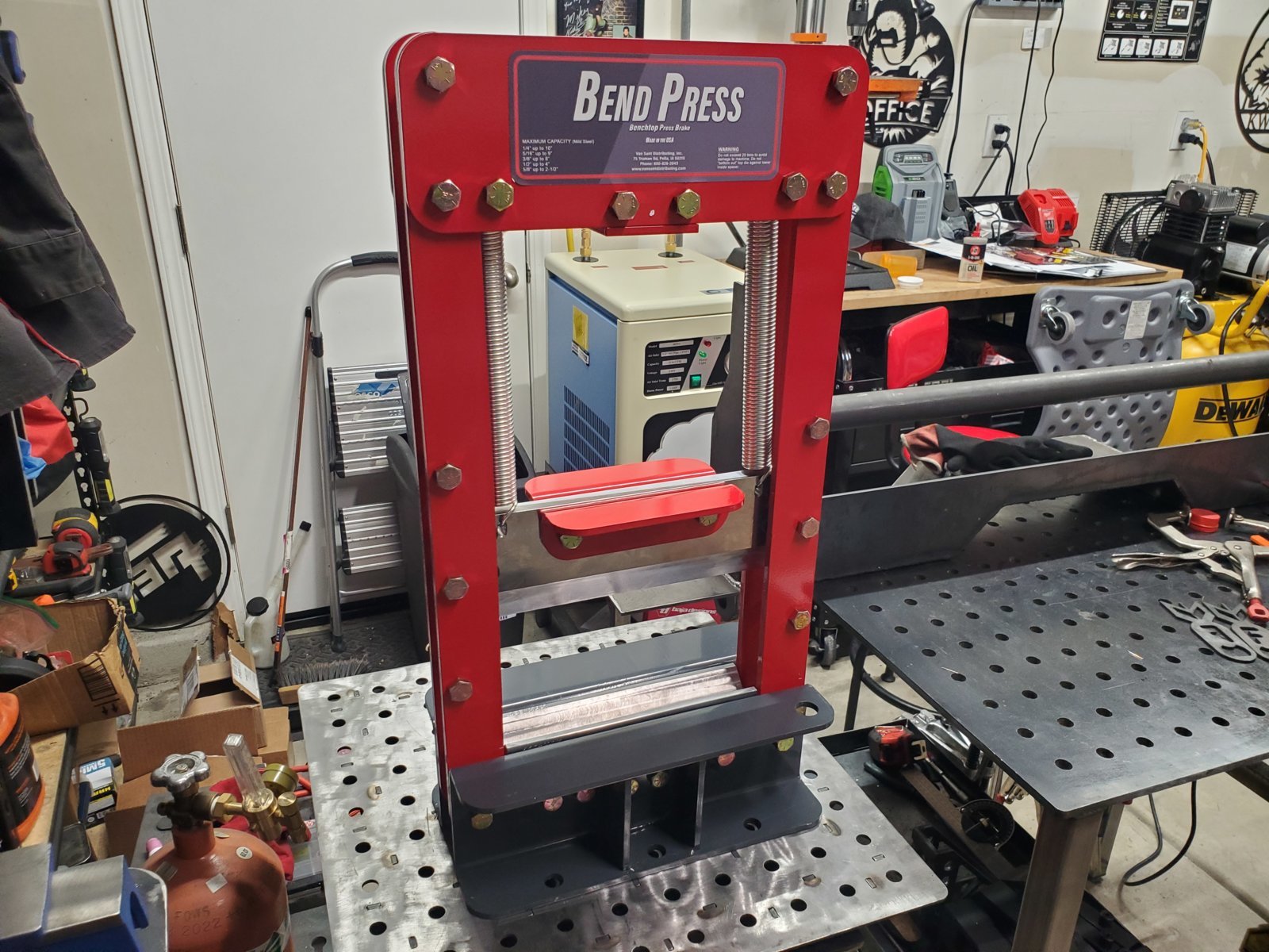

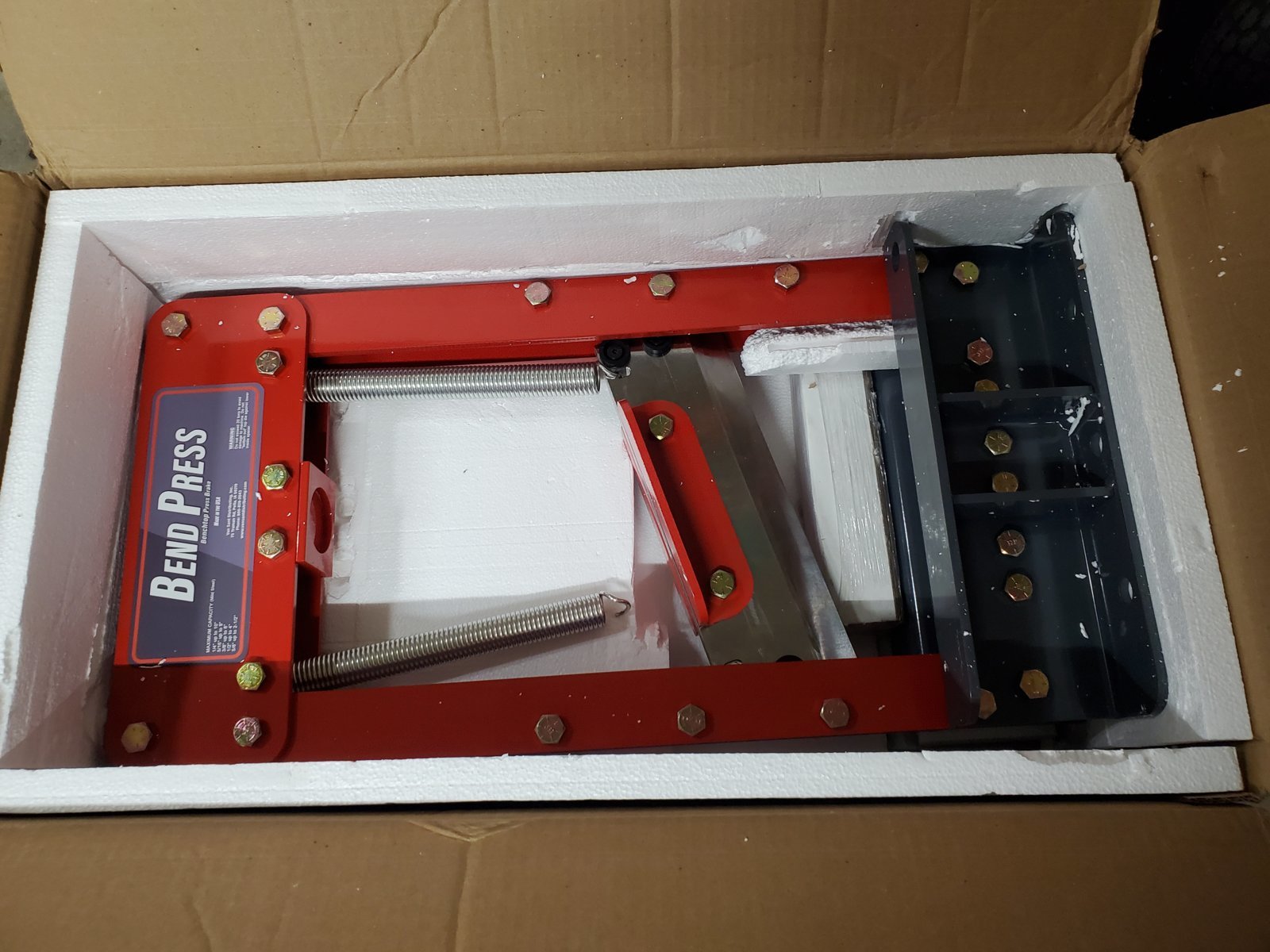

    To aid in getting these done though, I did invest some of my own money for one of these.
    Poor UPS guy.
    I went out immediately with a dolly and he just grunted as he put down the 100lb box :rofl:
    Was 103 degrees outside and I definitely didn't want him walking it up to my garage so I wanted to help any way I could.

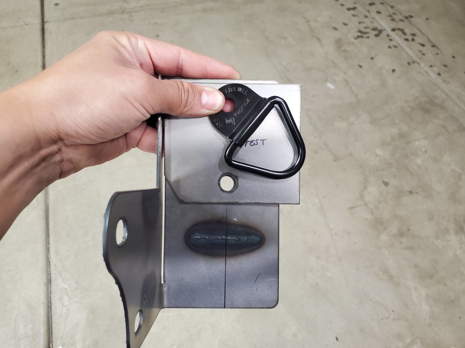

    With the brake here, it's relieving to know that I wouldn't have to add much to the bracket being bent.
    In order for the piece to be fully supported, I simply need to extend the tab on one end by 5/16" to fit the bottom die.
    And also, another member chimed in about keeping it low profile and adding tie downs themselves.

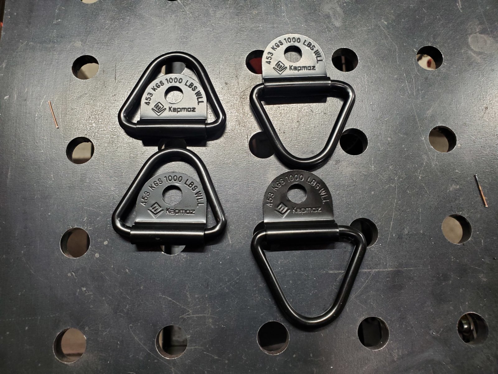

    I bought the very set linked in this thread and they just arrived; can confirm the hole size is a perfect match.
    So, you don't need to buy them from me but I'll have 4 on hand (enough for 2 sets) in case anyone wanted to go that route instead.

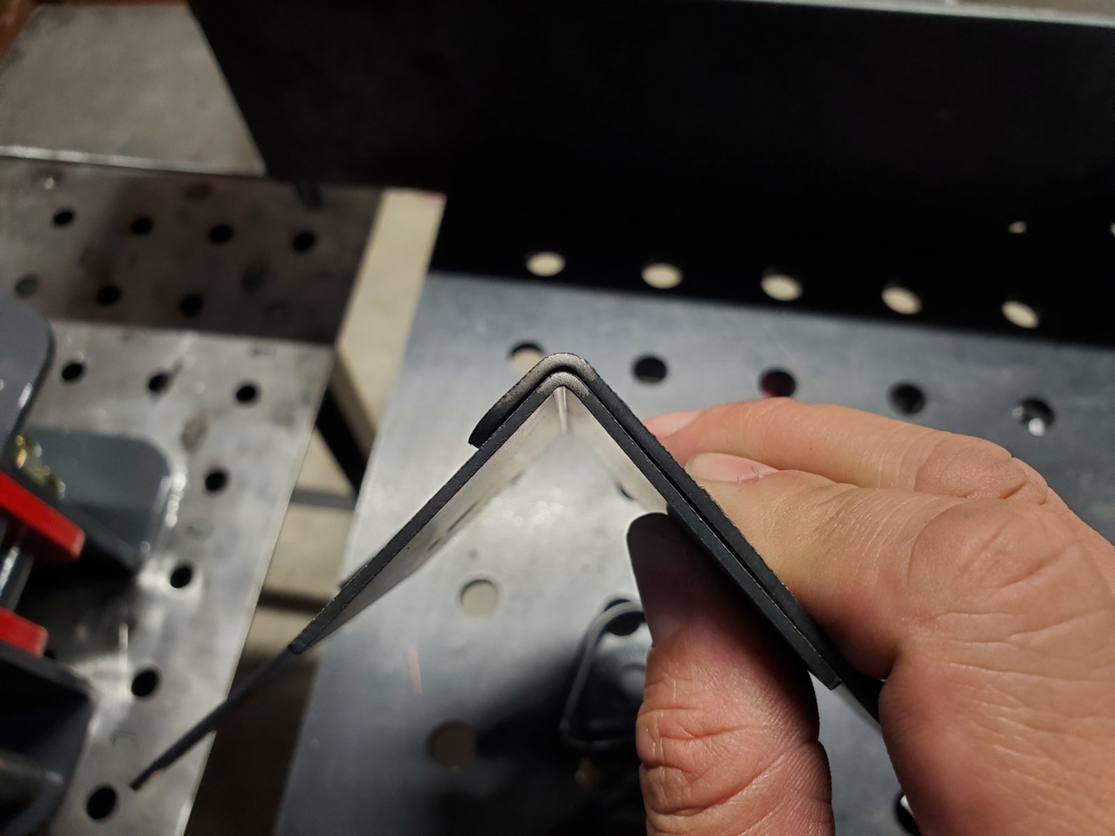

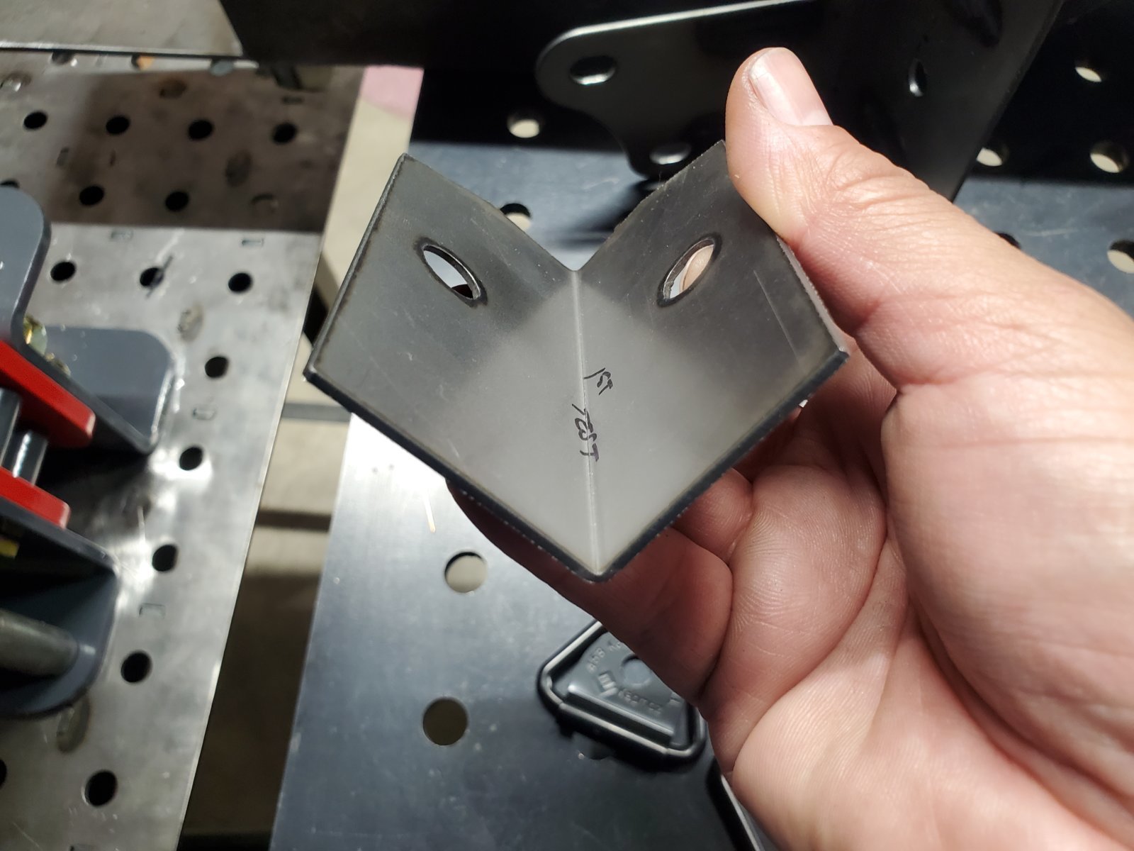

    Just had to try out the brake real quick so I grabbed one of those 16 gauge test pieces and bent it in half.
    Have to say, 16 gauge with a relief cut is pretty damn easy to bend so I was pleasantly surprised at how much tighter the bend radius is when using actual press brake tooling.
    Here's the mocked up piece, with relief cut.
    Here's a solid piece, bent on the brake.
    And the two stacked.
    You can see the smaller bend radius easily on the bottom piece.
    The "silver" coloring is the metal being stretched as it's bent.
    Excited to produce tighter bends on 3/16" than I'm used to when I owned my full swag kit.
