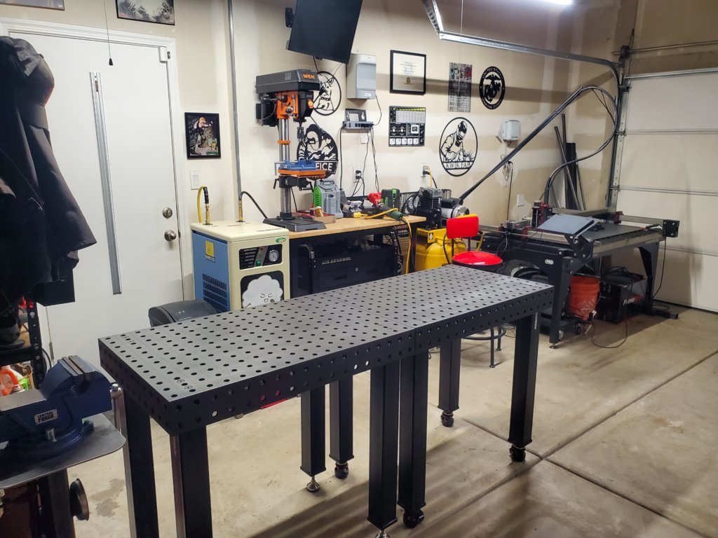

    My machine torch arrived a few days ago but being the middle of the week, I couldn't do much of anything.
    New one next to the old; I had removed my other plasma cutter from my table before that so basically I had my table down.
    During all that, I posted my other welding table for sale - literally sold the morning after posting it that night.
    I did manage to make 3 test cuts after clearing stuff out and installing the new torch. Problem is, I was getting a bit of bevel on one edge which tells me my setup isn't fully square.
    Takes forever getting it set right.
    At least the cuts are nice and clean, but done so much quicker than the other setup.
    Lastly, my second fixture arrived yesterday.
    The shitty thing is, the bottom had flaked and the bits got all rusted which lead to the top being discolored and getting some surface rust on it. Looks like an eyesore right now but I'm heading out later to grab some more WD40 and maybe some scotch brite pads and a new brass brush to clean it up as best as I can.
    Doesn't affect functionality though so no biggie. On the plus side, I got a partial refund for the table so that was a big win (I didn't even ask for anything in return).
    I still need to wait for my bolt kit to arrive to bolt the tables together, level them, and remove two legs that are on feet since I plan to have the center of one side open.
    Basically, shop stuff.
    But really to move forward with making more stiffeners, I need to dial in my plasma cutter otherwise parts will not be as accurate as they're supposed to be.
    That test piece posted above is supposed to be 2" x 2" with a 0.625" center hole.
    The measurements bring it to .003" on average all the way around; the goal is to remove that top edge bevel and maintain (or improve) the accuracy.

    On another note, the other fixture cleaned up really well.
    Tomorrow I'll be spending some time dialing in my table a bit.
    Unfortunately I'll be using 3/16" to do so but it's the best way to deal with the beveling issue and getting things spot on in order to resume making these stiffeners.
    Not shown are all the clamps, squares, press brake, and other tools spread on the ground because I need a spot to place them all.
