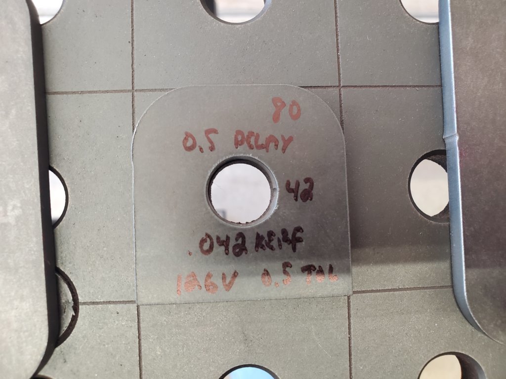

    Had a little bit of time yesterday to do some test cuts in 3/16".
    The small "gotcha" here for me is that the entire design was done around a different plasma cutter and torch.
    In the next few days, I expect to adjust the L bracket on CAD and proceed with cutting out a test part or two.
    @NoOne has been especially helpful in taking his time to pinpoint the adjustment for the lower slot, as well as marking where the upper slot is as well. It's just tricky trying to convey pictures to an actual dimension.

    Seems I may have to strip down the table.
    Technical difficulties as I do not like the beveling and there was a lot of beveling on a set of internal stiffeners I just cut out.

    To add a bit more context -
    I had found what would be, ideal parameters for great cut quality and tolerance to .005" from my CAD.
    However, I was running into a beveling issue specifically with two edges being quite a bit more beveled than they're supposed to be. The other two edges were square, and I mean perfect.
    I ensured both lead screws on the one axis were perfectly square with one another, on top of having unmounted and mounted my torch multiple times.
    I've trammed my Z axis and have ensured my torch mount is perfectly square with my cut piece.
    During all this I've ran multiple test cuts in ensuring the ideal nominal voltage for a specified cut height.
    I decided to walk away from it today and will proceed to do the following between tomorrow and the rest of this week -
    1. Install new consumables, in the event that there may something wrong with the current set
    2. Fully remove the new torch and plasma cutter and reinstall the other set, I still have them in my possession
    3. If both fail, uninstall the entire gantry tube and start going through frame assembly all over again
    The last option can set me back quite awhile on account of my bad back so let's hope one of the first two options solves my issue.
    NoOne likes this.

    Naw you're good. Those are excellent suggestions but a moot point here since -
    Table was leveled over a year ago when placed where it is.
    Table is confirmed for being level every few weeks; I throw the level on each gantry tube and had done so again 2 days ago.
    I methodically catalog everything, and performed way more cuts than I implied looking for the changes in beveling.
    The large factor that determines beveling is something I'm attempting to correct which is my nominal voltage - initial pierce collects data in establishing output voltage before it attempts to reach target voltage which in this case is 126v.
    When CNC plasma comes around a small radius, programmed speed slows down (naturally) which in itself fluctuates voltage readings causing the torch to compensate for it - voltages rose as high as 128v before it goes down to the target voltage.
    My only gripe is how it varies by as much as 1-2v any which way around bends which can cause as much as a cut height of .04" up to .08" even though voltage tolerance was set to 0.5v.
    Since tests being repeated with various settings only got a "little" better (or sometimes worse), I opted to perform more troubleshooting by dismantling the torch holder assembly and ensuring things were square before even posting.
    I've trammed the Z axis to ensure nothing is twisted and everything is square.
    When I ended the day yesterday I decided to swap consumables and continue with testing today.
    If all else fails, I will reinstall my other plasma cutter and torch in order to knock the rest of these sets out and just bench the Hypertherm until I get a new table down the road. If this does not fix the issue, I'll be dismantling most of the table to go through ensuring everything is perfectly square and level all over again but as an assembly process, not as a fully assembled unit (the water table has 15+ gallons of water).
    NoOne and ERod27 like this.

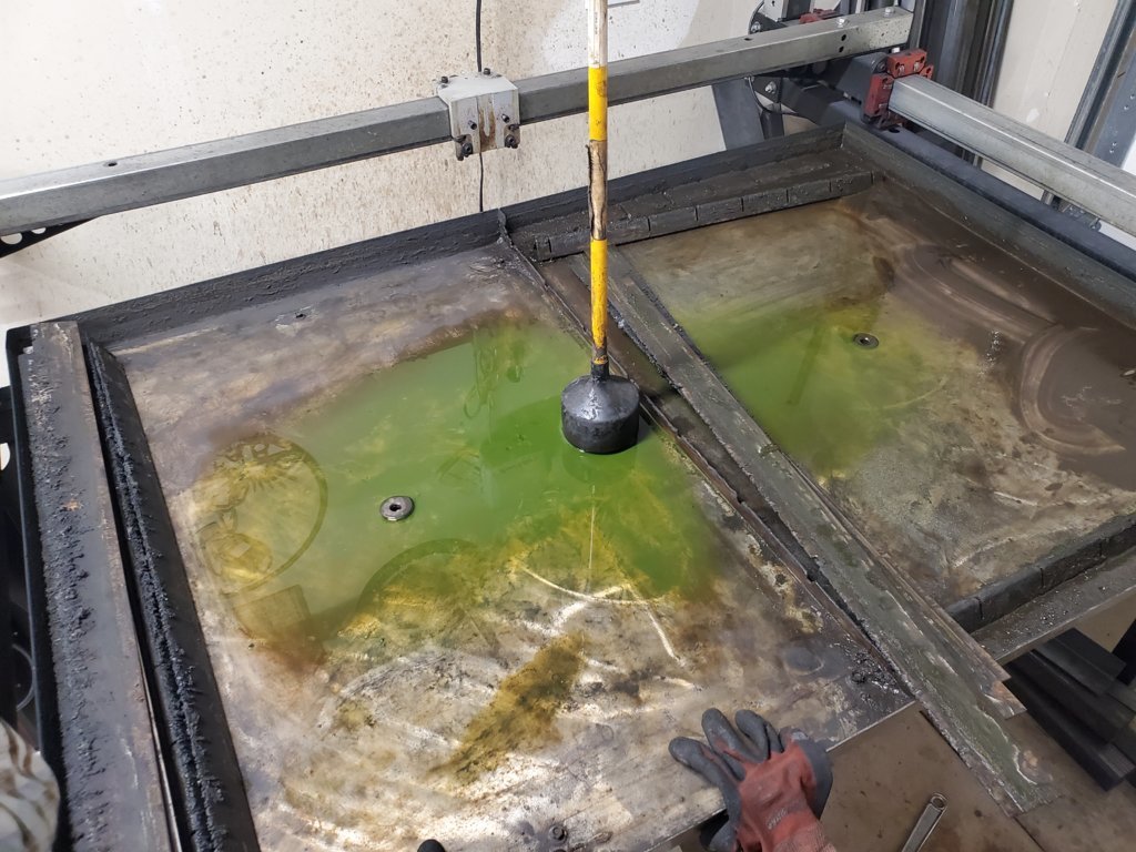

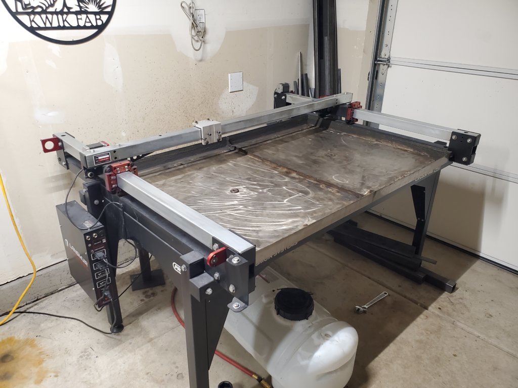

    Everything's good though; funeral this Wednesday.
    Finally finished cleaning up the waterbed, removed the lead screws, and cleaned up the gantry tubes as well.
    Currently the bearing blocks are all loosened up as I'll need to go through and check all 32 bearings.

  20. Sep 22, 2024 at 2:28 PM
    #1280
    ERod27
    ERod27 Well-Known Member
    Mar 3, 2019
    #285264
    433
    Eddie
    2019 TRD OR DCSB
    King 2.5s with Camburg Kinetik UCA Cooper Discoverer AT3 XLT 285/70/R17 17" 4 Runner TRD PRO SEMA wheels TRD PRO skid plate 5.29 Yukon gears Apogee front bumper with Warn EVO Apogee rear bumper with tire carrier
    Looks nice!
    NoOne likes this.
