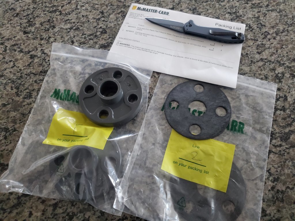

    Flanges and gaskets arrived.

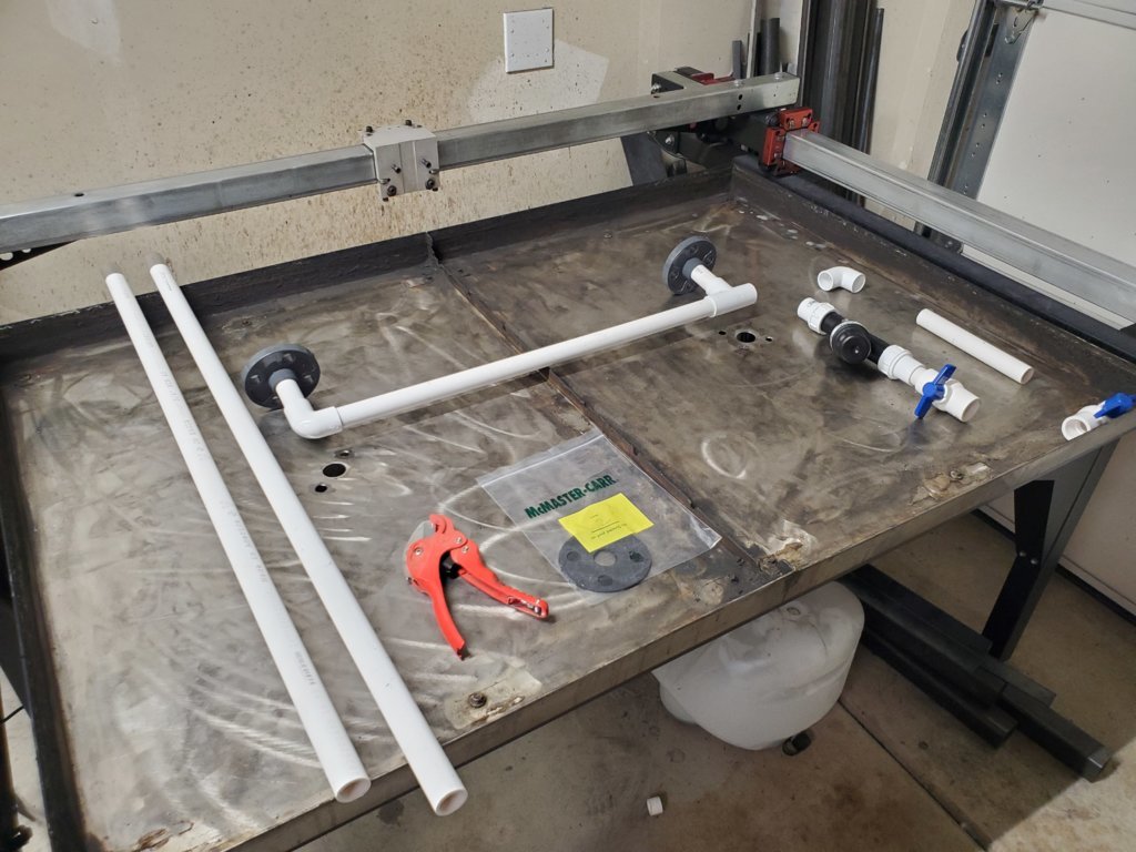

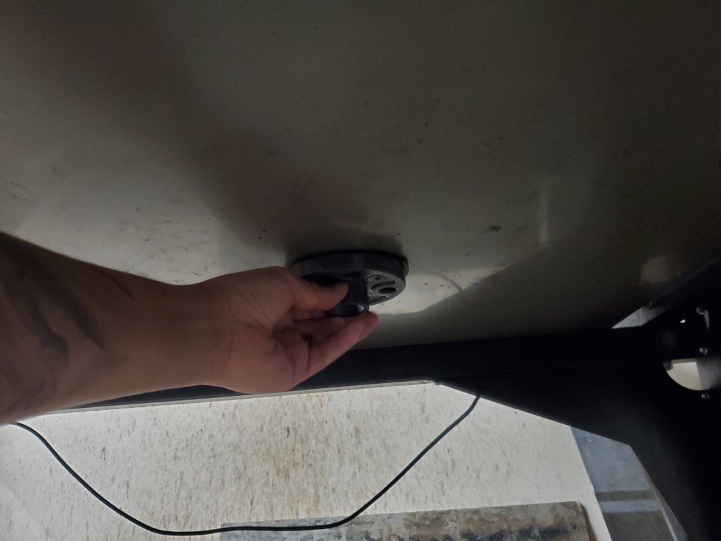

    Super basic, just need to pick up another T as well as a check valve.
    The T will be placed nearby under the second drain and act as the split for both a drain and refill.
    Coming immediately down from that T you'll see an inline filter followed by a ball valve. I'm implementing the ball valve here after filtration so I can close it when water needs to keep from draining from the water bed.
    To the right of that is where a check valve will go facing up towards the water bed to act as a means to refill. This is where the other end of the T will connect to (along with the elbow).
    Ignore the second ball valve. With the check valve in place I won't need it.
    Will have plenty of PVC pipe left after this.

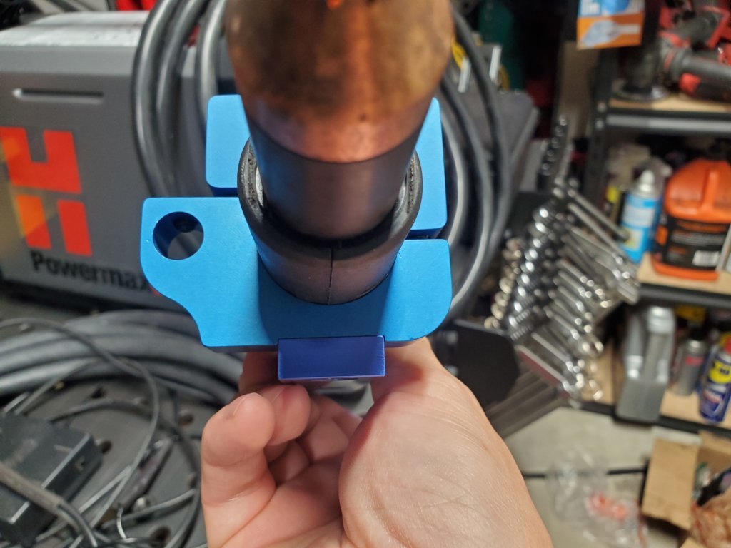

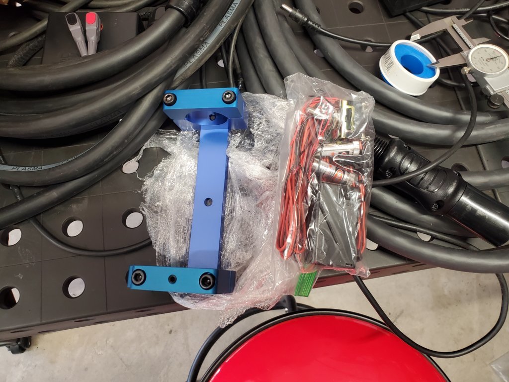

    So, an update to the saga.
    A member wanted to sponsor me a new torch mount, to show me the benefits of what his product has to offer.
    It just came in today and I'm pretty excited about it for two reasons.

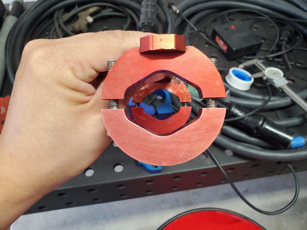

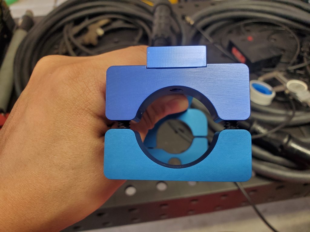

    The first (and main reason) is the clamping style of this mount versus my existing one.
    The mounts are made to fit specific torches and are sized as such.
    The stock one I've got uses a V style clamp, which results in these "pressure points" when clamped down. The only benefit to this is that it can accommodate a wide variety of torch sizes.
    Now, I've never had any issues with this style clamp but know of plenty that have.
    I've ensured that newbies that join the hobby know not to apply any real force when clamping their torch head, or avoid clamping the head altogether (if possible). Certain brand torches have internal moving parts which can easily be damaged if they're tightened a tad too much, which is possible with the V style clamp.

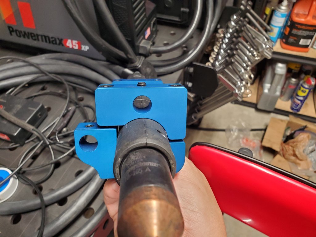

    The second benefit of this new mount is the implementation of lasers. A lot of people use 3D printed add-ons, or make their own offset mounts, but this torch mount accommodates two lasers for quick and easy zeroing.
    I never used lasers, and never felt like I needed to. That is until I had the tip up incident some weeks back when I got to cutting the very first batch. Post found here
    I had a tip up (normally avoidable) but it happened so fast and it threw off my zero forcing me to throw away parts for two sets. Had I been using lasers, I would've been able to zero back to my original start point.
    Here's the torch inside the mount.
    On another note, I did find a bit of binding in my Z axis mount. Called up Langmuir to see what parts I might need to order exactly and they said "we'll extend the warranty for you" and opted to send me an entire new Z axis assembly.
    So, new torch mount in hand, and a new Z axis assembly on the way, and this thing should be running better than new.
