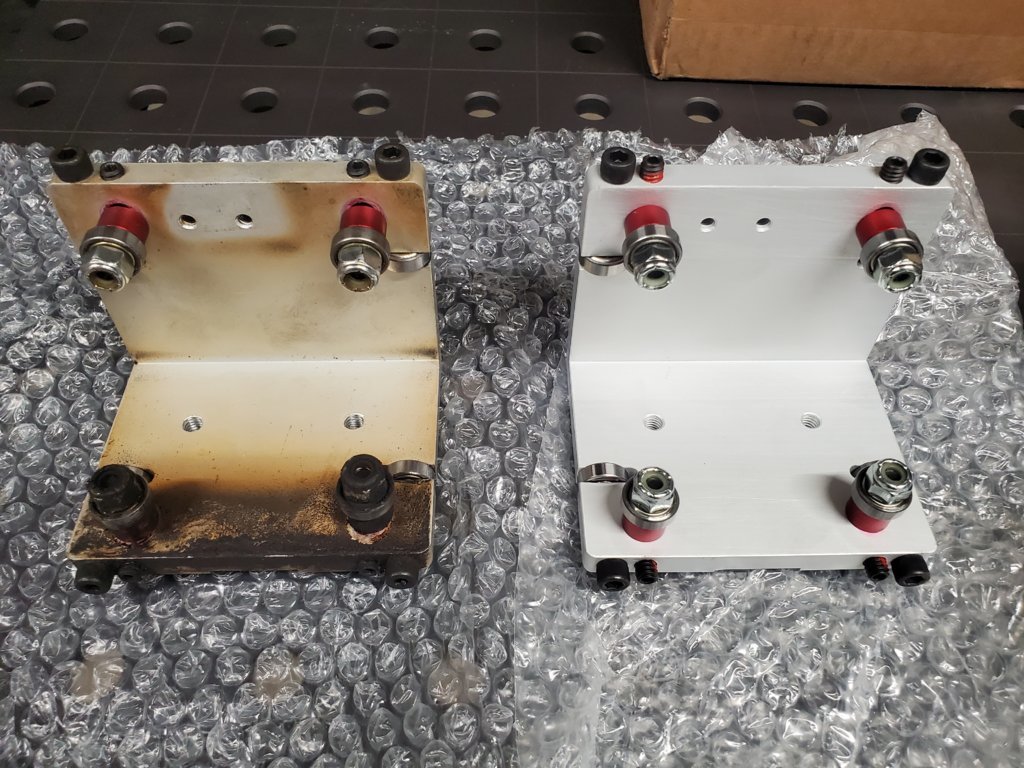

    Here's the old one.
    And the new one, although I did not expect to receive a new rear mount as well!
    Going to have to jog my setup and start taking apart a few other things to remove mine.

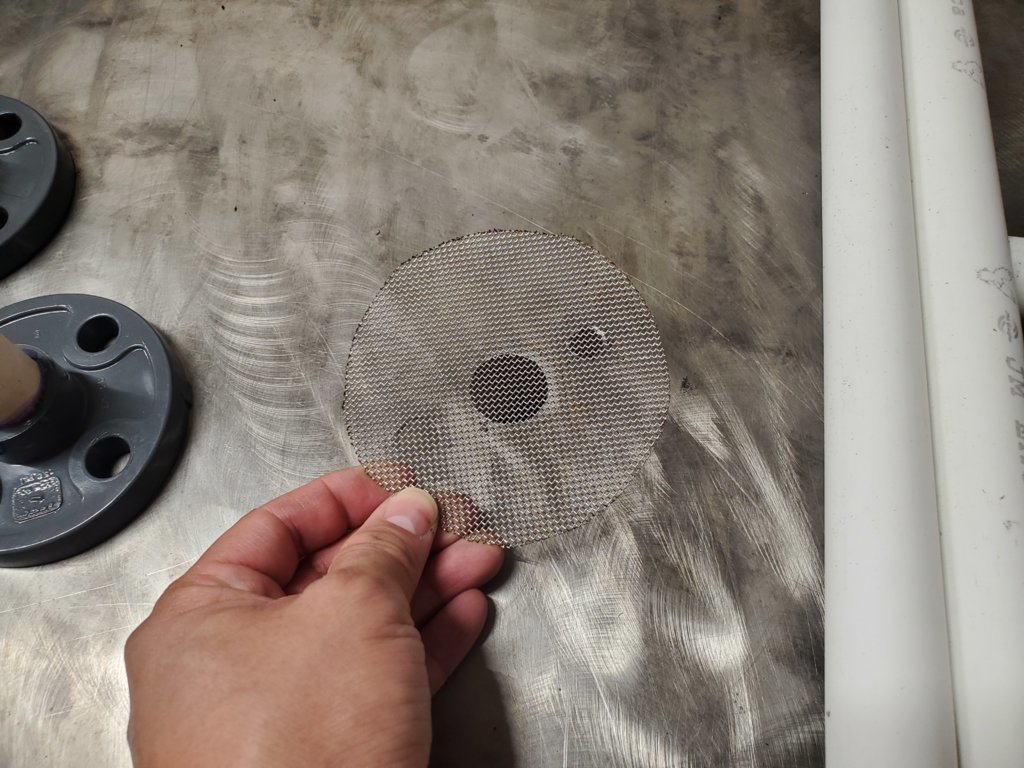

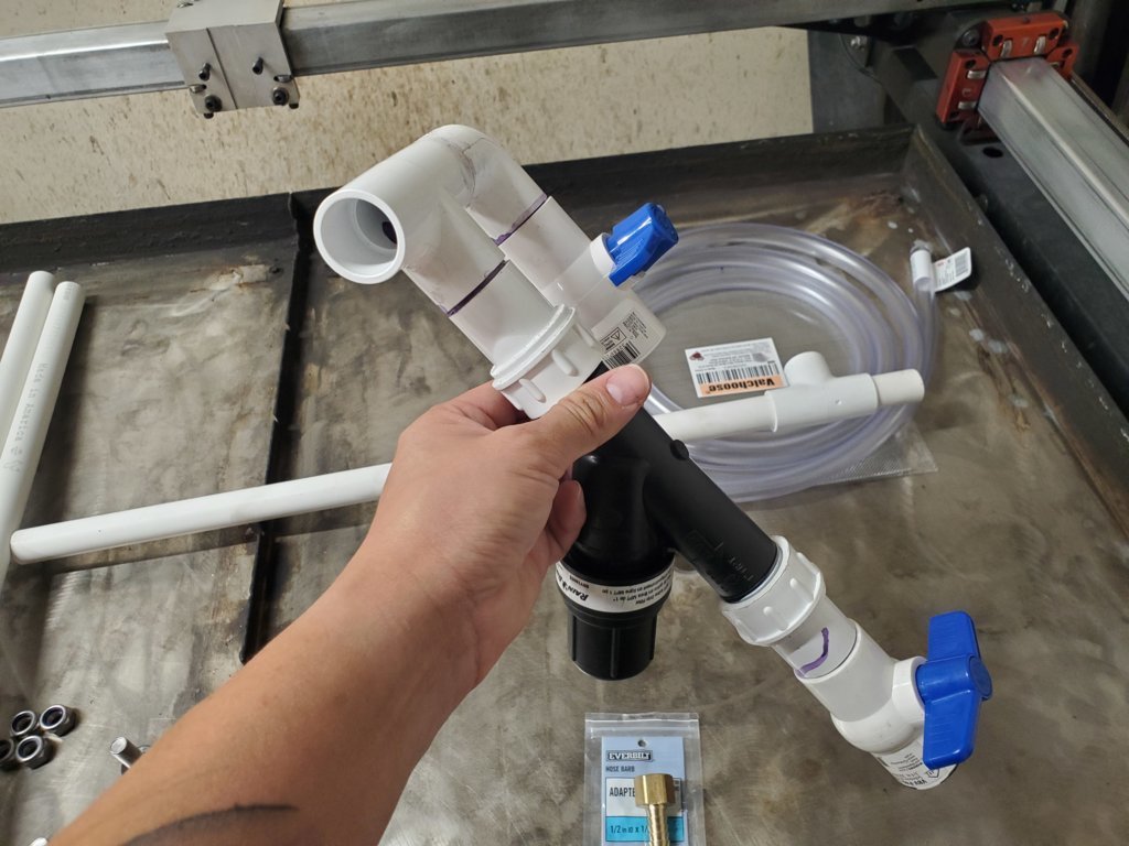

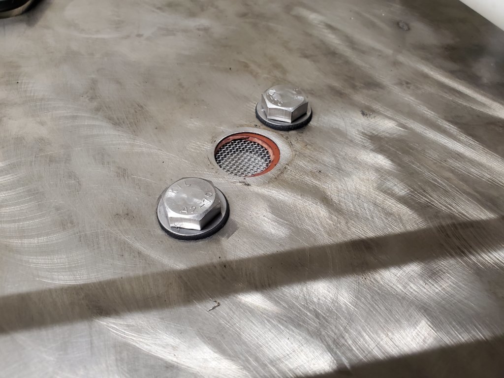

    In anticipation of parts arriving I went ahead and finished up a few things like gluing up the drain and refill end.
    For clearance reasons, I'm thinking of gluing it angled as shown.

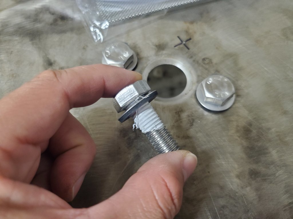

    I enlarged the holes in the water bed to utilize larger hardware, as well as getting some bonded washers to make sure everything is water tight.
    As well as some wire mesh to act as my initial "filter" before it goes down the drain.

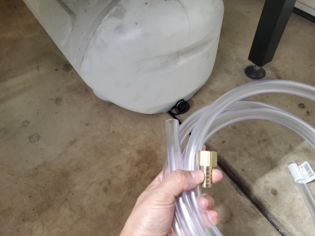

    And lastly, I'll be using a barb at the drain on my reservoir to feed my table from; this end will use vinyl tubing to attach to a transfer pump, and the transfer pump will output up the refill end of the drain.
    There's just the matter of incorporating my stainless steel mesh. I could "slot" it to barely get clamped by the bolts. I just didn't want water seeping out.
    I could also just go between the gasket and the flange, or at least the gasket and the table bottom, but that might create a larger gap than the above bolt situation.
    In short, I don't want to glue anything directly onto the table but also don't want to have any leaks. I may just have to go out and buy some caulk.

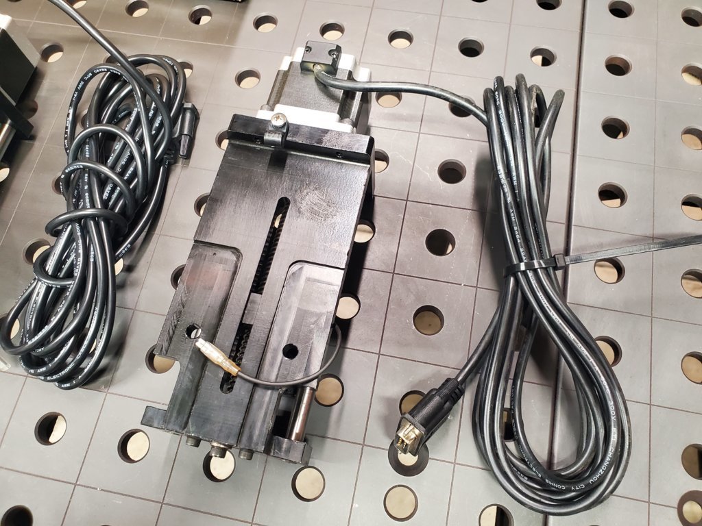

    And my fucking luck, the part holding the spring for initial height sensing is broken on the new assembly :annoyed:

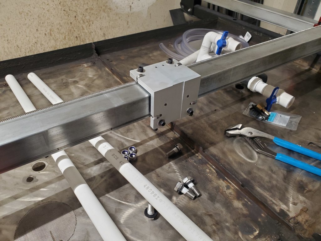

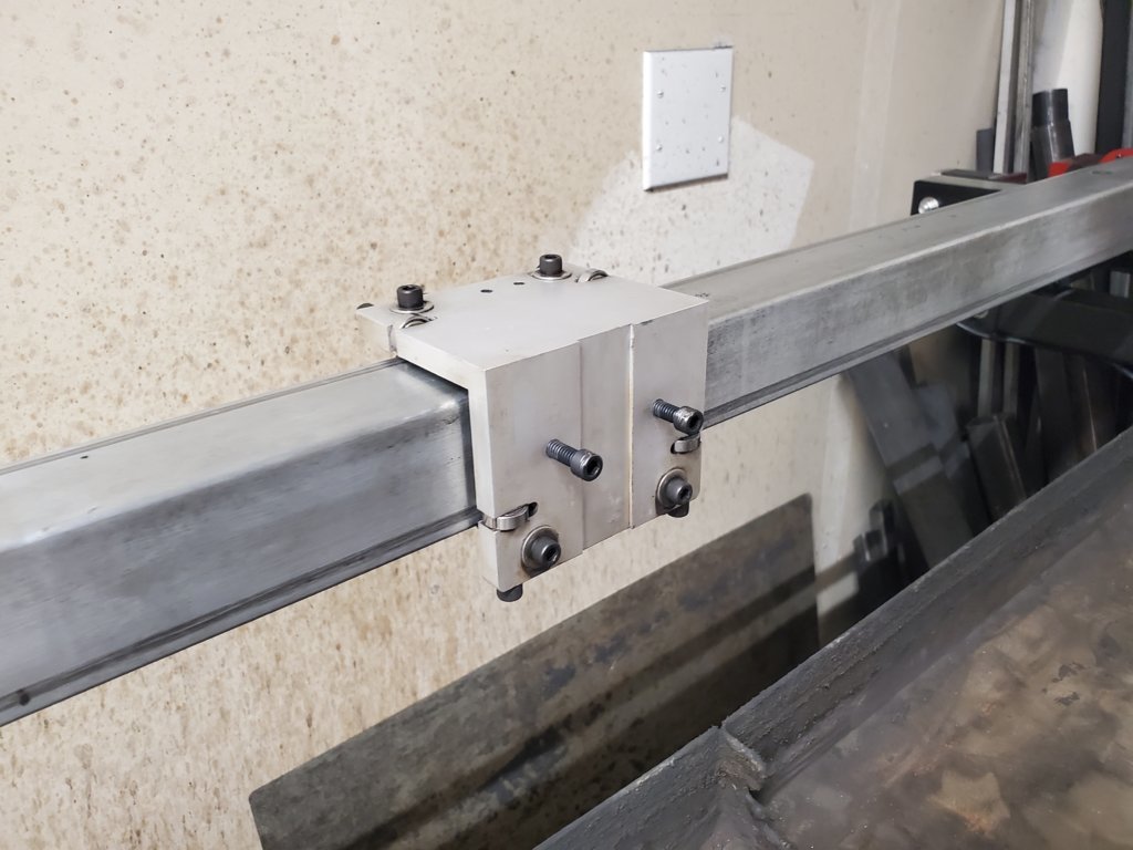

    Old Z axis mount next to the new one.
    Installed, trammed, and ready to accept the Z axis.

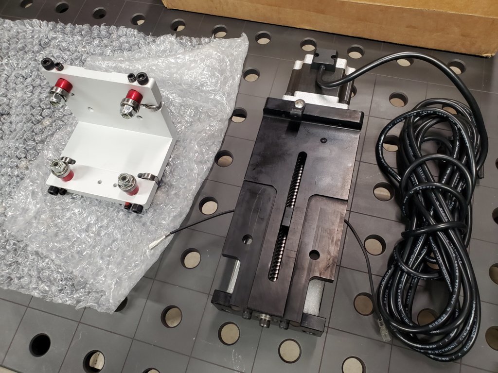

    And the moment my heart sank after finding this piece of plastic on the foam inserts.
    The little notch on the right is the spot where the spring sits. It's positioned between these two bearings and it is used for providing tension on the IHS switch when the torch drops down to push against the work piece and open the circuit.
    So, I shot an email out asking what I should do. I can cannibalize the new one to take out most of the parts and put it on my old one (specifically the motor, lead screw, and bottom bearing) or if they just want me to send it back.
    We'll see.

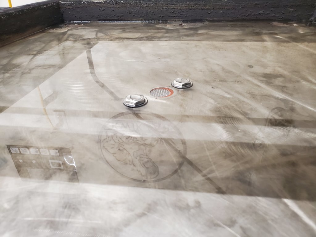

    Here's the idea, hoping it remains water proof.
    I'll test this one side tomorrow.
    NoOne and ERod27 like this.
  12. Oct 4, 2024 at 6:07 PM
    #1332
    GunthorNC

    You should look into e6000. I know you said you didn't want to glue anything to the table, but the nice thing about e6000 is if you want to remove it, grab it with pliers and rip it off. It comes off 100% clean. It cures into a pliable rubber type material. stretchy, bendy, and hold's very very well. For the screen I'd honestly just put a circle of e6000 around the hole, and press the metal screen down onto it, pushing it through the mesh.

    4 run, 2 don't
    My ADHD got the best of me so I thought, let me fill it up as high as I can (without it overflowing to the right side) and leave it overnight.
    So far, the pipe below is full and there are no leaks anywhere around the flange.

    I will say, water held all night.
    There was a droplet of water built up underneath but it was where the elbow and unglued PVC mated together. It isn't glued because I still need to finish up the right side of the drain.
    The entire rest of the flange however was bone dry.
    NoOne likes this.

    What I mean is, the tank holds 15 gallons but has room to maybe accept 17-18 gallons
    The table itself holds a maximum of 17 gallons which reminds me, I may as well buy another gallon of water additive.
    Also just got done draining the table. Stupid quick and easy so I'm stoked about that.
