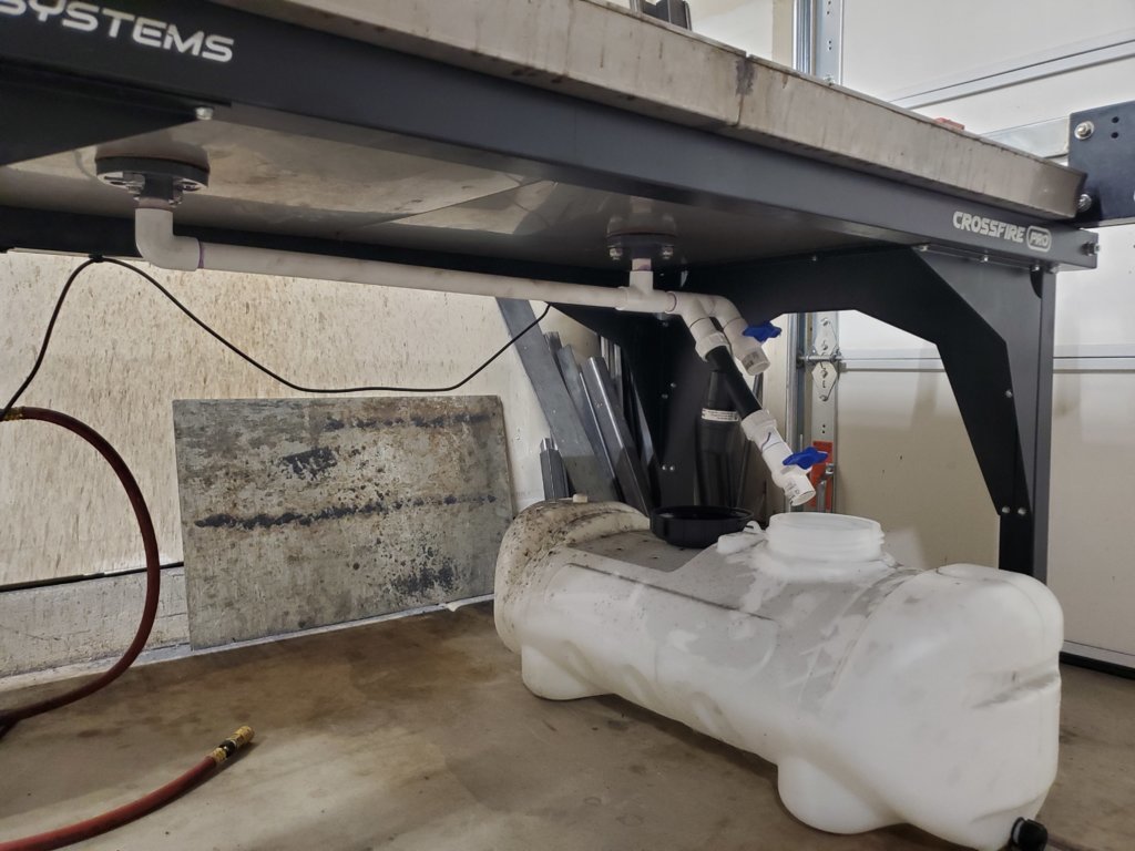

    Later today I'll be making the second drain, then gluing up the PVC pipe and see about ordering a transfer pump.

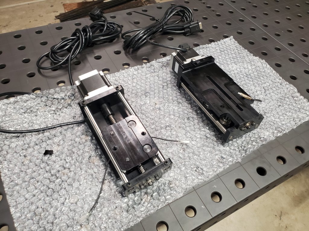

    Short version - still inop.
    Long version - I finished plumbing the rest of the drain this last Friday.

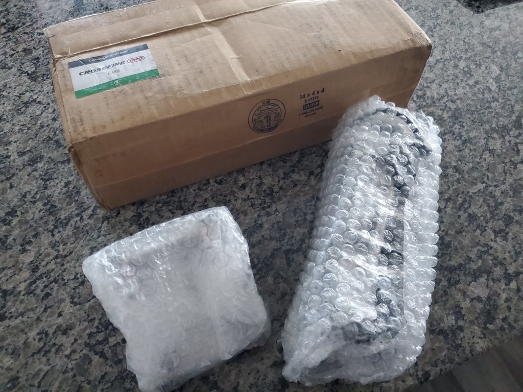

    My replacement Z axis assembly also arrived Friday.
    New parts began to take place in lieu of old ones.
    The actual torch height control assembly arrived broken.
    It was after hours so all I could do is send an email asking -

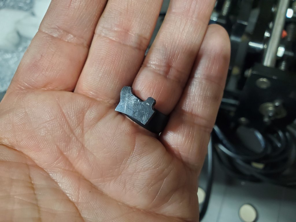

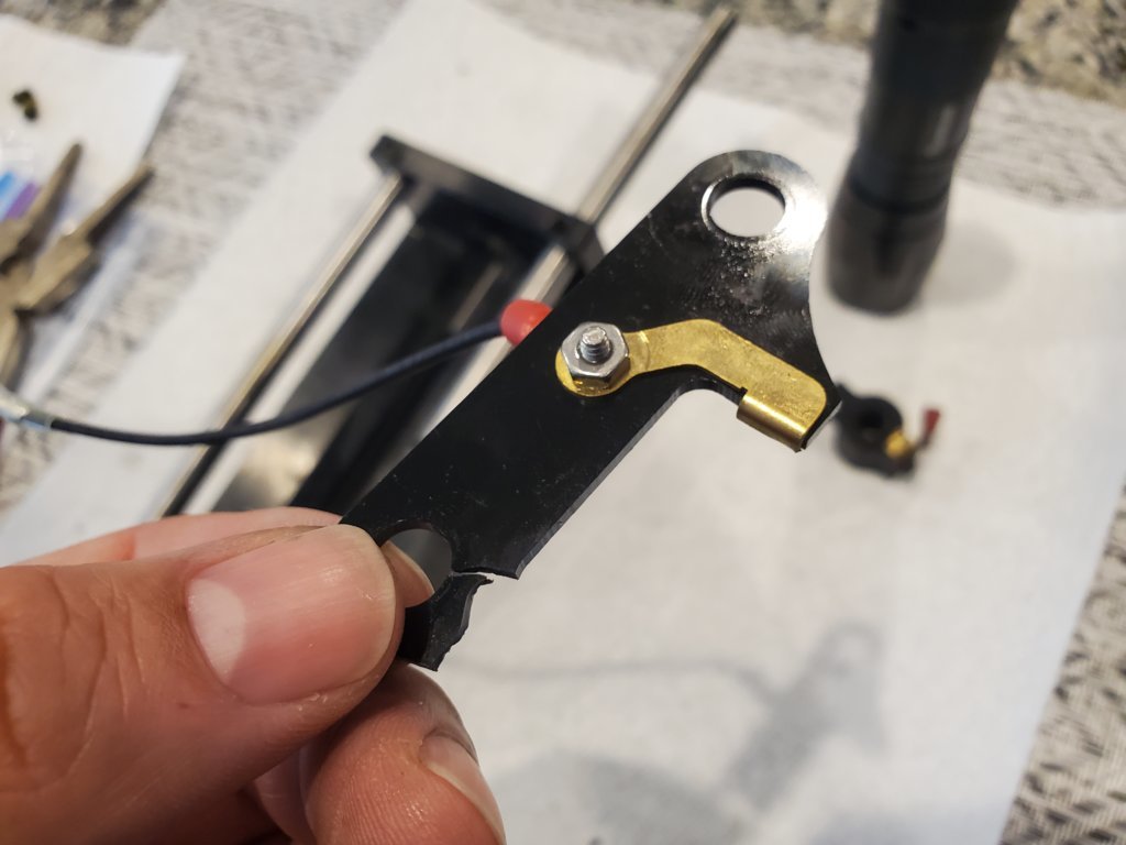

    "Received the entire new Z axis assembly. The "tab" holding the small spring for the IHS part of the assembly was found broken inside the bubble wrap.
    Pictures included are the new Z axis assembly displaying the void, and my current old one displaying the tab still intact. And lastly, the piece in my hand was found in the bubble wrap.
    Was wondering if you guys want me to utilize the parts from the new Z axis and transfer to my old or? I'm good with any method suggested."
    This morning I received this response -
    "Hey Nelson!
    Here's what I'm going to do. I'll send one just in case to you. If you can use the old parts and see if you install them. The little spring is super glued just wanted to let you know about that. Let me know how everything goes. I'll be here to help."
    So, I will look into taking apart the new assembly and seeing what I could install on my old assembly to get it going. Although I hear it's a real pain to dismantle and get back together again so worst case, I have a new one being shipped out soon.

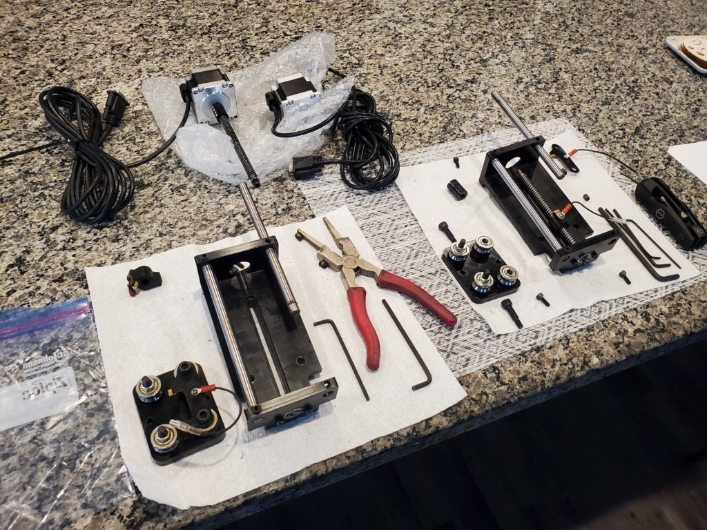

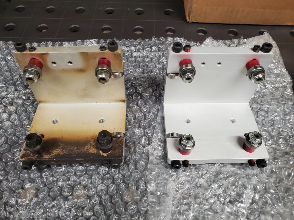

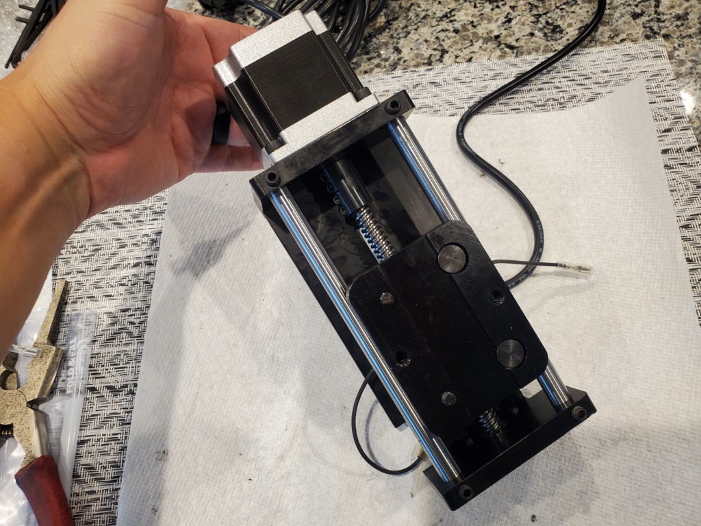

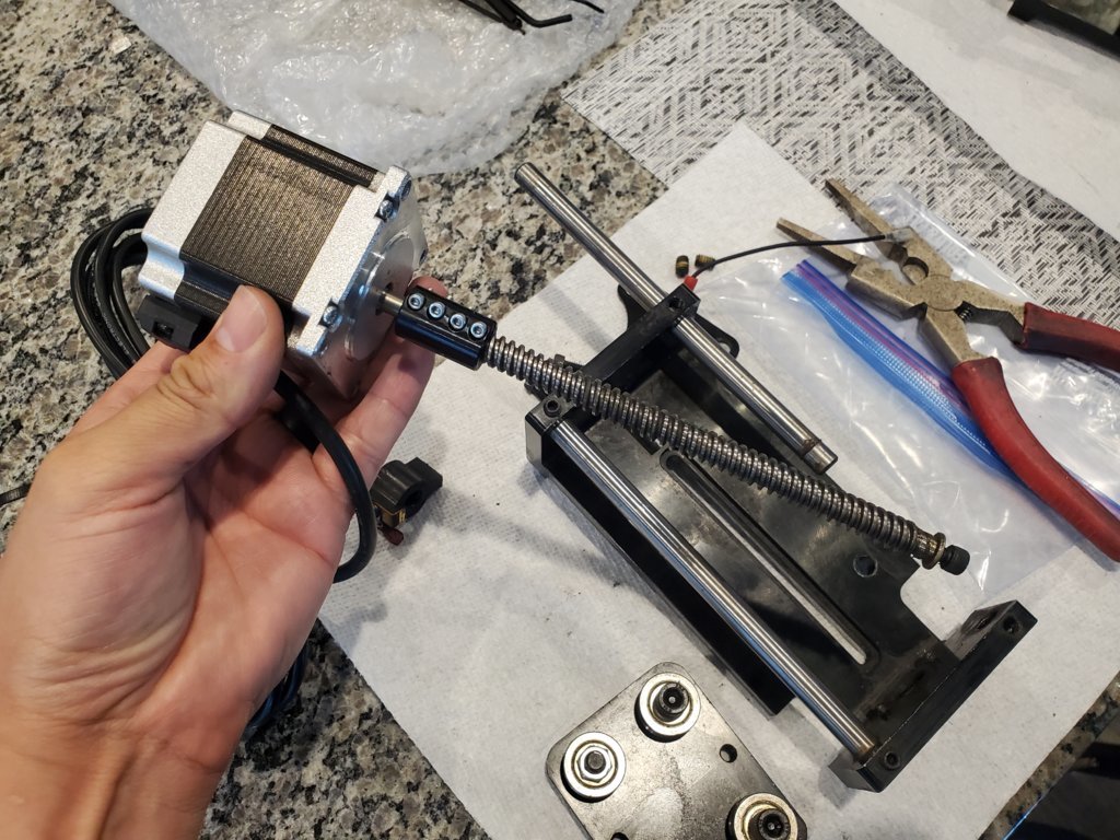

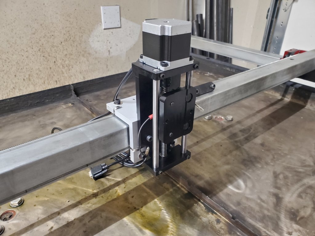

    ADHD knows no bounds.
    Little one woke up so had to move work into the kitchen while he snacked.
    Old one on the left, new one on the right.
    I had trouble with the coupler on my old setup seeing as how the socket head screws stripped up top, so I pulled the motor and lead screw assembly out.
    All this to remove this broken part from the new assembly, and replace it with the fully intact part off the old assembly.
    Back together again.
    And installed!
    Boring stuff I know, and completely irrelevant to the stiffeners offered in this thread. But just showcasing how easily it is to go "down" when something isn't working the way it's supposed to.
    Hoping to wire things up this evening and see about test firing some cuts in the next few days.
