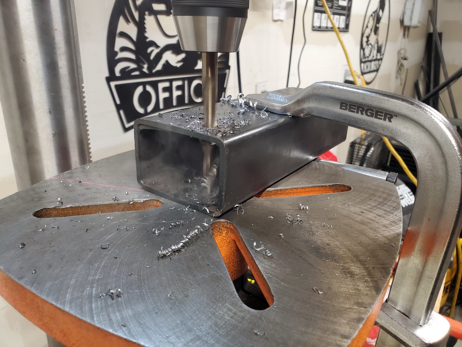

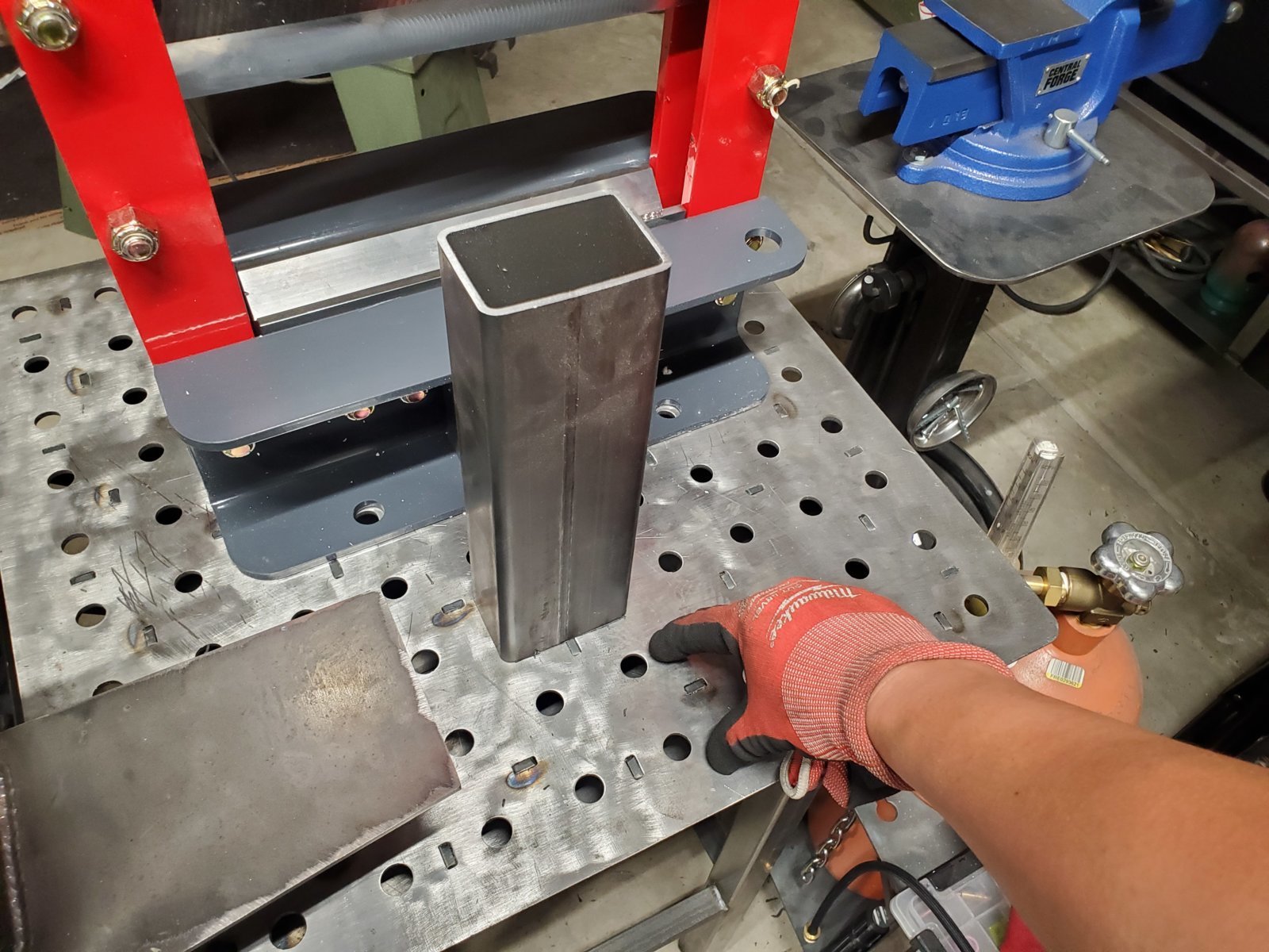

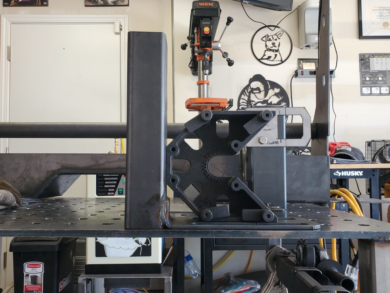

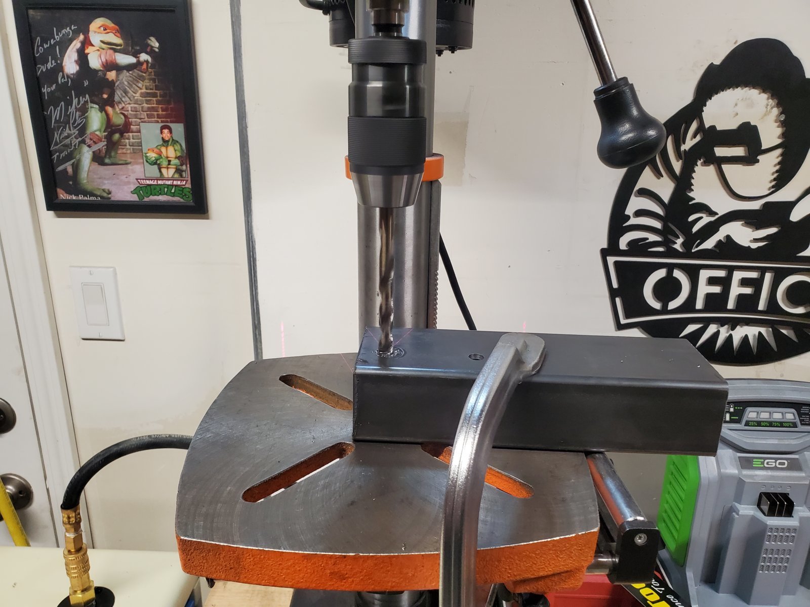

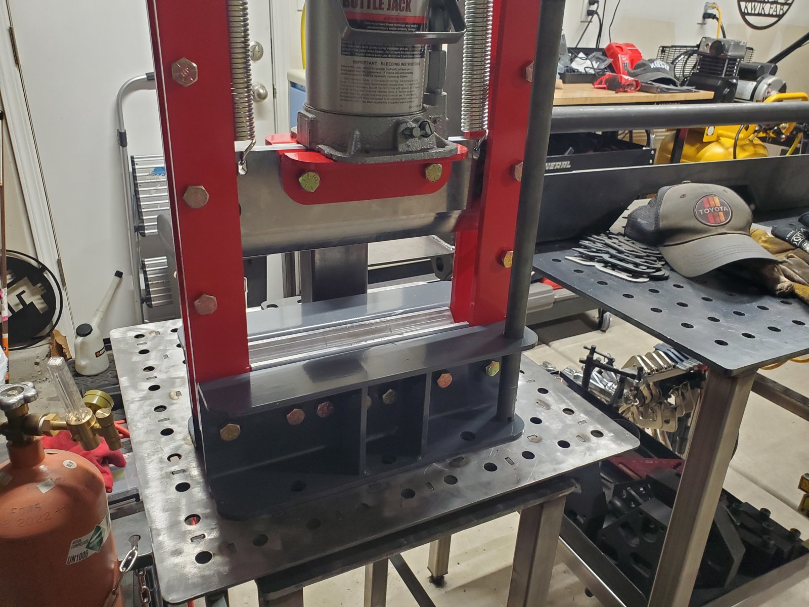

    Putting the 20 year old bandsaw to work.
    Drill press isn't as old, but useful as fuck. I've had this thing since we moved out here and I love it.
    Especially nice to have that extra throw to go all the way through.
    What's the tubing for?

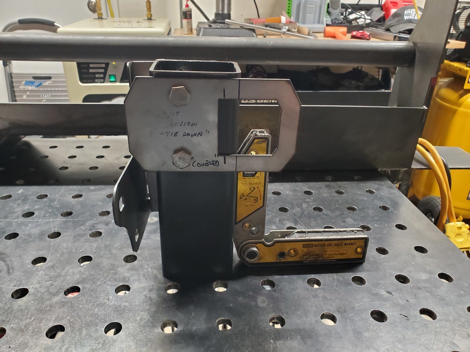

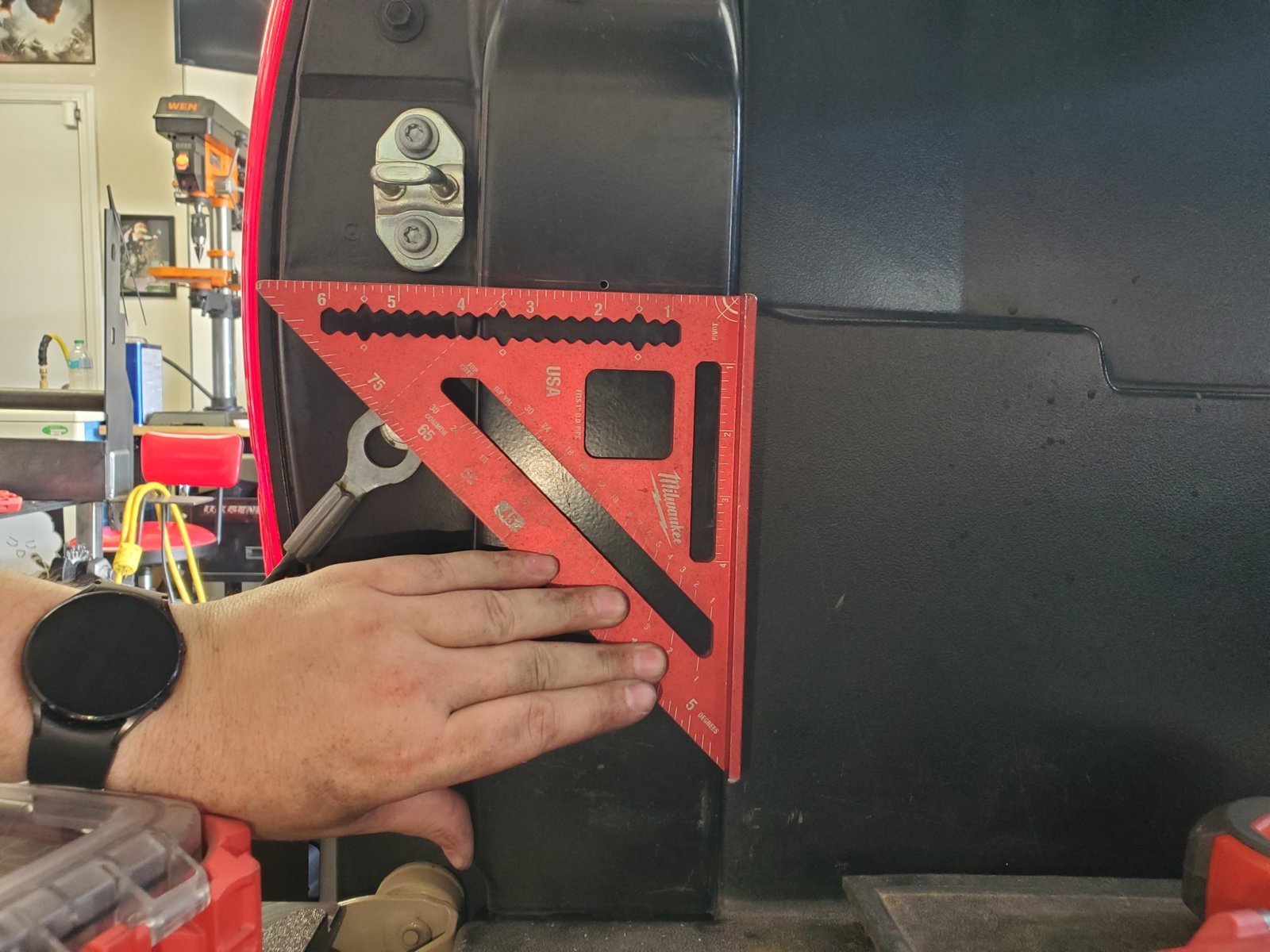

    Well I wanted to make a simple "jig" to mimic the bend mounting portion.
    Here you can see the mounting (following 2" from the leading edge) gives us the exact distance measured on the tie down yesterday when we put it against the bed itself.
    This is especially important as I can use this to toy with the bottle opener and tie down ideas (on thin steel even) for mock up.

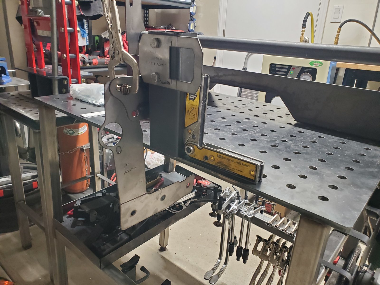

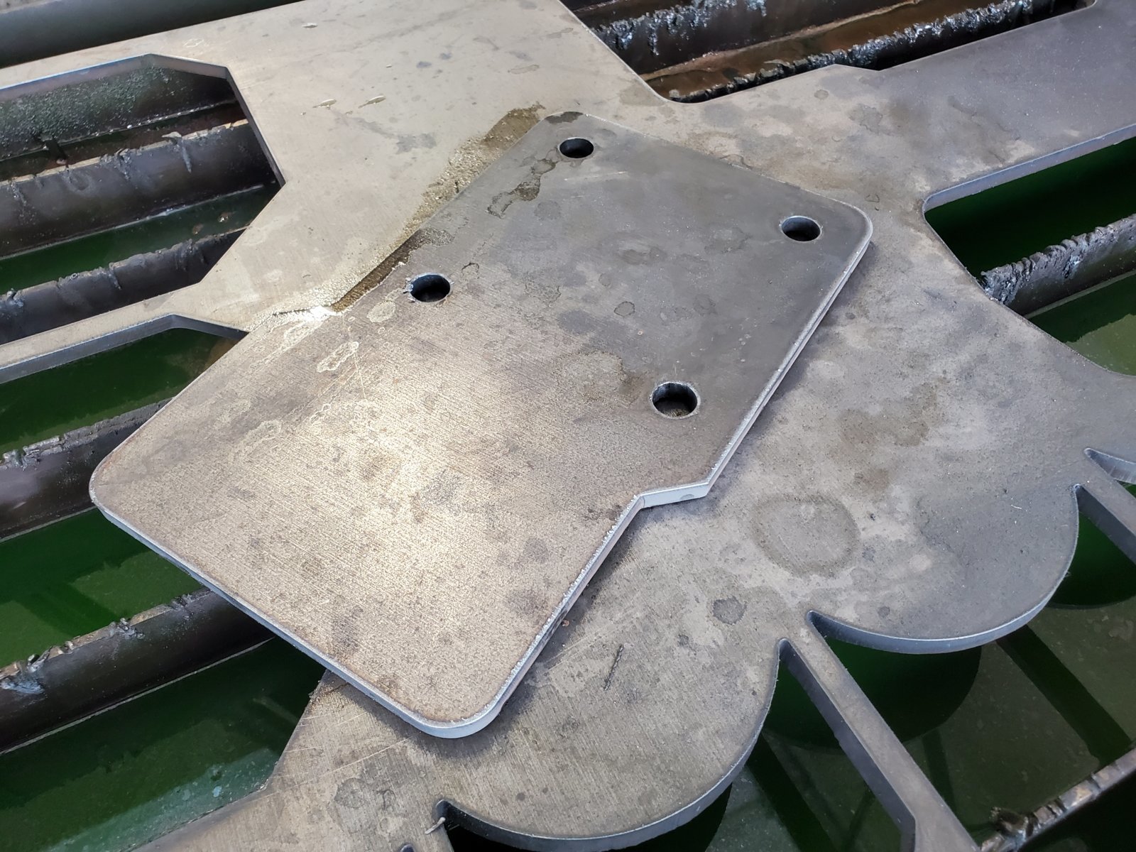

    And this is how it all goes together on your bed.
    Seeing as how the bed itself is 16 gauge thick, it is entirely possible that 11 gauge (1/8") could be an acceptable alternative.
    I won't toy with that yet but just throwing it out there as a possibility.

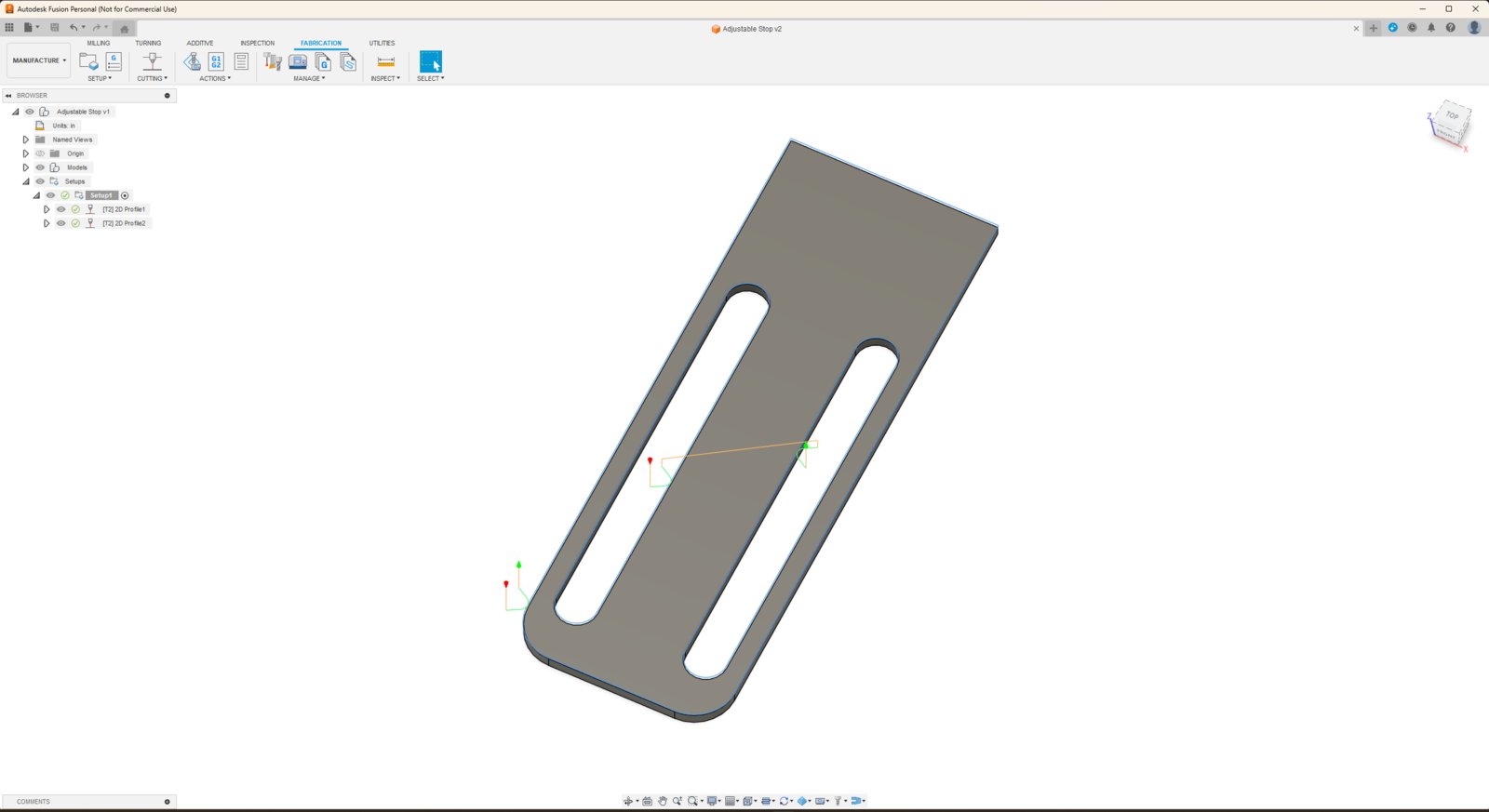

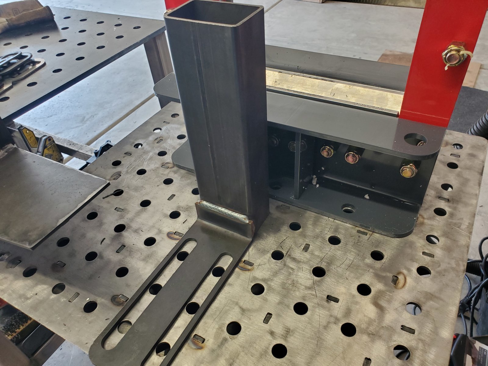

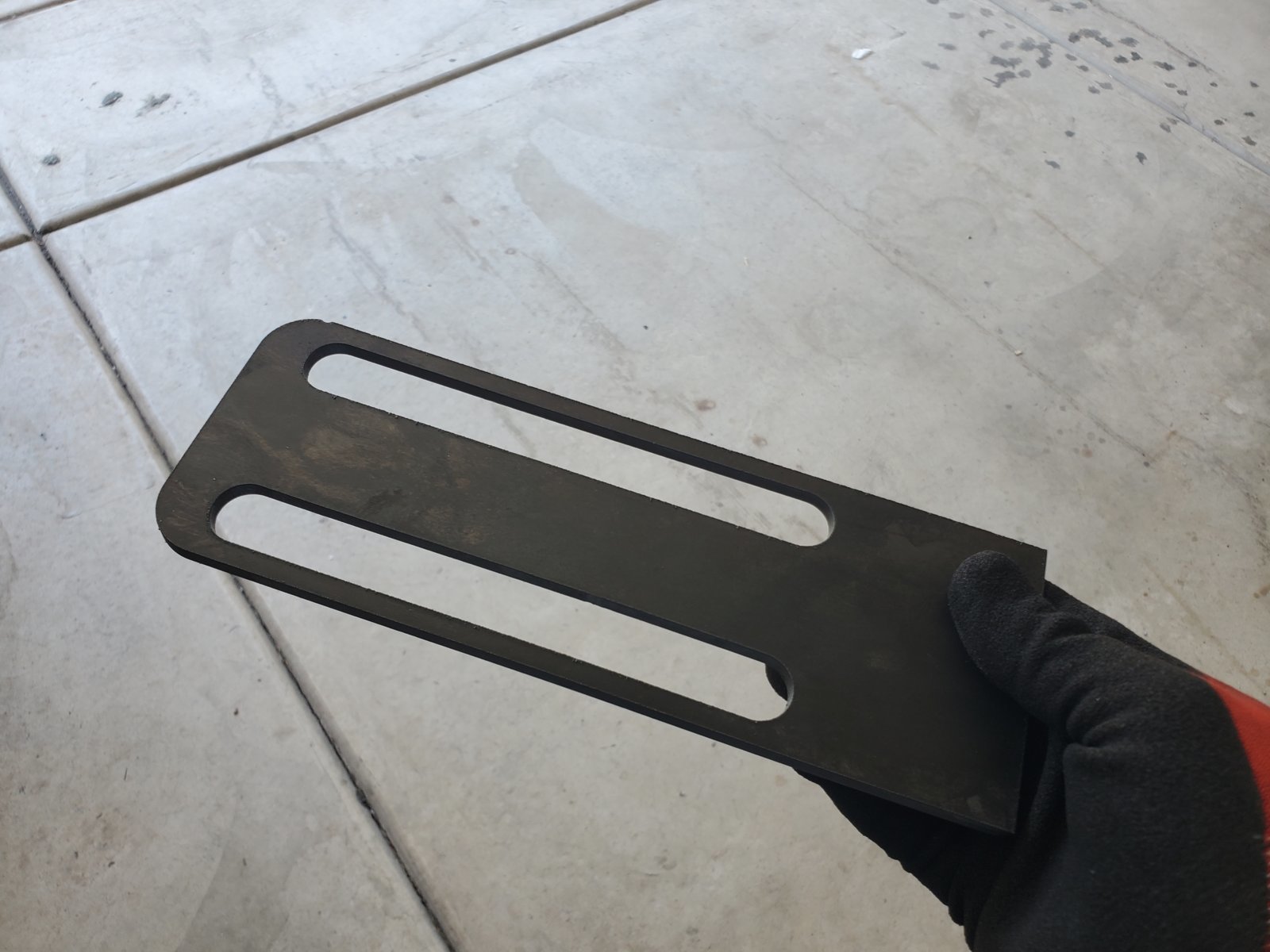

    Came up with an idea for repeatable results - a backstop for my press brake.
    So I cut out a second piece of tubing which I'll use as a backstop to my press. Since I'll have it mounted on a "fixture" table I made over a year and a half ago, may as well utilize the holes in it.
    Here's the idea.
    And here's the solution, which I'll cut out shortly.
    The overhang will get bent to a 90 degree and welded to the face of the rectangular tubing. The slots will allow for adjustment and placement of bolts to secure to the fixture itself.
    This is what happens when a fabricator has ADHD :anonymous:

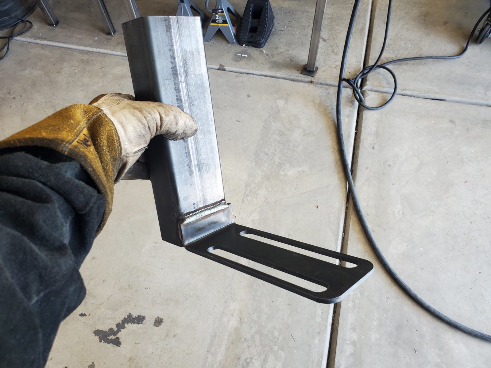

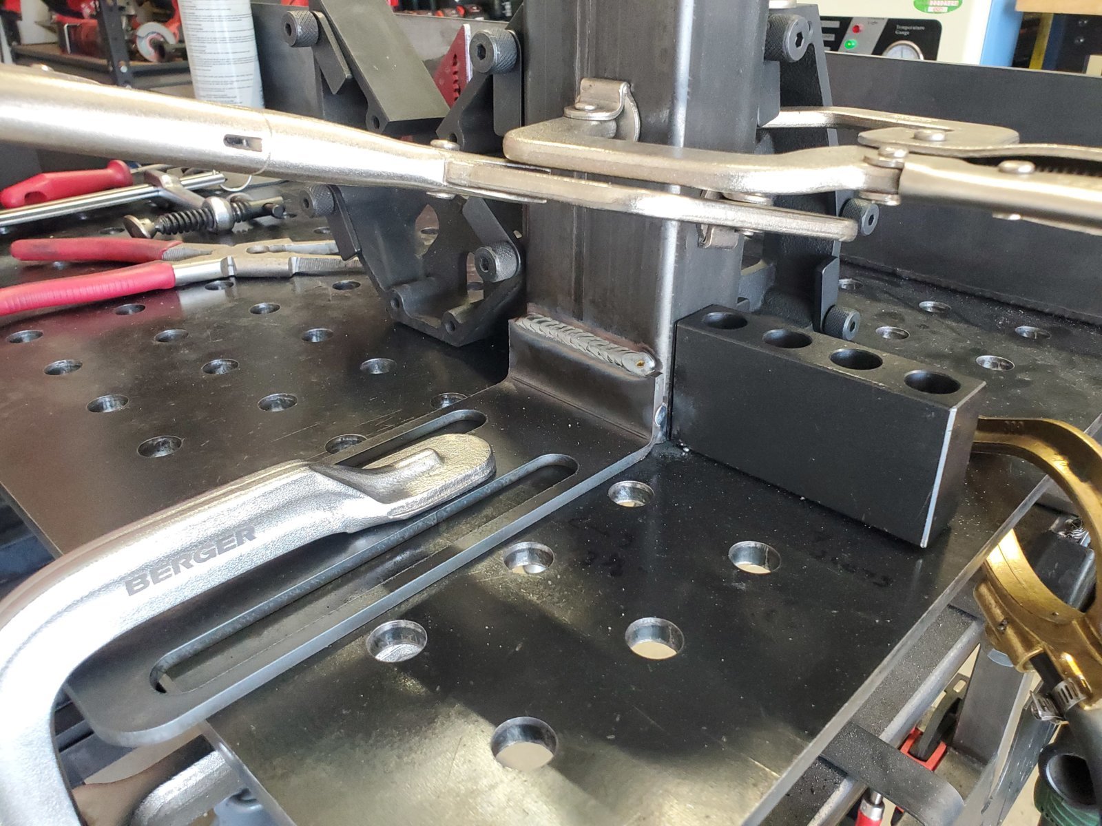

    Using tools to make other tools.
    Clean.
    Bent and getting welded; made damn sure the tube was perfectly square to the bracket being welded on.
    Perfect.
    With the backstop in place, I will be able to provide repeatable bends as I want each and every piece to be as consistent as possible.

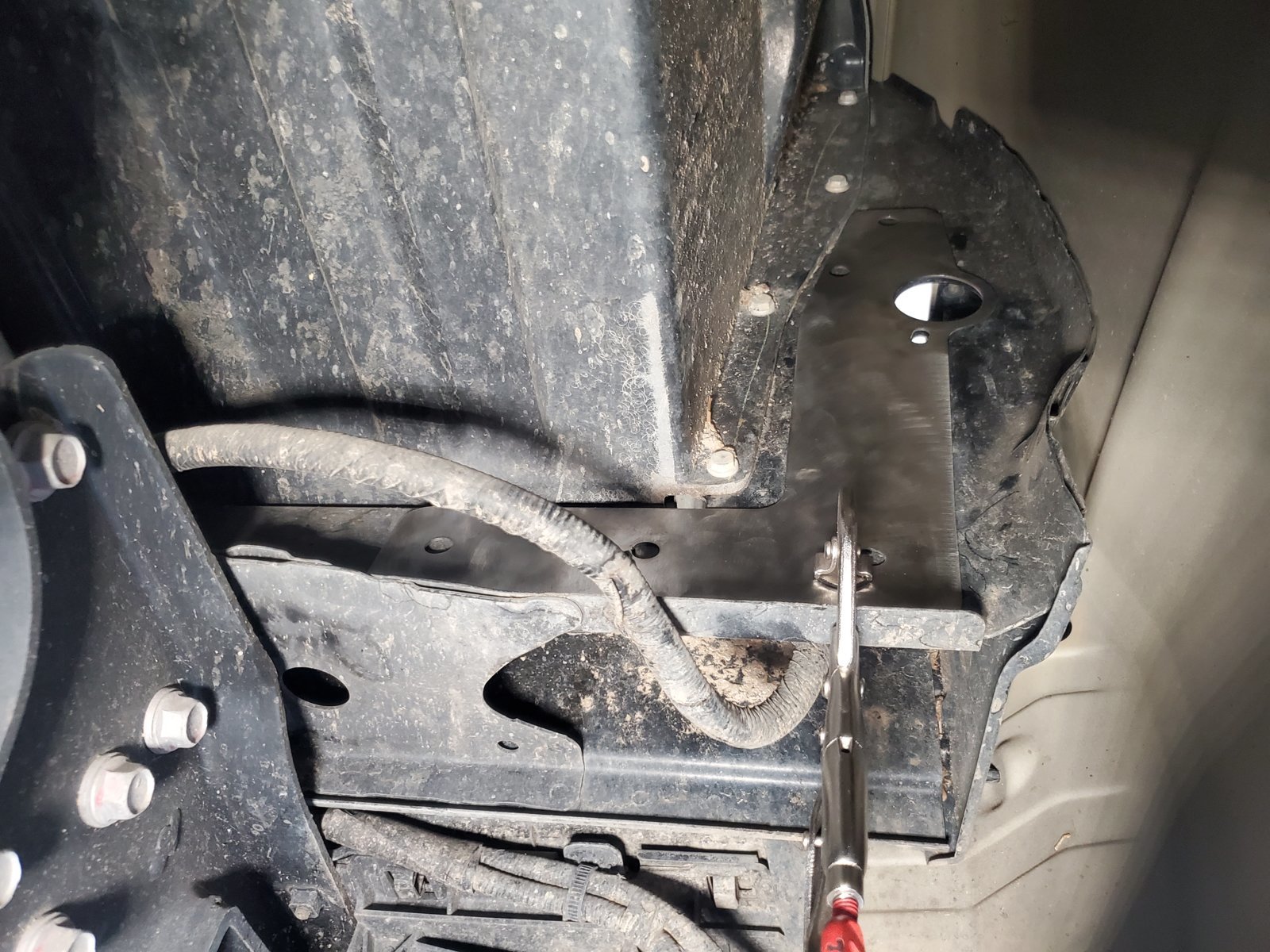

    Yeah we were talking about how easy these will be to install.

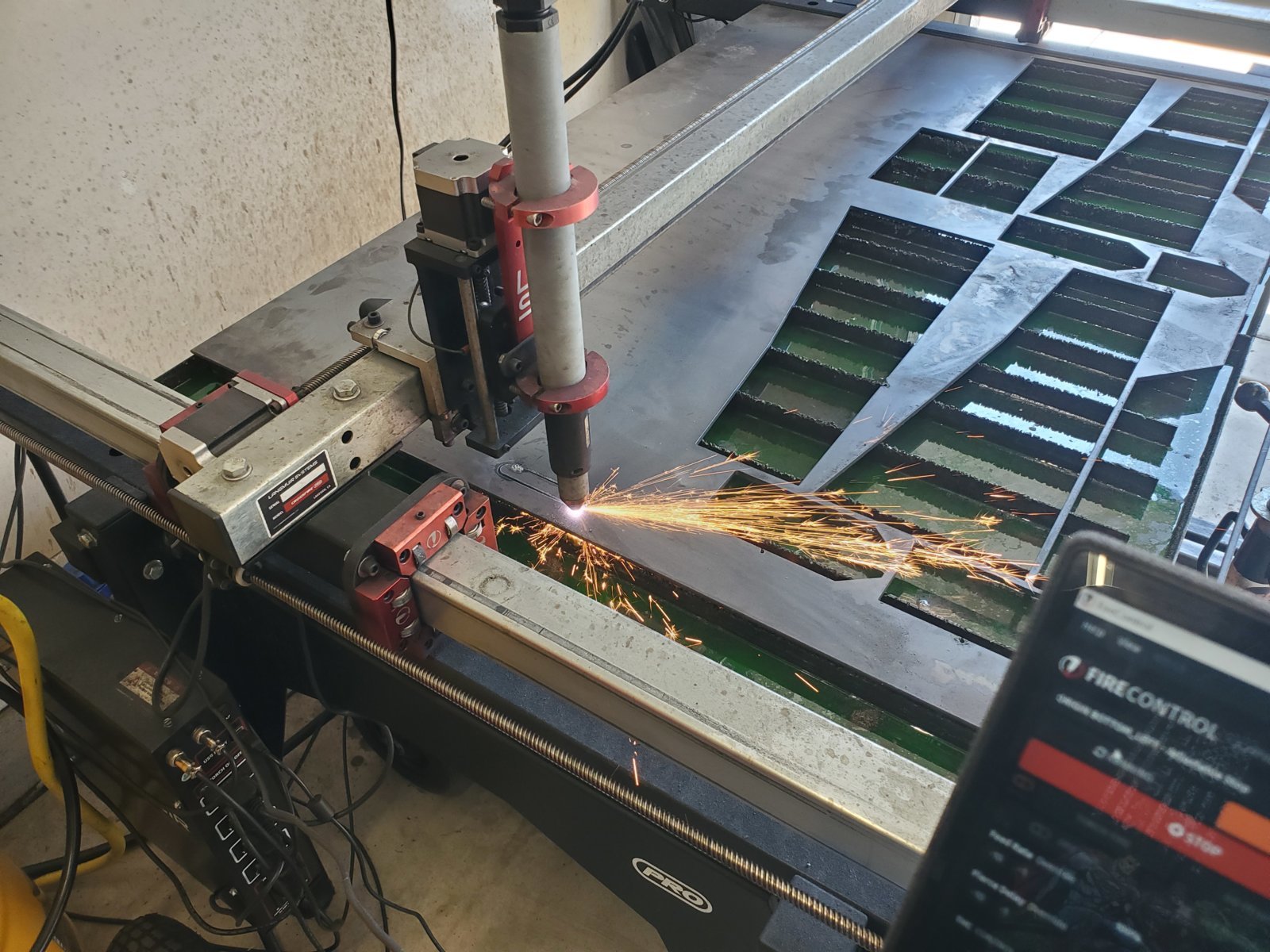

    I mean heck we spent a lot of time bullshitting, drawing, cutting parts, revising, welding, etc. and spent less than 4 actual hours working (I talk a lot :anonymous:)
    But two 10mm bolts to pull the tail light is all the dismantling needed!
    Had to run errands so no cutting of the actual parts in 3/16" occurred today. Hoping to do that within the next few days if it ever cools down since I'll be out of town all weekend.

    Something looks wrong about this mock up. It may be a trick of photography, but it looks like the bracket with the large circle is where the tailgate would be. I realize this is a mock up, just want to be sure.
    Kwikvette[QUOTED][OP] likes this.
  16. Jul 15, 2024 at 10:19 AM
    #136
    Kwikvette
    Kwikvette [OP] Well-Known Member Vendor
    Feb 27, 2019
    #284735
    81,869
    Fresno County
    4 run, 2 don't
    Bracket with the large circle is installed from underneath the vehicle, behind the rear tire.
    The mock up shown in the above picture just shows how the pieces "go together" as they sandwich the 16 gauge thick bed.
    Wulf and NoOne like this.

    Can you show how the bracket position in the mock up works with this method of measuring the 2" from leading edge hole?
