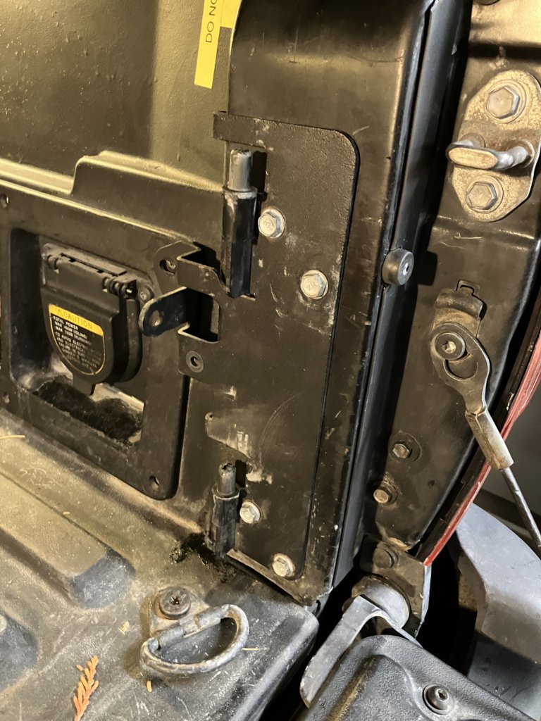

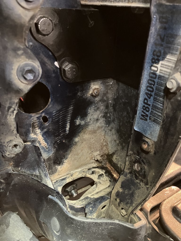

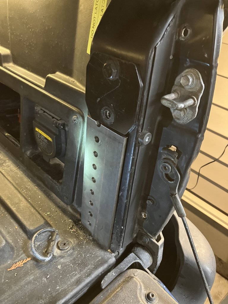

    Aaannnddd the core mod is in.
    Driver side is easy. But passenger side, I have a bed box thing that I really like, so I have to work around the limitations of both.
    but thankfully, I have this scrap steel I can cut to size and drill some holes.

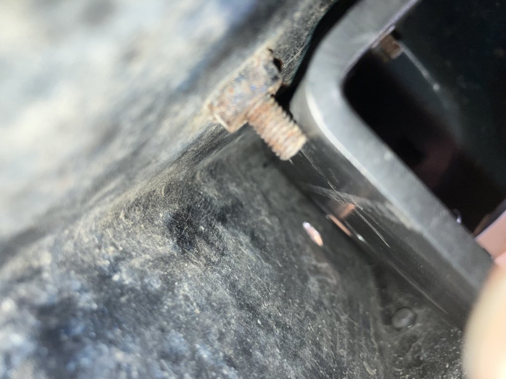

    For 2nd Gen specific issues, the only 1 thing is this bolt that is in the way. You can either unbolt it or cut it off. It was too seized for me to unbolt so cutting it is.
    Rust my god, I wish Toyota replaced the structure for rear bumper when replacing the frame. Nearly got a fragment of rust in my eye.

    Jesus you work fast.
    Did the slots on the L bracket line up correctly?
    And did the large hole being resized make it easier to keep everything "aligned"?
  20. Oct 28, 2024 at 7:17 PM
    #1460
    BluberryBCtaco
    BluberryBCtaco Making the magic happen
    Apr 17, 2023
    #422651
    633
    BC Canada
    2007 Tacoma Sport DCLB
    3in lift, Tow package, Any time 400w inverter, in cab outlet, vinyl floor, roof rack
    Haha, I was already tinkering with the truck.
    Yes driver side was perfect.
    Passenger was odd. The sheet metal was bent a minute amount. (Probably prev owner reversing into something)
    So I had to fight with the “L” bracket to be aligned.
    Making the bolt plate holding the “L” bracket tight to something. Could not stick my head in there to see exhaust pipe was in my way.
    infact the small little hole below the big hole helped. Threw a M6x20 bolt in there to keep the thing in place.
