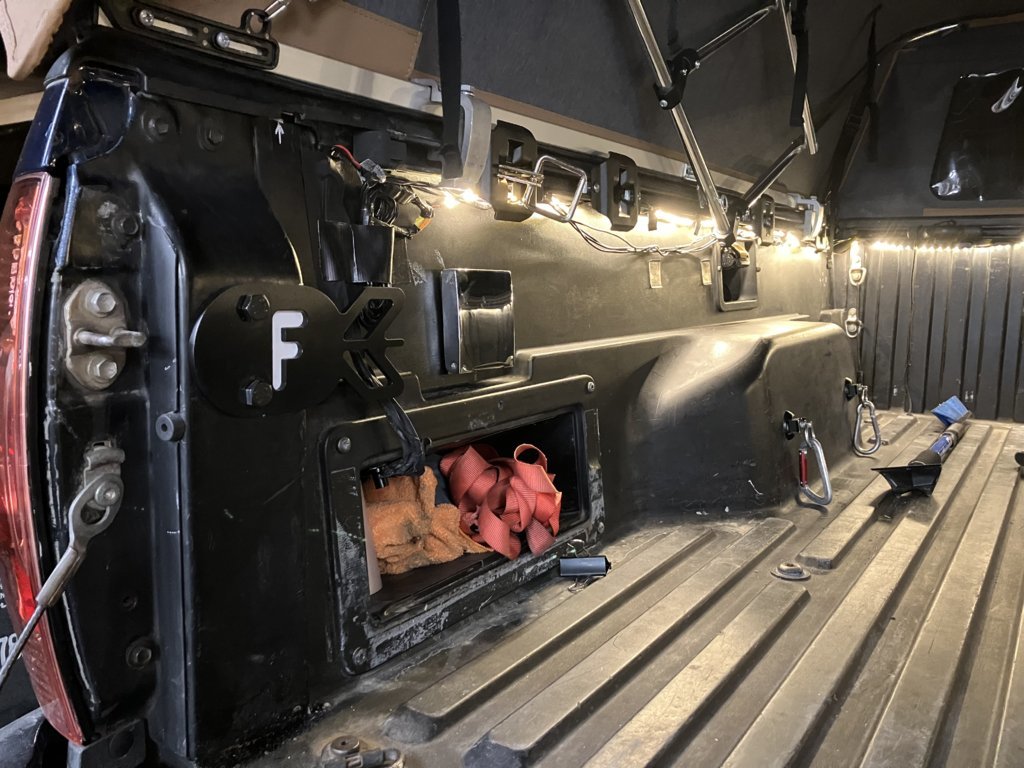

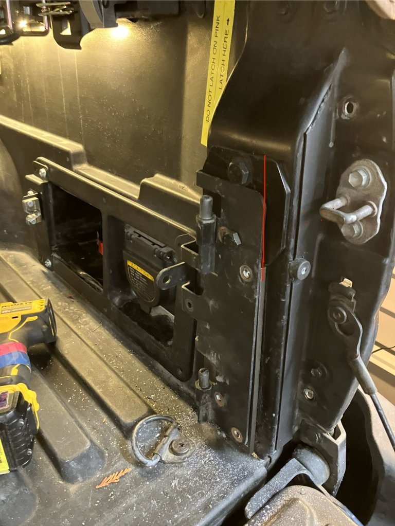

    Okay the patient is all closed up.
    Added some sealant between the cracks.
    The best part, it still functions with the Bed box / swing case!
    Clean too and solves my ever widening bed sides.
    Might paint the bomb later on. :)
    But overall 5hrs to install incl the swing case stuff. Not bad!
    now I gotta figure out the deal with the tailgate stickin go out. But that’s a future me to worry about. Fuck that guy.
    Thank you
    Kiwik!

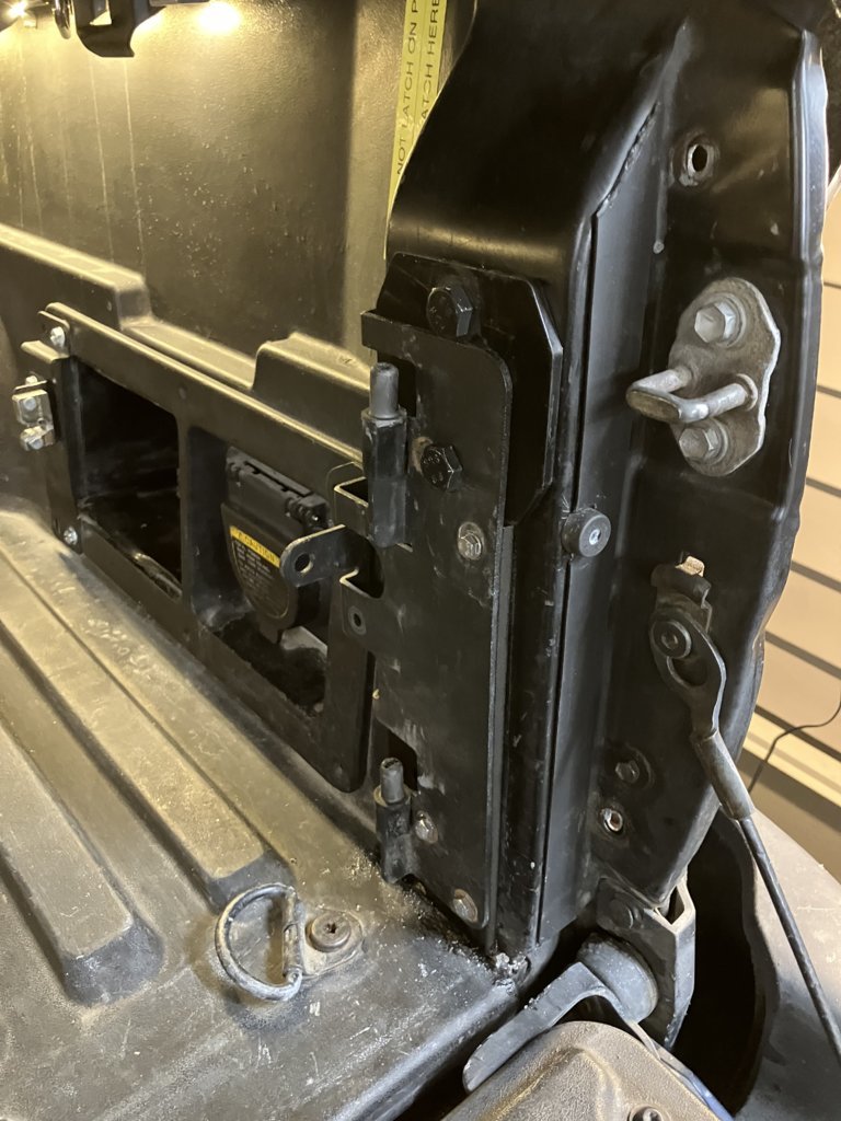

    I have the same swing case and was hoping I could make it work still! Looks like some metal underneath to shim out the lower portion and it works just fine!

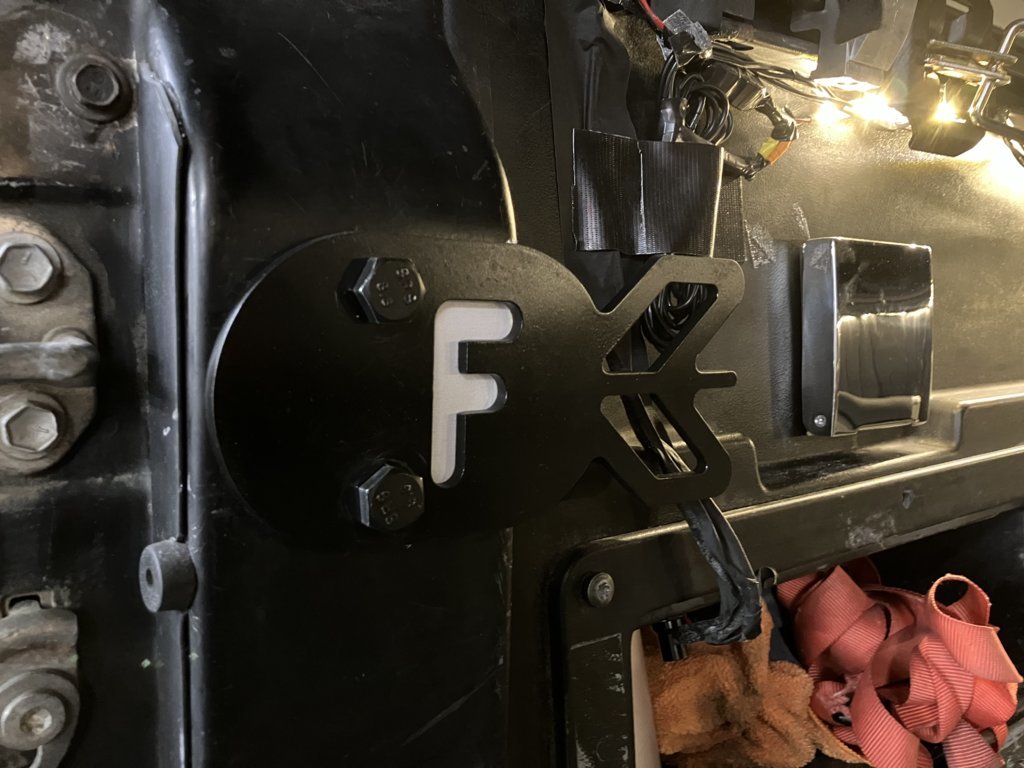

    I didn't even know that swingout was a thing; could just skip the exterior bracket for the stiffener on that side and simply drill two holes through the mounting plate?

    Yes. I would say adding more steel makes that sheet metal there a bit more stronger.
    If you really want a clean look you can cut the steel along the red line.
    That is an option yes. But then the upper bolt hole goes nowhere, and the swing out hinge steel is kinda thin crap.
    And the bolts they provide is crappy self tappers. So you can imagine the weight and cantilever kind of pulls the bolt thru the sheet metal hole.

    The spacer you have added there, looks to be thick.
    I'd offer you a strip of 3/16" with holes in it to fit in place of your mock-spacer but I think it'd be cheaper if you just got some stock yourself and drill a few holes.
    Could even use HDPE instead if you don't want metal as a spacer - it's the same plastic used for cutting boards.

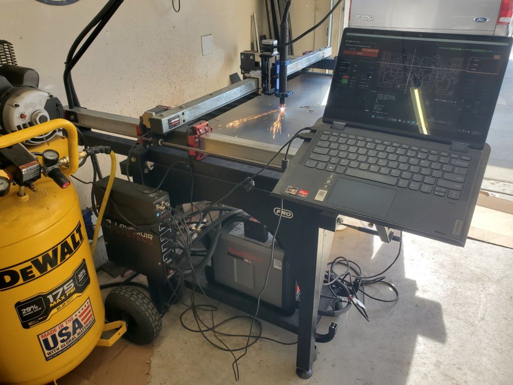

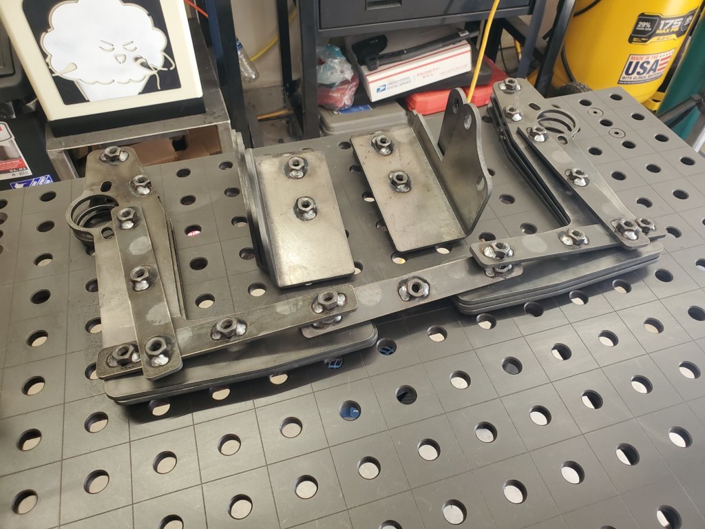

    Should have some time to weld these later today, but knocked out the bending on these while the kiddo took a nap.

    All welded up.
    Going to clean them up tonight for shipping tomorrow.

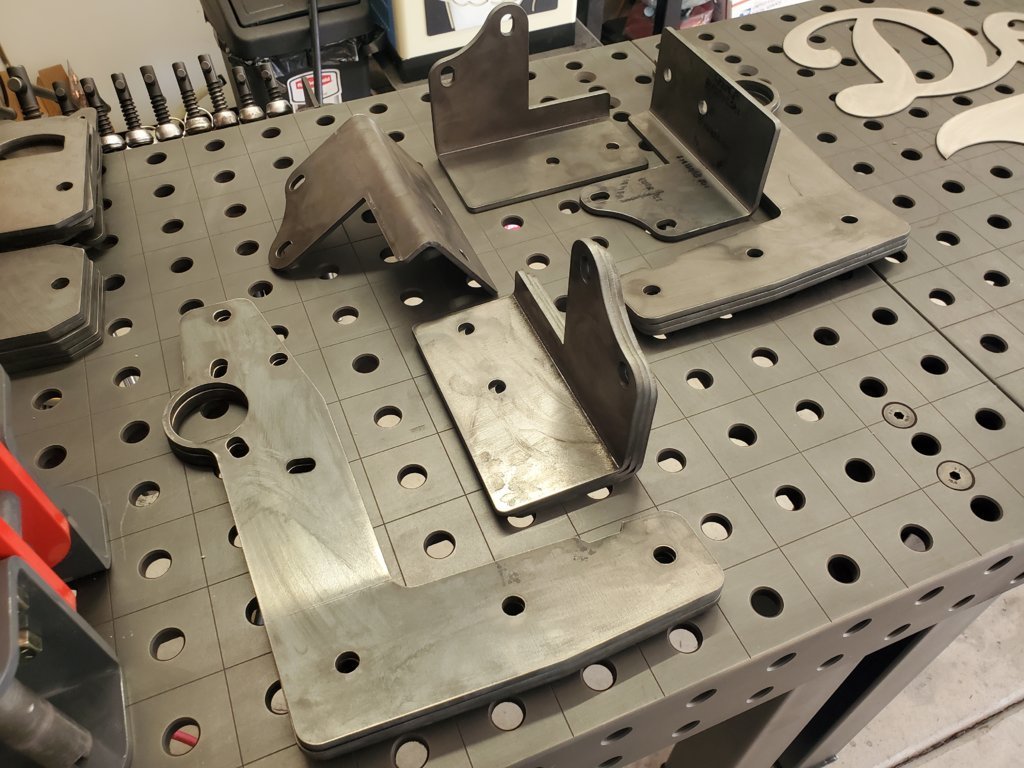

    4 run, 2 don't
    @GunthorNC
    I do have to ask though since it got me a little concerned, you said the rust needs to be knocked off your parts?
    Did you snap pictures?

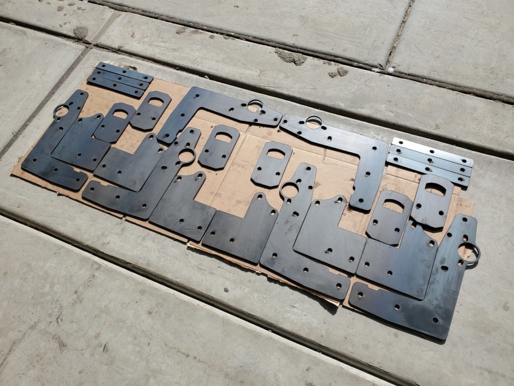

    Just got done cutting these so they're fresh off the table.

    Will bend and weld these 3 sets tomorrow.
