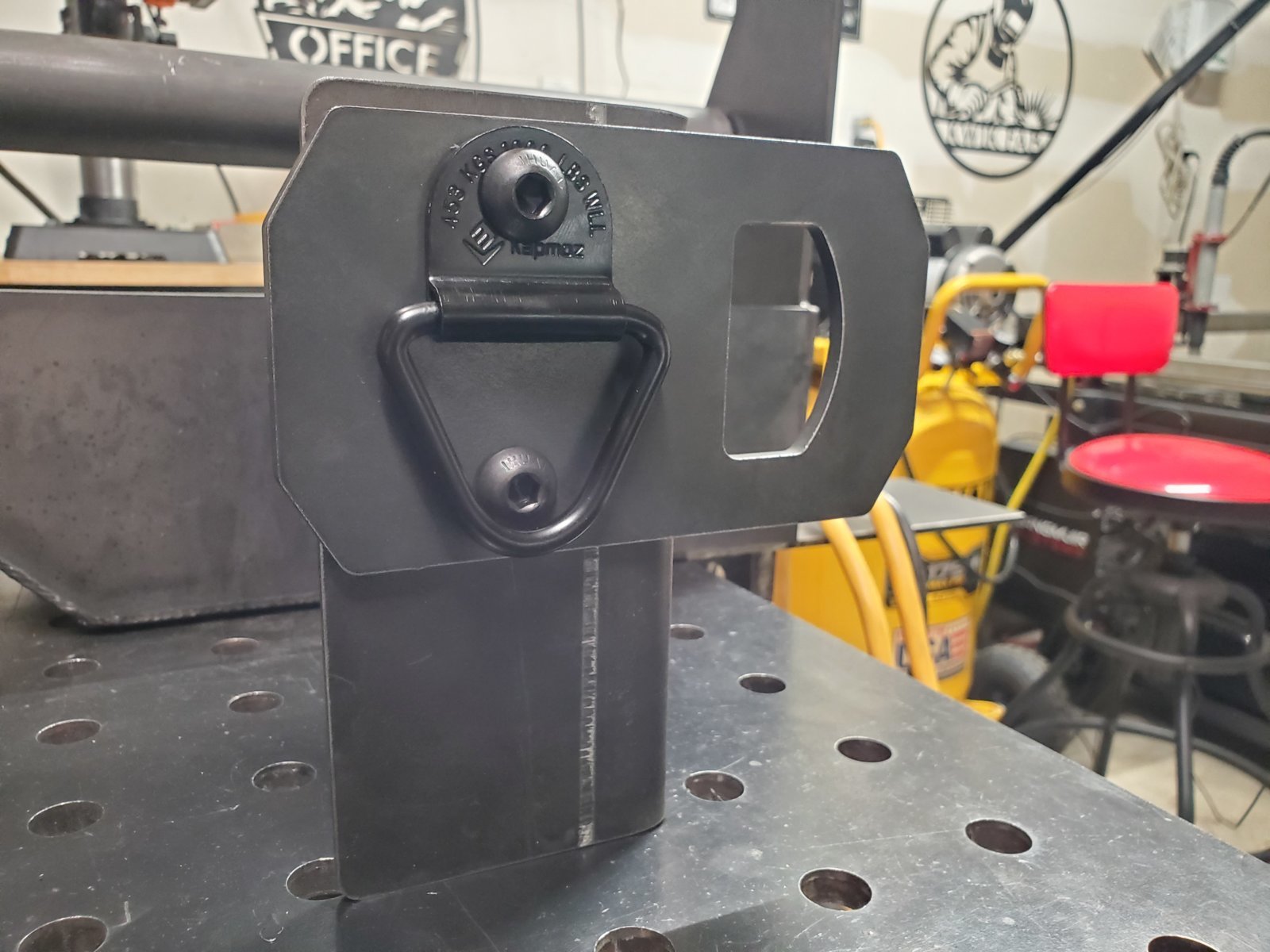

    Personally, I think the sandwiched version of what you showed me would work best.
    Being sandwiched means it's really supported by the hefty 3/16" thick tie down bracket.
    Not a whole lot is going to really go passed the bed itself and what will, is supported anyway.

    Grade 8 is an SAE rating. 10.9 is close enough, next step is 12.9 but is way overkill.

    If 10.9, then probably black oxide as it’s high carbon steel.

    Yep, black oxide for the button head bolts.

    Sure, there are several ways to protect the edge. The D rings that were posted back a few pages is another option that wouldn't even encroach on the bed.

    Not that I would purchase them to sell with these stiffeners, but yeah some may want to buy their own loop.
    Bought a 4 pack so only two people can opt to buy these with their purchase and skip being forced to buying a 4 pack (you only need 2 total).

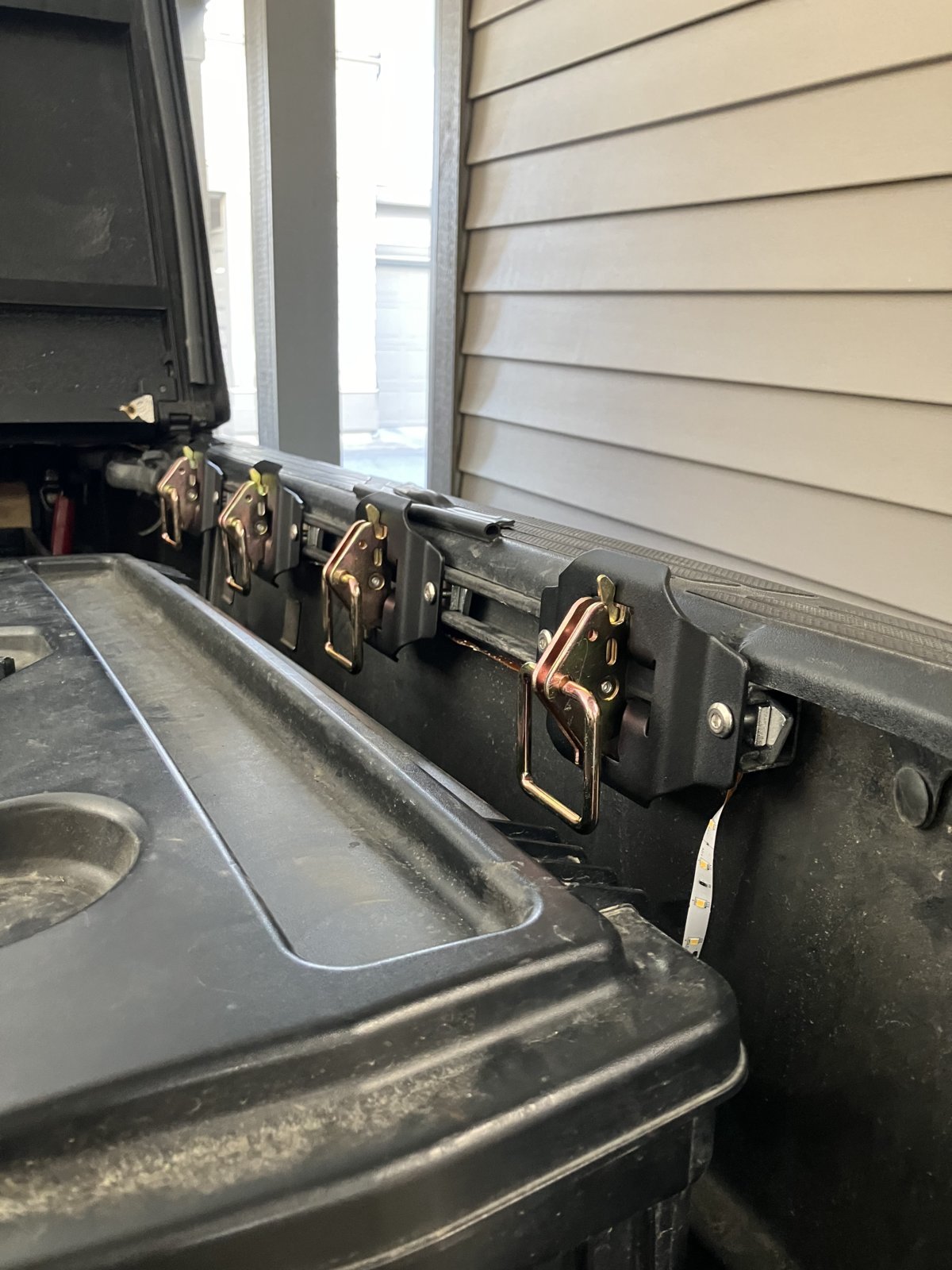

    Risking function creep here, there is a thread that I've seen that adds a new bolt which allows you to move the tailgate stays to a different position, which makes the tailgate stop on an angle such that the top edge is flush with the top of the wheel covers in the bed. Which means you can slide a sheet of plywood in and support the trailng end.
    I'm not sure where that bolt needs to be.

    It looks to be inline with the bottom bolt meaning about 1/2" to 3/4" of the exterior bracket will interfere with such a bolt. Specifically the bottom corner towards the tailgate.
    Unless there a specific demand, I don't think it warrants caution.
    Solution would be to "notch" the bottom corner of said bracket as it wouldn't interfere at all with mounting.

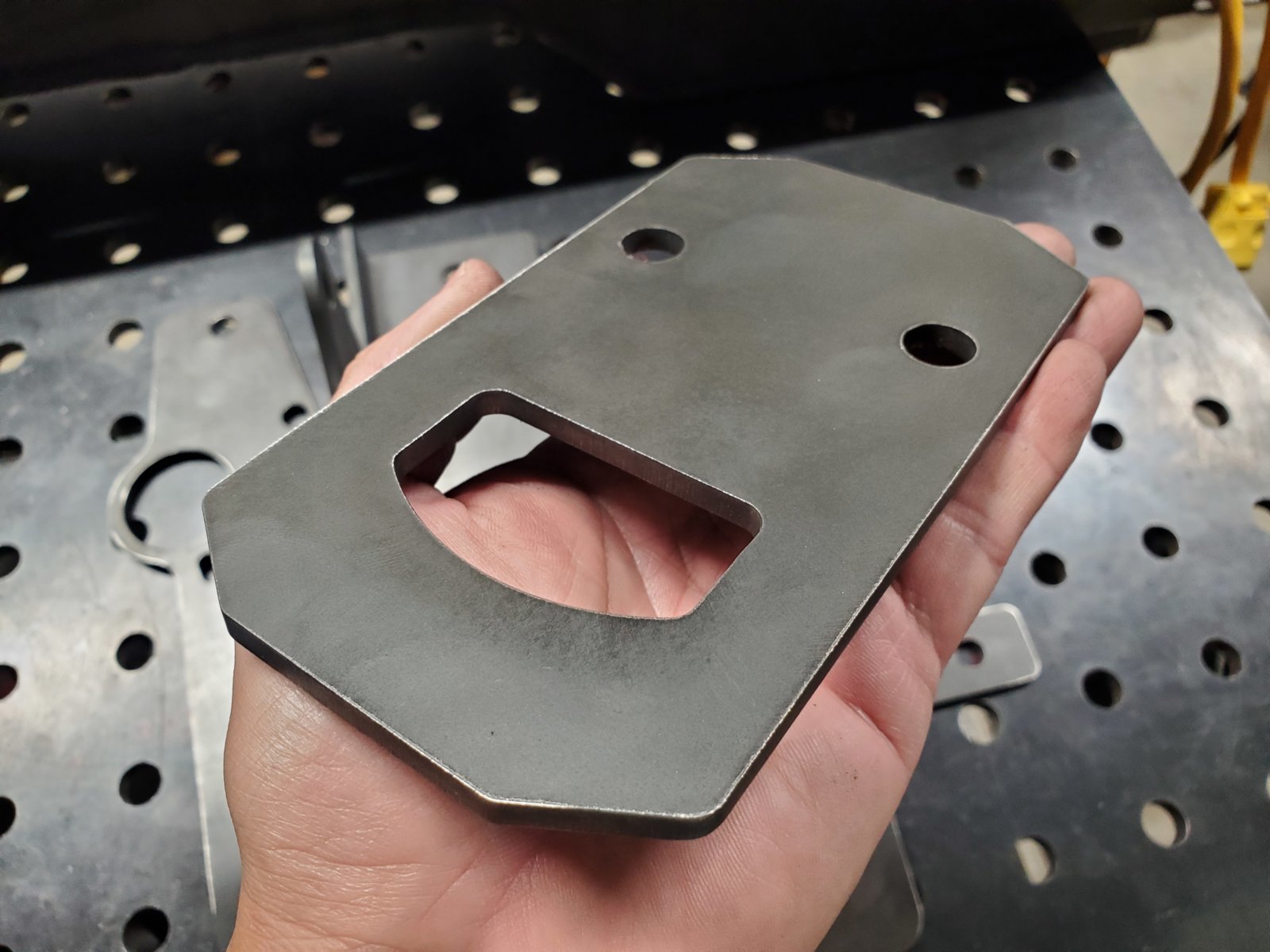

    But if the steel price hasn't changed from 2 months ago for a 4' x 8', I can confidently price these at -
    $150 shipped per set, all hex head bolts, bent, hardware welded.
    $155 shipped per set, hex head bolts for inside hardware, button head bolts outside, bent, and hardware welded.
    That's if I can ensure each set is nice and secure in each flat rate box.
    That brings the price per set to $135 and $140 respectively (if you wish to pick up locally).
    A call tomorrow to my metal supplier will dictate final cost just to be safe.
    Does this seem fair for everyone?
