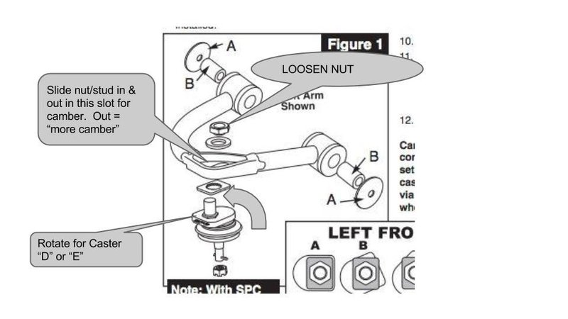

    so do the UCA's fix positive camber caused by lifting...

    Yes

    Maybe I am retarded but...How?
    SPC does this by adjustable outer ball joint to allow for 0° to +4° of caster and ±2° of camber

    Because the set back of the ball joint is fixed when they are made vs adjustable like the SPCs
