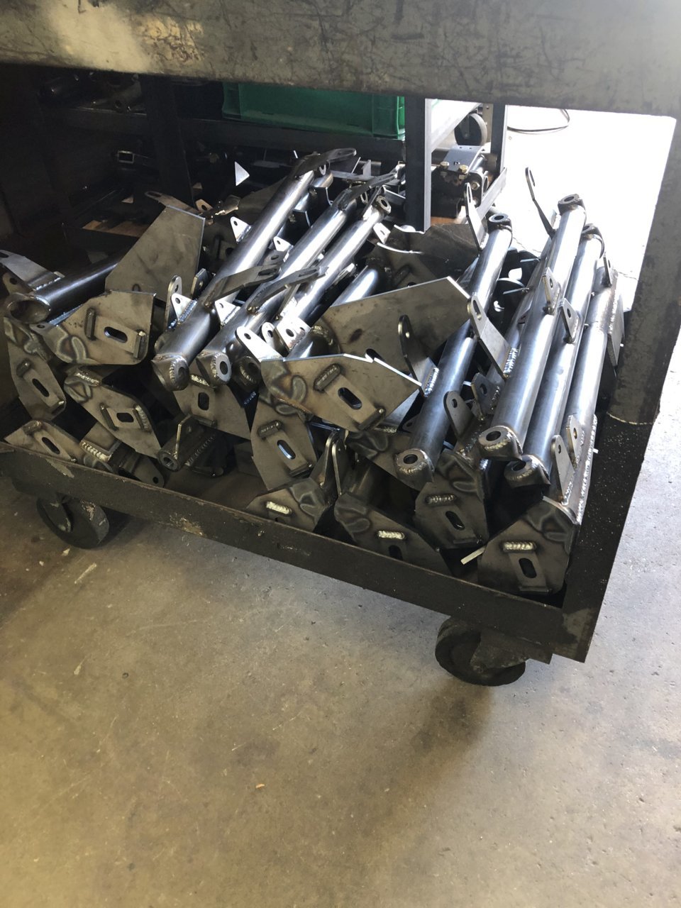

    Shooting for Monday, will keep you updated the second I know.
    As of now the laser cut cams are expected to be done Thursday... I have the subframes all welded, and hardware is all bagged up.
