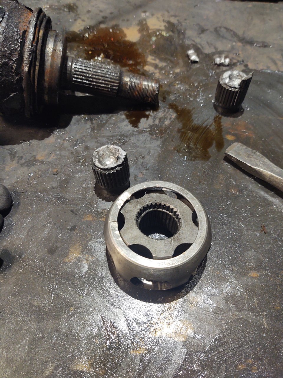

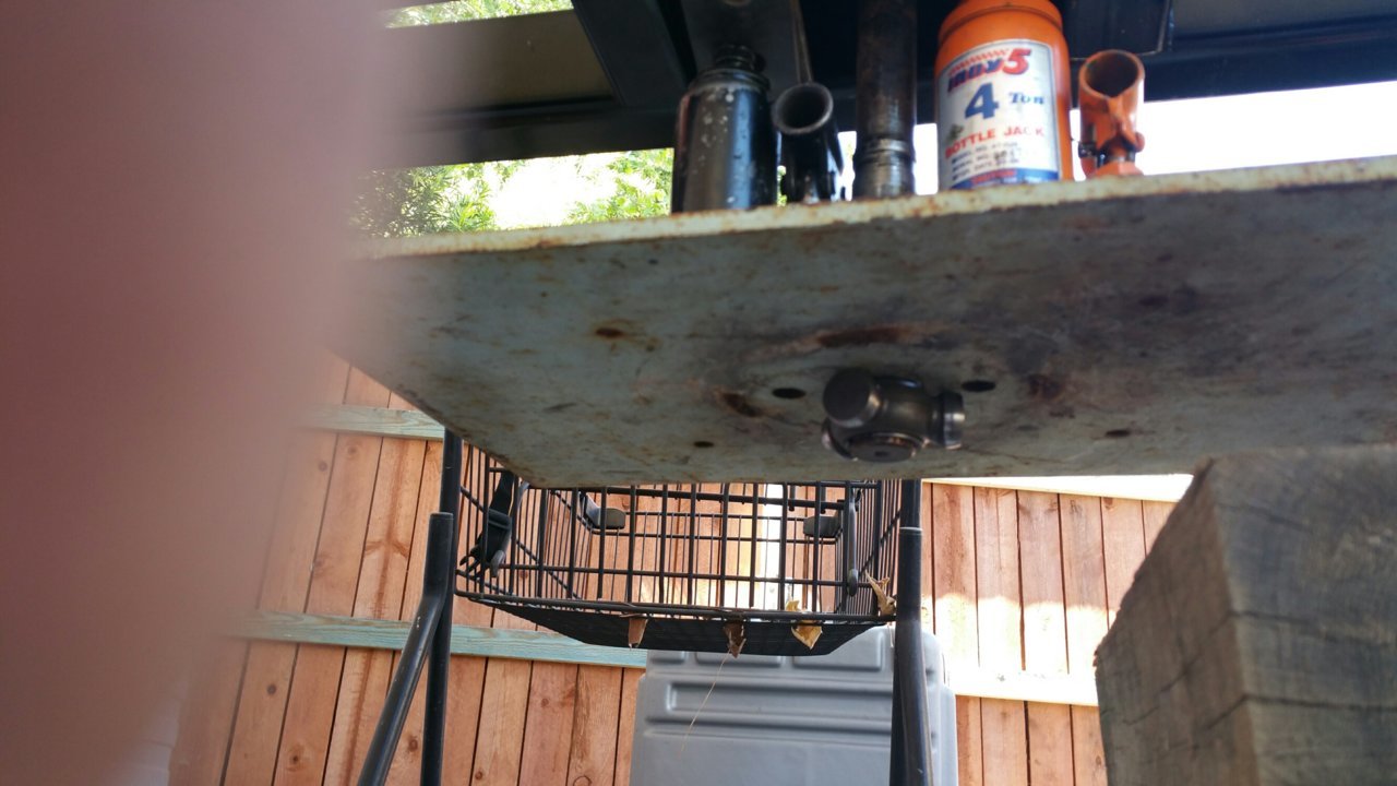

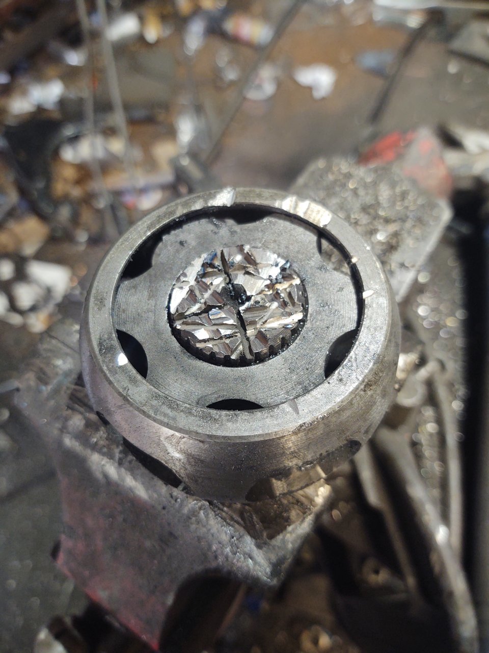

    If the pipe slide method doesn't work your probably going to destroy the oem shaft, and break the splines off. A 100 ton press will make short work of this, but apparently it takes between 50 and 80 tons.
    Cut the axle off just below the birfield joint, shot enough out can spin it around to get the joint apart, long enough to have some left to grab with a vice.
    Then notch the top with a grinder to get through the case hardening. Then drill out the shaft to 3/4" diameter, and 3/4 inch deep.
    Now you can use a 12 ton press and a short 5/8 bolt to break the splines
  3. Jun 19, 2020 at 2:06 PM

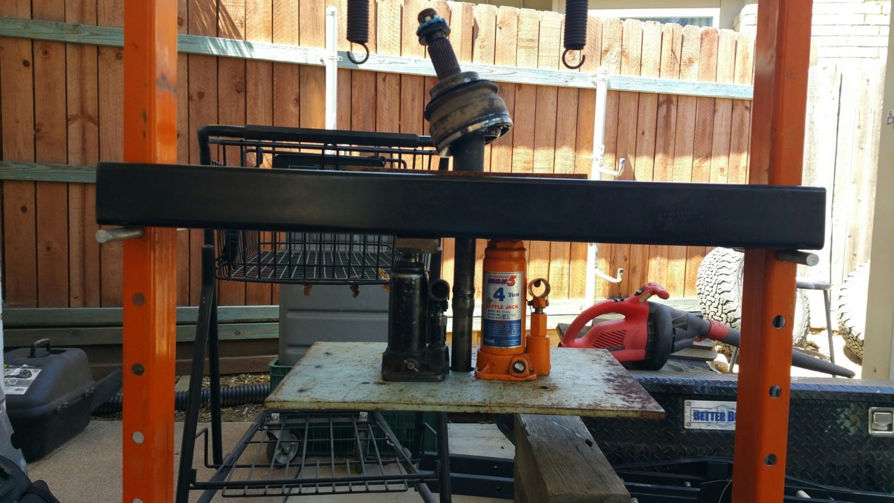

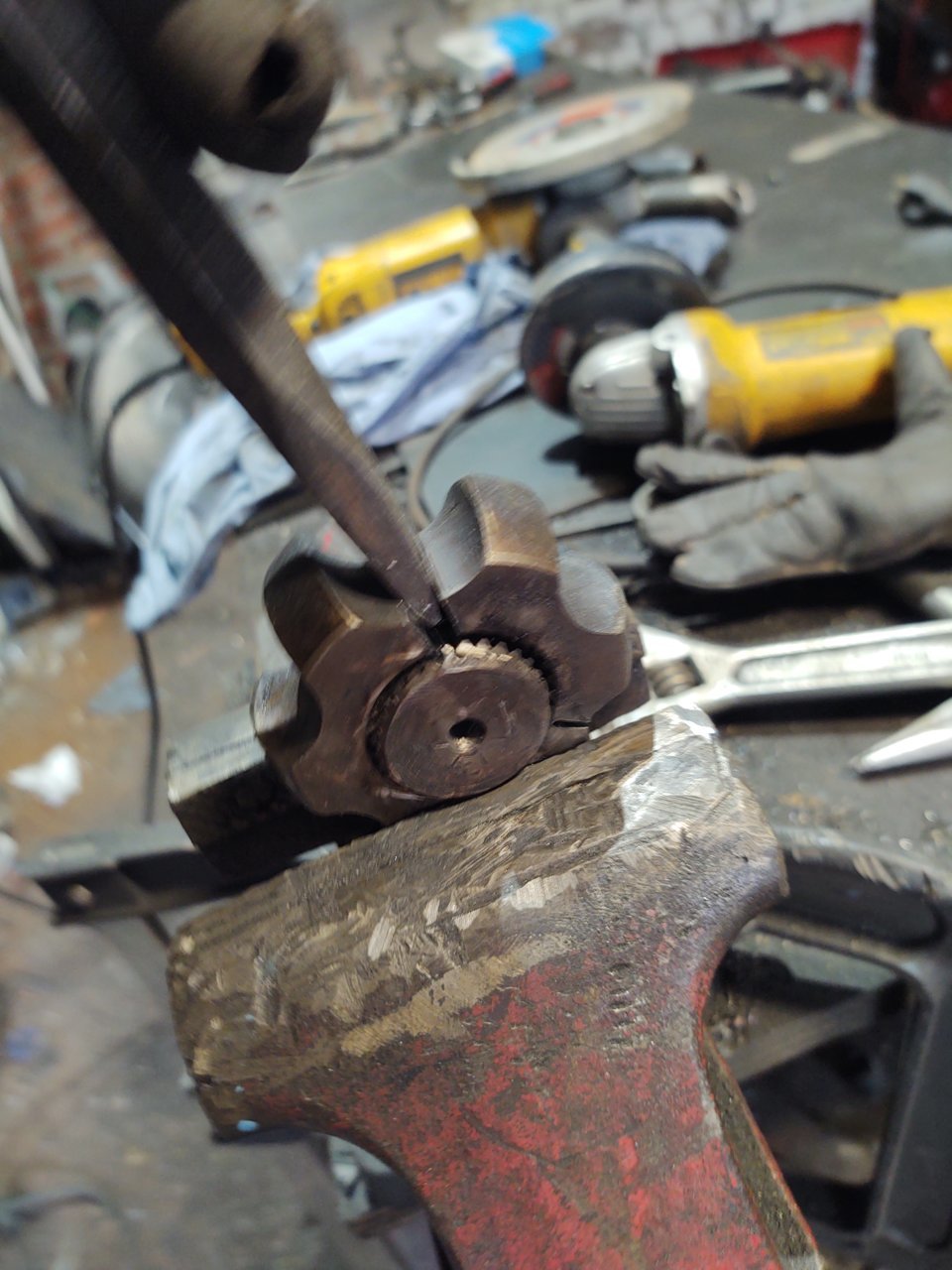

    Here's how you'll save the fancy axle you just bought if you blow an outer CV and can't get the shaft out of the joint.

    Wouldn't heating up the birfield (not HOT enough to effect the temper) help with getting it off? Heat = expansion. They are in there so tight, it's almost like they are sweated onto the shaft.
  11. Jun 20, 2020 at 11:03 PM
    #371
    tetten
    tetten Cynical Twat Waffle
    Nov 2, 2014
    #141581
    2,503
    Andy
    Socal
    The heat may simply expand the snap ring too and not make it easier.
  12. Jun 20, 2020 at 11:28 PM
    #372
    kasnerd
    kasnerd candied bacon
    Jan 2, 2014
    #119695
    2,498
    SoCal Yokel
    '14 SC LT Mall Runner
    Mods? Yes, oh yes..
    What's the solution to preventing having to go about this by asking nicely with a cutoff wheel and a cold chisel?
  13. Jun 21, 2020 at 3:59 AM
    #373
    tetten
    Nov 2, 2014
    #141581
    2,503
    Andy
    Socal
    Unless you get lucky and the pipe drop method works on the snap ring, you can only save either the shaft or the birfield, one of those has to be sacrificed to disassemble the assembly. Which component you want to reuse will dictate what gets destroyed.
    Arcticelf[OP] and DocME like this.
  14. Jun 21, 2020 at 6:11 PM
    #374
    Arcticelf
    Arcticelf [OP] Well-Known Member
    Jul 18, 2015
    #159735
    7,662
    Gladiator
    Exactly. Definitely try the pipe drop first, but have a plan B.

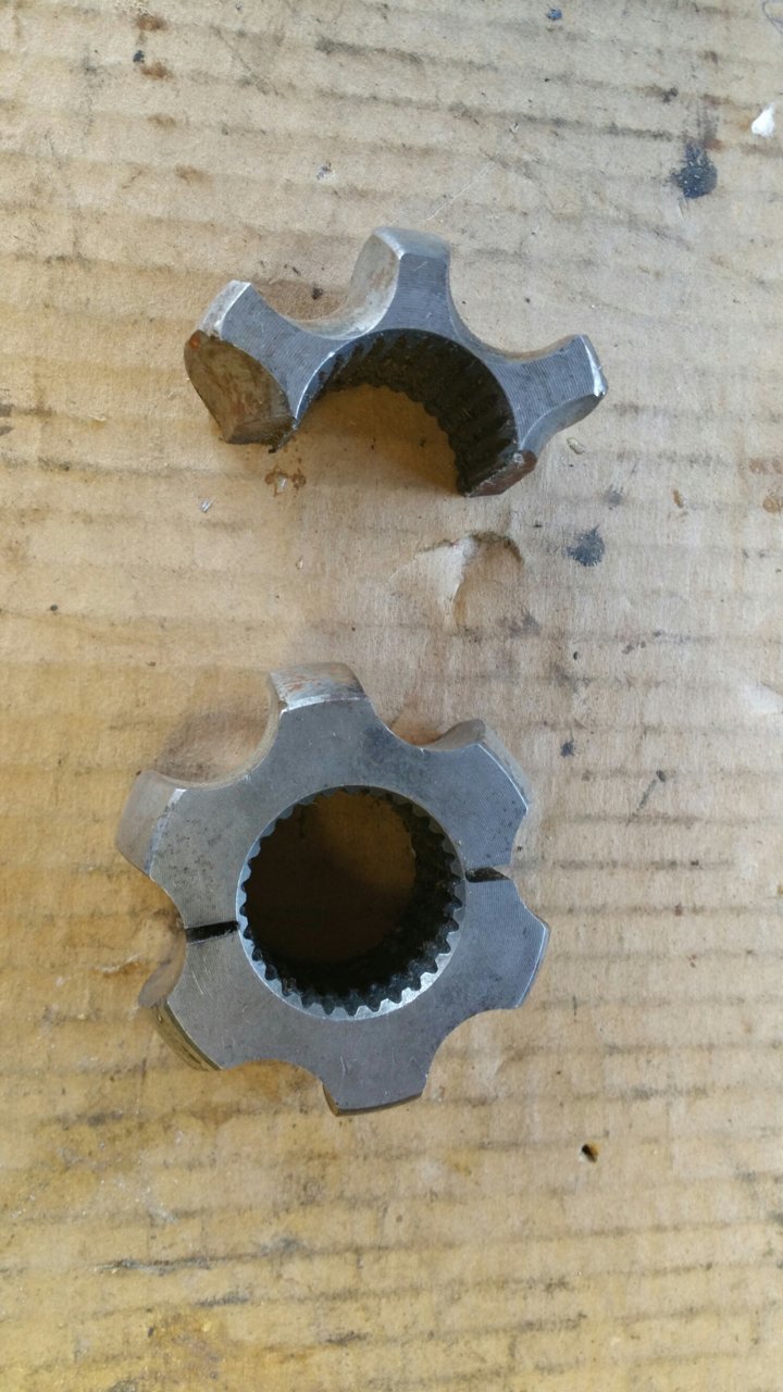

    This worked for me , Any body have the inside star part for a OEM Cv I need two for my spare cv ?
  17. Jun 22, 2020 at 1:07 PM
    #377
    Arcticelf
    Jul 18, 2015
    #159735
    7,662
    Gladiator
    It didn't occur to me to use the tripod bearing as a point to press against to get the birfield apart.
    I'll have an extra halfshaft with a good inner CV for sale shortly, I'd be happy to take it apart and just send you the inner birfield if you want.

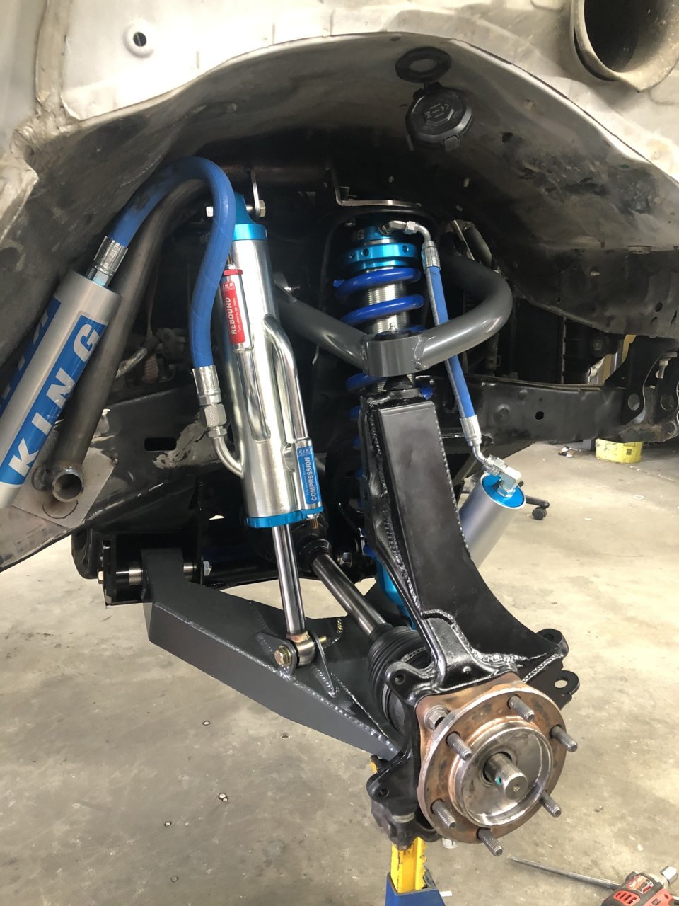

    Started building the LT kits today

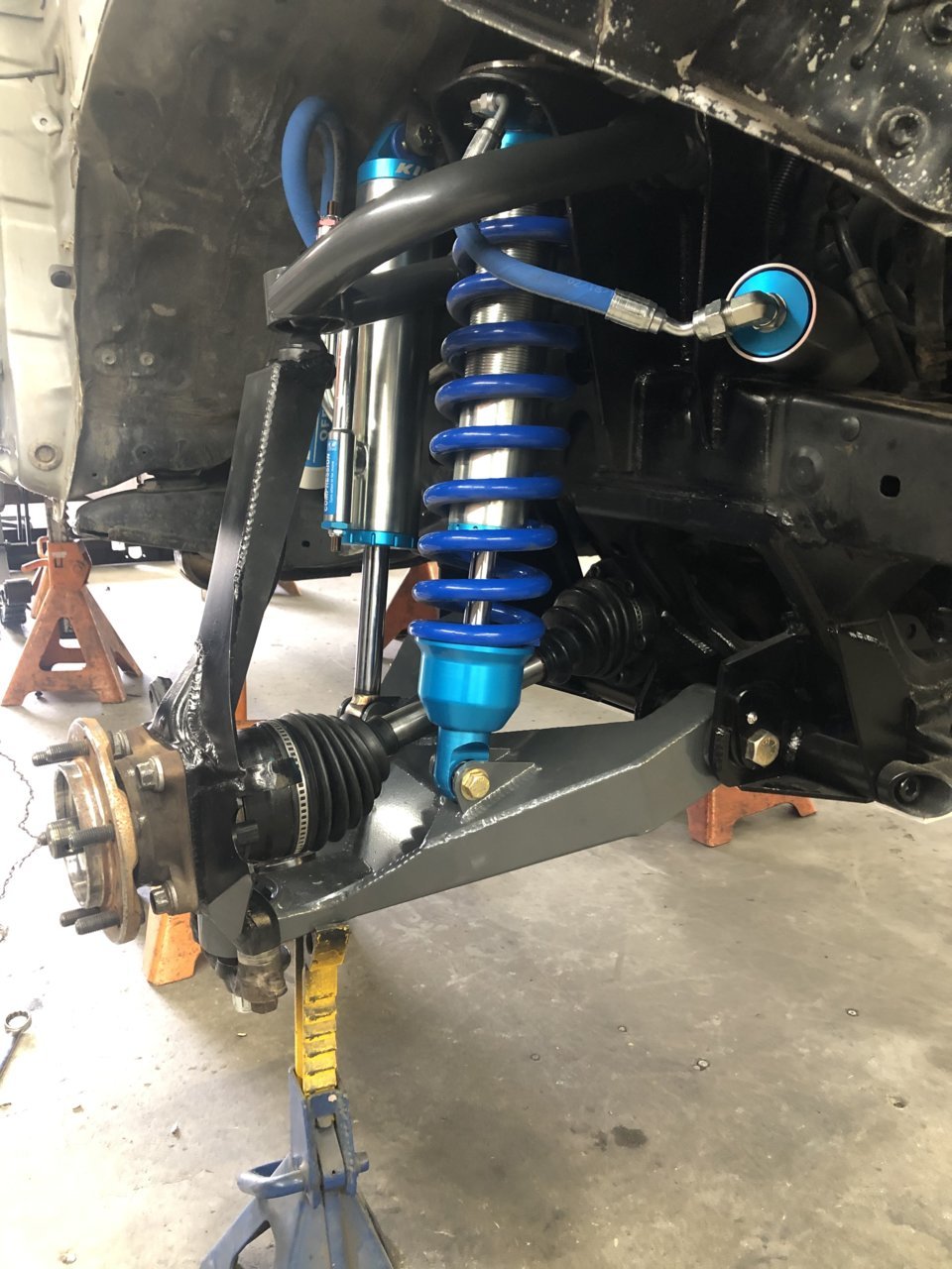

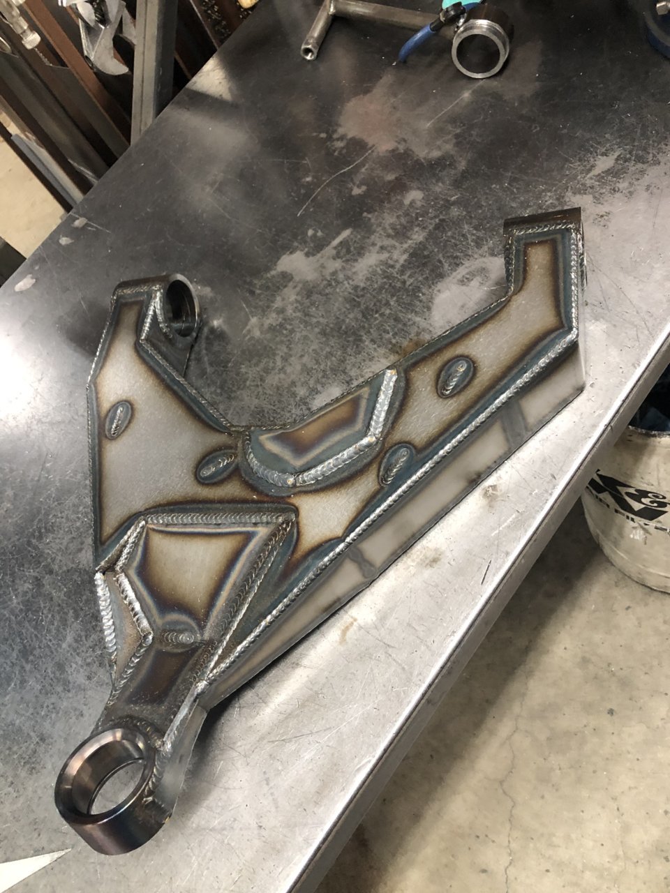

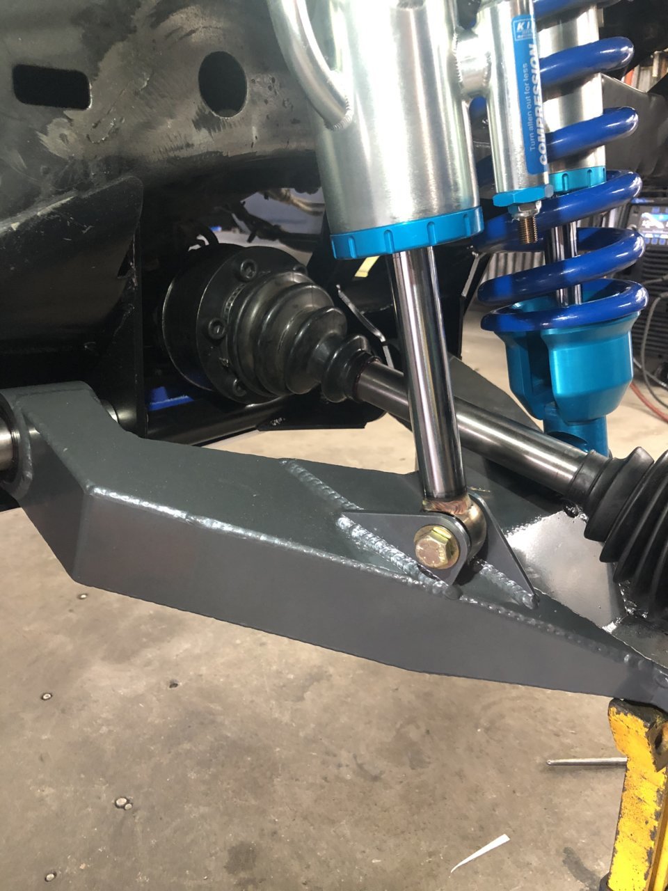

    3.0 bypass fits real nice with the 934 CV’s and the LCA relocation kit
  20. Jun 25, 2020 at 10:56 AM
    #380
    RonRon23
    RonRon23 Well-Known Member
    Aug 25, 2013
    #111135
    1,302
    Ronnie
    Buena Park
    2013 MGM DCLB 4x4
    Front suspension: Work in progress JD Fab +4 LT, LCA pivot kit, steering slide rack, 934CVs Rear suspension: Archive Garage shock relocation and SUA Conversion,King 14x2.5 shocks, King 2x2 hydro bumps, FN wheels 5 stars, sliders
    Damn that looks good. I wish there was a wider kit though!
