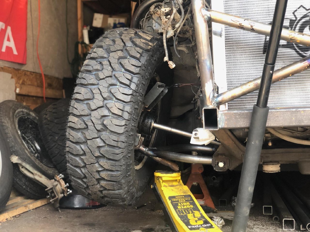

  11. Jul 23, 2020 at 4:05 AM
    #411
    Arcticelf
    Arcticelf [OP] Well-Known Member
    Jul 18, 2015
    #159735
    7,662
    Gladiator
    Hey guys, for those who will soon be taking apart outer CVs.
    Order of preference:
    1) The Pipe-Drop method. Hopefully you have better luck than me.
    2) Cut the axle, dissemble the birfield, and have a machine shop press it out with a 100ton press.
    3) See below.
    The last one I took apart I tried a third method:
    Take the birfield apart, and get the stub shaft and center piece out.
    Support the inner birfield with a small piece of tube on a cement floor or steel plate, with the cut end of the axle pointed up.
    Beat the ever living shit out of the stub shaft with a sledgehammer. I did it with a long handle 3#, if I have to do another one I'll use a 40#.
    Once the stub shaft moves 1/8", flip it over and drive the stub shaft out of the inner birfield.
    That 1/8" of movement is the snap ring breaking.
    old55guy likes this.

  14. Aug 2, 2020 at 6:07 AM
    #414
    Arcticelf
    Jul 18, 2015
    #159735
    7,662
    Gladiator
    It's coming together. Full bump will be about 3" of ground clearance.
