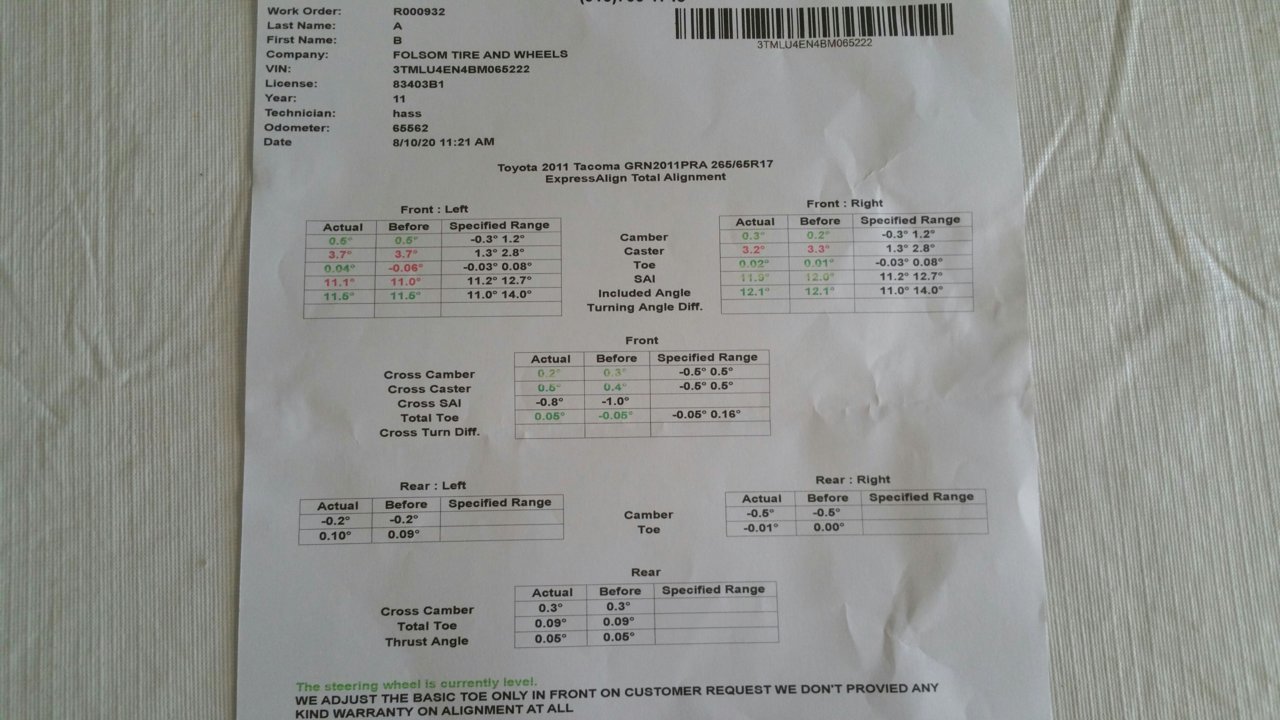

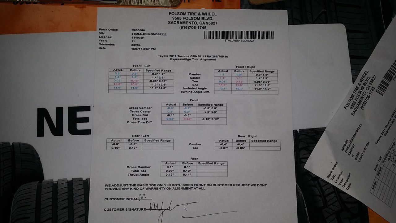

    So i had my alignment done How can I get more caster ? this is the best the alignment shop could do ? The pic on top was my alignment two years ago , Pic on bottom is my new alignment SPEC . All Good ???????? Or ????? Truck rolls down highway straight !

    More caster? you're already out of spec on the high side, looks pretty good to me? How many spacers did you use on the lower control arm?

    Ask the alignment guy for more

    I have all 3 pucks ( 1" ) in all my LCA ???

    Im in the same boat as you. All three spacers in to push the LCA all the way forward. I've got about 3.4 of caster on both sides. Truck rides great but I'm in the cab mount and firewall more than I was before.

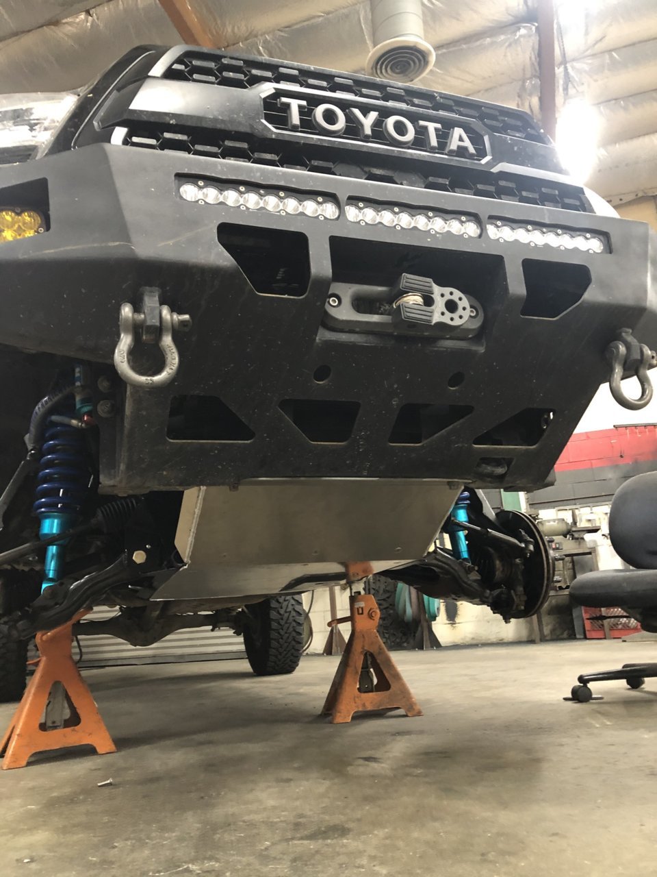

    2. Since on the 3rd gen the oil filter hosing is vulnerable do you have an option to place a skid there or pics of how you made one?

    I just made a connecting skid to protect the oil filter (see pic below)
    3/16” steel is overkill in my opinion

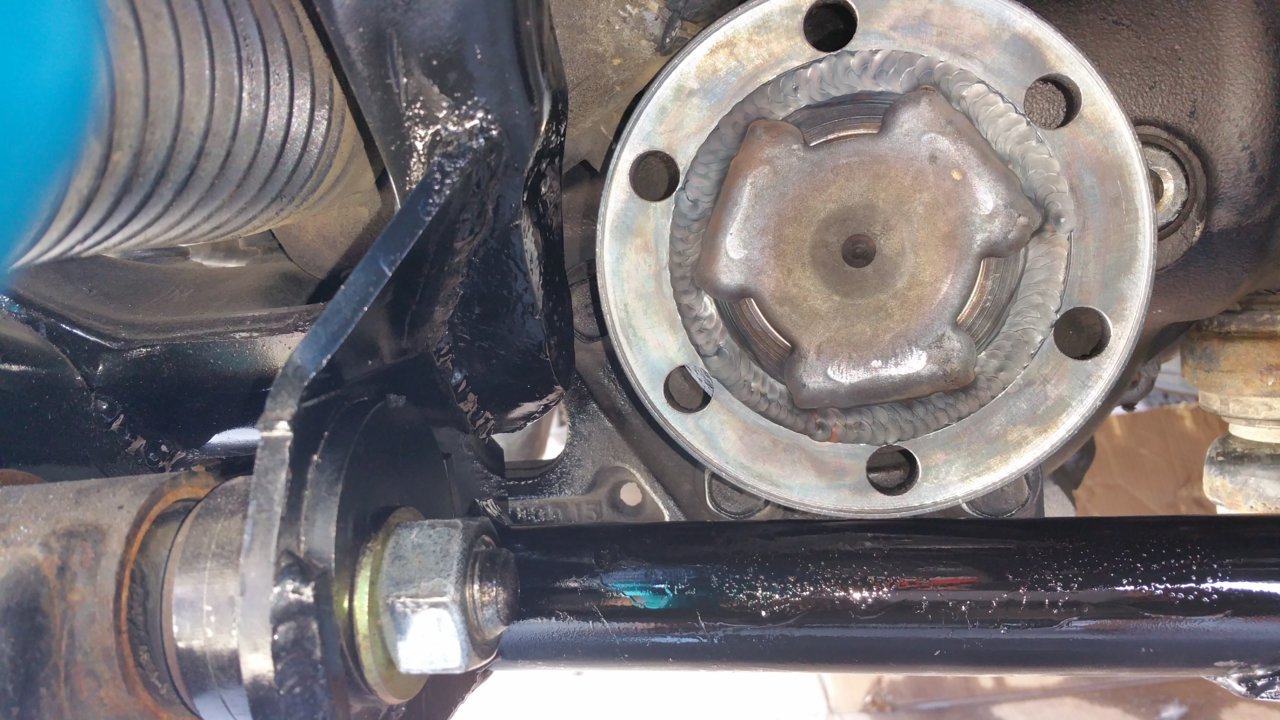

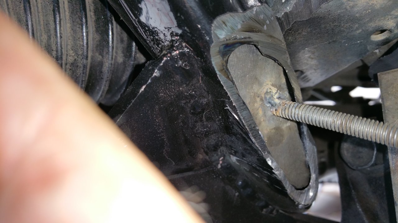

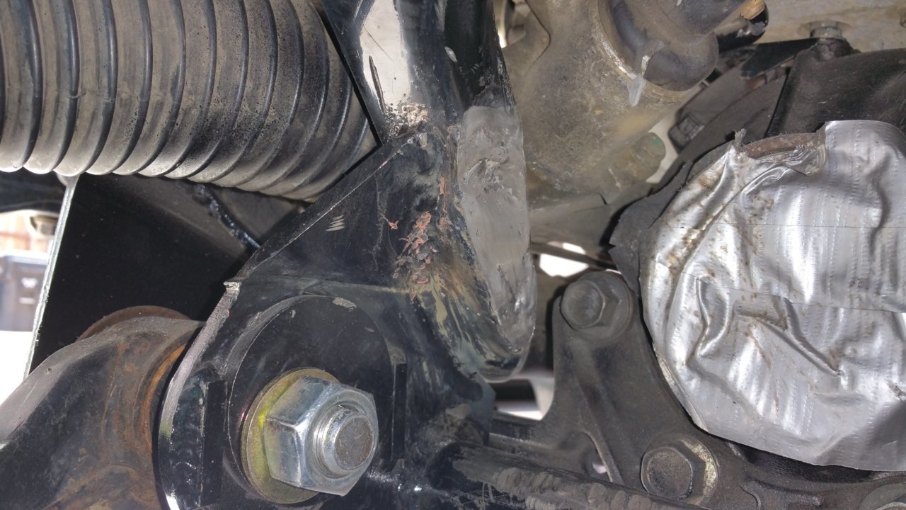

    This is how I did my fill n plates ? ( Yes I weld without gas , and yes lock nuts will be put on ) Hope to have this project done by next week , Time to move on .
