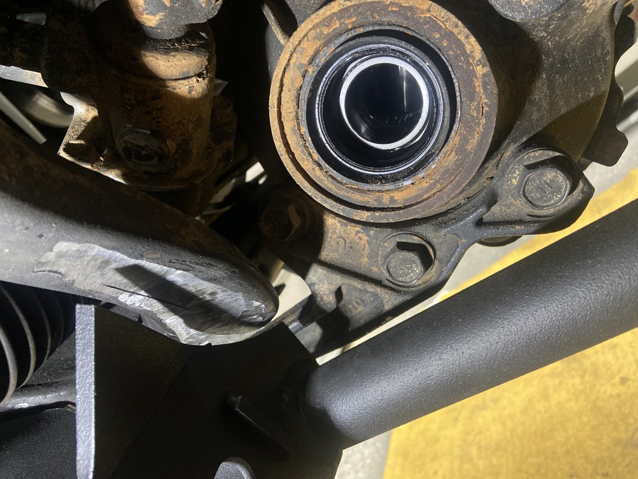

    Yeah I’ve grasped that. Now that I’ve got the OE LCA mounts off, and the new just bolted in to test fit, it’s like the new front LCA mounts are pushed too wide from the cross bar. And wide enough to get my fingers between?

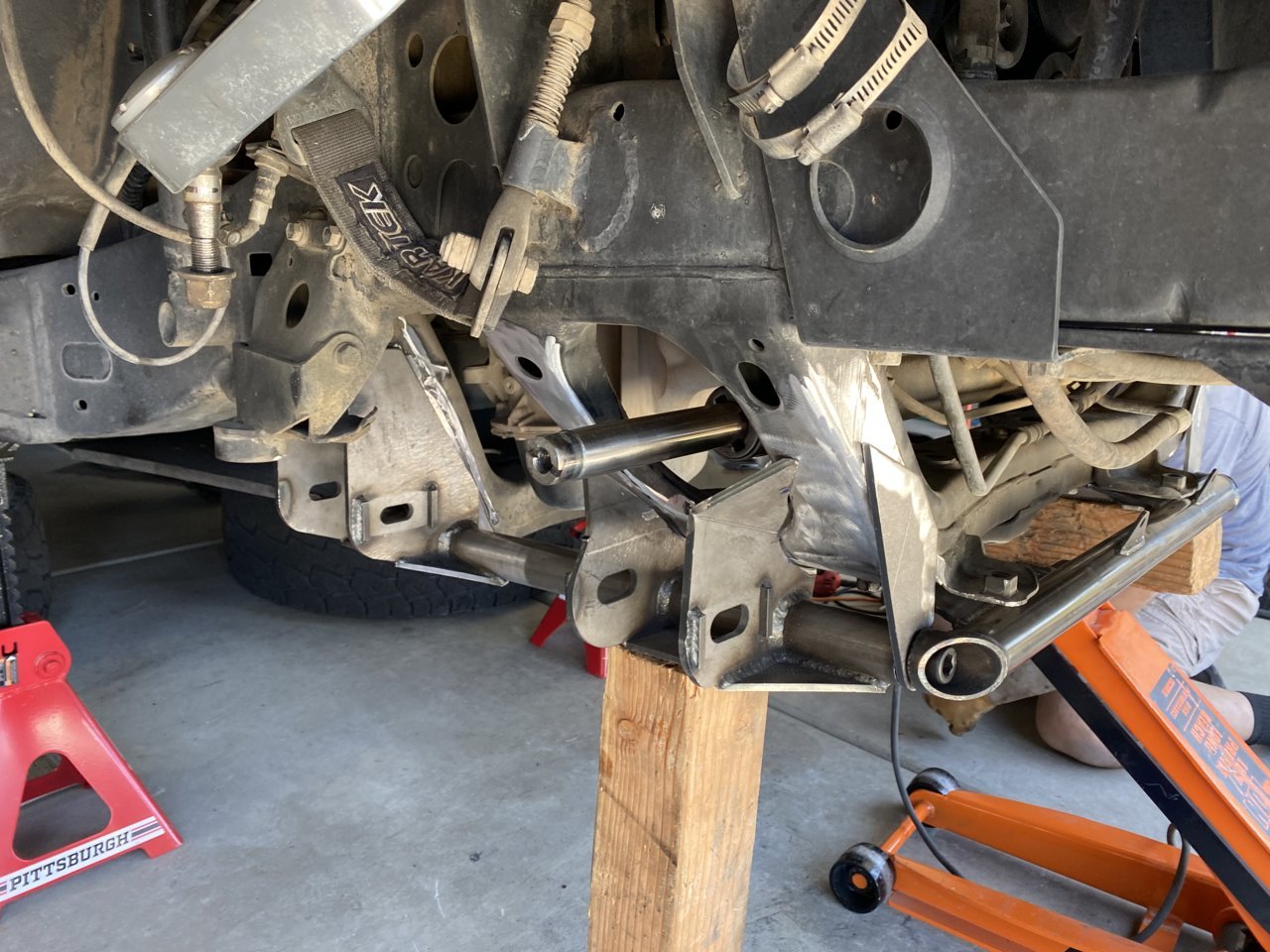

    Here is a bunch of pics of my install https://flic.kr/s/aHsmQKkER4
    After grinding to get things as close as possible...I also used a floor jack to push things up and into place and welded it in that way. The floor jack method will really close up the gaps. Pretty sure JDFab told me to do this...as i'm pretty sure I didnt think of this myself.

    Jack it with it bolted together?
    The front is spaced by a cross bar and indexed by skid plate bolt holes. It’s almost as if the cross bar is too wide. The gaps are large enough I can jamb 4 fingers in there and no signs of contact elsewhere preventing fitment. I’m gonna try to jack it in the morning, but concern is with as much movement as would be required to get against the frame. Something is bound to be out of line.

    Yup...take a look at this pic....I have floor jacks on both sides pushing it up into the frame...and I wasnt nice about it either...may have barely been on the jack stands
    After the fact...I was worried that the skid plate may not line up because I didnt have it on putting all that pressure on it...didnt make a difference...skid plate fit perfectly
