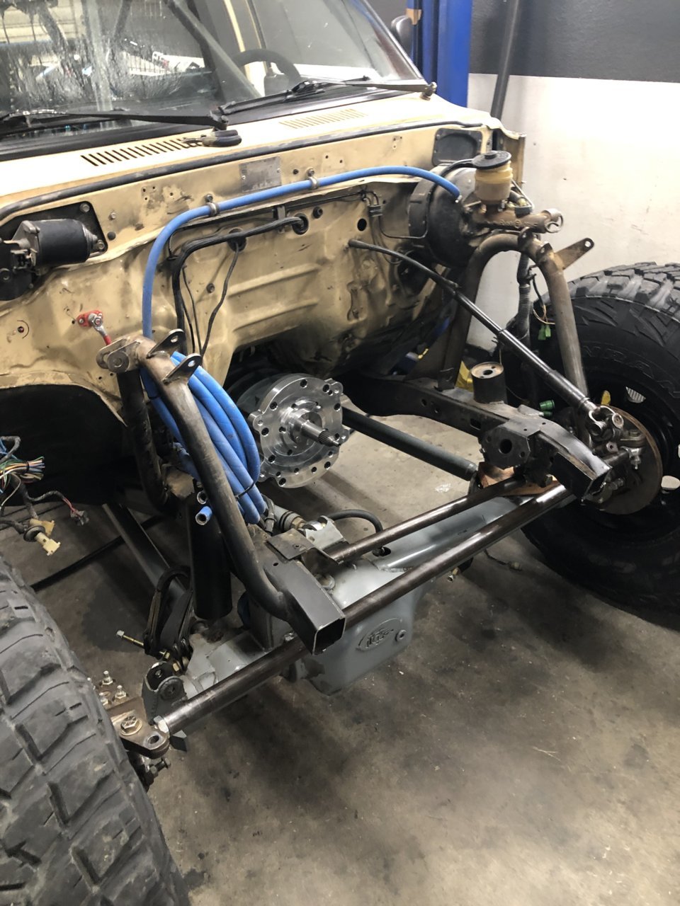

    If you're going fast it'll almost certainly rub the fenderwells at full stuff. In part because of the soft body mounts and thin sheet metal flex downward as the wheels come up.
    I rubbed on 33s going fast. The only solution is to either slow down or tub.
    Or do this: IMG_20200426_132832908.jpg

    Some times you just have to charge and cut things out that are in the way :)

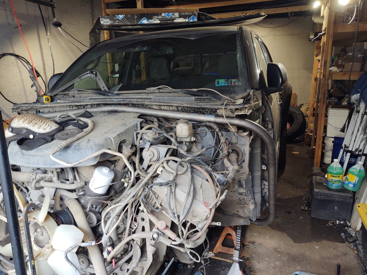

    You will. Fitting 35s with bump stop spacers (Dirt King stock length lowers) and still rubbing front under the battery and obviously the firewall. Keep in mind my truck has been in a prior wreck so I can only get 2* or so of caster but I still rub up front. If you're going to go 35s and are planning on wheeling, expect to work for it. If you don't want to do the work then stick with 33s. :headbang:
    Start cutting. :sawzall:
    and cut more...
    and more...
    Remove more stuff out of the way.
    Check clearance
    See more on my build thread. I don't want to clutter @Arcticelf's thread. Was just relevant to the conversation.
