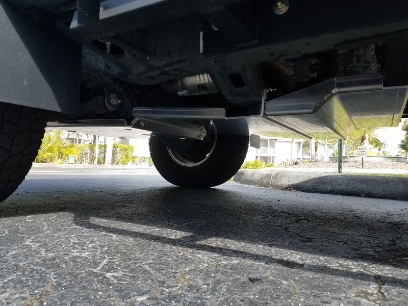

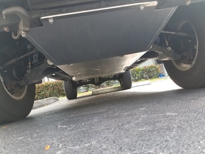

    Yessir, just had to loosen my crossmember bolts and the bolts that attached the trans/IFS. Got the middle IFS bolts to bite just enough to bring it up. Looks real solid, thanks @Mobtown Offroad for the quick reply and great product.

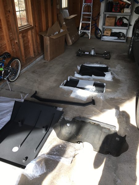

    Remove the OEM skid plates. Save the big silver bolts and the black smaller bolts, then you have to remove the front frame supports and remove the side/rear frame supports near the transmission.
    The Transmission skid is lifted into place first then the transfer case and secured together and then you mount the IFS skid.
    Its simple but involved, I would wait for instructions.
    The transmissions skid and transfer case skid mount to the 4 long bolts running through the transmission crossmember, you need to remove 1 bolt at a time and replace wiht a new bolt before removing the next bolt.

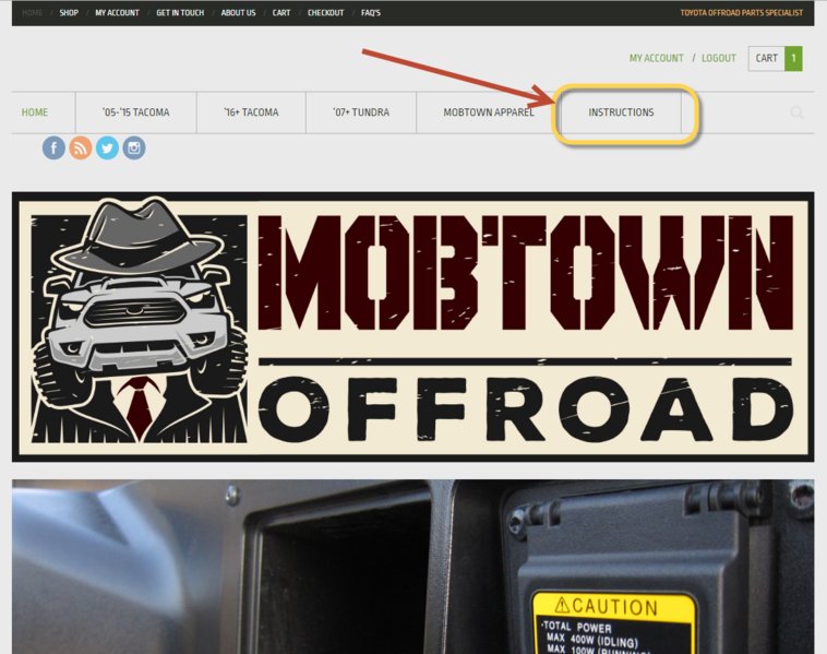

    Updated the new "Instructions" Page on our website. I'm not sure the skid plate instructions that I posted have all the updates that @Mobtown Offroad added yet.
