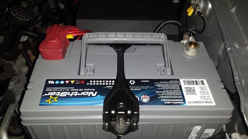

    I installed mine (27F) today, I was able to make it fit without messing with the handle. I had to take the bolt off of the front j-hook, attach the back j-hook, line up the front j-hook and press it down before threading the bolt. It is certainly snug and took a few extra minutes, but the handle is down.

    "Problem" solved with a TRD Battery Hold Down. Outstanding design, workmanship, and service! Thanks, @Coupe!
