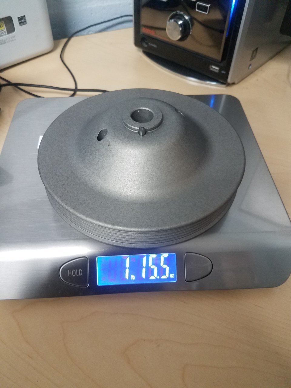

    Update:
    You guys at going to be unhappy with what I'm going to say.
    I was doing some pulley work inside the engine today and was observing tolerances in a much more up close and personal level for the supercharger and found that the work required for an overdrive pulley is going to be far too extensive and would require far too many pulley replacements which would further drive costs upward for all of us. We are best off producing a lightweight billet version of the OE sized pulley.
    Pricing for these units is to be announced hopefully sometime late next week if all goes according to plan. All those no longer wanting to be a part of this group buy, I understand. Please let me know and I will update the list if necessary.

    It sucks we get stuck with such a cramped up engine bay. This was likely done to prevent us from playing with boost levels easily.
    The other alternative to all of this is going with a full cogged pulley setup. That would require some HEAVY time and R&D though, as the belt would without a doubt have to be under an inch in width and cogged setups would require a full change in their sizing to run the same ratios we are at. It would all be incredibly custom not to mention it would be highly likely be an instant smog fail for emissions visual people.
    Considering the Magnuson supplied OE pulley has some weight on it (just .5 grams shy of 2lbs) this is still what should be a good mod for weight reduction. I am glad I found this out before actually fully engaging XPO in the production of pulleys, otherwise we would all be incredibly disappointed and much more broke because of it.

    Due to the size interferences from the idler pulley immediately from the right of the crank as well as the water pump pulley, we cannot make the crank pulley any larger than it currently is. The crank pulley size is maxed out directly from Magnuson. Any boost adjustments would have to be done at the Qwickchange pulley. :(
