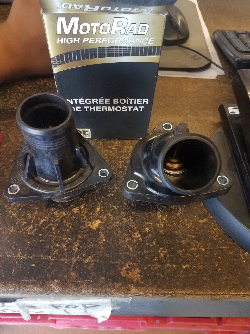

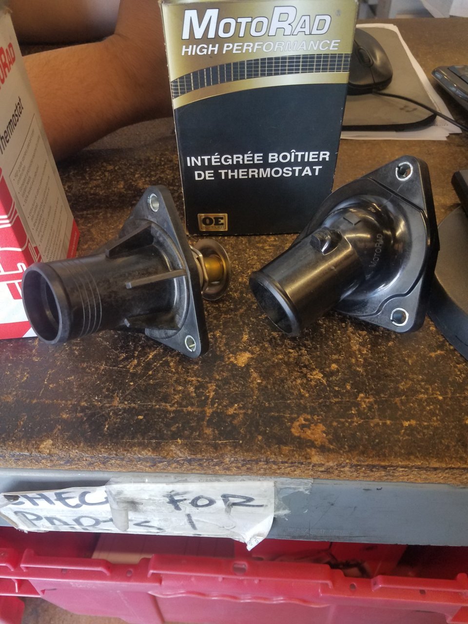

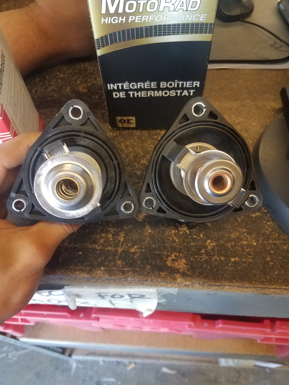

    Well here is what I got. The fitment bolt pattern is INCREDIBLY close... The Tundra one SHOULD work, however I am uncertain the pattern is an even triangle design. If we have a shorty version which can mount whatever way we want then theoretically speaking we could mount it facing outward the other way and we could use the current lower hose we have with some small tweaking. Pictures below of differences between Tundra and OE pattern.
    One thing is for sure. It IS shorter than the OE Tacoma flavor.

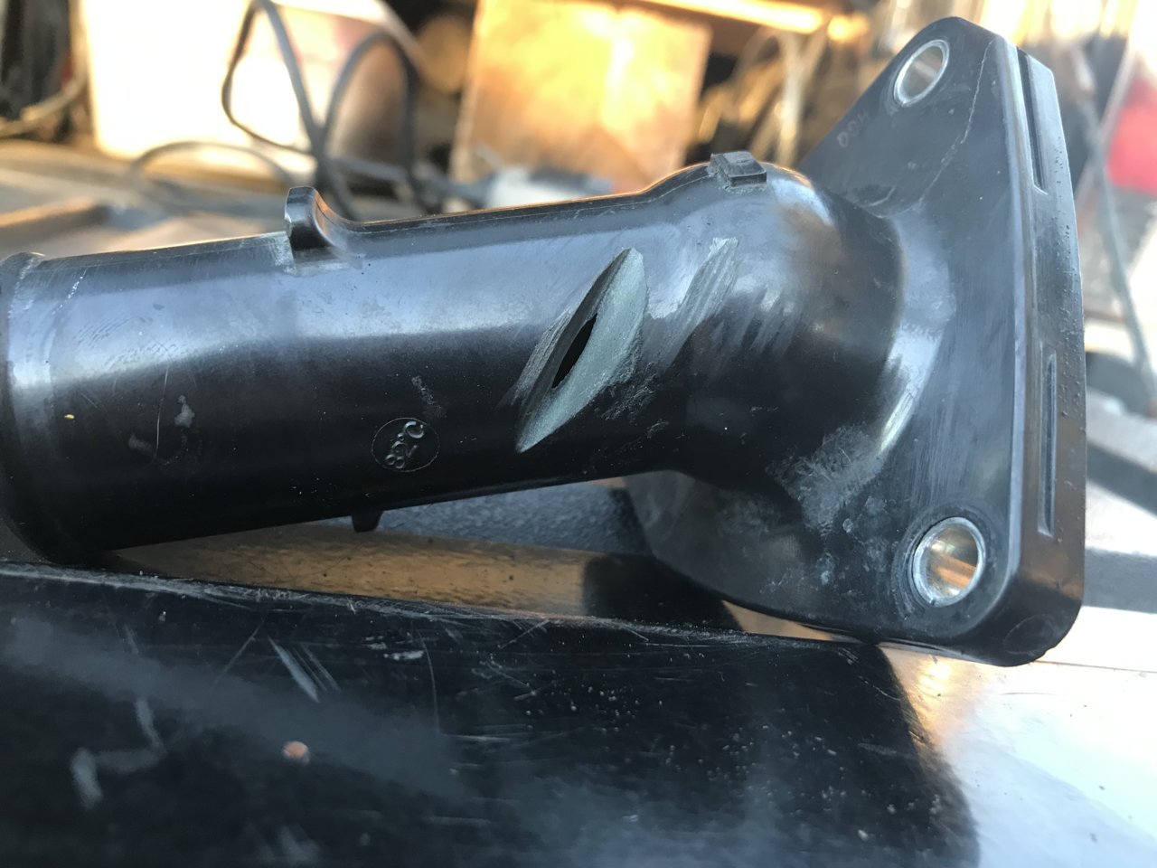

    As someone that has had a belt chew through the thermostat housing, im not sure swapping to a tundra one will yield you any more clearance in the direction you need it..
    Below is a pic of where your belt is going to make contact

    Yeah the Tundra one may not be more favorable over the OE offering. There is another option potentially which may or may not be able to work and that is a housing off of the Sienna. I was looking at that one and it seemed like it could potentially work. I'll have to keep searching but at least we know other options which may not require modification to fit to our trucks do exist and that in itself is a win.

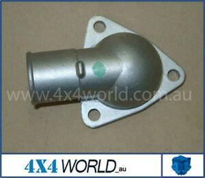

    I have tracked down two more possibilities. We would have to buy them from down under Aussie however, but a Hilux design would route the hose to an angle and then straight down, or just straight down. I don't know if it would be exactly what we need though.
