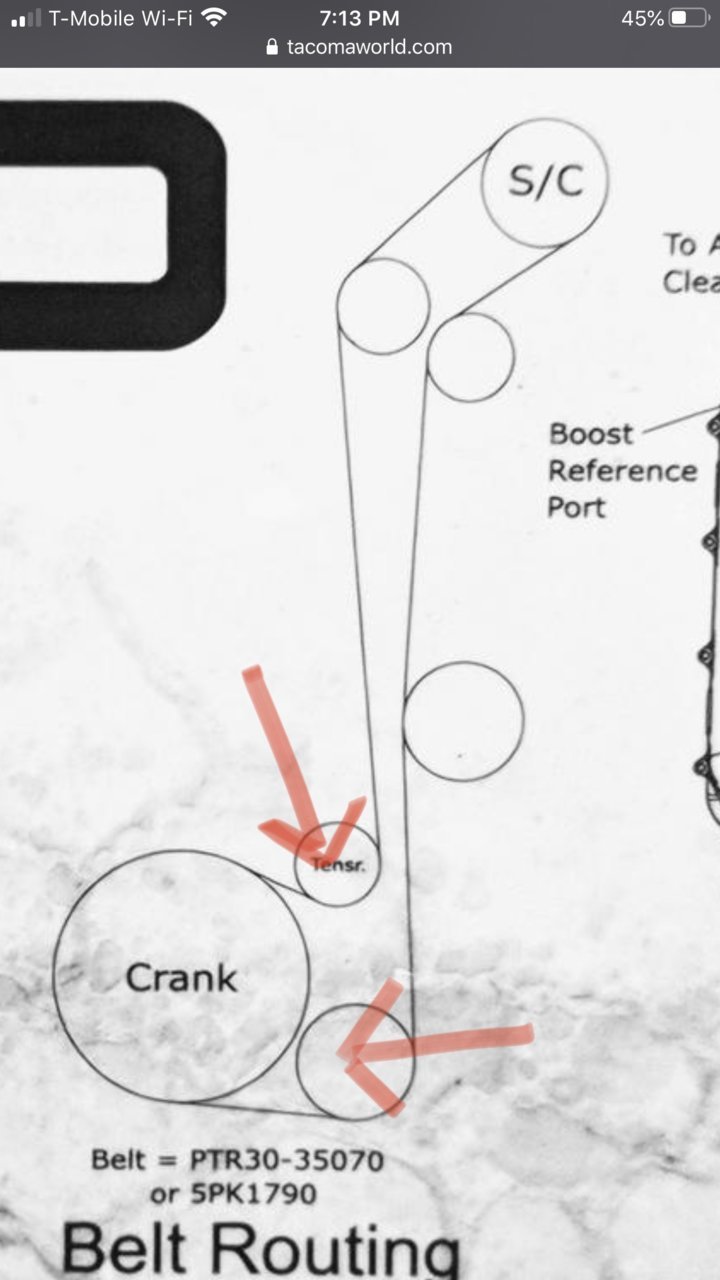

    For everyone asking about the NST overdrive kit and what it entailed from pm’s. The NST SC crank pulley was much larger in diameter than the stock TRD SC crank pulley. Therefore the two TRD pulleys marked in the diagram below had to be replaced as well. So NST included two smaller version pulleys in order for everything to fit properly.

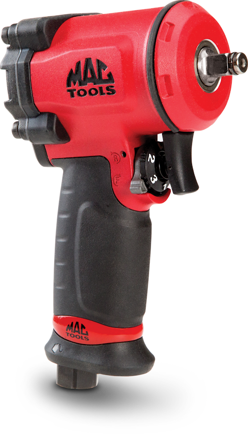

    It's a slightly larger model over this one below, either way either will work, but I prefer IR impacts.. they have always been absolutely bulletproof. This one would fit with zero issues no problem in that tight space, but I love the small IR gun for this job.
    This model is the Mac Tools AWP050M. It definitely packs a serious punch as well.
