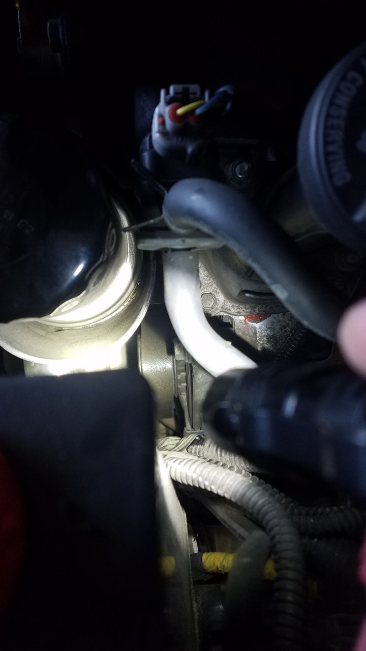

    20200112_101342.jpg So obviously havent taken anything apart yet... but there is my alternator with the stock pulley still on. Looks pretty close... I cant see that having a lip.

    So no solid word on lip or no lip on TRD trucks..... seems to be a case by case basis on whatever the mechanic at the factory blindly pulled from the bin when your truck rolled past him on the assembly line.
