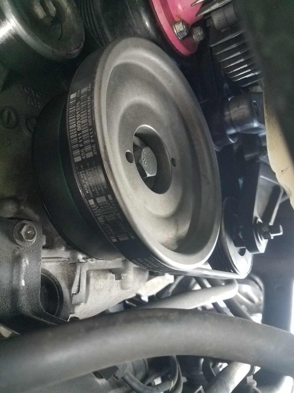

    It's the lowest, largest pulley in the setup which drives off of the crankshaft. The pulley you upgraded is the highest point of the setup. This is the lowest and the largest pulley of them all which should measure some 6.5" in ID. Here is a photo so you have a better idea of what I am referring to.
    The large gray pulley, far left.
    Here is a better shot of it.

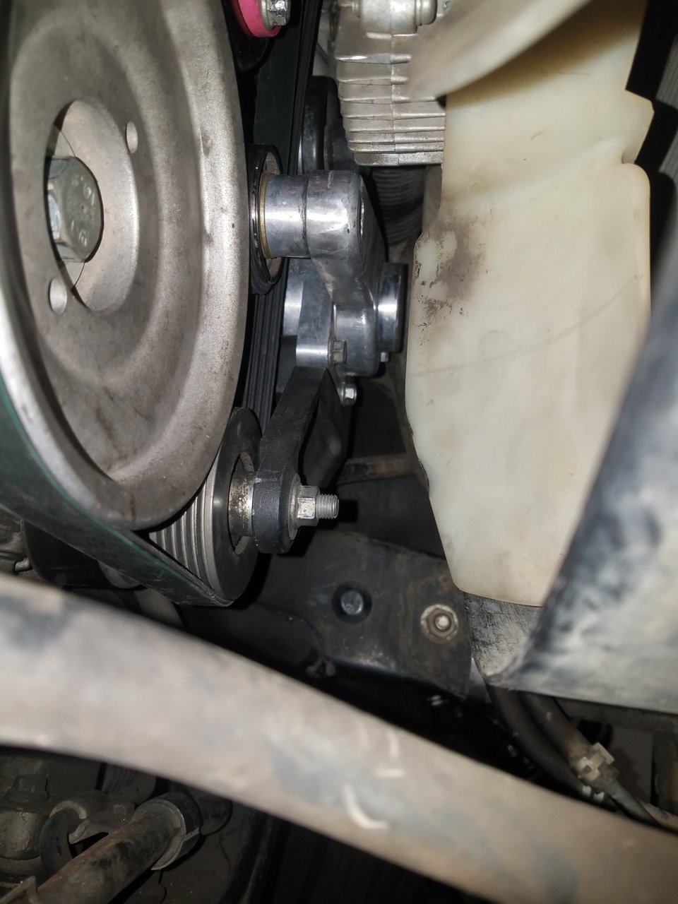

    Believe it or not it may cause interference issues. The fitment in there is that tight. However, being that my idler pulley for my beef tensioner is a 50mm and not a 54.58mm as OE is would allow me to run a 6.6" pulley as my idler is .1 inch smaller over original OE design.

    UPDATE: It turns out I have the full CAD drawings necessary for this to become a "thing." I'm going to message @XPOTRPR and I'll send him what I got. We'll see how we go from there. If everyone is on board we can make a pulley .1" larger over OE flavor which would offer up to 1-1.5 psi over what we are currently seeing without having to touch Qwickchange pulleys, however most members would need to upgrade to the Roush unit and change the pulley to the 50mm LFP double bearing roller as has been discussed in the tips/trucks thread.
