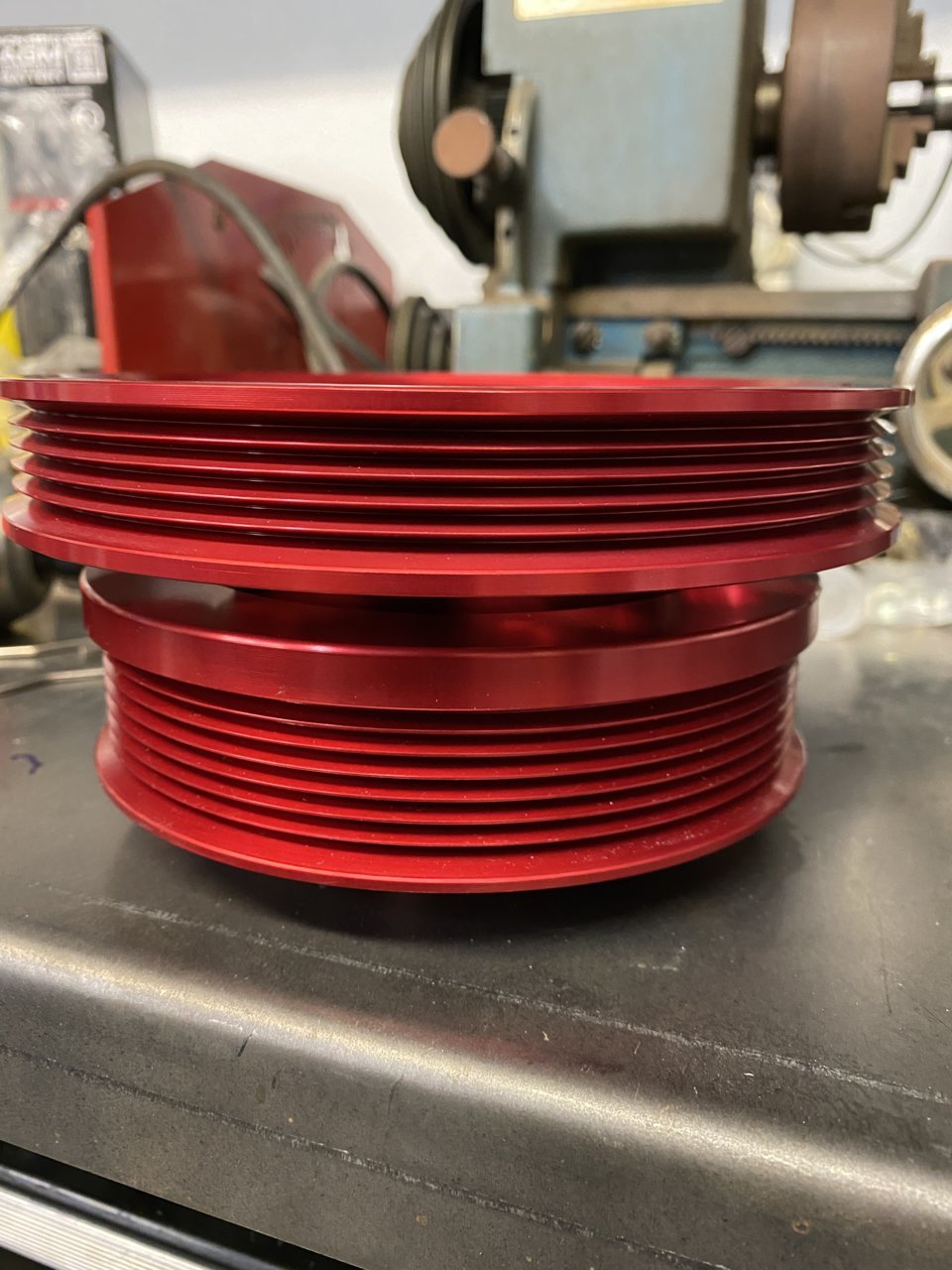

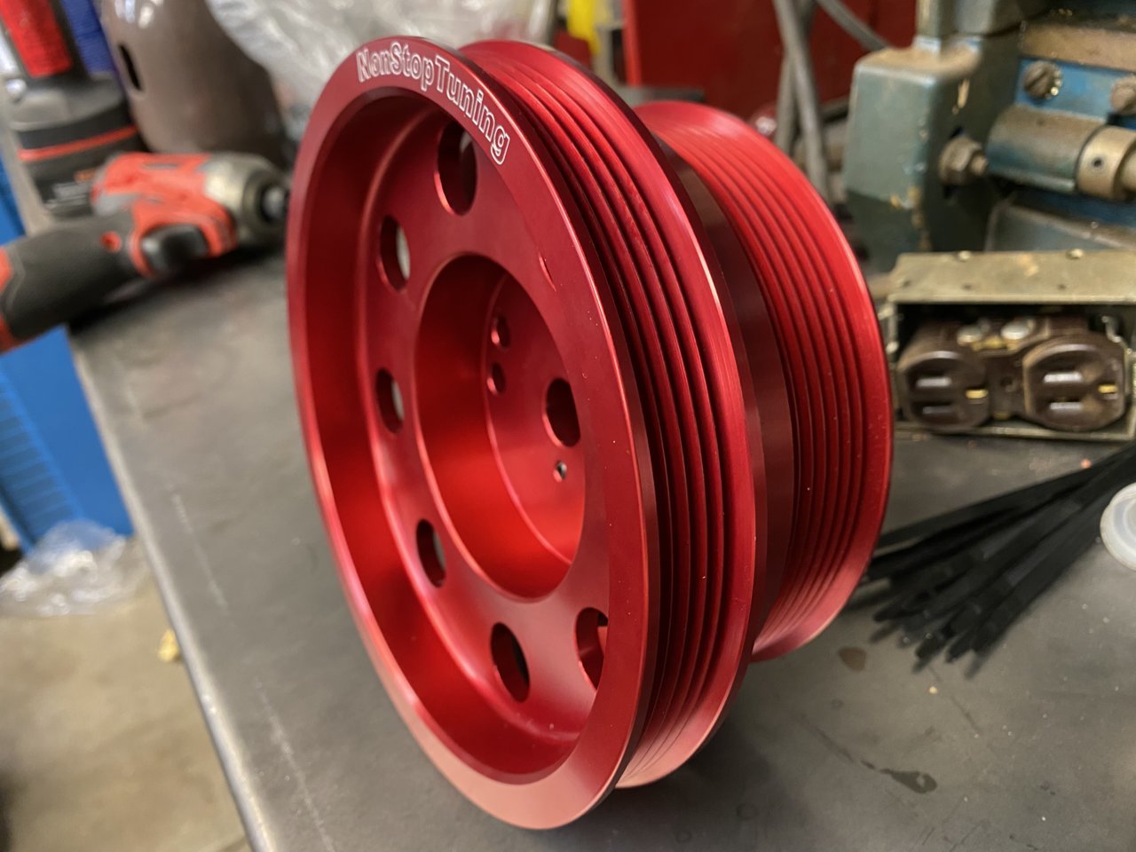

    Granted my truck is torn down at the moment so it was quick to swap on.

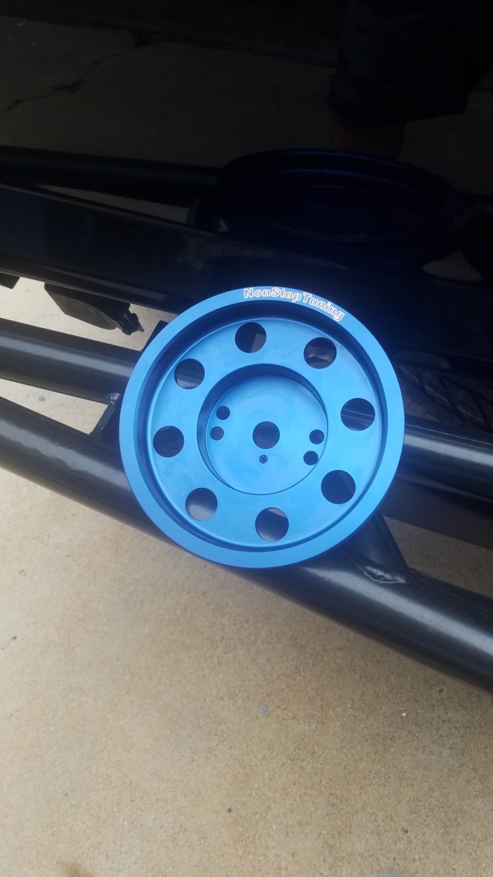

    20200404_182704.jpg Everyone knows blue provides the most HP gain...

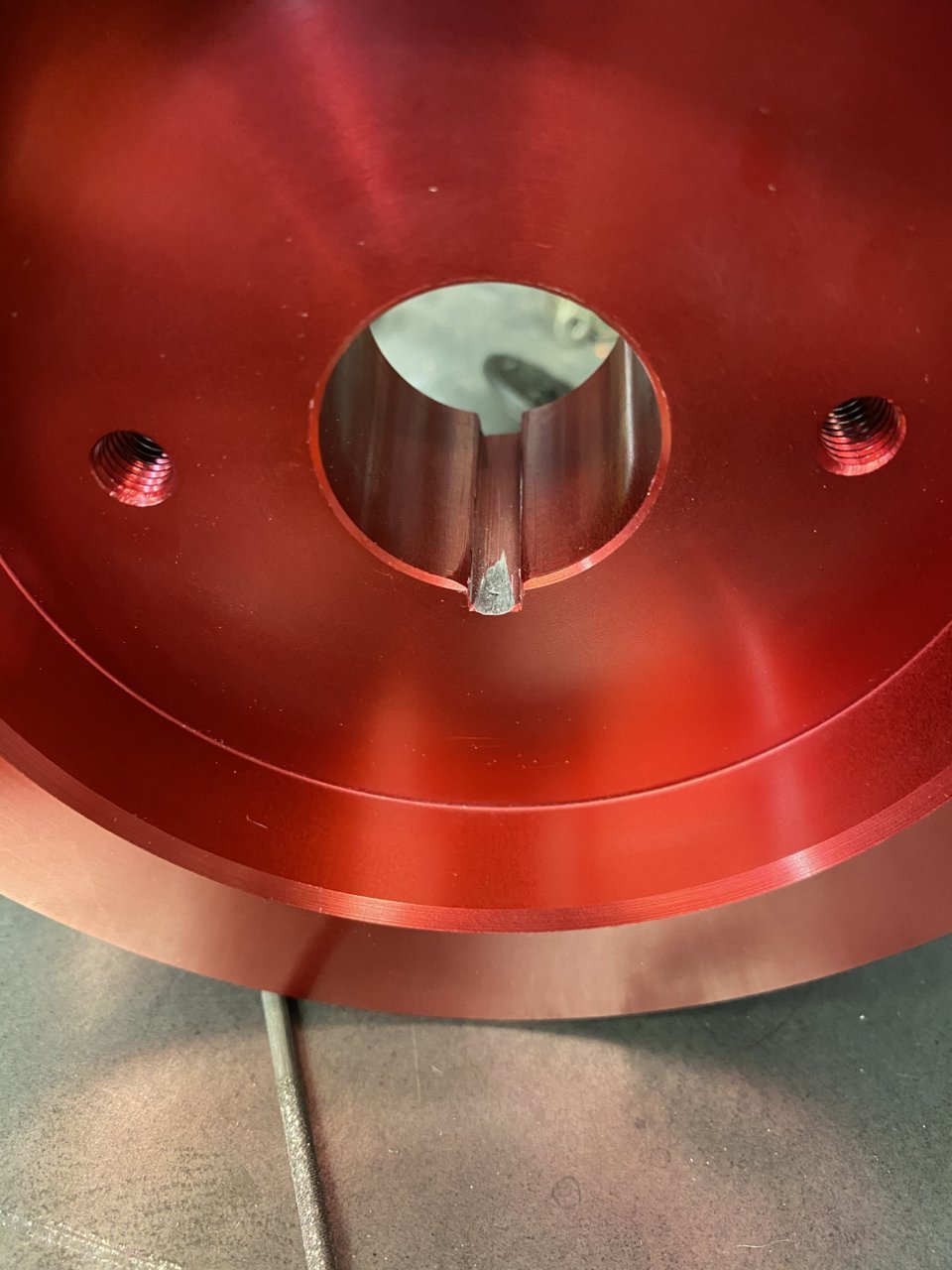

    This is for those who are swapping out the crank pulley with their NST S/C pulley. The NST crank pulley does not have a mark on it so not impossible to find TDC but much easier by checking the crank pulley first when tearing into the engine. The TDC has nothing to do with the SC NST pulley since the guide pin orients it regardless.

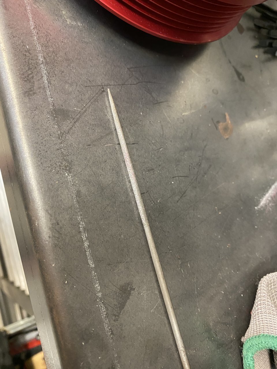

    had me second guessing if I needed to do that on the SC one. When I tossed it on today I pulled the NST and cut a nice line where I had marked it before. Just in case.

    you don’t need to put at TDC when you pull the pulley. You can only install it one way but if you need to do cam gears or anything with chains etc you will want that line on there. So when you take off stock put it against the NST find the line and mark it. I had a line I marked but did a small cut today similar to the factor one.

    New pulley color match is pretty good with the crank pulley I bought from @JustDSM
    Had to file the groove a bit to get them to play well together.

    Lining up a crank pulley to TDC is VERY important when doing internal engine work. It is essential in ensuring that everything is lined up correctly when either removing or installing cam gears, cams, timing chains, timing belts etc. etc. I'd you do not have the mark or make the mark on your pulley and you have to do internal work later on down the road you will be very sorry you didn't do it.
    This right here. I used a cut off wheel on the dremel to make a small slit on where the TSC mark is supposed to be then sealed the mark with some blue assembly paint. The same kind that was originally on the supercharger 3.0 pulley for our trucks.

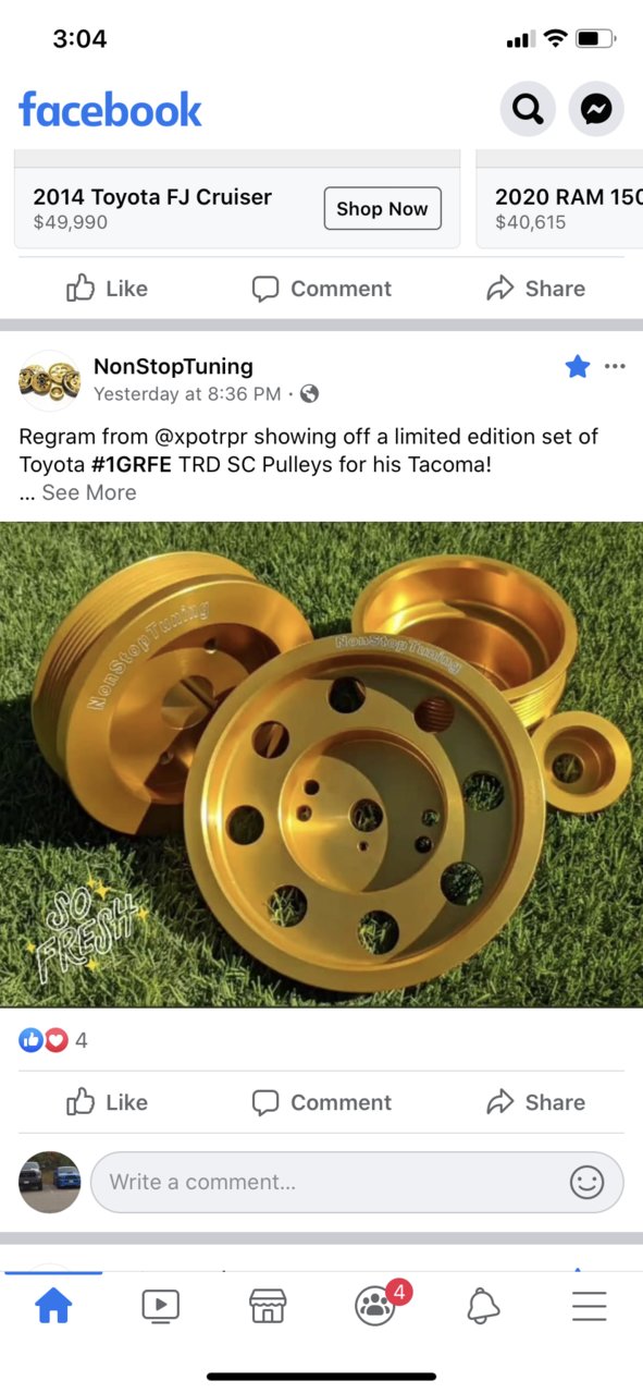

    Nice. Nonstop posted my picture. Shame all this gold is gonna be hidden. Lol

    oh.. fancy, facebook too huh. I dont have that. lol
