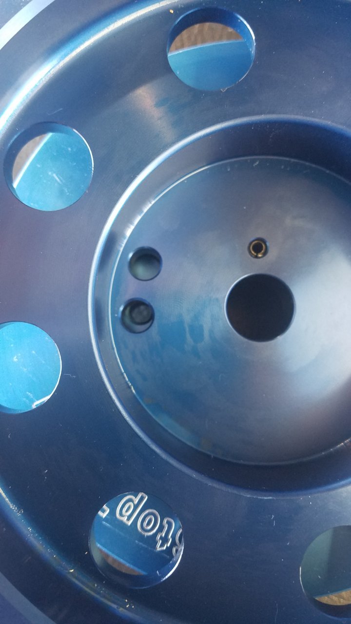

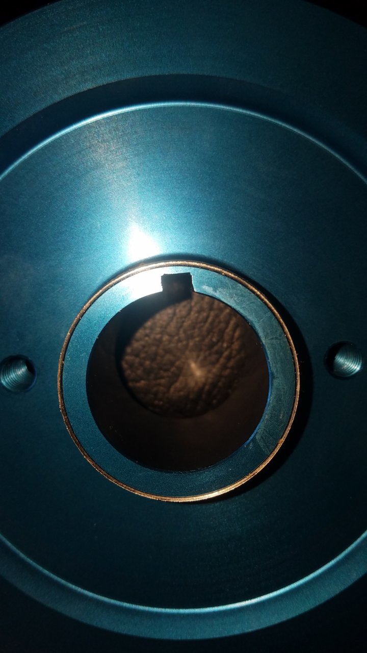

    Has anyone had issues with bolt holes being misaligned between the two Crank pulleys? I just took my stuff to mechanic since I don't have time and he says they don't line up.... ARGHhhh

    Throw up a picture of you can. I want to see what your mechanic is talking about.

    What exactly appears to be the issue? It looks fine to me but if it's not you may want to take a straight on shot of it so I can better assess the holes. Worse comes to worse you can just open up the hole a little bit if need be with a Dremel or similar then put a dab of grease on it and on the metal sleeve to prevent corrosion and scoring of the sleeve on the crank seal.

    The 2 holes that go through the pulley don't line up. isn't that what holds them together in addition to the crank bolt?

    No. It's just the main hole and the keyway that lines up once they are put together. The holes on the side are irrelevant.

    @zerotimeouts if your mechanic is not capable of understanding the way that those crank pulleys are assembled (especially since they have to remove the old ones in the process, which specifically highlights the assembly design of the setup) they just did you a favor by being too short-sighted in outing their competency as technicians and you need to find yourself a new mechanic.

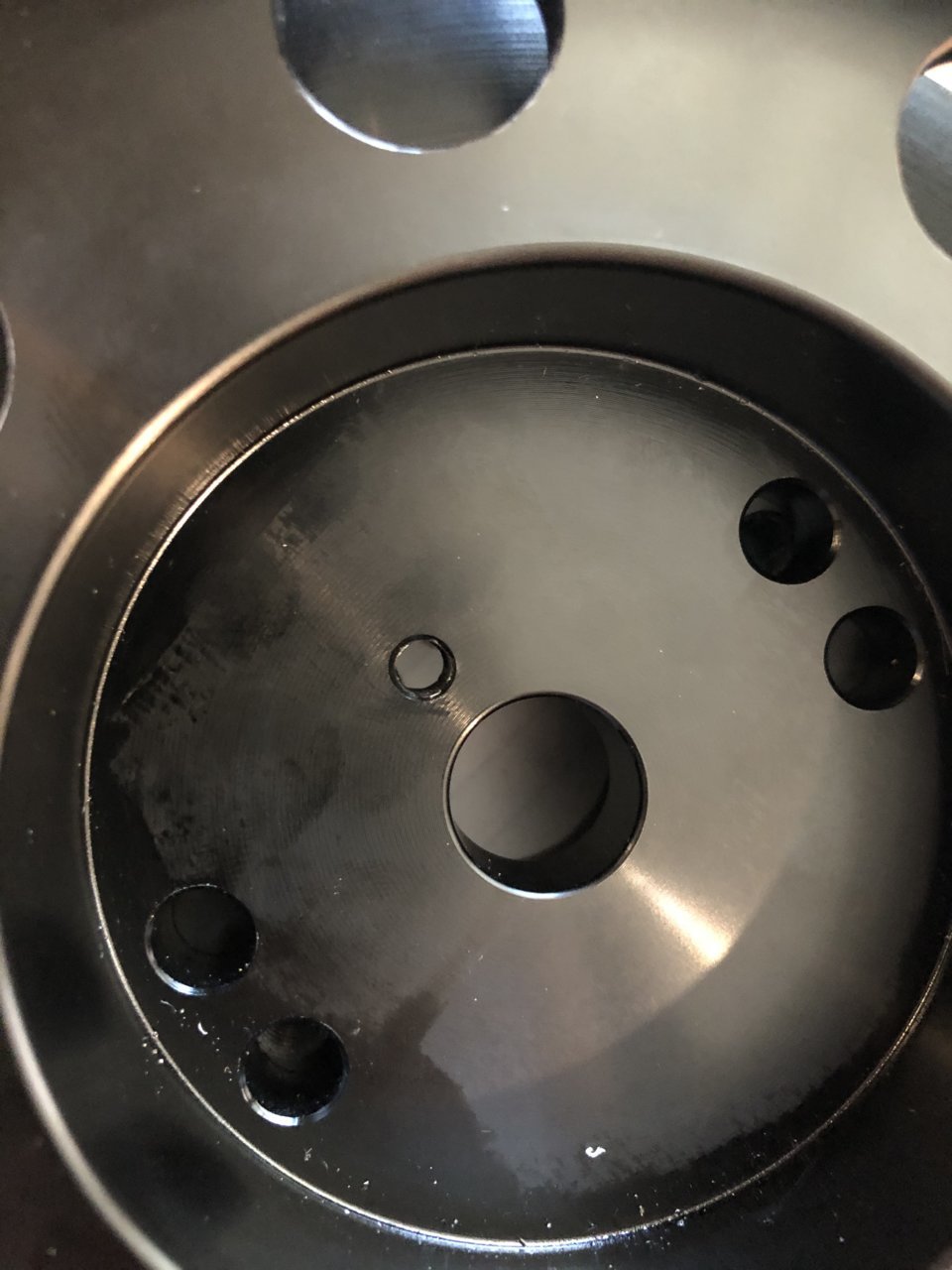

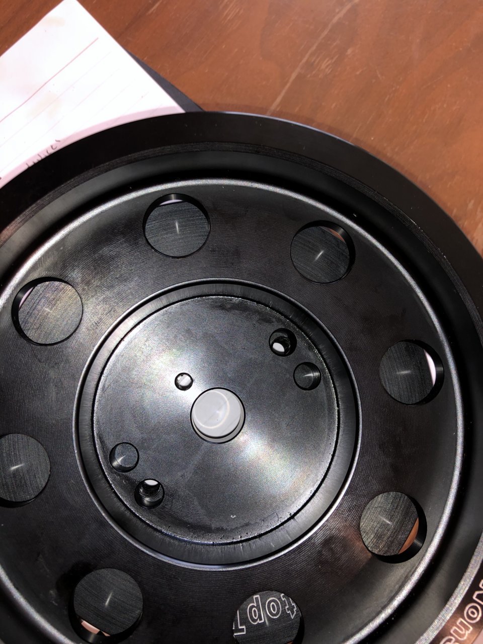

    How important is the dowel? NST SC crank pulley matches the stock one. The NST crank pulley has holes that don’t match stock crank pulley.

    How did you end up solving this issue? I’m sure I can rig up some tool to hold the SC crank pulley while I tightened. Trying to figure out how to solve this issue as mine looks just like that.

    Those holes aren’t used to secure the pulley right? Just used to hold the pulley with the tool for crank bolt tightening right?

    The SC crank pulley holes are smooth and supposed allow the screws to pass through to the crank pulley where they screw on while using pulley install tool. Mine don’t align as they should when both pulleys are aligned by the dowel key hole. So yes to your question. Trying to figure out how to attach the tool.
