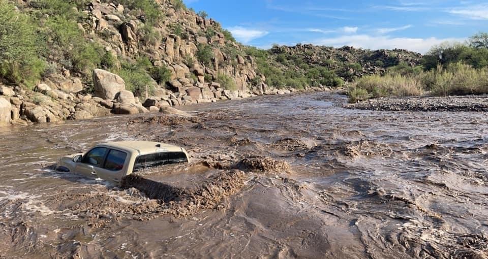

    islandhiker[OP] likes this.

    Yes! how did you manage to take the picture?

    This I can also do!
