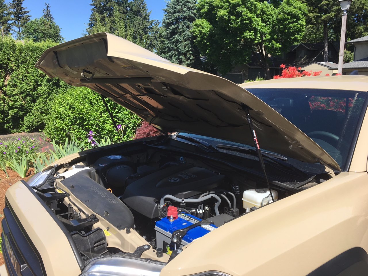

    Just installed mine, only issue was a few of the holes in the brackets were too small to allow the rivet to pass through. Simple fix and it still took less than 30 minutes.

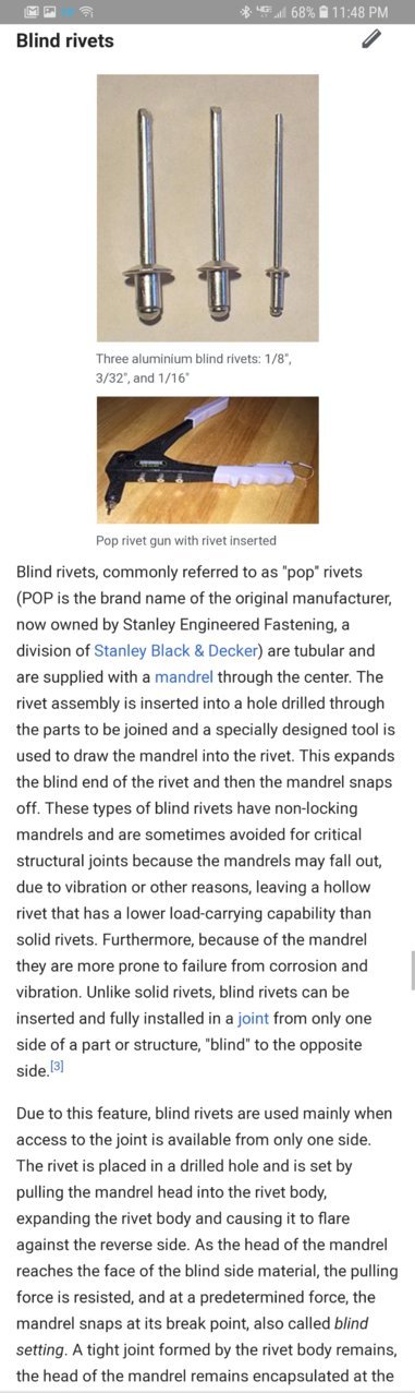

    I'm confused. What's the difference between a Blind Rivet and the rivets that come with the kit?
    Edit - just looked on Wikipedia and it says that what come with the kit are Blind Rivets and the term Pop Rivet is just a common description for them.
