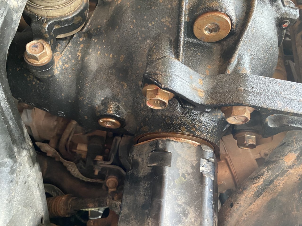

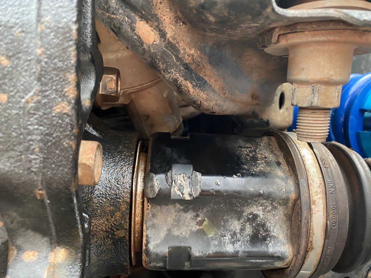

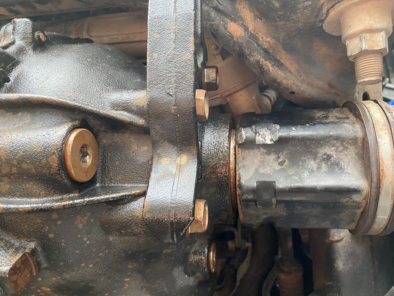

    4737F194-EA3F-42D3-9006-6E6DD3080D5F.jpgAnybody that has regeared already have any issues with the front diff leaking? These are pics of my driver side axel.
    33C3C2CF-9743-46D4-BF7C-AD739F546123.jpg 92AB78BB-2CA8-4757-B909-E62EDCCB3099.jpg
    You can tell they banged the shit out of my cv.

    Is it really leaking or is it just mess left from when they changed it? Hard to tell from the pictures.

    No it’s leaking because I used brake cleaner this morning on it, drove it to work and back, and checked again ☹️
    I also noticed more play on the driver side axel going into and out of the diff. I believe this is the clicking noise I hear occasionally when driving.

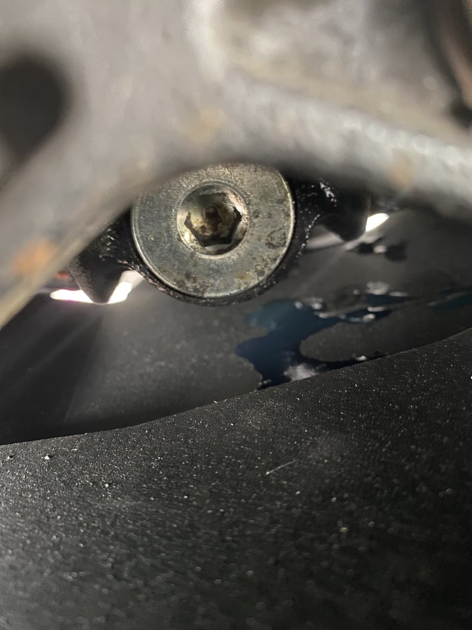

    I waited til after to change from my stock skids to an RCI skid. There was a mess on the stock skid but I figured maybe from the changeout. Cleaned it up, installed the RCI skid and you just reminded me to go take a look again. Seems to be leaking on mine as well. Guess I will have to get back in touch with them.

    Yeah I called off work to go back tomorrow morning.
    Looks like yours is leaking from the drain plug which will probably be fixed by putting a new washer when changing the fluid after break in.

    That’s a good thought, I haven’t inspected further since initially seeing it so maybe I’ll give it til then. Thanks!!

    I wasn’t sure how much play there was supposed to be. Thanks for the insight. I called and they were cool with me bringing it back to change the seal.
