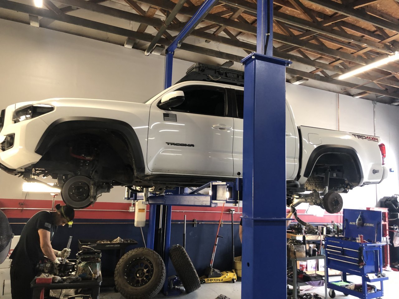

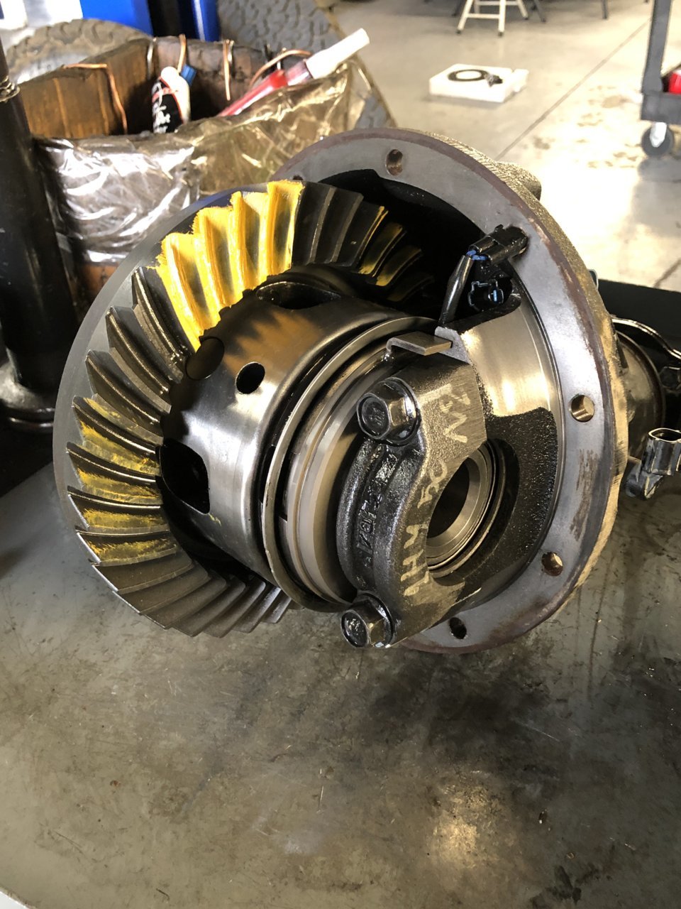

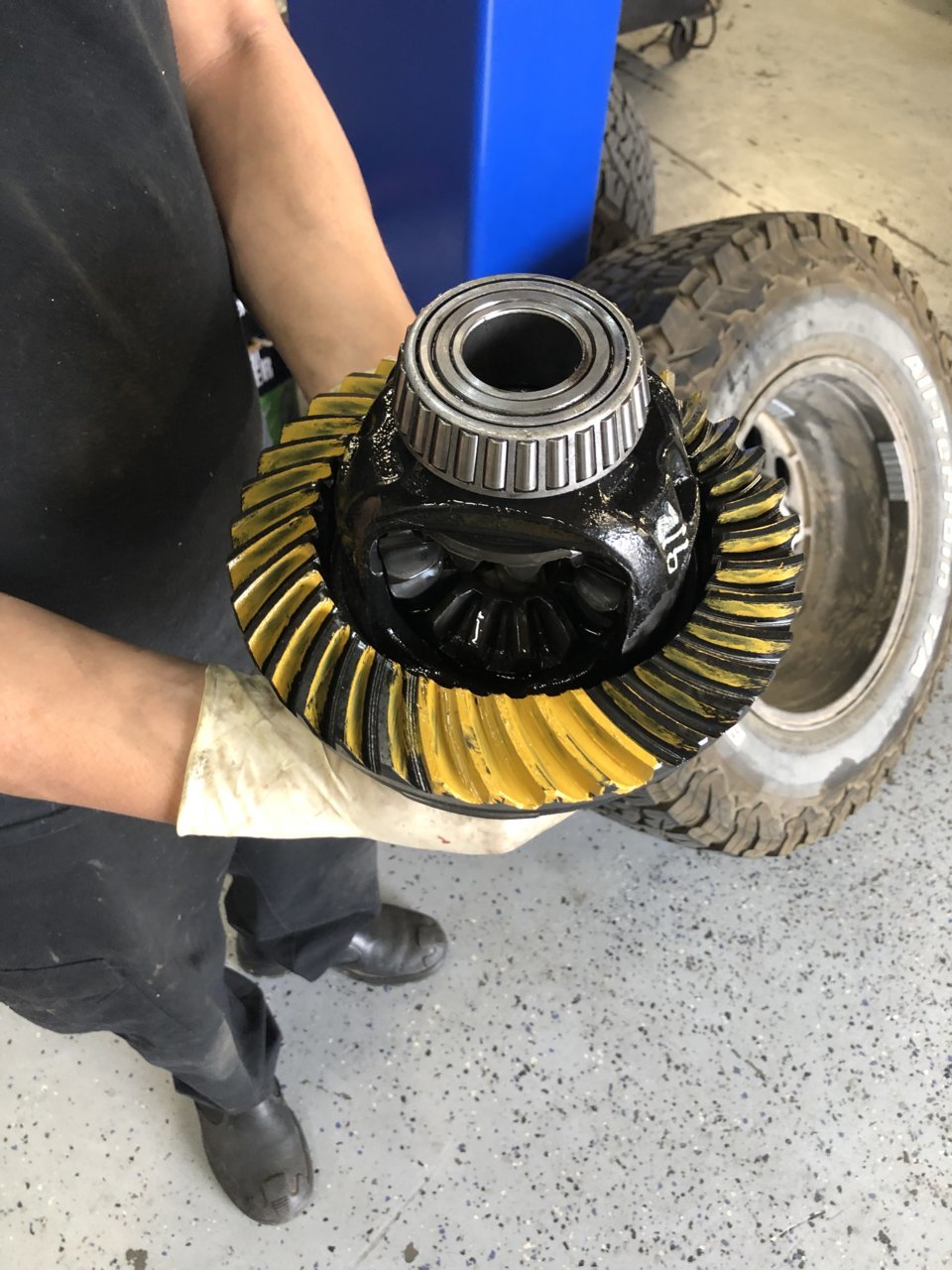

    Just under 2 hours for the whole process! Thank you to Miguel, Carlos, and team at Premier for getting this done. So happy and HUGE thank you to @SoCalTacoTruck for hosting this group buy and saving us lots of money.

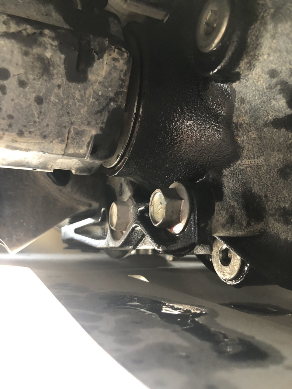

    9C64CEAB-9C5F-4757-944C-271CFBE3740C.jpg Ugh. I wish I could report completely good news for today. Gears felt great, during my breaks I checked the truck for leaks, everything fastened down, etc. Got back home to San Diego, let the truck sit for an hour and come out to check only to find my front driver's side CV is leaking. Sent pictures and a video over to Miguel and they're going to fix it, but have to make the 1.5 - 2 hour drive back up....
    Here's another thing for you guys to check prior to leaving Riverside. Check the play between the CV axle and the front diff to ensure there's no leaks/excess play. Unfortunately it didn't leak during any of my breaks up in that area.

    Smack CV in with a flathead, clean off the fluid, drive it, then check again. I've had this happen so many damn times.

    Yeah, did that first. Took a pry bar and mallet to try to get it seated, drove another set of highway/street miles, still a good amount of leaking. It's okay, we'll get it resolved. The gears feel good!
