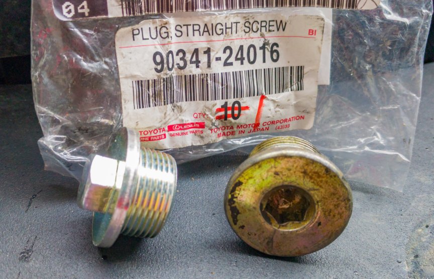

    I recommend replacing the front diff drain plug with the lexus drain plug 90341-24016 since the Toyota plug can easily be stripped. IMHO it's worth the $20 price tag.

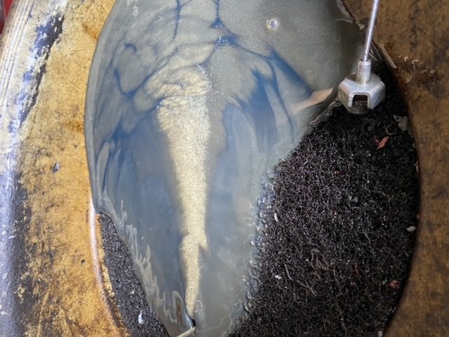

    just a few things.
    How did your guys oil look? Mine was like this. Does that look normal? Wanted to stick with amsoil so went with thier 75-140 severe gear. No leaks for me and torque was good

    Just changed the diff oil, the plugs required a breaker bar but they were not stripped. :jellydance:
    My front looked a bit like this, I don't know if having the ECGS bushing install had anything to do with it :notsure:
