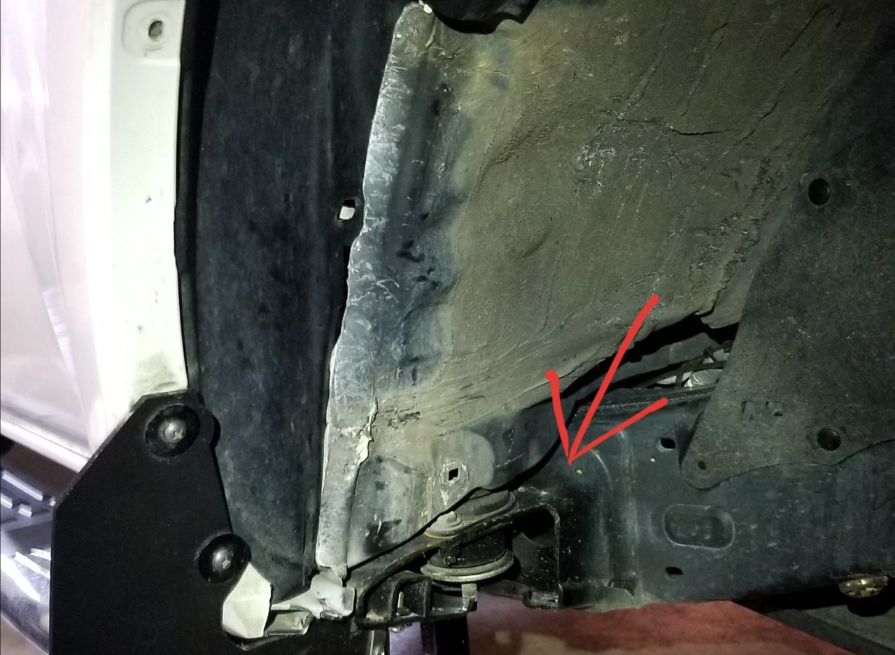

    So if you look in your front wheel well there is a section of frame that pokes out into the wheel well. This is what the whole cab is bolted down to. A cab mount chop basically cuts 1 - 2" off a section of this frame to allow larger tire fitment within the wheel well. Here is a picture after I did my CMC. The arrow points to that section of frame. Compare it to what your wheel well looks like.

    So do you remove it with a grinding wheel or plasma cutter or what? How does it affect the structural integrity of the body/frame?

    Yeah I just used an Angle grinder and cut it off. Supposedly it doesn't severely affect the integrity but some people will weld in plates to put the integrity back. Most people I think just leave it open like I did. Just make sure to spray some paint on the exposed steel to prevent rusting.

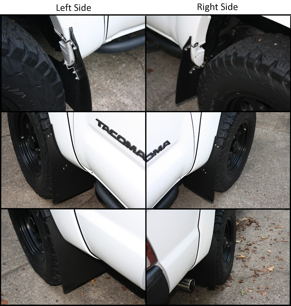

    OK. Here's mine. All for corners (Front ones have two views each).

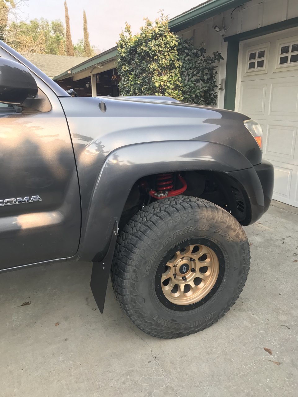

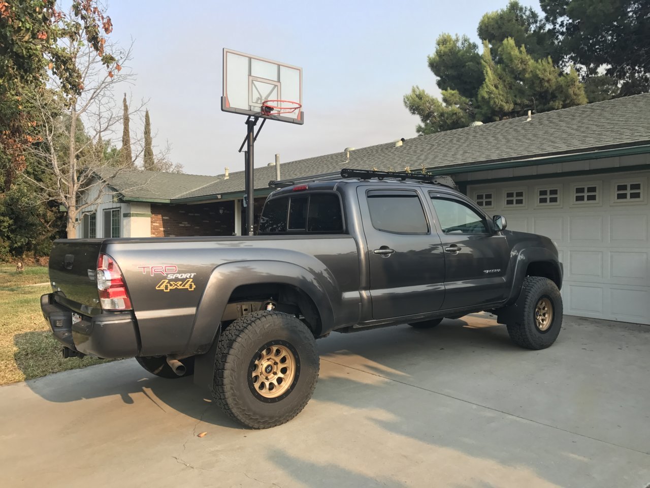

    Installed my rokblokz flaps yesterday, the fit and finish seem of good quality, although they are somewhat of a pain in the backside to install due to the Phillips screws. Overall, good road flaps.

    I'm going to be selling mine. I had them on for a week and they rub terribly for me. As I said before, I'm not dissing the product; it's just that with my combination of lift and tires, the front rubs even on an easy 45-degree turn.
    I really liked them; it sucks that they don't work for me. :(

    What version do you have? Regular VS Short, oversized wheels, color ???
  19. Aug 14, 2018 at 5:08 PM
    #299
    Tactical_Panda
    Tactical_Panda Armchair Anarchist
    Mar 6, 2017
    #212502
    7,162
    Tim
    Fredericksburg, VA
    2015 Tacoma Double Cab, Off-Road Edition
    AJT Designs Shifter AJT Designs Battery Hold-Down ARB Awning 2500x2500 ARB Twin Compressor w/ Slee Offroad Mounting Bracket Avid Brush Bar Avid Step Bars Black Rock Wheels Series 997 Type 8 Circuit Breaker/Relay Panel Custom TRD Decals Bulletproof Fabricating Raptor Grill Bulletproof Fabricating Cooling Panel Bulletproof Fabricating Tow Hook Duluth Trading Company Dog Hammock Exhaust Breather Mod eBay Special 3-Gallon Air Tank Expedition Essentials TPAM EZ Down tailgate damper Flagpole Mounts, Dual Foglight Mod Front Camera Rear Camera; full time available General Grabber tires Goat Armor Hella Supertone Horns Iggy Switch Panel Icon Dynamics Stage 3 Suspension Katskin Leather Interior KickAss camp shower LED Bed Lights LED Interior Lights Midland MXT275 GMRS Two-Way Radio OEM Audio Plus Reference 500 audio upgrade Plano Cases. 42" roof mounted, X2 Pop-N-Lock Tailgate Handle Prinsu Cab Rack Prinsu-like Shell Rack Redline Tuning Hood Struts Rigid Industries 40" Light Bar Rigid Industries Ditch Lights Rigid Industries Spotlights Toyota Bed Step UltraGauge EM Plus v1.4 Vixen Air Horns, Four-Trumpet Whole bunch of decals worth about 5HP each Yakima Road Shower, 10-gal
    Short, Oversize, Black
