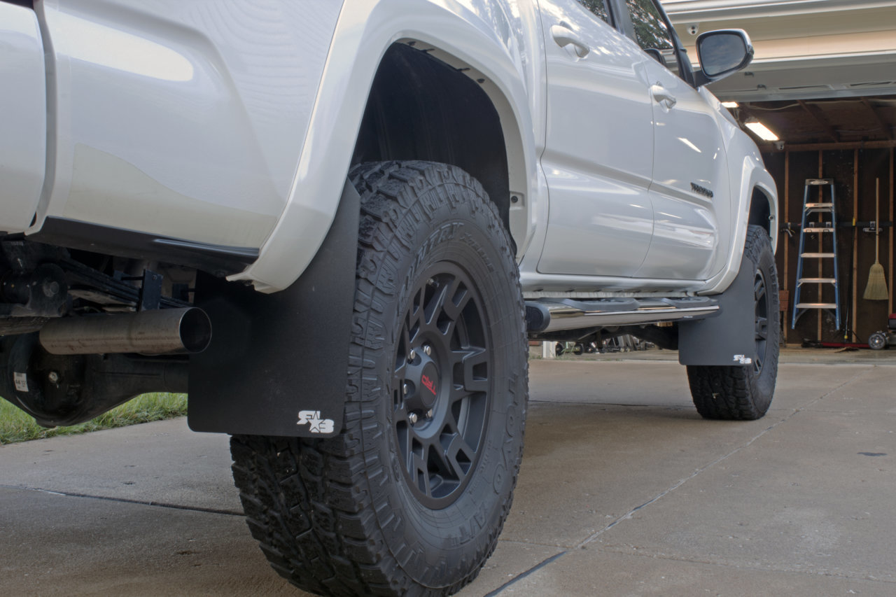

    Hope everyone is enjoying their flaps! Finally got around to installing mine tonight.

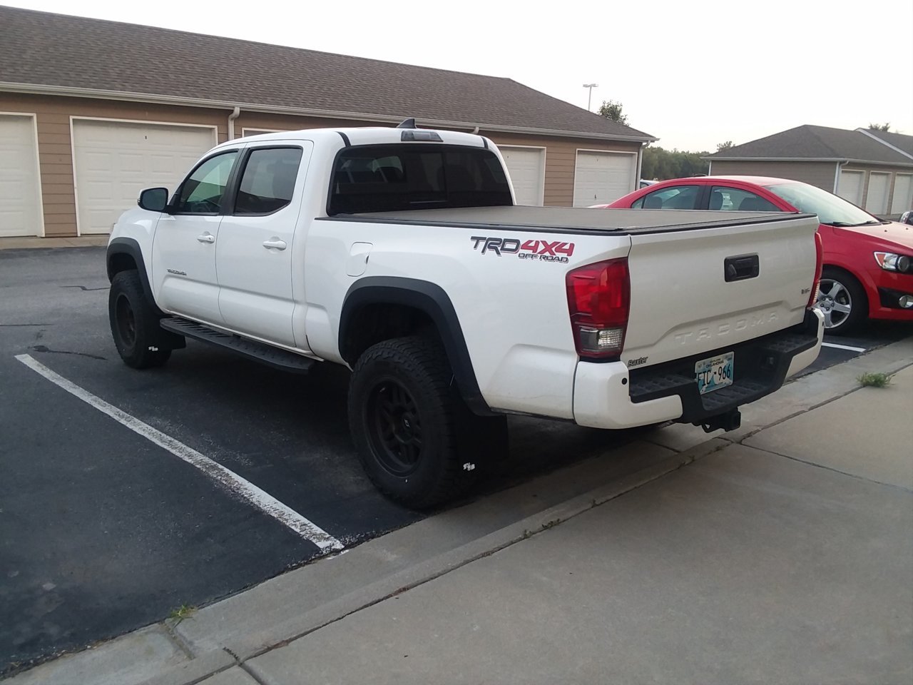

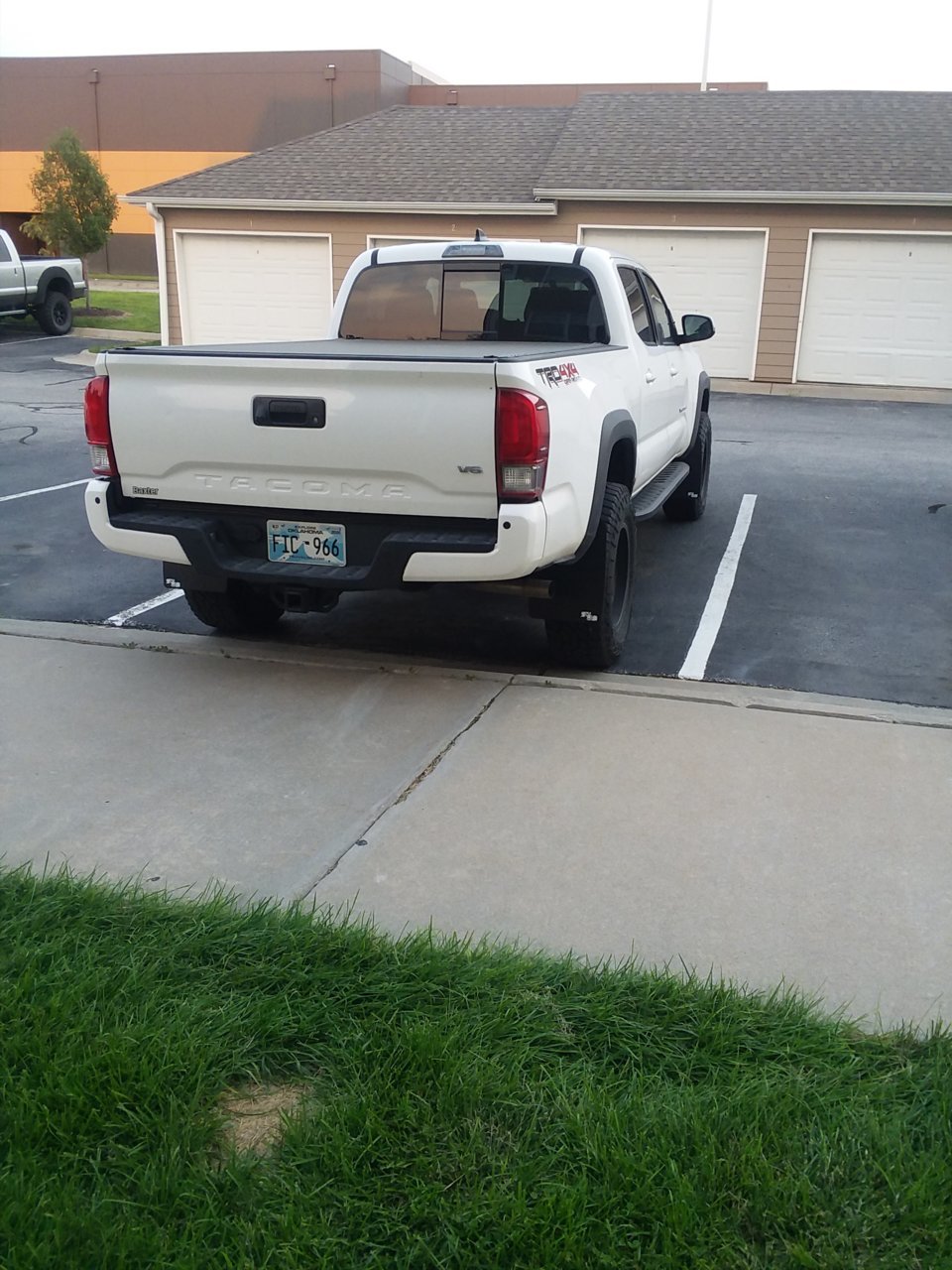

    Just got done with mine! What are you guys doing for that slot nut on the front to get it snugged in the hole?

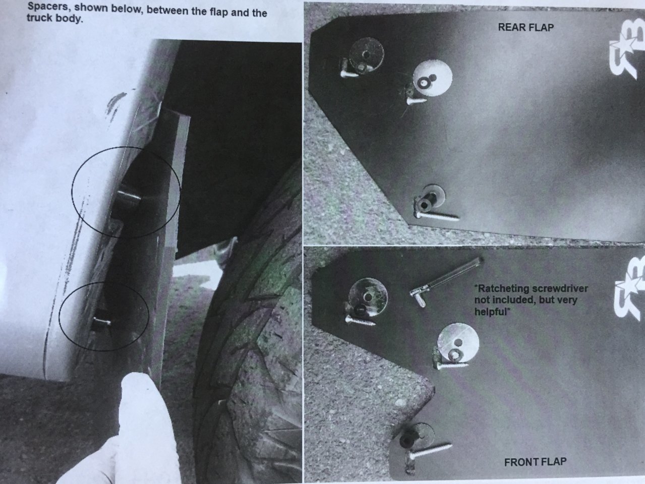

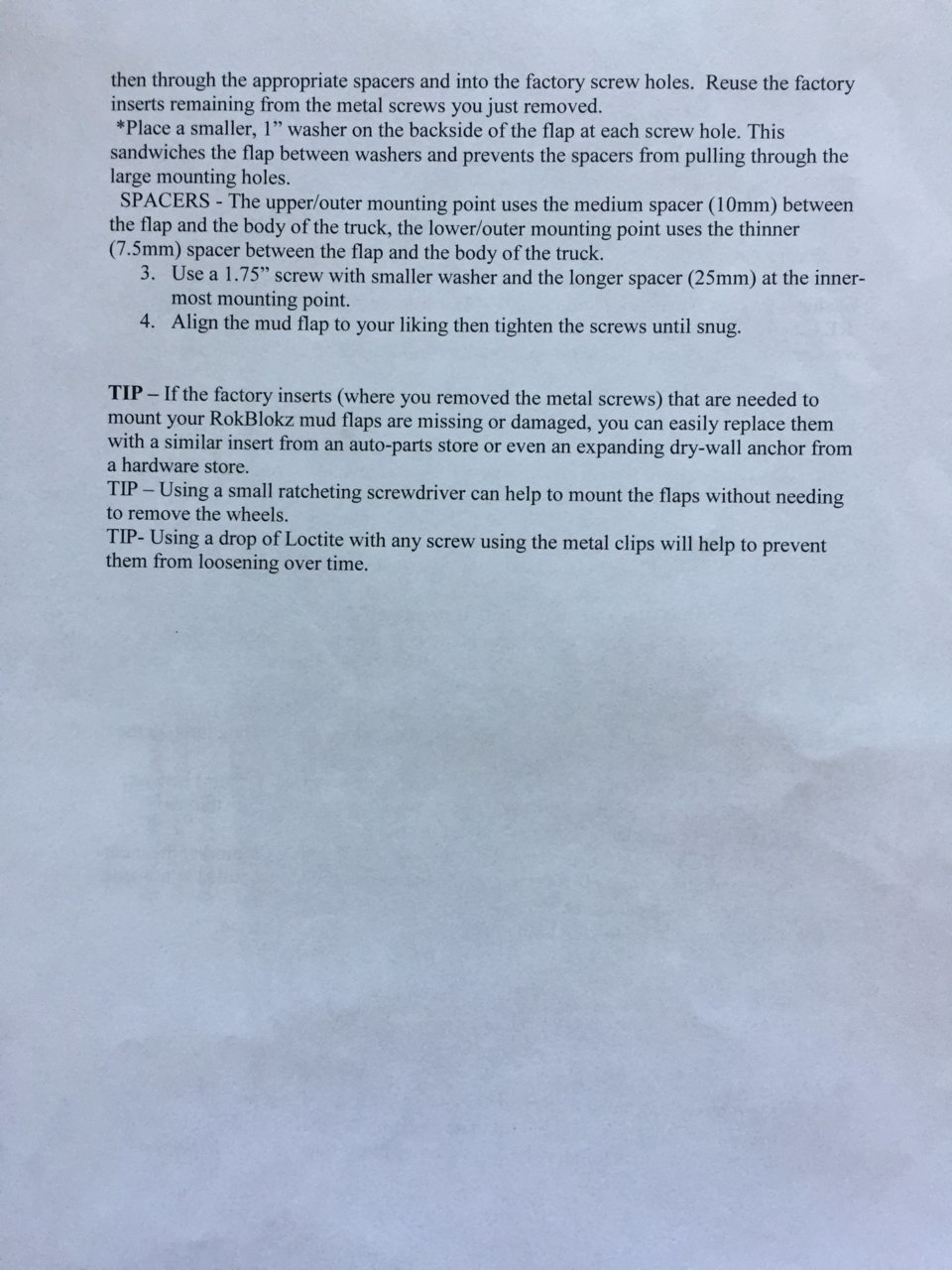

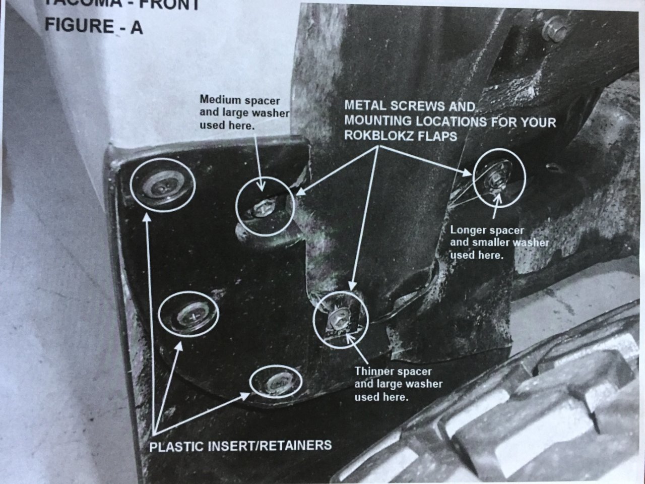

    Does anyone in this thread still have to instructions for these? I bought a set second hand from a member with all the hardware but I am not sure where the hardware goes. Can anyone help? If you have the instructions please take pictures or scan and upload them. I would greatly appreciate it.

    Theres 3 different sized spacers and different sized washers and some different sized screws. I just want to know exactly what goes where
