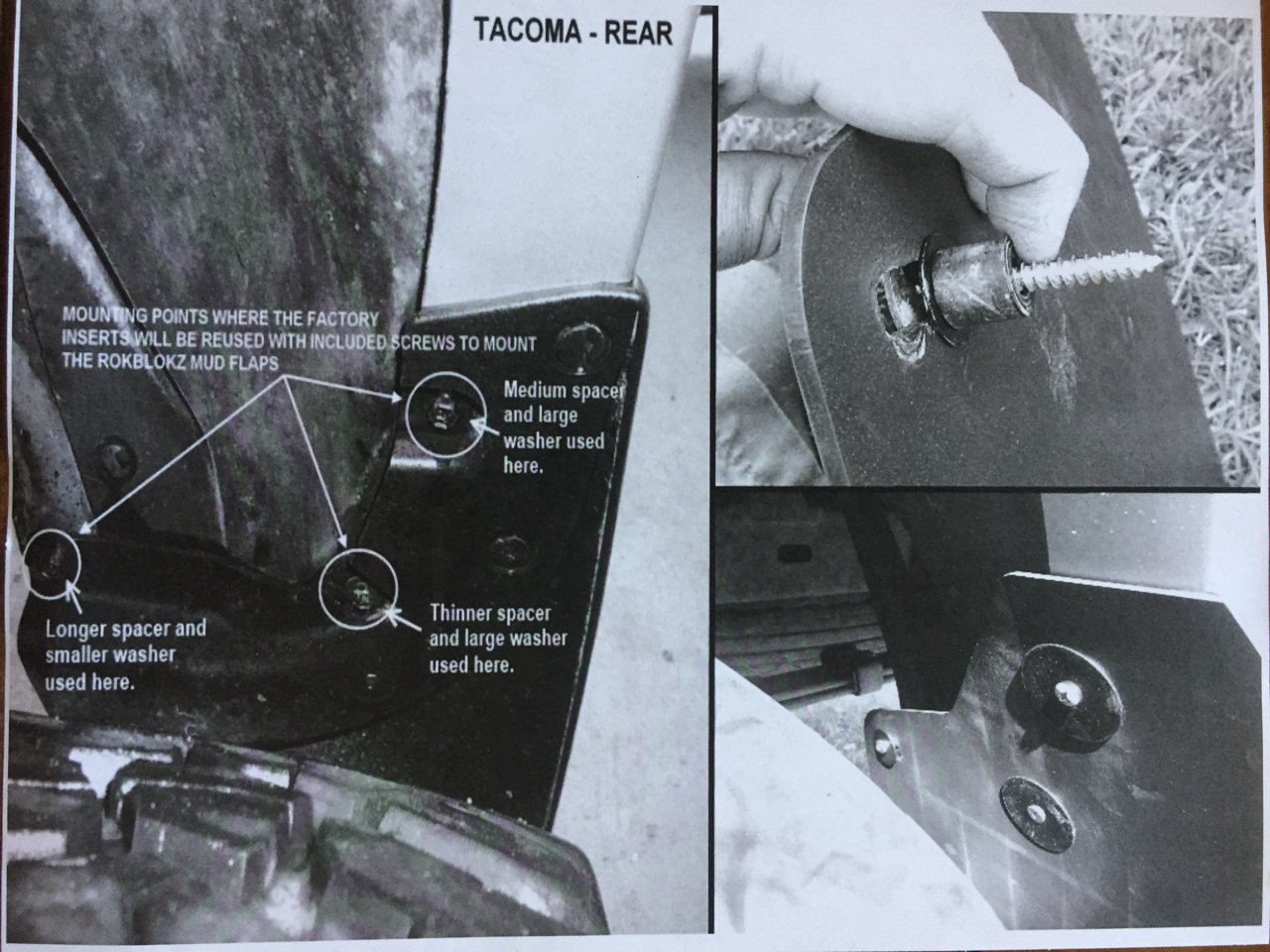

    Thank you so much! I really appreciate it. I got them installed last night with your help. I should like send you a beer or something lol
    The company did get back to me this morning with these 2 PDF's I attached them here just in case anyone in the future needs a hand. One for the regular flaps, one for the over sized tires flaps

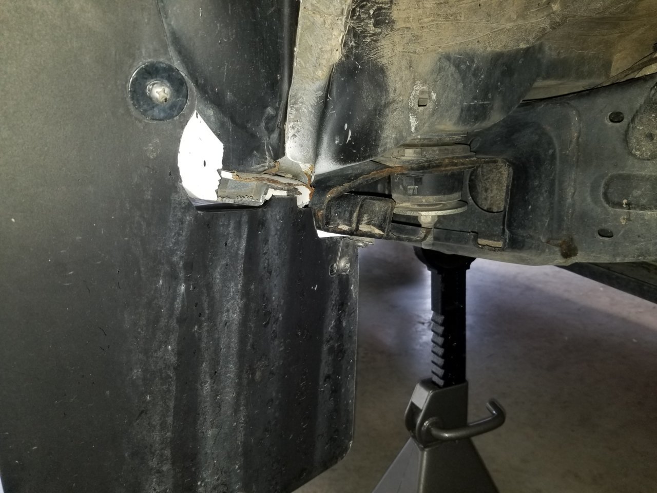

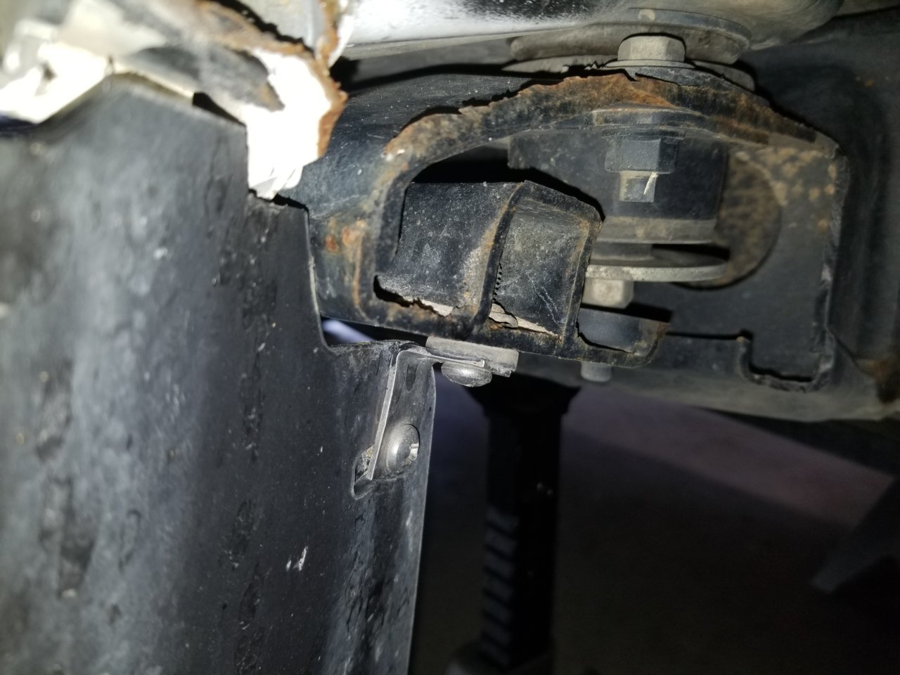

    @VangaSTL can you post a pic of the wheel well and how you remounted after the cmc? I feel like I would have to angle the rokblokz to get this to work

    Sorry, Ive been sick with the flu all weekend. I'll take a picture as soon as I can. You do have to angle the Rockblokz a little bit for fitment.
