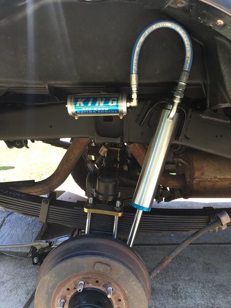

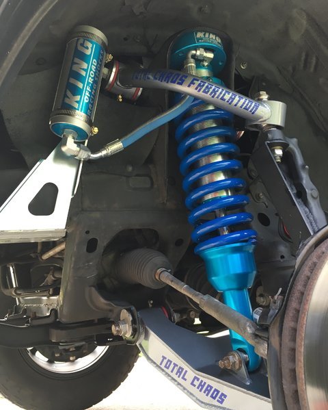

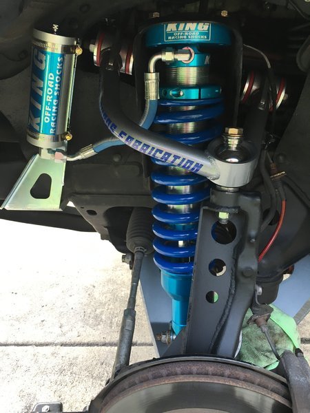

    '11 MGM DCSB TRD Off Road 4x4
    Total Chaos +2" Long Travel Kit; King/TC 2.5 LT C/O w/ 16"x600; TC/CVJ Extended Axles; TC Spindle Gussets; King 2.5 RR shocks; All-Pro Expendition Leaf Pack; Pelfreybilt Sliders; Anti-Dark LED Hood Light mod; LED map and dome light mod; Bed lights; TRD Cold Air Intake; KB Voodoo Tailgate cap system; HomerTaco Thin Lip "Raptor" grille; sPod SE System w/ LCD Touchscreen; Baja Design OnX6 40"; Baja Design S2; Rigid Industries LED Rock Lights; Front Runner Slimline II Roof Rack; A.R.E. Z Series Camper Shell Projector BHLM Headlights (with custom wiring); Method Racing NVs 17"x 8.5; and Nitto Terra Grappers 265/60/17
    Good setup, that's what I have and love it.
    You need a 14x650 spring rate. 600 will be too lite and 700 will be a little to heavy.
    @Mike330R is correct you just put number: 25001-119ext and King will take out a collar to make it extended. No price difference.
    Yes you need extended travel in the front. They don't make extended travel fro the rear, unless you went with their custom 2.0 12" travel shock
    B/c I use my truck for daily driving and camping. I got some great advice from Tyler Pelfrey and a gentleman at King about the purpose of the adjusters. Let's say I was Baja racing or driving my truck fast somewhere off-road where my truck would need more compression and then coming off road to utilize it as a daily driver, and I was doing like weekly, then yes I would need an adjuster. It would not service the purpose to increase compression and the lowest setting puts it back to a "stock" compression, doesn't make it any softer than what comes out of the box for the regular remote reservoir ones. And since I live in North Carolina which is very similar to Alabama, with rocky and wooded areas I figured just go with the non-adjustable ones.
    3.5 over stock. I have 14x650 springs.
    I finally am almost level with my all pro expos I have in the rear
