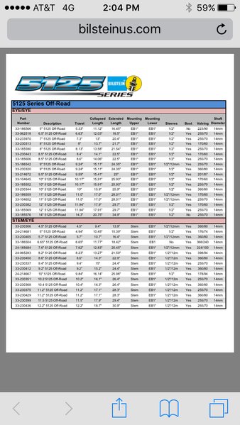

    This is possibly a better picture, full chart at the bottom of the building your own mid-travel setup page

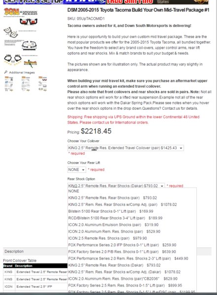

    The part number I posted just a few posts back is this shock.
    Pr2012-ss -a
    I called king this morning and spoke to a rep.
    Edit: I will be doing a relocation and may buy bamf tower or just build my own

    When you guys are saying extended the only ones King has are the 12" or more, custom shocks that come in 2.0 diameter. For anything like Dakar or All Pro leafs, a 2.5 diameter OEM shock will work just fine.
    To find the 2.0 shocks you go under performance I believe on their website. If you do a 12" shock you have to have the relocation kit, which then makes it a custom job not a straight bolt on kit.

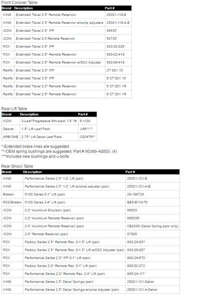

    so with the Dakar's in the back giving me more than 3" of lift, which length should I go with?

    You will be fine with the 2.5 diameter ones. 25001-121
