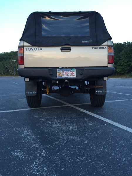

    Anyone else have issues with ARB rebate card? Unable to check balance and cannot purchase anything...

    Did you use new u bolts?

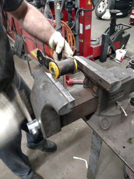

    Help these bushing fittings there something I'm doing wrong??

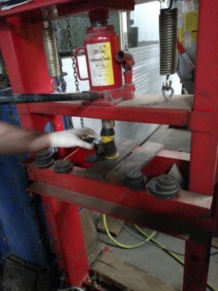

    My guess is this is a no go

    I did use new ubolts. I got them from wheelers, I believe they are 6.75 inch. They came w washers and tall nuts.
    Wow we didn't have to do that! Mine just pressed on by hand or a nudge w a hammer

    You shouldnt have to press that hard, you put the bushings in first, then the steel insert ,it looks like you are trying to do it with the inner sleeve in place, you do that afterward.
    I have done at least 25 OME kits and have never had to use anything but a small tap of a mallet to get everything in.

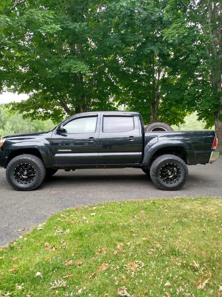

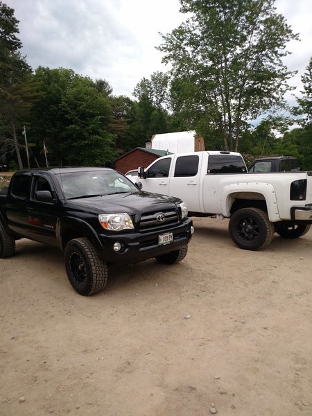

    From what I learned yesterday/ today there are no replacement shackle bushings just leaf spring bushings. WHY they give you 2 extra sets is beyond me.... I tried replacing both sets on the shackle to no avail it ONLY took 10 hours and 3 were spent doing this here GRRRR lol tried everything but ended up putting the old bushing in. So I need a new bushing on the one side....BUT on another note the lift is done and it looks great on 285/70/r17s with 887 coils and all pro UCA's happy happy happy hope this helps somebody else

    Hope this help anyone else like it did me after the fact :frusty:

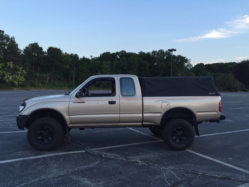

    What would you do if you ordered an ome light kit, but while it was on it's way here you got a plate bumper, sliders, and skids?

    See if someone wants to trade 885s for 886s springs or buy 886s springs outright and sell your 885s.
